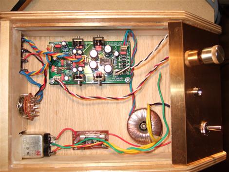

almost finished
Phew! Don't think I want to do any soic chips; at my age they are getting hard to see. Also exactly what is the purpose of the jumper? my preamp wouldn't work without it. I still have do get a better switch but itis playing well. I will let it burn in for a while.

Re: almost finished
Which jumper do you mean? 🙂
If you are referring to the 0R JGND that is simply used to provide a very slight resistance between the audio ground plane and the digital ground plane as per the PGA2311 datasheet. 🙂 You can also use something like a 1R to 10R resistor there which I have tried with success. The noise is so low in any case using the 0R jumper is an excellent option.
There are two more jumpers, but those are omitted if you are using the input buffer. 🙂
I am glad your preamp is working well. Enjoy it. 🙂

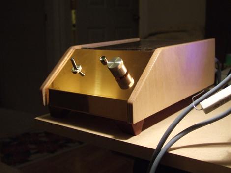

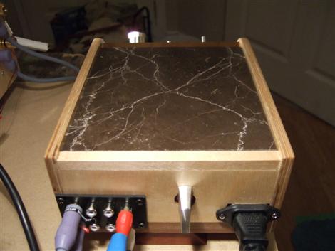

case
I learned something on this last case: bronze is tough but also very ductile
I also cut it with my table saw. The forming, to get those nice corners, I cut a groove with the carbide saw blade on the backside 1/2 the thickness of the 1/8" plate. Then I clamped the plate in my workmate and bent it by hand.If I say so, the bends and corners turned out perfect; better than a press brake could do, plus no damage to the front face. Just wanted to pass this along; I am still learning!
The preamp sounds really good and it can only improve. Thanks for this gem.

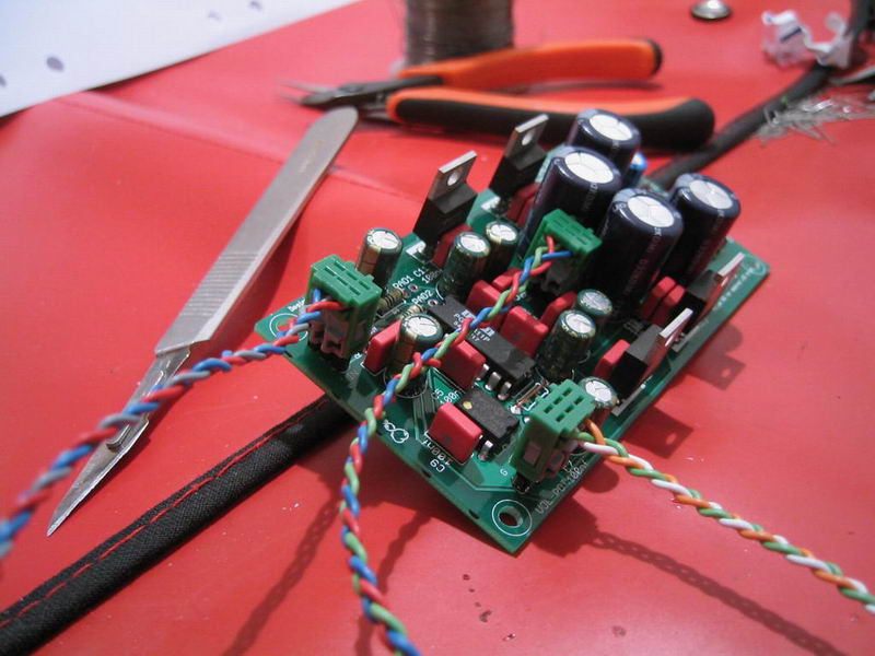

Mr. Triatic said:partly assembled..
Nice work! I really like those coonectors you used. What are those?
Very glad you like the preamp. It is my personal favorite. 🙂

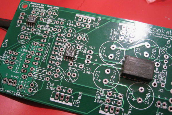

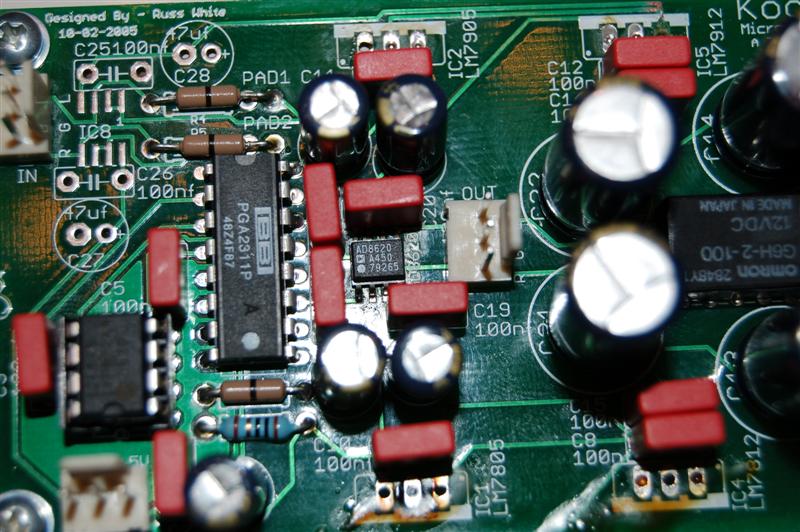

Russ/Brian-
Is my AD op amp oriented correctly?
If not just send me another board (and invoice) and I will start again from scratch.
I got my Rev_C back yesterday and went to install my Kookaburra(*) and realized I have the voltage regs backwards... 🙁
I removed them and figured I better ask about the op amp before I go any further.
Edit: * I recently found out the "locals" of the Kookaburra call it the "Laughing Jack-***". No joke!
