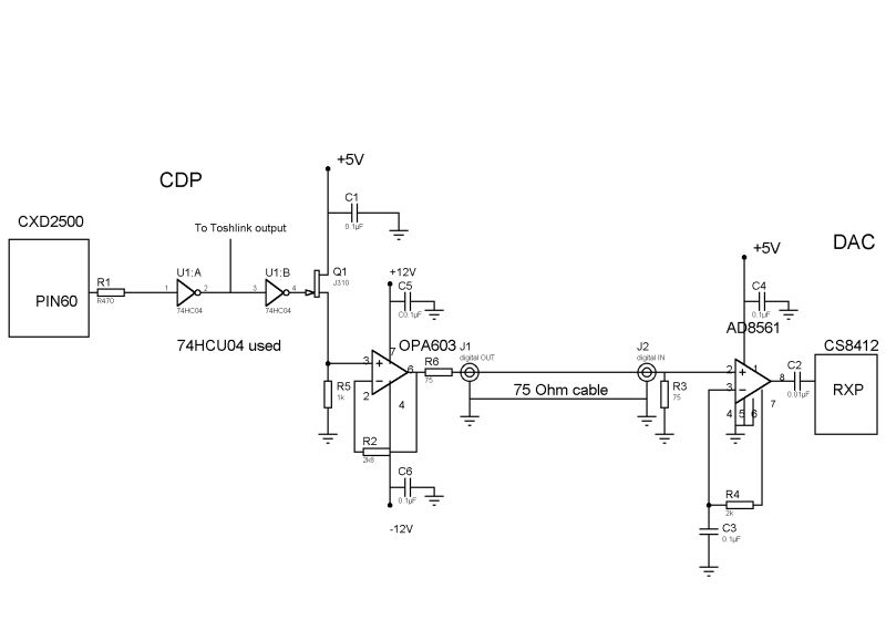

Hi All,
Attached is a improved interface using the AD8561 comparator. It produces a 4.5 V peak to peak signal at the RXP input of the CS8412 digital input receiver. Signal at the input of the comparator is about 1 V p.p.
Sound is much improved , better bass, better texture in the music. It is like tones are started from the fundamental, instead of from a higher overtone. Imaging is also improved. I like it!
Thanks for the hint Jocko! Apparently we need to knock hard on the entrance door of the CS8412.;)
Sharp eyed readers will notice the similarity with the KWAK-CLOCK: JFET followed by comparator.:)

Digital interface
If your output impedance is 75 ohms and your input impedance is 75 ohms and you are driving at Cmos levels, how do you get 1 volt p-p at comparator. The Crystal likes to be driven at logic levels it also likes even better to be driven differentialy (REAL BIG HINT!) Also I don't think you need the coupling cap into the 8412 since you have a logic level input. I tried the LT1016 comparator and I didn't like it but haven't played with the AD8561. Glad to see you back. I thought we ran you off.

Hi Harry Haller,
No I did not ran off. I had a nasty virus on my computer. I formatted the harddisk and everything looked OK. After that I got a boot disk error and I could not format the harddisk anymore. End of life <B>-KAPUT-</B>
The circuit:
The JFET source follower has a gain less than 1 and the arrangement with the cable gives a 3dB signal loss.
Of course this scheme can be modified to 110 Ohm balanced cable with one or two comparators at the CS8412. This will involve major surgery in my CDP and DAC to install XLR parts. Thanks for the hint; maybe I will try that in the future. I don't think it is a good idea to omit C2 as the input of the 8412 is biased to a other voltage than the comparator ouput. I am using a silvered mica cap for C2.:)

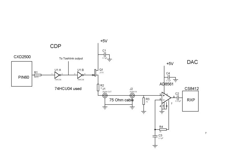

Hi Tiroth,
I just gave it a try with dual +/- 5V supplies for the AD8561 comparator (pin#4 connected to -5V).
Much to my own surprise it sounds a lot better that way. Can it be the 5dB better Power Supply Rejection..........?
Also powered the comparator in the KWAK-CLOCK this way: same improvement.
So your question led to a major improvement!
Pretty interesting! Can I ask why you don't bias the inverting input above ground? Wouldn't this provide better noise rejection?
The designs I have seen that make sense to me use a comparator with its inverting input biased to, say, 50% of the input logic "1". Maybe 100mV for S/PDIF or 2V for AES/EBU.
I think I am getting my comparator tutorial now. ;)
SPDIF input receiver
Hi Tiroth,
The trick with the 2k feedback resistor on the comparator is that the negative input is biased to the DC-level of the output.
In this way the trippoint is automatically adjusted to the DC-level of the inputsignal at the positive input.
[One usually sees the negative input connected to the wiper of a pot connected between V+ & V-.] You can also look at the comparator as a unity gain follower at DC.
You asked for a universal circuit and that is what you get. It will work with standarised SPDIF signal (0.5 V p-p; no DC) as well as with my circuit with about 1.3 V p-p AC and considerable DC offset (about 1.5V) on top of this.
The comparator has TTL logic output format. I did understand the CS8412 likes his/her food this way.
