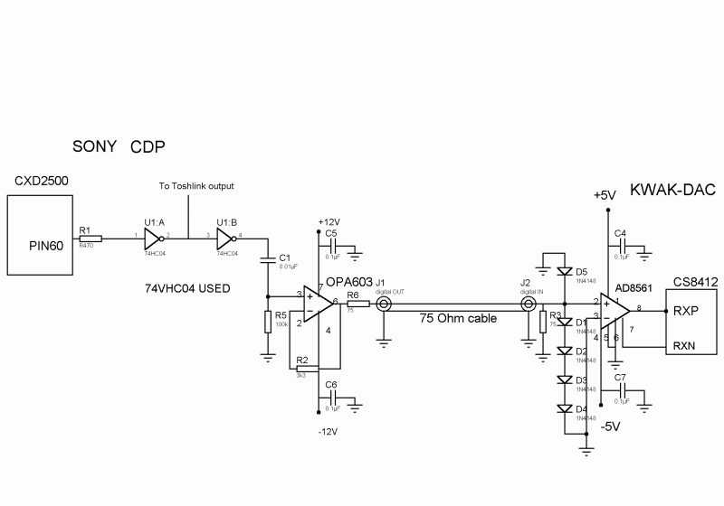

Finally made a interface with balanced drive to the CS8412, after listening to many hints. It is quite a improvement to the sound!
The FET in the CDP is omitted as it proved it worked just as well without it.🙂
How to make a balanced 110 Ohm interface is left to the creativity of the interested reader.😉 😉

Nice circuit Elso. But, suppose I haven't modified the output of the CD player, and has V<sub>L</sub> 0.7V and V<sub>H</sub> 4.3V, which are the values from the output transmitter of the CS8420. In this condition, with the - input of the comparator grounded, the differential input voltage is always at least 700mV, and the comparator's output will be constantly on.
The problem is that the differential input must swing to -2mV for the output to switch, and in this case that would be 2mV below ground, which isn't going to happen 🙁 With your transmitter on the left, the voltage will swing all the way down to -1.8V, which is great, but if I don't control the other end I have a problem.
Any ideas on how to adapt this reciever to general purpose use? I guess you could move the whole shooting match over to the right hand side of the cable ...
Sorry for my ignorance. I'm just trying to find a good way to interface single-ended coax transmission into the CS8420's reciever. A pulse transformer probably works fine, but that couples reciever glitches onto the cable. Perhaps a pulse transformer followed by some logic?
The right pulse transformer will work great
But about glitches....
If the '8420 is like the '8412/4, with a Schmitt trigger input, you will need to isolate it from the line with or without a transformer. If you do use a transformer, you can get differential operation, and employ a few chips to get the level up.
Seriously.....I've used ECL style inputs, which could mean a decent high-speed op-amp optimised for differential lines. Or even discrete circuits. That way, you wil have a circuit that will not couple anything back onto the line. The logic chips can then serve an additional isolation stage.

Hi JWB,
I hope you don't drive directly the coax cable from the CS8420 The datasheets suggests using a transformer connected to TXP with a 374 Ohm resistor and a 90.9 resistor across the primary. (fig. 33) You can also connect the TXP to a 74HCU04 as in my circuit. With the transformer installed I thrust the signal at the receivers end is up to the SPDIF standard; 0.5V p-p. In theory this should work with the AD8561 comparatoras long no DC component is present. The comparator only needs a few mV above zero to give a high outputstate.🙂
Re: Digital Interface
Elso Kwak said:
With the transformer installed I thrust the signal at the receivers end is up to the SPDIF standard; 0.5V p-p. In theory this should work with the AD8561 comparator as long no DC component is present. The comparator only needs a few mV above zero to give a high outputstate.🙂
Wel in real world it does not work!
I tried it with a standard Sony CDPXA30ES and got no sound output. Dead silence!
The comparator produces a series of glitches but not a real SPDIF signal. Somewhere I must have made a fault in my line of reasoning.
But the complete interface works as in the picture, provided the digital ground is connected to the chassis of the CDP.:cannotbe:

Hi all,
I feel deeply ashamed as a broken ground lead to the comparator board lead to the wrong conclusion!:blush: :blush:
The interface <B>does</B> work with the standard SPDIF output from the Sony CDP.
It also does work with the TORX173 receiver provided that a 10nF coupling cap is installed and a 100k resistor to ground from the comparator input to ground, having a path for the input bias current.

SPDIF Interface
Forced by circumstances, both my Philips CD-650's broke down, I had to use the SPDIF interface again now with a Philips CD931. I did not find the I2S signals yet, waiting for the manual.
I followed Freds suggestion removing the inputcoupling caps to the DIR.
Now I have much more bass and much less glare! How is this possible? Thanks for the hint Fred!
I added some 1N4148 diodes to the digital input limiting the voltage between +3 and -0.6V, hopefully protecting the comparator.
I also experimented with a Scientific Conversions transformer in the CD-output and also with 74VHC86 directly driven by the opamp. The opamp was configured for a gain of 2x for this configuration producing 5V at the 74VHC86 's inputs. The transformer did not improve the sound, nor did detoriate it. I noted less slam with the 74VHC86 but did not get one of the outputs right....😉

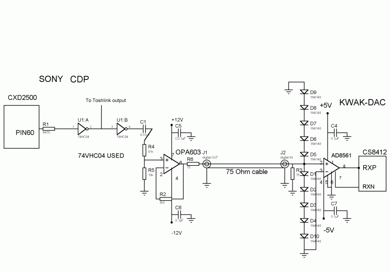

Stupid Mistake/0.5V p-p Out
Jocko let me know he dislikes the diodes, as they are conducting and he wants a 0.5V p-p out as SPDIF norm prescribes.
Well I can't plaese everyone :clown: Hopefully I have learnt to count to 5 now :cannotbe:
Sonically this circuit is not different from the previous one.....😉:bawling:
