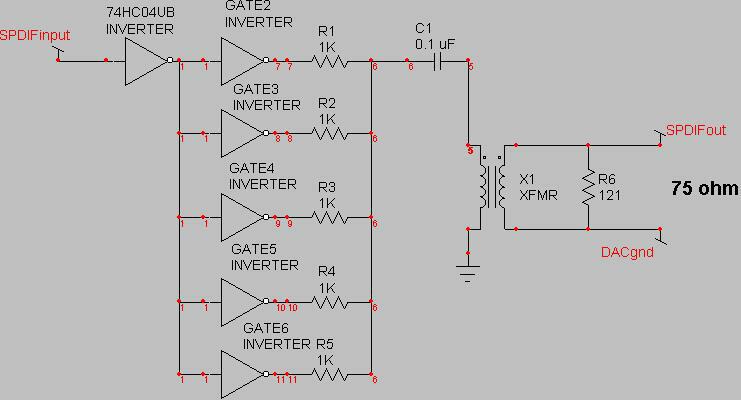

My setup is like that:
The transformer in the transport is the one from Sonic Frontiers. There are 75 ohm resistors in series with primary and secondary (I wasn't sure if they supposed to be in series or parallel with windings but that how the PCB was designed). In the DAC the receiver is CS8420. Since I have a transformer on the transport side I was trying to eliminate the coupling caps completely leaving only 75 ohm resistor to the ground, but CS8420 didn't lock then. Any explanation?
Digital Transformer
Transformers work best at tansport end. Here is a circuit using on CMOS hex inverter. I like a 50 to 100V polypro cap. High voltage caps have too much inductance. Jocko?

The output resistor is 121ohm? When using that setup can I remove coupling caps at the DAC input. I tried to do it before, but without caps CS8420 didn't lock, why?
Digital driver
The transformer driver goes in the CD transport. The resistor after the transformer is 121 ohms or 120ohms depending on 1% or 5% values. It is part or the attenuation network for the driver and also buffers the leakage inductance of the transformer to provide good back termination impedance of 75 ohms 1000/5 in parallel with 120 ohms. Leave the caps on the inuts of the Crystal receiver. YOU WANT ABSOLUTELY NO DC IN A PULSE TRANSFORMER.

You actually could use a 0.047uF cap or a regular 74HC04 for this circuit with no problems. Avoid 74AC logic and other fast logic for digital audio. It overshoots and creates EMI and sounds bad. Several digital audio designers have not quite figured this out yet.

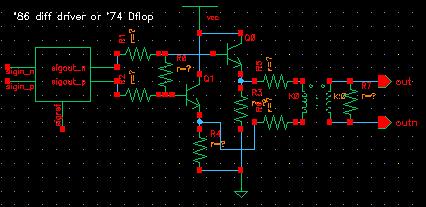

S/PDIF driver suggestions

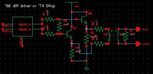

Two technical issues with the '04 xfmr driver relating to my obsession with jitter:
1] As Jocko [are we Devo] et al have pointed out, part of the art is matching the xfmr; and the critical transitions, which define the edges of the waveform are essentially a transient high impedance state of the CMOS/TTL driver. When it switches, all bets are off...and the edge is when we also need the impedance matching. So, a class A *linear* driver is usually better, keeps the impedance more constant [one of my fave oxys] during transitions.
B] Single ended CMOS/TTL drive is way too power supply sensitive: any power supply shift will shift the launch point and introduce jitter, including at hard to filter low frequencies. Try a balanced scheme, either using a[n] '86 with two sections wired out of phase/polarity for matched delays; or preferrably a '74 using q and qbar outputs being fed a clean clock for registering/reclocking.
I think it was Ed Meitner who gets credit for first suggesting the obvious: hook up a highish gain AC coupled amp to a digital supply rail and listen. Watch the gain, save your hearing for music. You will hear strange gremlins, correlated to the music signal. You do not want any critical timing signal referencing these gremlins.
Hopefully the attached sch is more readable this time. The r's in the sch depend on the implementation and should be experimented with. You may need a big blocking cap in series with the primary. The supply for the '86 or preferrably '74 should be clean and quiet. The CMOS/TTL driver "sees" the same load for each direction of the transition, and the emitter resistors can be set in conjunction with the transformer and load resistors to put the transistors in constant power mode, ie the transistors have the same i*v for each state, hi/low. The lack of thermal tails at this null point is audible, unless your name is J. Hirsch...
If you really want to get trick as the phrase goes, use a 6111 dual triode pencil tube with a 15 or 30 volt supply in place of the transistors. You would have the only tube drive transport on the block.😎
The 84xx rxp and rxn inputs are self biasing, and can handle many volts of signal. Try hooking the secondary of the xfmr with the load matching resistor directly across them with no ground reference and no caps. It may work in your system, it may not.
Enjoy,
WMS

Power supply noise
"hook up a highish gain AC coupled amp to a digital supply rail and listen." That is what oscilloscopes and spectum analysers are for. Noise at over a megahertz is hard to hear.
Could not have said it any better myself. Only problem is if you keep giving away designs like that, how are we ever going to keep selling them empty-shell high-end comapnies.
'74 flip-flop, eh? Ever hear of prop delay?
And you better buffer the input of those wretched 84XX receivers.

Jocko, do you have an opinion on the TI DIR1701/DIR1703? I have see you lambast the Crystal parts on many an occasion ^_^ but what alternatives do we have? Is there any monolithic IC/IC+buffer that you like for a reciever?
The reason I hate them so much is because they have a Schmitt trigger input stage. Put a buffer between it and the line, and they are fine.
Hard to say which ones work, and which ones don't without actually hooking them up. Helps to have A TDR, which I do. Believe it or not, the lousy Yamaha RX chip everyone hated so much actually has low reflections.
I prefer a linear stage, properly loaded to 75 ohms RESISTIVE. Layout and cable parasitics need to be addressed.
