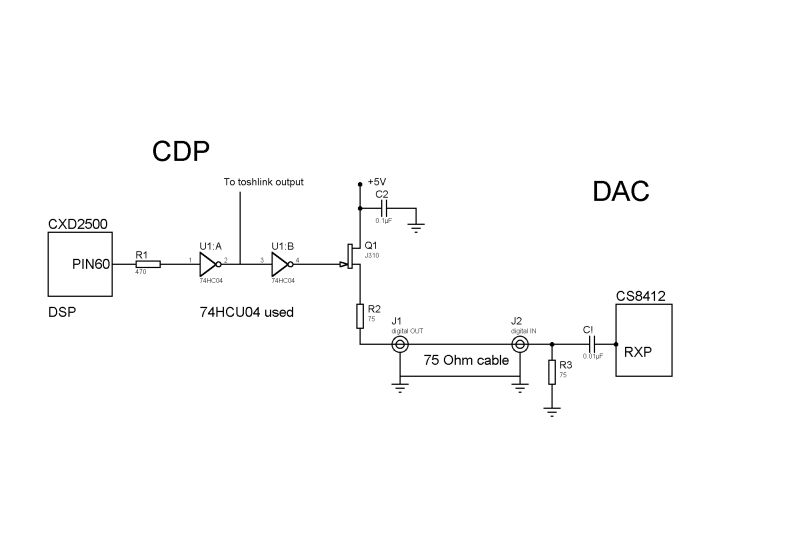

Simple Direct Transformerless Interface
Hi Wildmonkeysects and all other esteemed inmates of this lighthearted Forum,
Over a year we discussed my direct coupled interface in conjunction with the Wildmonkeysects loopfilter on the Audio Asylum forum.
http://www.audioasylum.com/audio/tweaks/messages/30462.html
A forum now passing away slowly because of obesity.....I can't even find back my own posts. Here we see passing along genetically manipulated cats, a dog addicted to booze & smoking, forummembers wearing very weird hats etc.....
Quite recently I improved the circuit, now using the J310 N-Channel JFET from Fairchild in place of the 2N2369 bipolar transistor. I am using double shielded coaxial cable used for video and TV transmission.
The Interface works fine for me and should have adequate bandwith. It has of course no ground isolation as the transformer.🙂

I am a little puzzled - are we talking about digital transformer which functions as an alternative to 10nF capacitors at the spdif input to the CS8412?
Or are we talking about a transformer somewhere else. Elso's helpful circuit diagram shows the transistor he mentions actually driving the 75 cable - rather than at the receiving end.
Is that what Kasra was meaning? Is that what we have been referring to? (i.e a transfomer to drive the 75 ohm cable)

Weird hats aside, some of us have done a lot of research into this. We strongly feel that using isolation transformers function better that direct connections. We have also done a lot of research into what transformers work, and why.
And the bottom line is to use a transformer, and one with as little leakage inductance as possible.
And yes, all the loop filter mods and other tricks are still a bandaid for a poorly conceived interface.

Im going to build an interface between the cd and my homemade dac. Well the CD has already some cheap a¤¤ that need to be upgraded. It really leans to Pulse transformers, which seems to be really easy to use.
I have talked with the president of Scientifi Conversions, by specs their values seem to be the better ones on the market when it comes to transformers.
They provided me with everything i needed to know, even measuremeants which are far away from my knowledeges.
They have many to choose from depending on the wanted interface, and they are all optimized for different samplingrates, according to the papers i have read.
Jocko / Elso / Harry / Others, what do you think about using transformers, and perhaps the ones from SC?

Can't think of any reason to have so many flavors. As long as you can pass the 7th harmonic.
A good place to start is the Schott 67125450 that Digi-Key sells. I believe Crystal recommends it, but if they do it is for the wrong reason. Like everything else in their diatribe on transmission lines.
