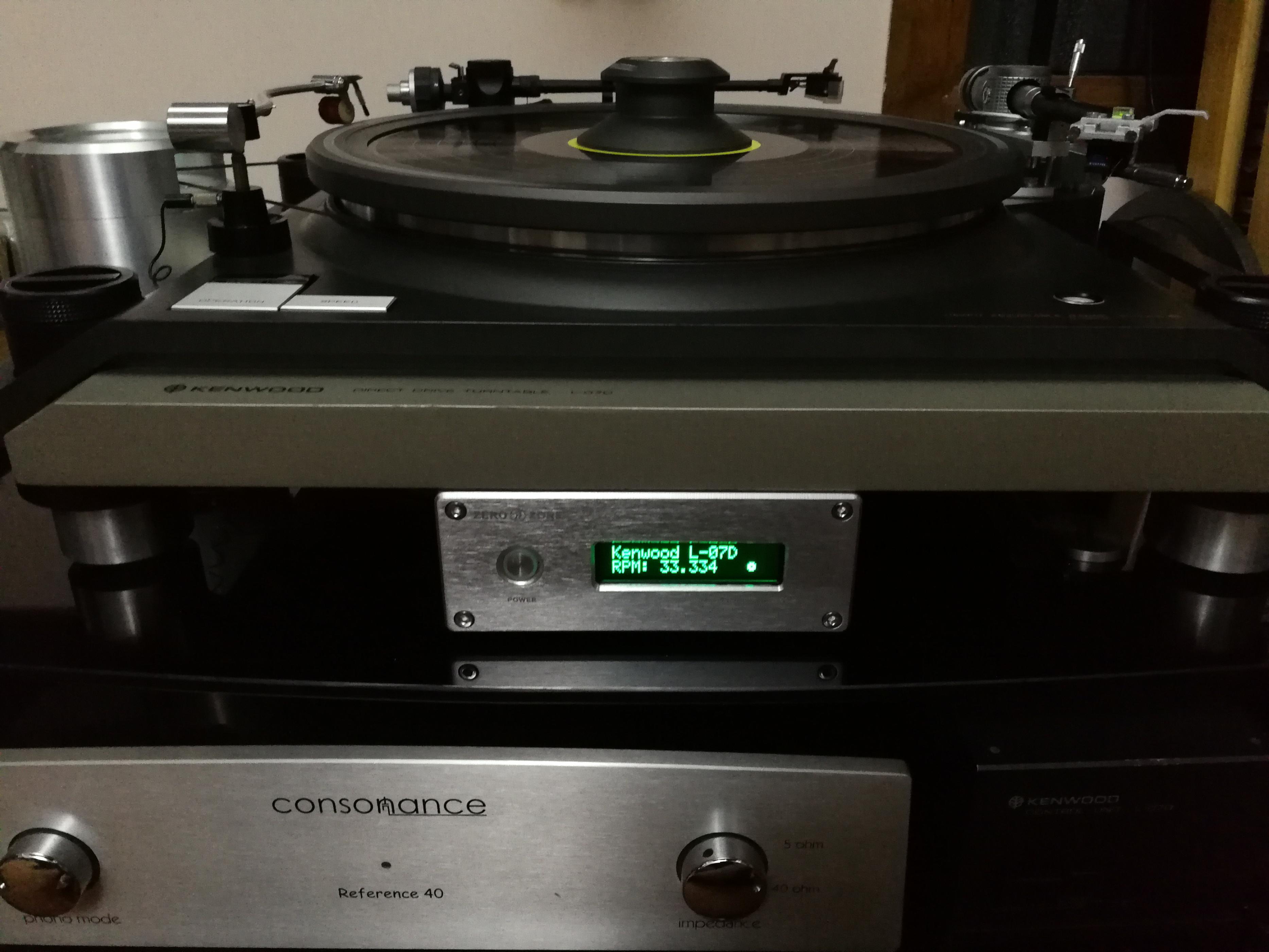

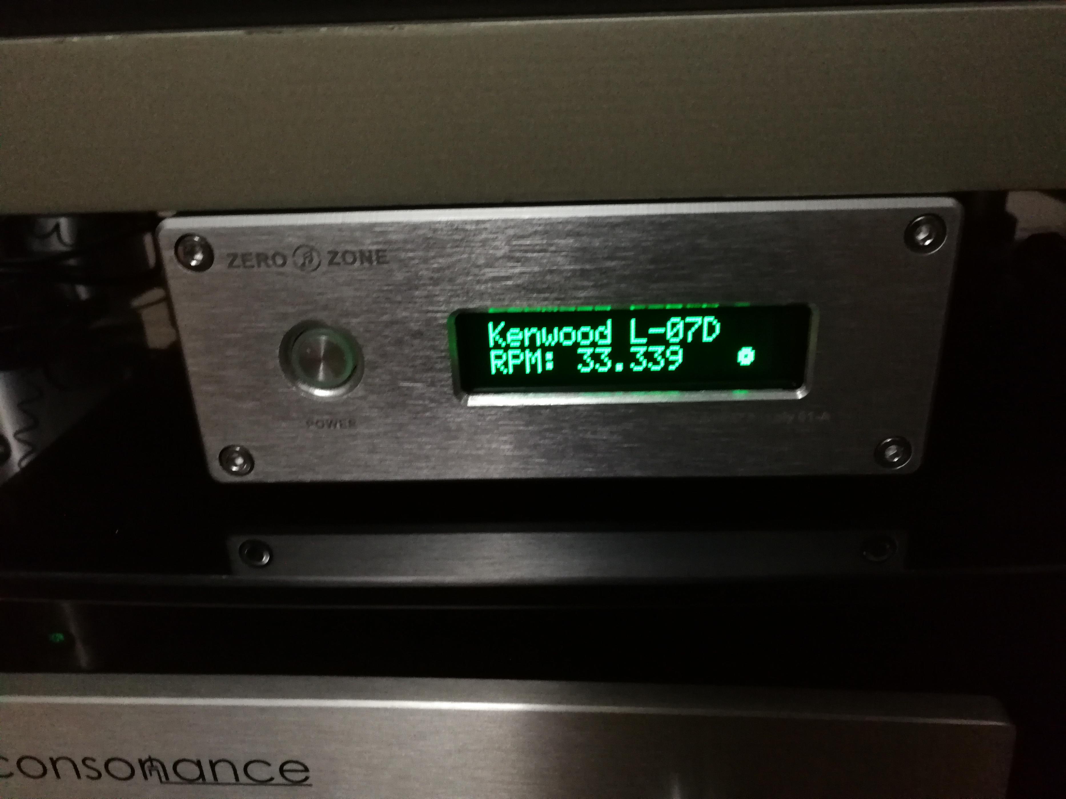

Hi find my tachometer completed, I have ordered ZeroZone linear power supply for my turntable motor, I build my tachometer (Midas LCD+ Arduino Uno) inside linear power supply. Thank you all helping build accurate turntable tachometer. Rajkumar
Great looking build; glad it worked out. The table looks great and appears to be very accurate.
Thanks Bill, this table originally direct drive, I have modified 2 in 1 direct belt drive. There was sound different in belt and direct. When I build belt drive never use direct. I love to listen belt drive. Rajkumar
That is a nice looking isolated motor housing, good job
