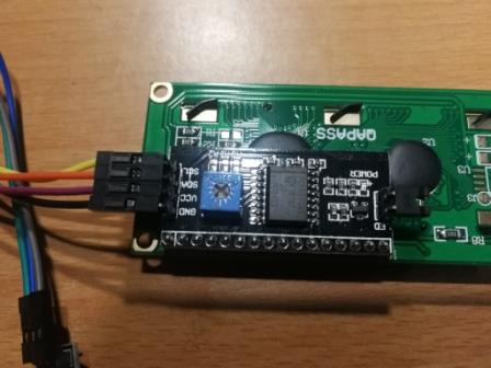

I've to try recall what I've done. My LCD is Midas MC21605G12W-VNMLR (red on black) whereas yours is green version. The circuitry is the same for both. The difference lie (compared to lcd 1602) is to reroute the I2C VR potentiometer ground terminal to Vee (pin 15) at the Midas display. This involve a bit of careful surgery to the I2C adapter. Do this surgery BEFORE soldering piggyback to the LCD. It'll be a pain to separate it in case of any mistake. Perhaps hook all up to a breadboard before making anything permanent. The I2C VR have to be entirely desoldered removed from the adapter pcb, isolate the ground terminal by cutting round that VR pin point, then connect by wire to pin 15 at LCD. I don't know if you can do this successfully but hope you can if you insist on using the Midas display.
About the commonly found I2C 1602 adapter. You may be supplied with 2 types of chips. PCF8574T or PCF 8574AT. Both are the same chip but different address 0x3f or 0x27
Use Arduino I2C scanner to find out the address and use that.

Again, remove the i2c VR pot, isolate the ground terminal, link that isolated terminal with wire to Pin 15 after soldering the VR pot back to the module.
Try it out with a breadboard to see if it works.

Also do not solder the piggyback I2C to the LCD. Use the same socket they use in the Arduino pins connections. You can remove it easy if you have some problems with the display. If you a LCD make sure the piggyback it is not solder to the display. Normally I buy the ones with the connector looses.

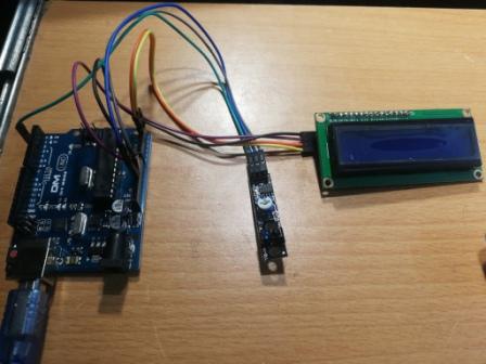

I have try to loading file you given "Tach" also try another old file there was error message on screen Arduino IDE, I have used Arduino Uno Chinese board and check loading example file board working good, used LCD "1602 16x2 LCD Character Display + IIC/I2C/TWI/SPI Serial interface Board Module" module chip PCF8574AT. I have attached board and screenshot error. please help me.
Ensure that you have the PCF8574 library installed in the Arduino IDE. If not, you will need to download and install it. See this link for help:
Arduino - Libraries
Arduino - Libraries

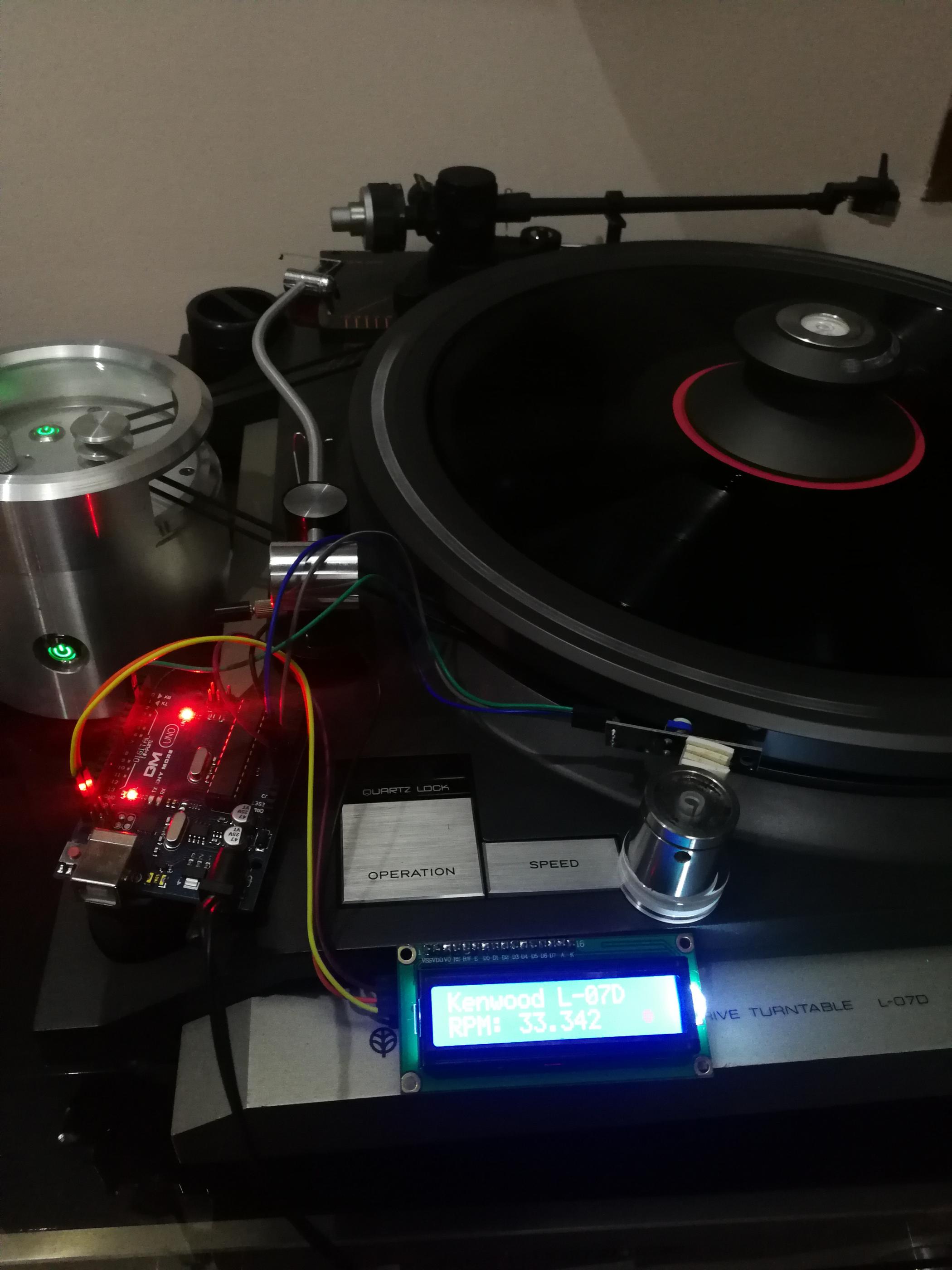

Dear Pyramid, As per your instruction I have installed libraries for PCF8574 than file can verify loading successfully, but still not seen any character, then address try change as per txt file than when enter 0x3f load again start working I can seen RPM display I am very happy you people doing grate support. Please find picture my turntable "Kenwood L-07D' this is legendary from Kenwood, this table direct drive, I have modified "Direct & Belt Drive. Thank you all who help. Rajkumar
Hi Coolmaster, I have received Midas Display since yesterday now I'm waiting for another 12C adapter, you're 100% correct existing 12C adapter not able to remove from 1602 2X16 LCD. Once received 12C adapter, I will try to modify 12C adapter VR ground isolate from PCB board solder wire reroute to Midas display pin 15 Vee - negative output. I will update when complete conversion Midas & 12C adapter. Thanks
