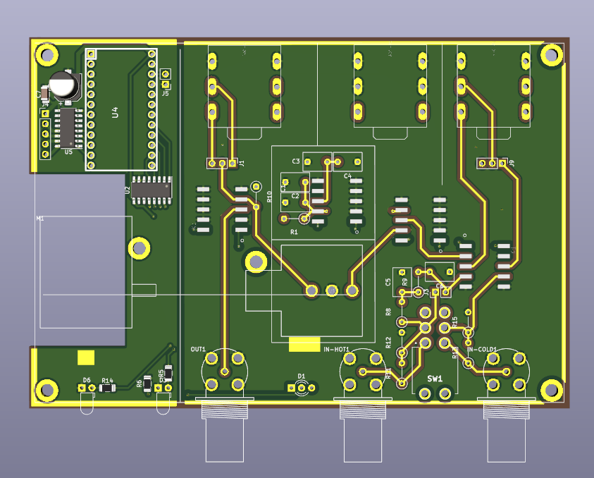

For the resistors and the caps I would recommend through hole parts. We can get better parts and ones that won't have significant voltage coefficients. All this matters below -120 dB. Possibly the solder mask matters judging from what victor has reported. Maybe hold back the soldermask around the sensitive parts. We should use a nonconductive link between the motor and the pot. Pots are notorious for issues around shaft grounding. if its completely isolated that should not matter (I hope).
There also may be an advantage to adding driven (guard) planes around some of the sensitive circuits to reduce stray capacitances. A resistive divider from a low Z source would be all that is required.
Thanks a lot for your review.
The most critical part is the RC filter (and the pot, of course). Its distortion cannot be compensated. I use a THT resistor there already (the switchable RC filter is the block with 4 capacitors and the THT resistor on the render). The other resistors are SMD to minimize noise pickup now.
My reasoning was the DAC and ADC circuits are full of SMDs and it is the job of the compensation to correct their distortion. Adding a few more SMDs into the to-be-compensated part should not matter.
Distortion outside of the calibration loop cannot be compensated - that being the switchable balanced input attenuator and the by-passable input low-pass filter to reject the bandwidth noise. They are all SMD now too.
I can replace all signal resistors with THT footprints - but would like vertical position for space purposes - is that OK?
Signal capacitors are THT already.

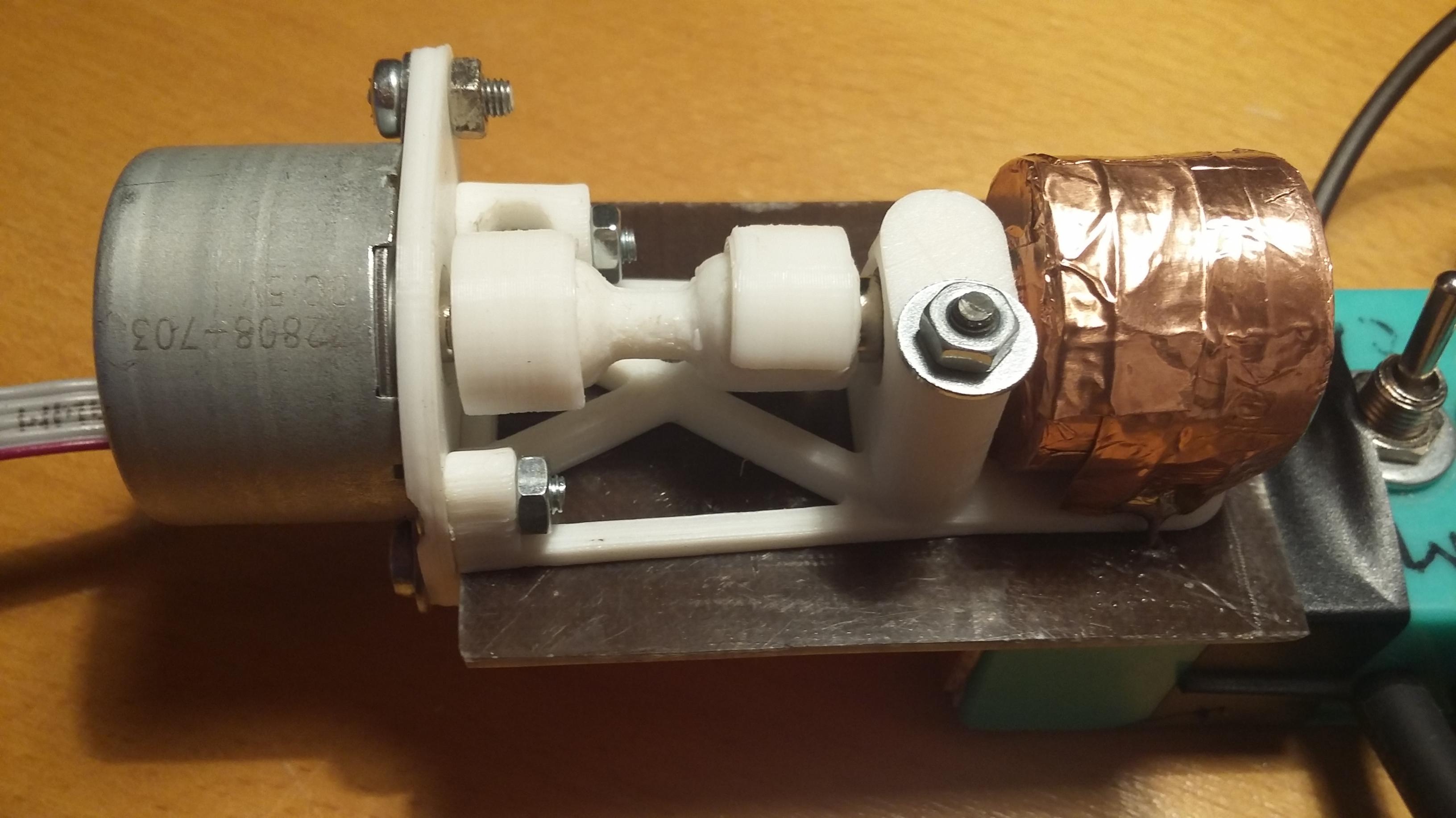

The stepper-pot coupling will be 3D printed, as everything else. I made sure their axes have enough clearance. Actually the stepper and pot holders will be one 3D-printed part to guarantee their axis concentricity.
Regarding the capacity coupling between sections: The 3D-printed enclosure will consist of bottom and top part, internally completely covered with copper tape. The top part will have ribs all the way down to the board at places marked with lines on the board silkscreen. The copper-taped ribs will shield 3 sides of the RC filter (I may add the remaining side to fully enclose the RC filter), and TRS sockets from each other. A rib running across the whole board (along with its mirror on the bottom half of the enclosure) will create two galvanically isolated shielded compartments when the enclosure is closed - for the controlling part and for the signal part. Fully separate grounds, connected to the corresponding shields of each compartment (that is why the board has no solder mask along its edges). The part of the stepper-pot coupling which goes through the shield wall will be narrowed to minimize the non-shielded area.
The pot will be fully taped with copper, so that the voltage-divider path does not interfere with the out-of-phase LPF path. I have this arrangement in my existing adapter and it seems to work OK.
I will avoid the solder mask in the RC filter and other sensitive parts.

For the through hole resistors a .2" spacing should enable most precision resistors as well as 1/4W leaded parts. Personally I would want to minimize nonlinear stuff both inside the correction and outside. Just less to correct.
I was first thinking you would be using one of the Alps motor driven pots but getting the motor to have enough resolution would be an issue. Does the stepper have enough resolution?

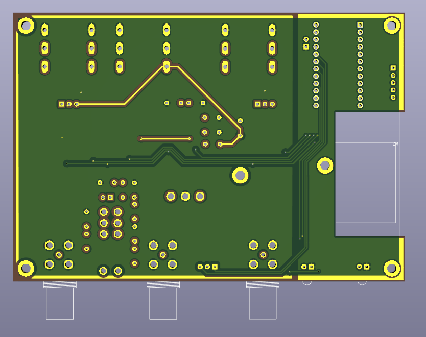

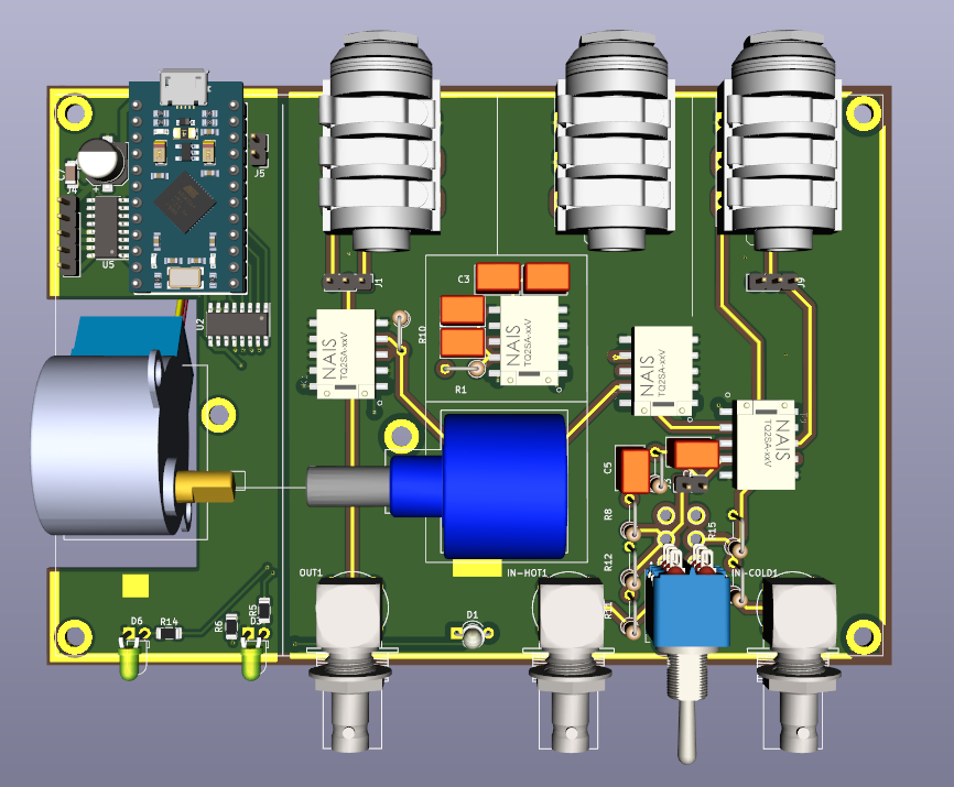

Removed the preparation for compensating dual tone by summing two input channels - I think it can be achieved with dual-tone signal from a single channel (to be tested). This simplified the board a bit.
All signal resistors are THT, all signal tracks have solder mask removed (manual chore in kicad 🙂 ).
Rearranged components to allow enclosing both the RC filter and voltage divider into separate shielded compartments.

The stepper-pot assembly finished in order to finalize position of required holes on the adapter PCB. About 10 stepper steps to reach the adjacent pot wire, 15 steps of backlash, no problem for the control loopback.

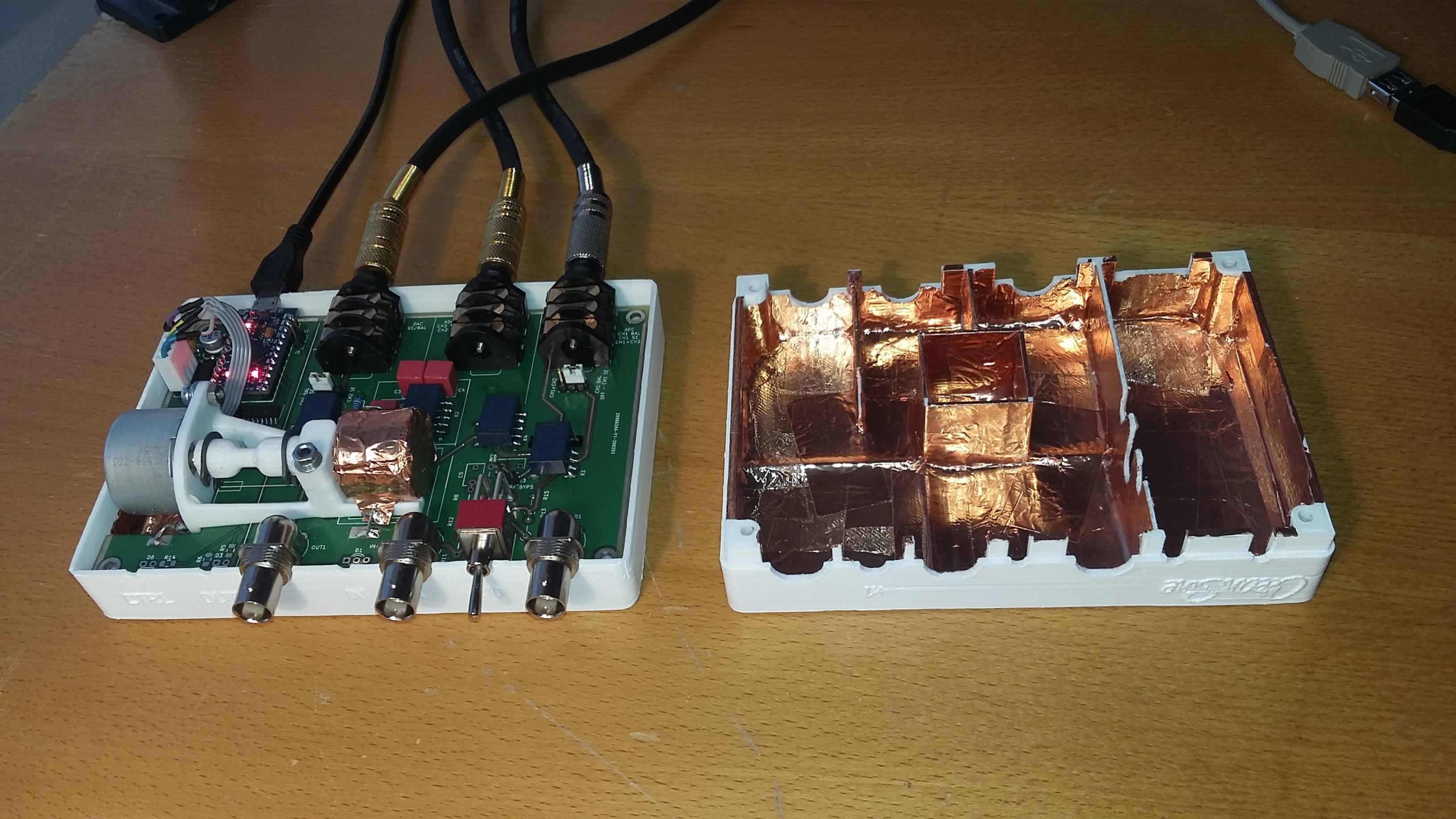

Now the PCB can be sent to manufacturing. Meanwhile the assembly mounted onto the existing adapter can be used for writing the stepper support into the compensation software. Things just take time... 🙂

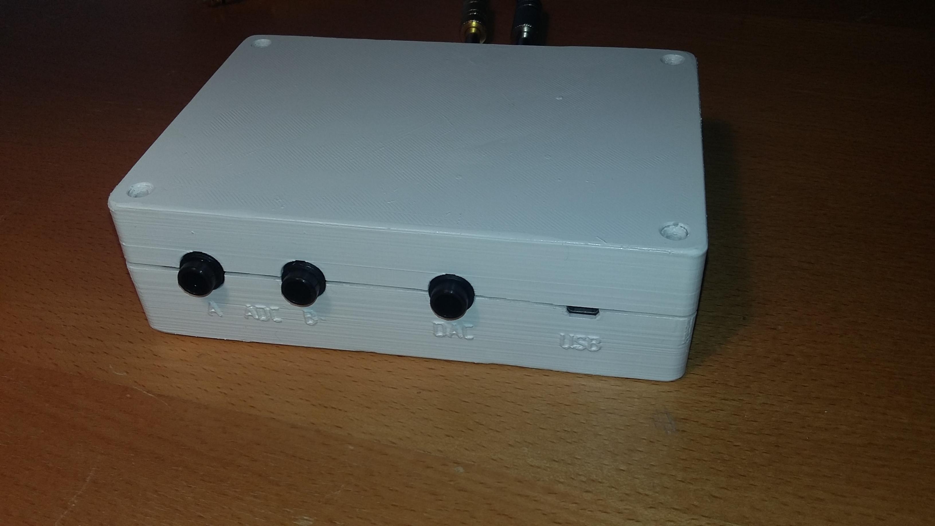

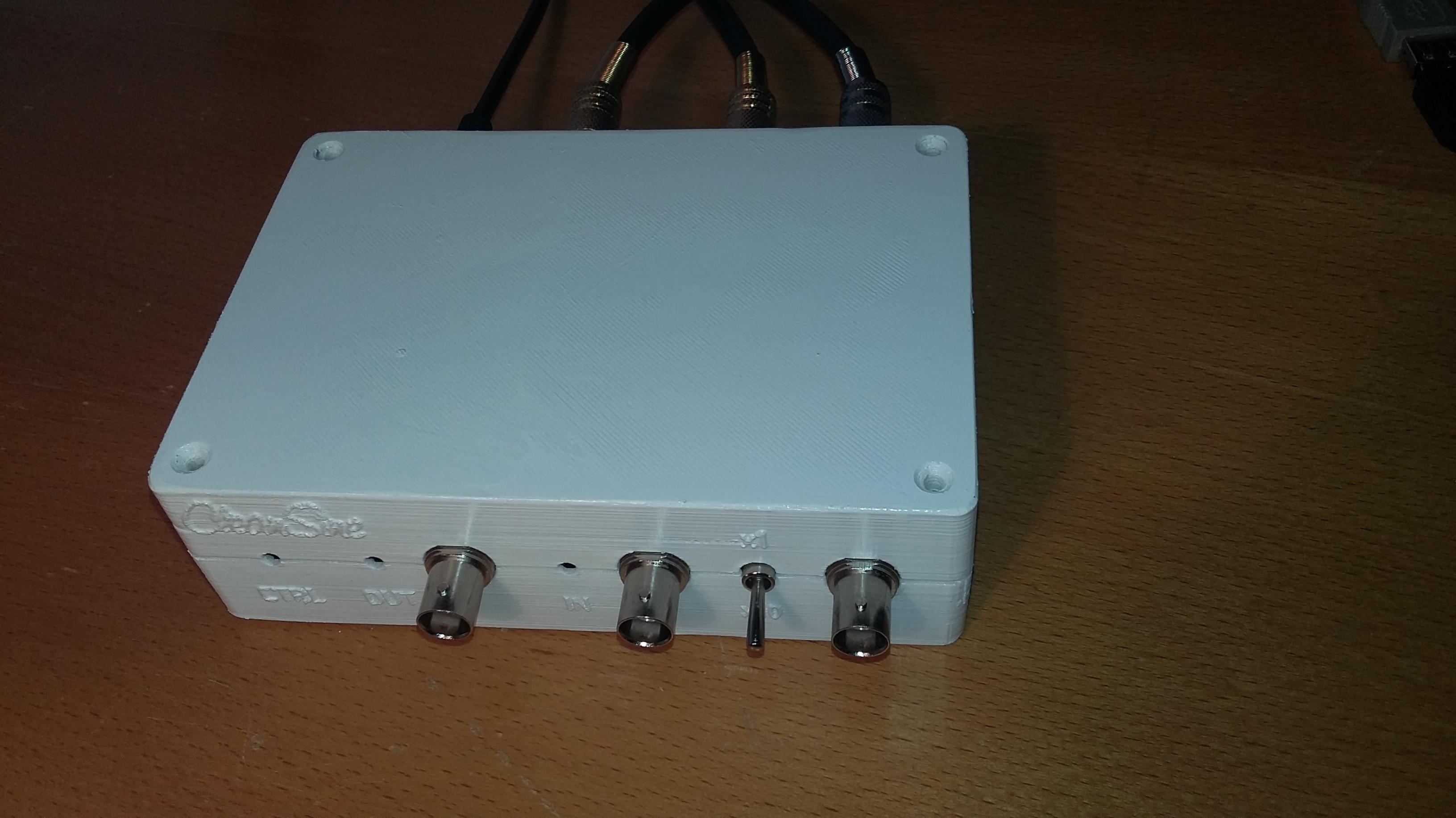

First make of the automated adapter tested and measured. LEDs indicators are still missing, just like input attenuator resistors and the input filter against high-frequency noise (more on that later). Dual LPF filters for (switched at 5kHz) are in place.
Digital (USB ground) and analog (soundcard ground) sections have separate shield compartments.
Taping the copper shield was a boring work, ingredient for the conducting paint are waiting in a box, if I do not decide to shell out the 80 bucks for a 1kg can of non-oxidising nickel conducting paint for plastic. The PCB has no solder mask around the edges on both sides, connecting thus the top/bottom enclosure shields to their corresponding grounds.
The stepper-pot assembly is printed as single piece now to maintain the axis colinear as the stepper running from 5V USB is not particularly strong. ULN2003LVDR low-loss drivers for the stepper feed over 1V more than regular ULN2003 which makes a difference with 5V. In future makes I want to test DRV777s waiting in the box.

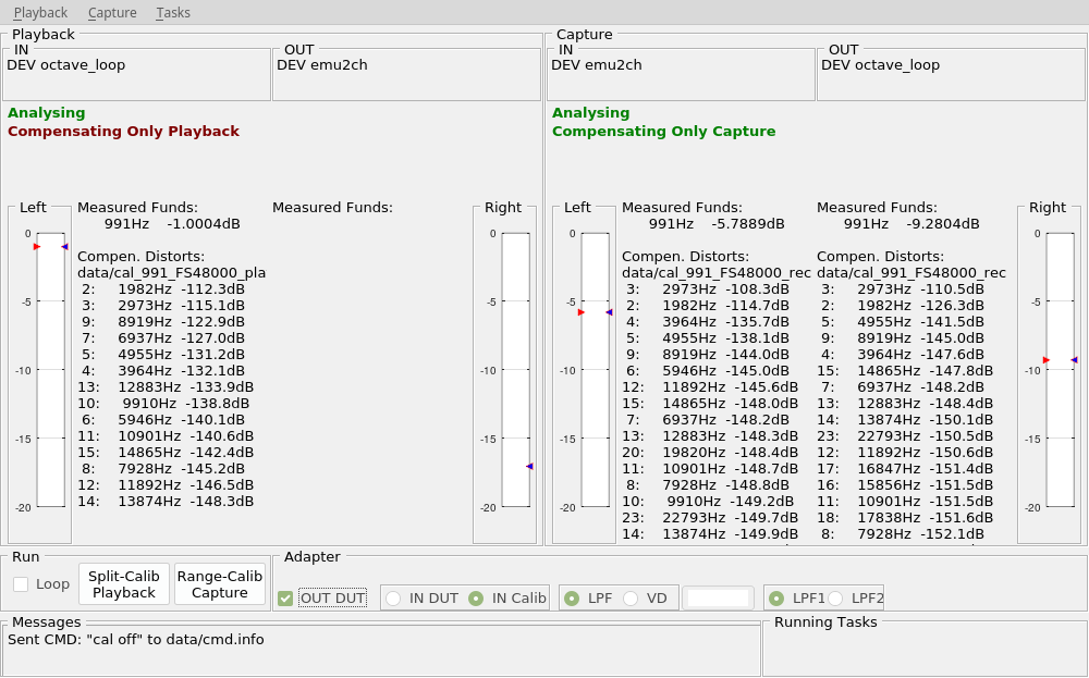

Automated stepper calibration was interesting to code, it took a few iterations to find a fast-converging algorithm stable at both ends of the range. The code estimates initial pot position and backlash using an equation for position and fitting the parameters with nonlinear regression (I have really learned to appreciate its inherent elimination of real-world measurement deficiencies - noise, random errors, etc.). Often a move of several revolutions (5k+ steps) takes just two iteration cycles (move + subsequent level measurement) to reach level within 0.002dB of the target value.
The software tool implements fully automated (relays + stepper) measurement of the VD and LPF transfers (at all harmonic freqs to the current fundamental), split-sides calibration (optionally looped for permanently calibrated/compensated harmonic generator), and range ADC calibration for the incoming level (at +0.05dB, spot on, -0.05dB below the level) to get interpolation points for slightly fluctuating incoming signal. Every task can be interrupted at any time. When no automated task is running, any relay can be operated from the UI and the stepper (VD) can be ordered to set any level (important for testing).

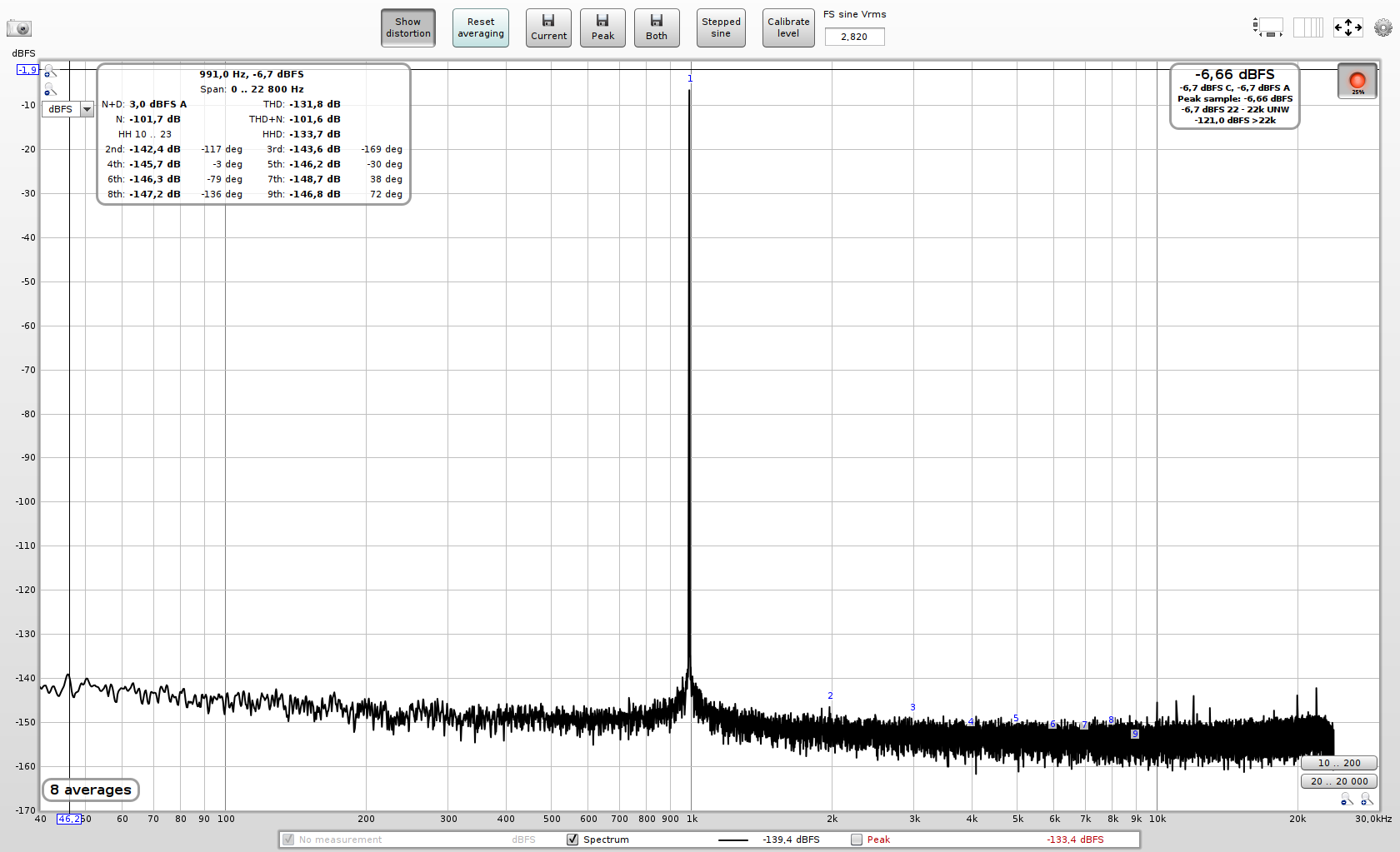

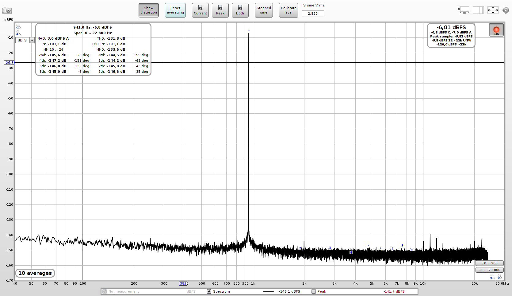

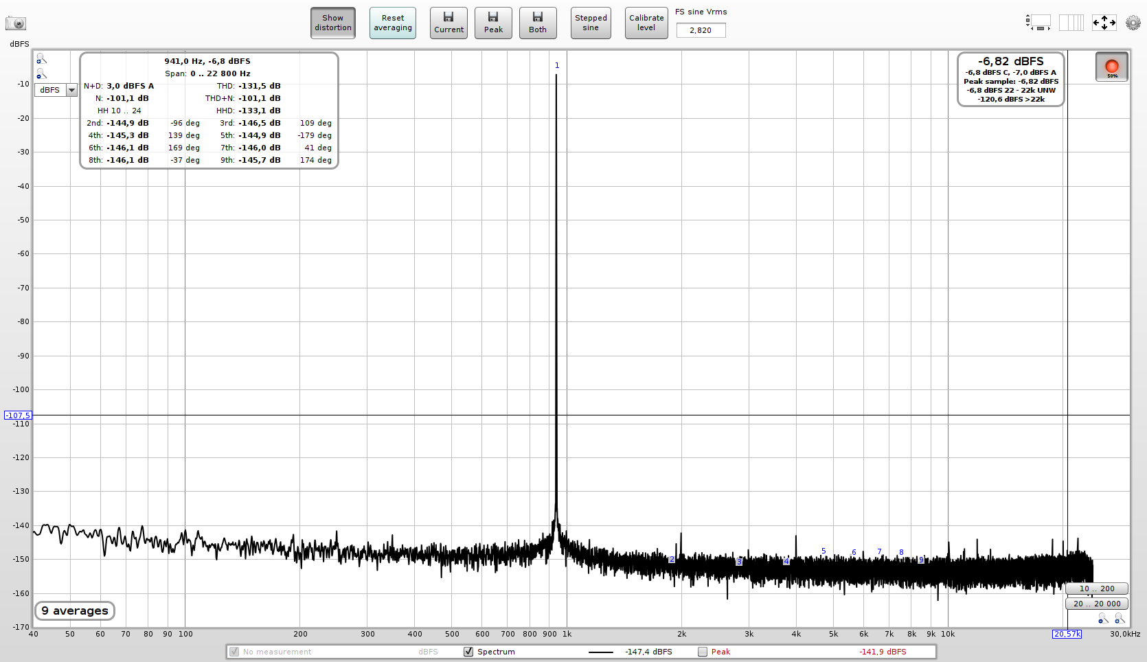

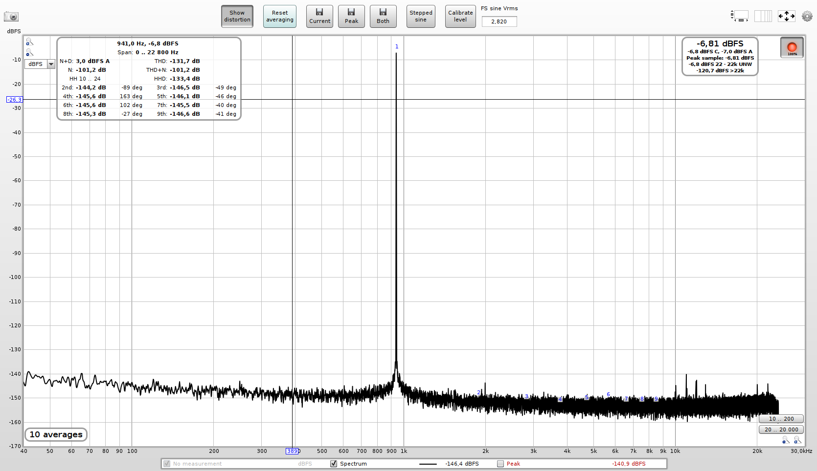

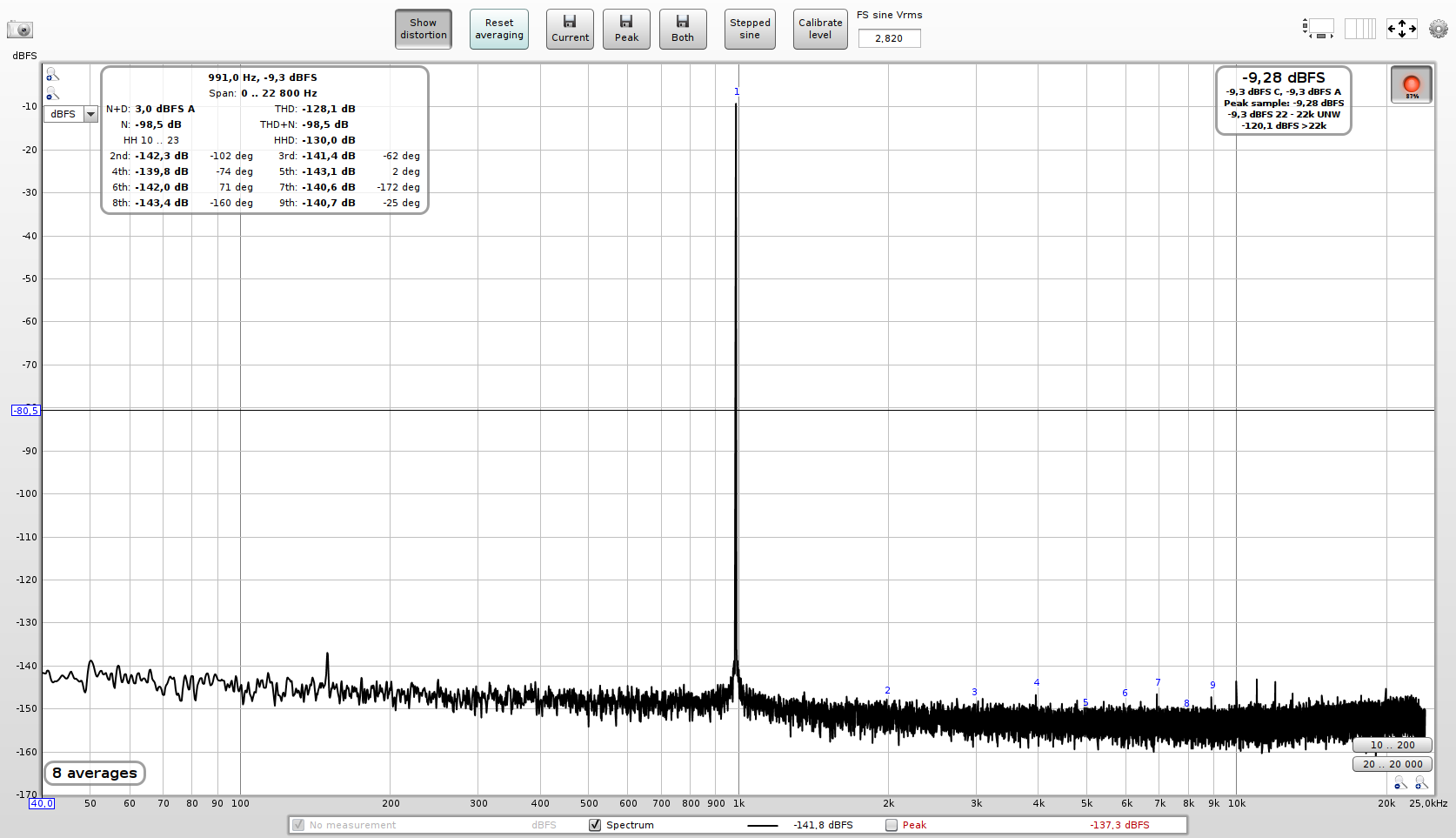

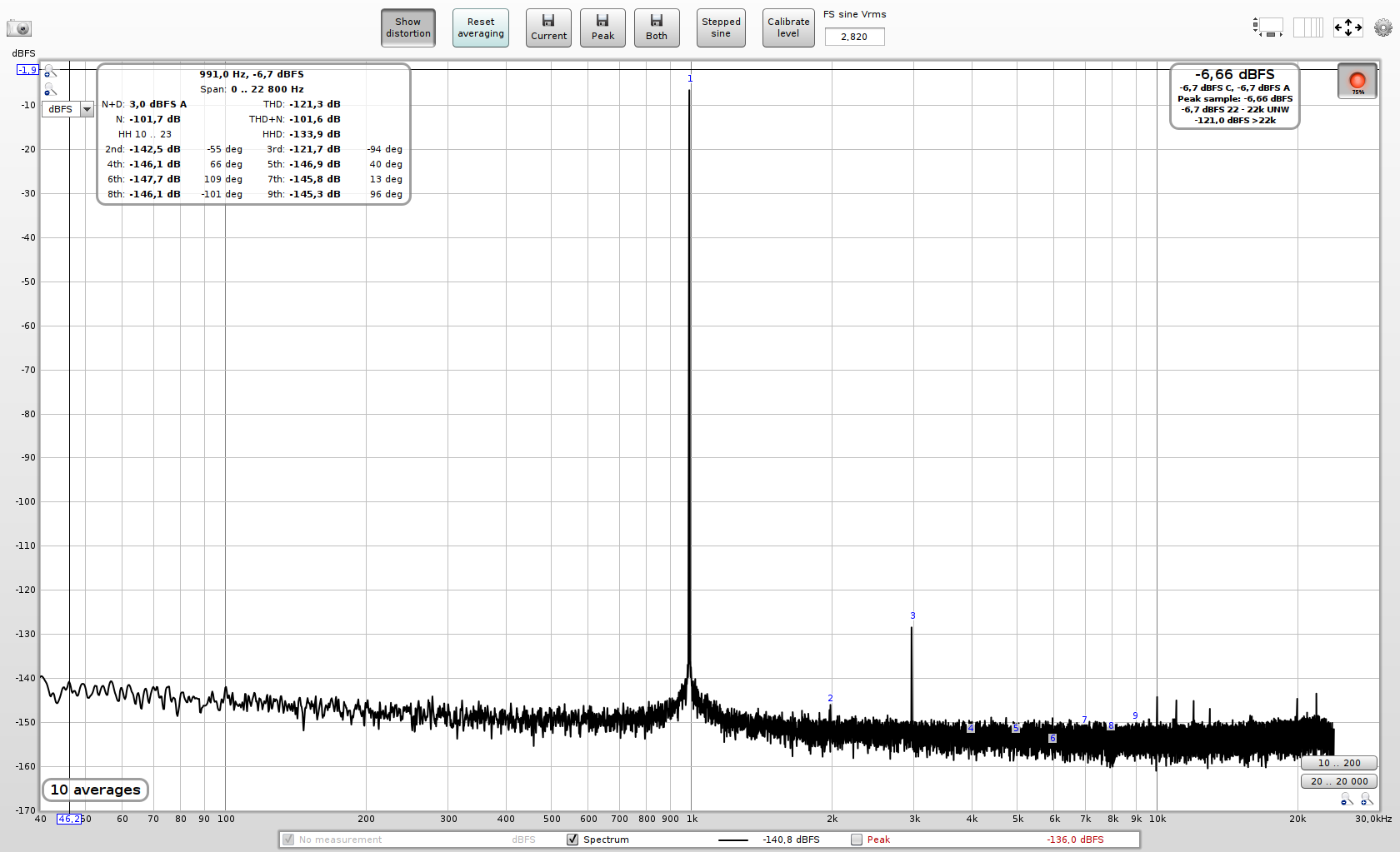

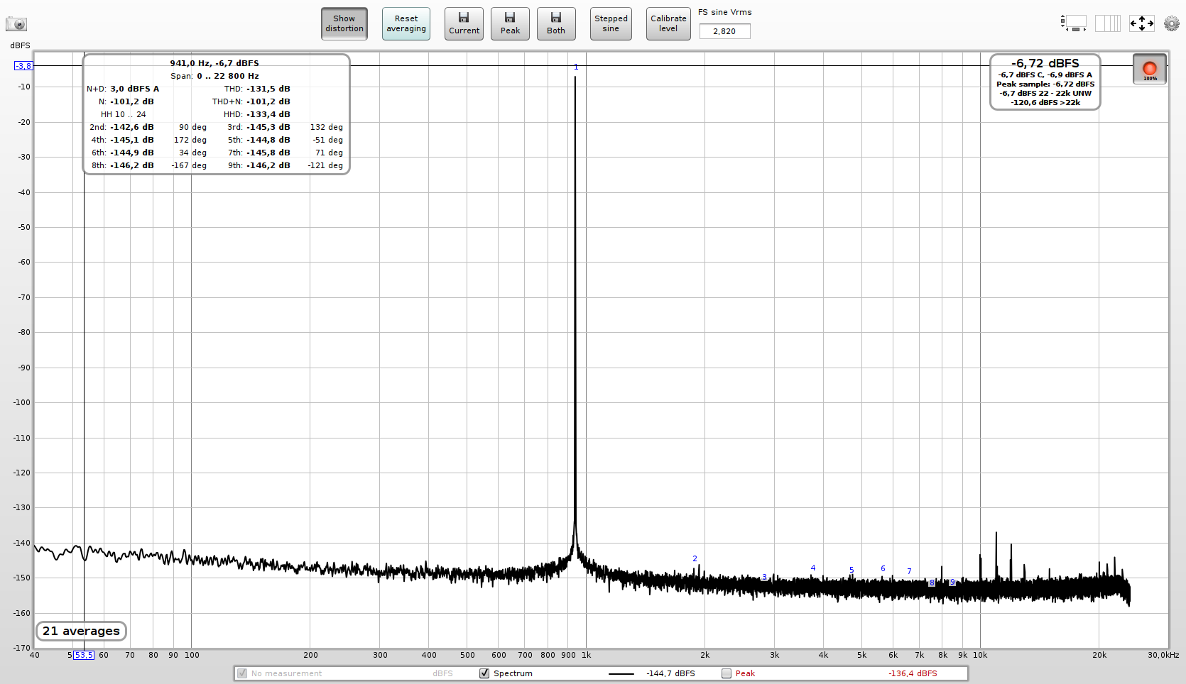

Measurement results, all 128k FFT, 48kHz

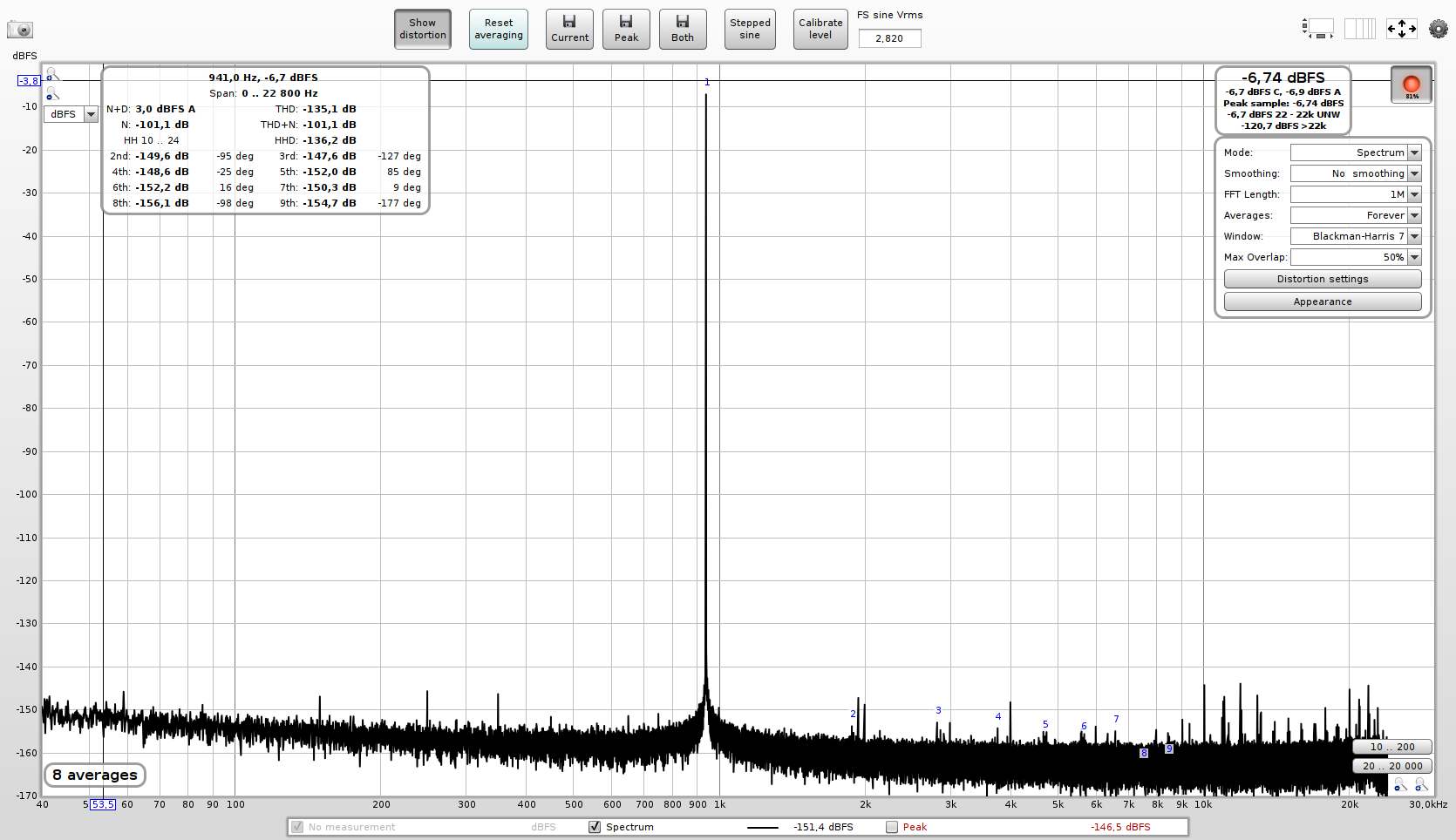

1) Split-sides compensation
Fig 1 - DAC compensated with split-sides calculation, ADC compensated at VD, switched to VD

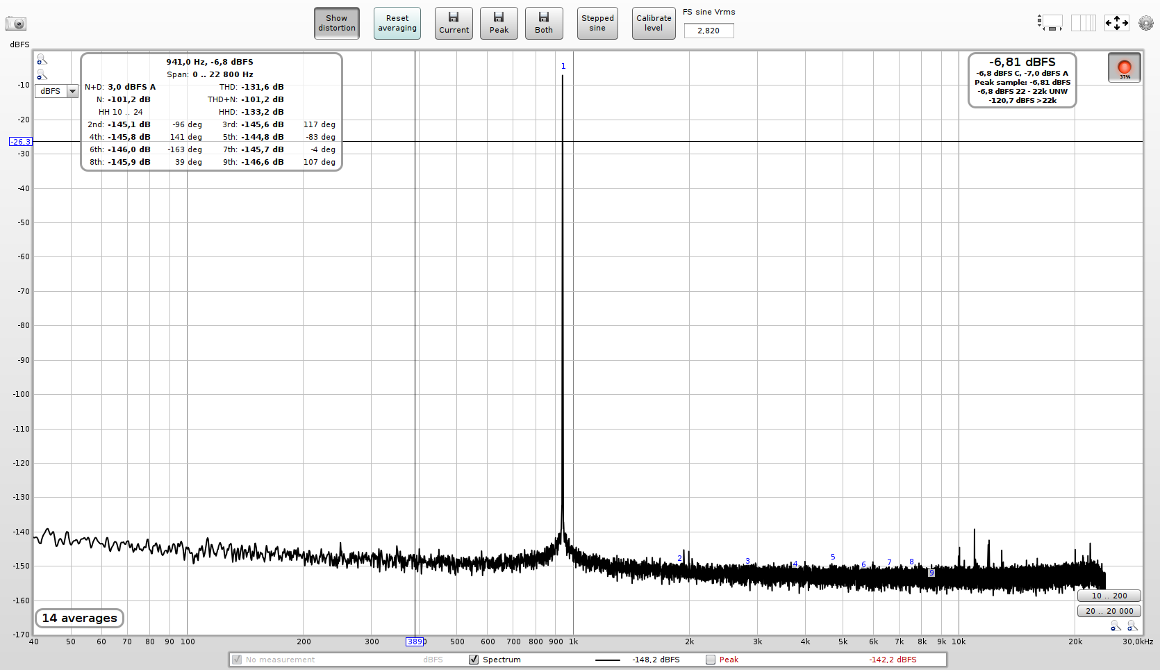

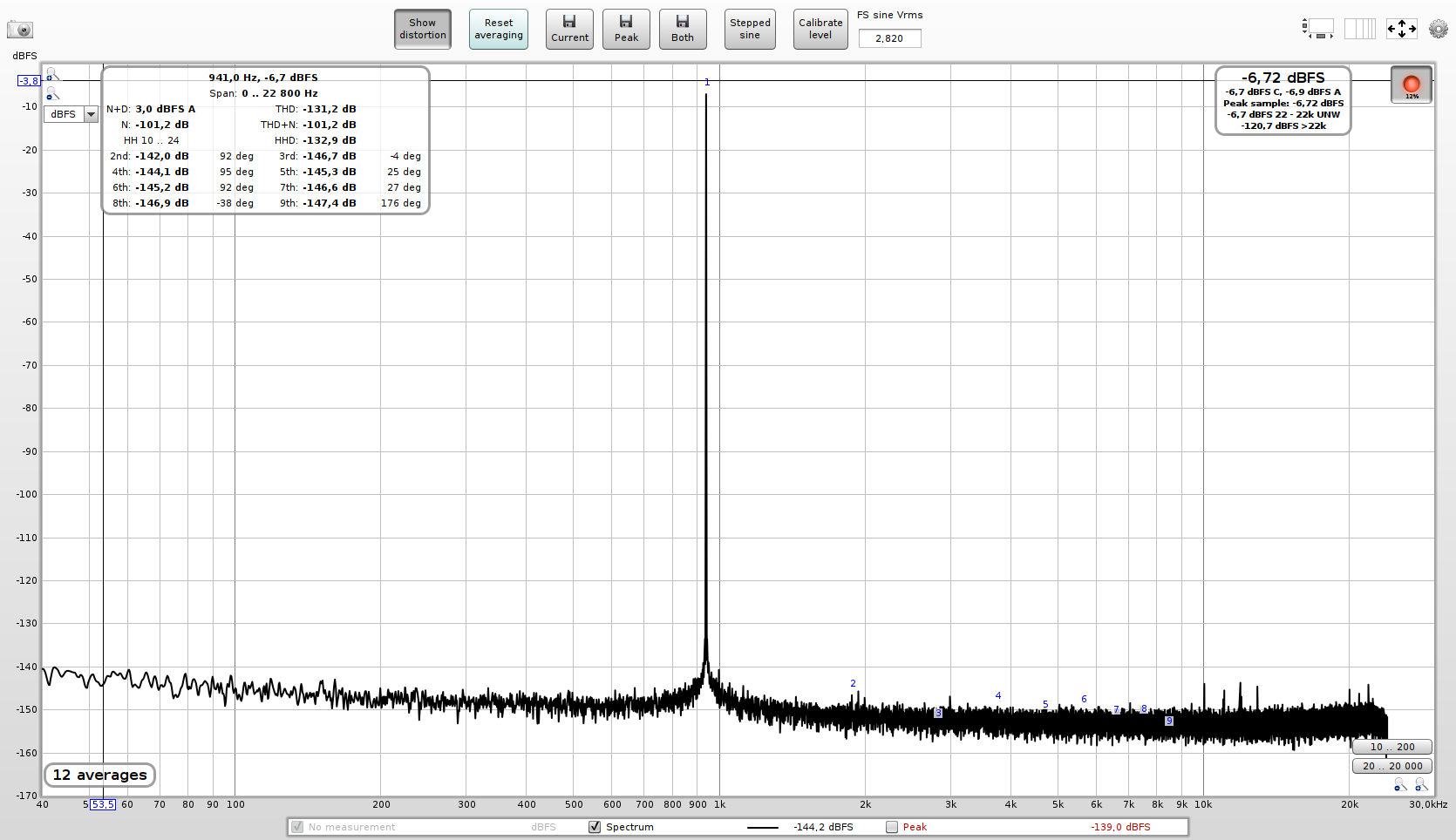

Fig2 - results upon flipping the calibration relay to LPF.
I was not sure what a PCB would do with the splitting performance. IMO the construction has not introduced any phase noise and the splitting works decently.

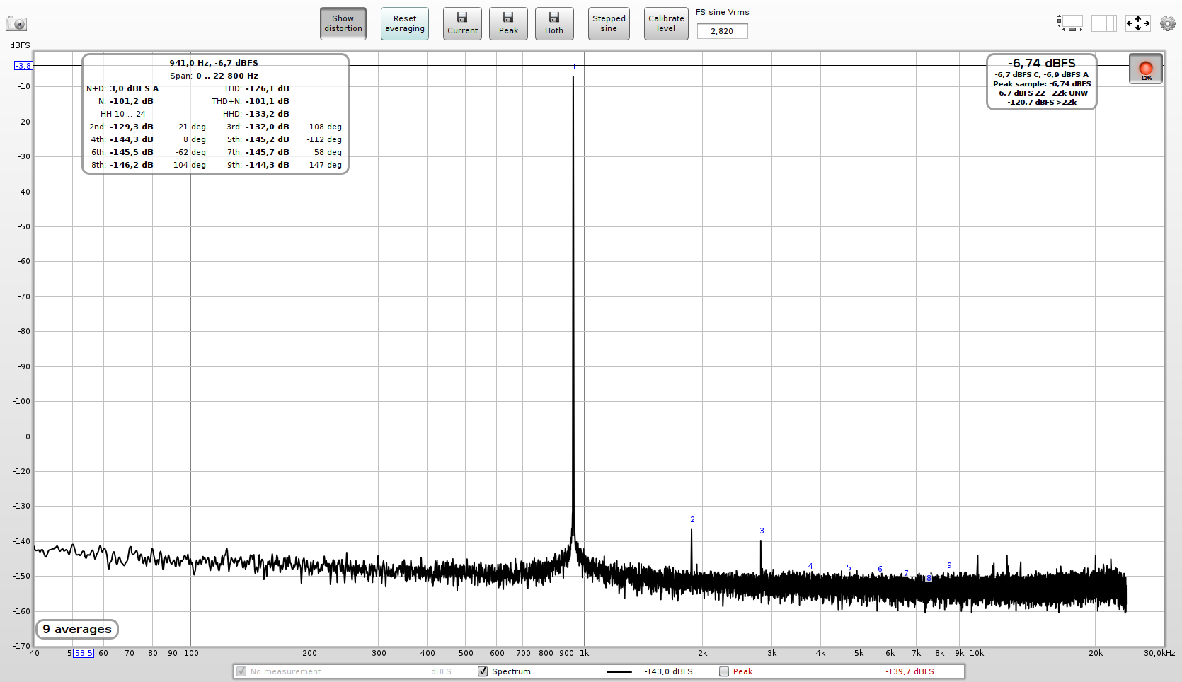

2) VD vs. DUT path distortion

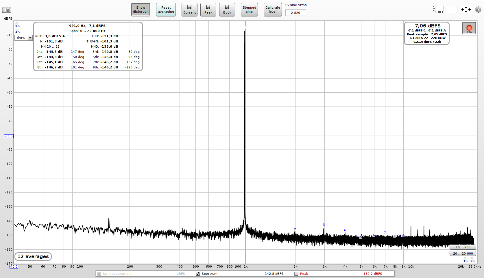

The splitting method just calculates the split. If there is a distortion in the calibration path/s, it will be included in the result. Therefore both paths must be of lowest distortion possible.
I do not have a way to measure the LPF distortion, but brand-new WIMA polyprophylene FKP2 caps are used.

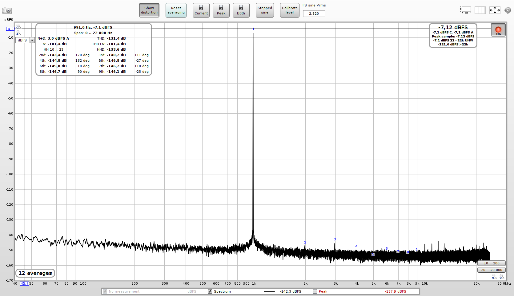

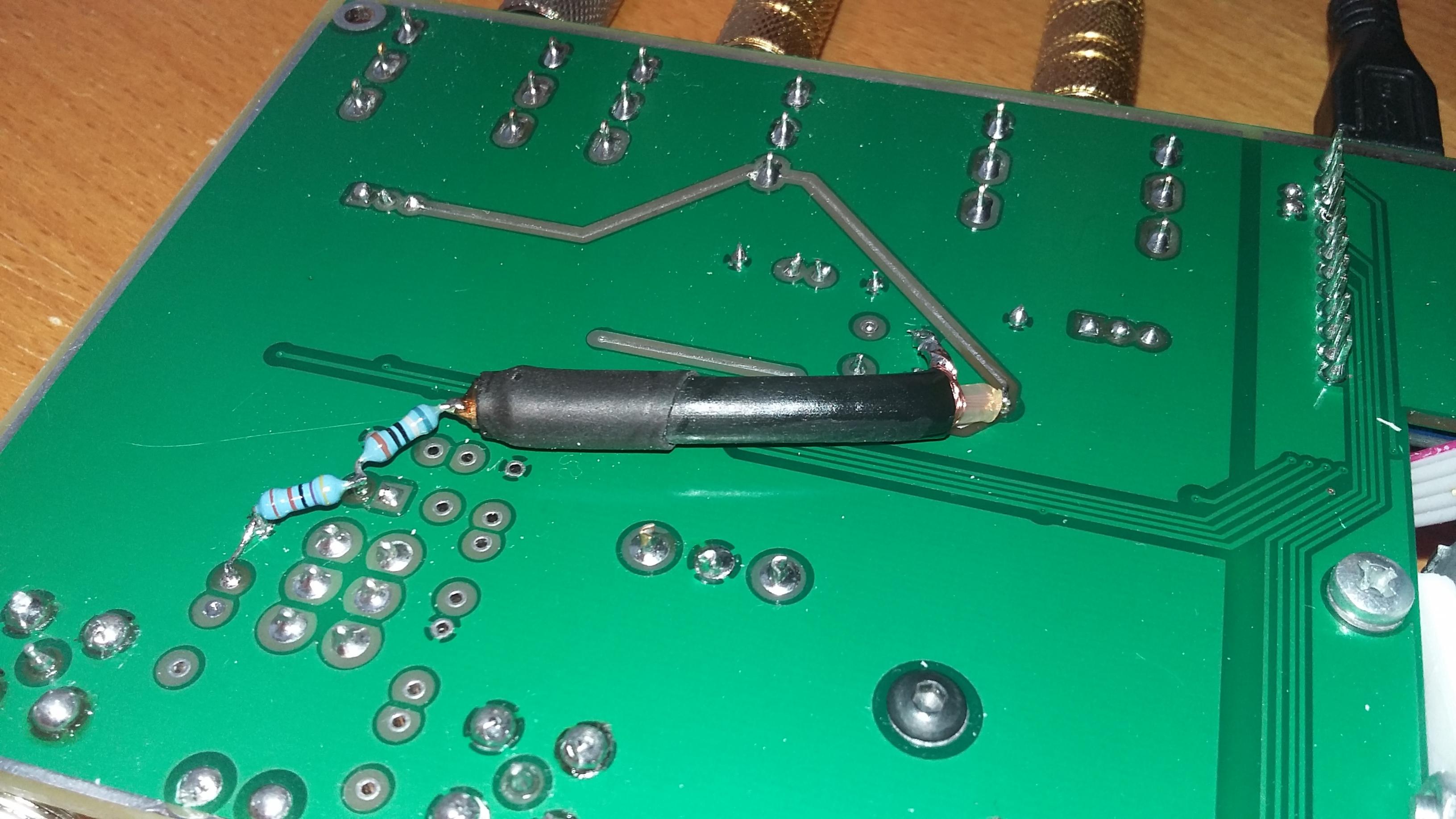

The chinese 10-turn pot was a big question. I tested the distortion with a fixed-resistor attenuator through the external DUT path (can be considered zero distortion for the -130dB THD range of this setup). The VD was set to the same level (+/-0.001dB), joint-sides calibrated, and with the calibration kept running, the path was switched to the fixed attenuator in the DUT loop. While other harmonics did not change, the third one has always crept up a lot. That was a bad sign - if the pot distorts like that, there are not many options to fix it, dead end after all the work.
I recalled PMA's test with wide-band noise increasing the 3rd harmonic. I soldered the attenuator directly to the bottom of the board, to avoid output relay contacts, the two BNCs, and the unshielded placement - fig 3.

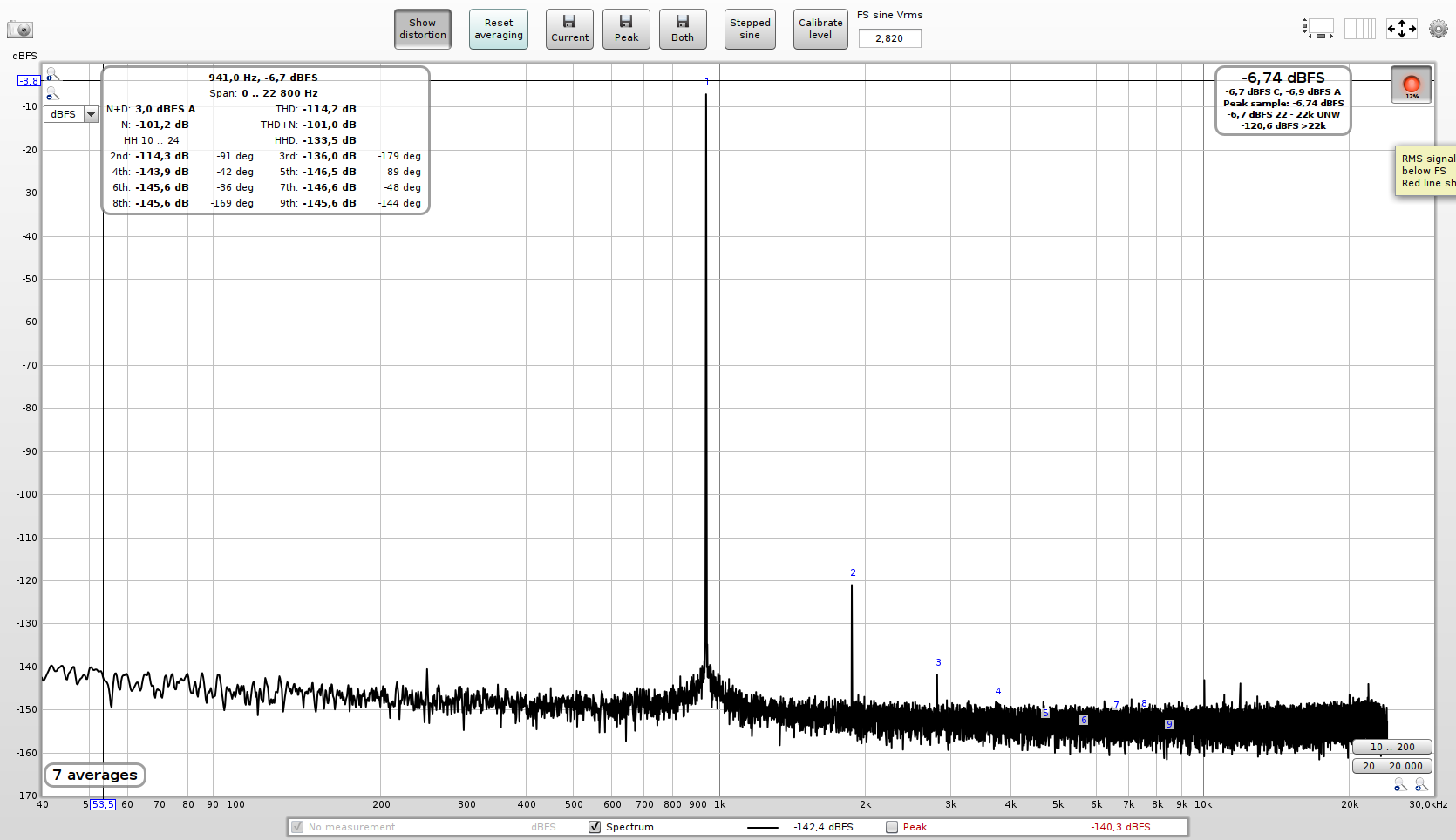

The results:

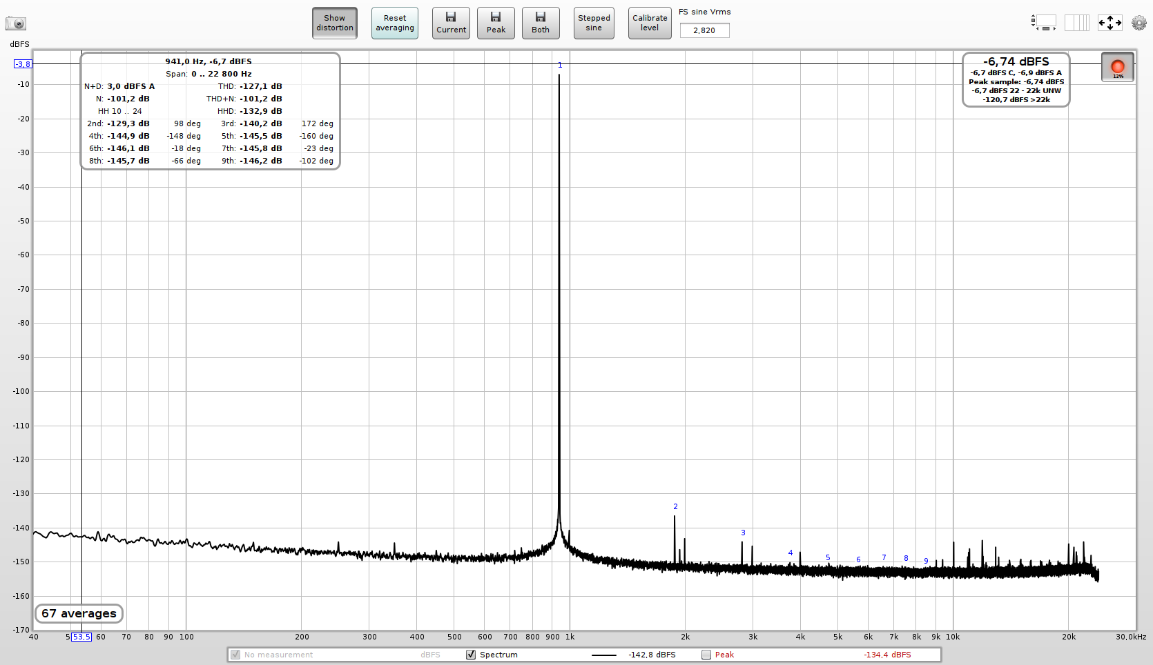

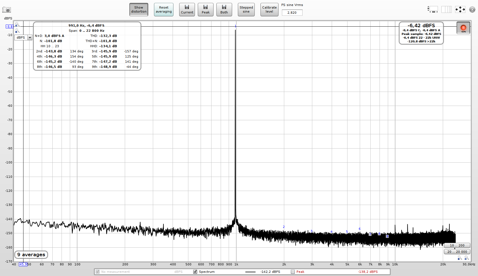

Fig 4 - joint-sides calibration through the pot - calibrated for the pot

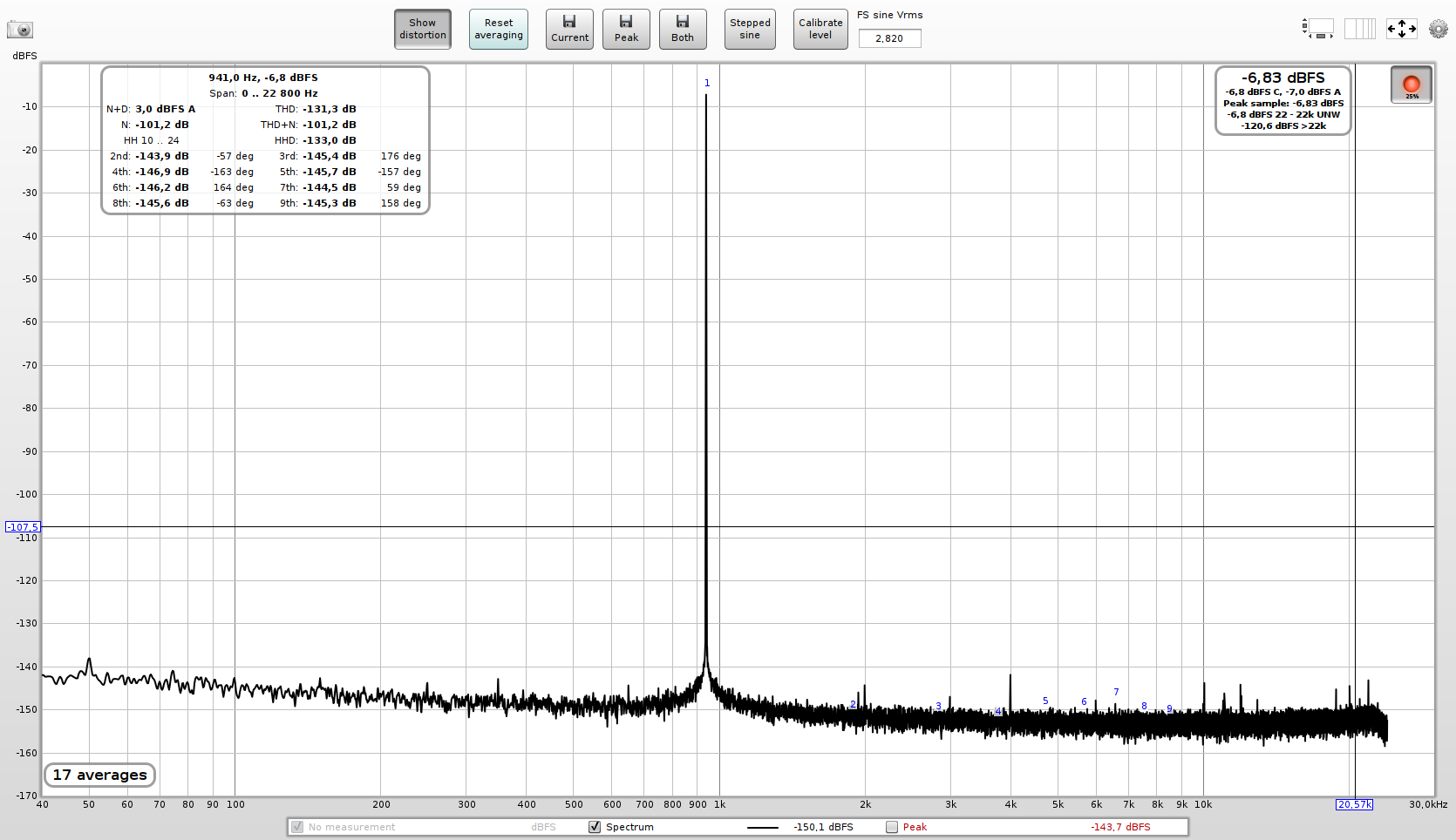

Fig 5 - switched to the shielded soldered resistor attenuator - compensation kept running.
IMO the pot-path distortion is quite low and the 3rd harmonic present in the external DUT path is really due to BNC contacts/unshielded noise. Next steps will be playing with the input BW filter for which the PCB has preparation and the BNCs which are quite loose (bought locally, quality worse than much cheaper ebay BNCs waiting in the box)

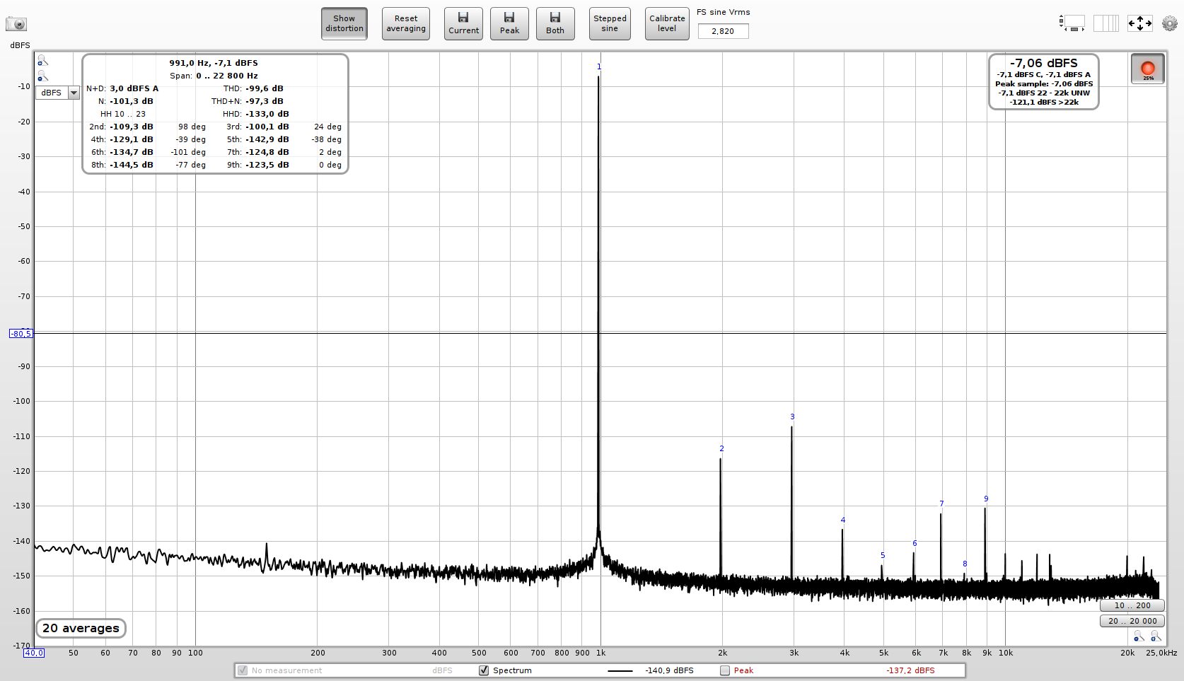

The last figure is base (no compensation) performance of the adapter/soundcard, for comparison.

The results:

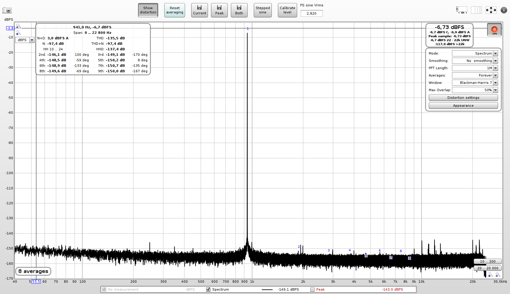

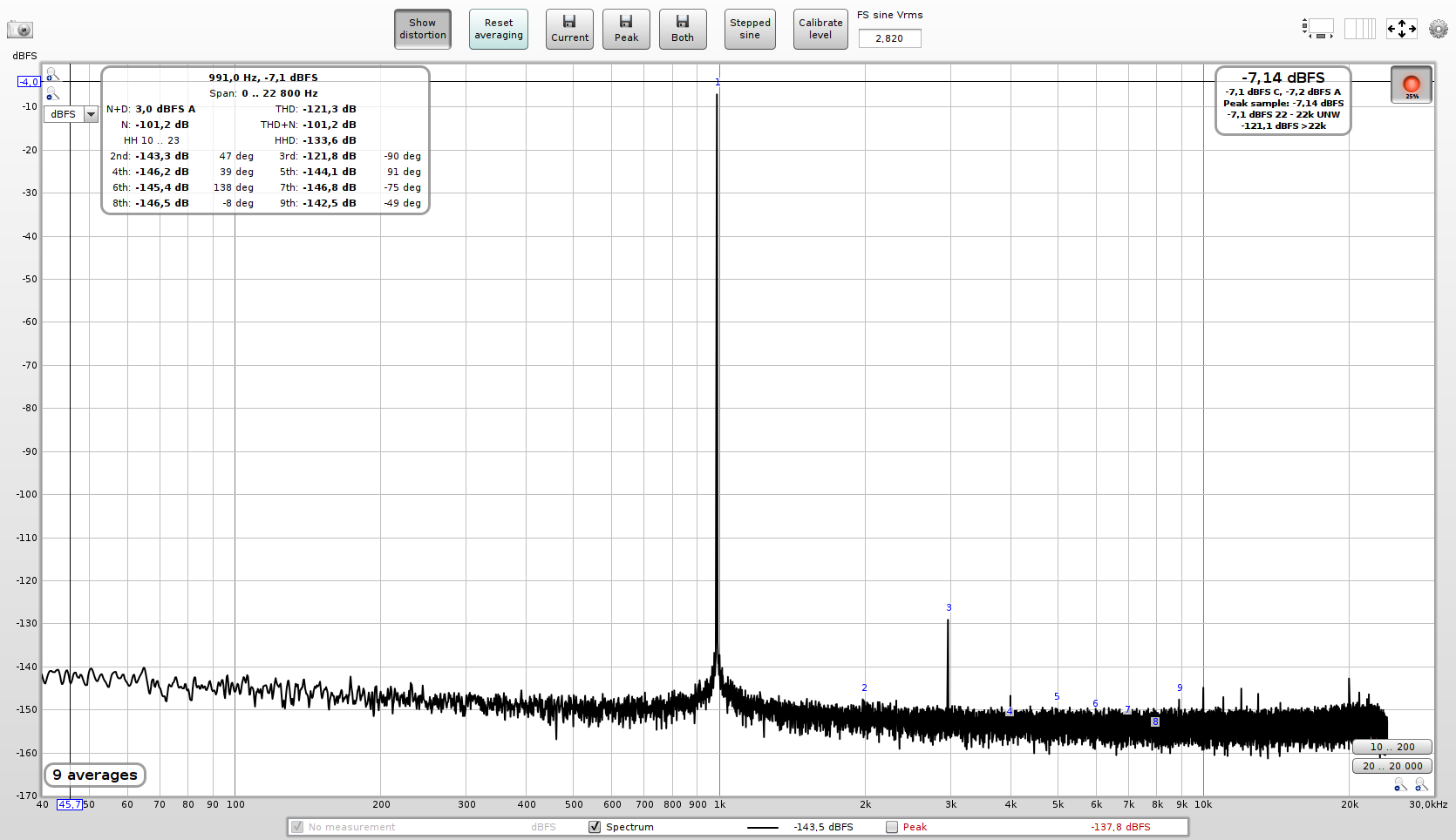

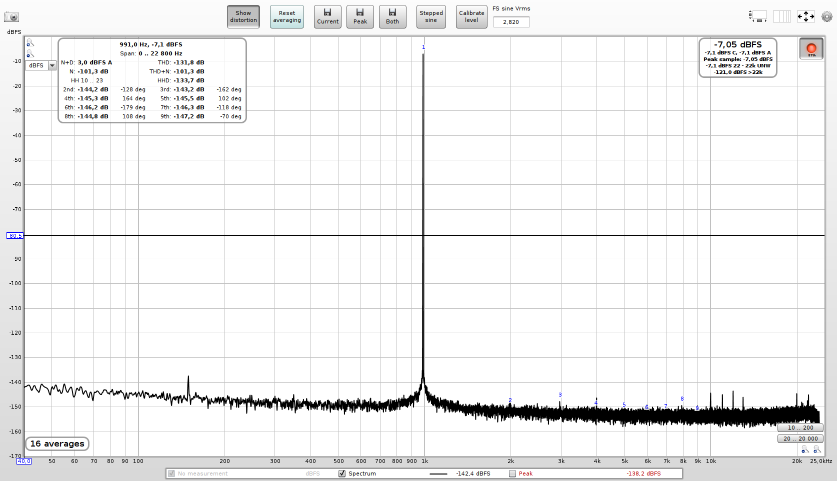

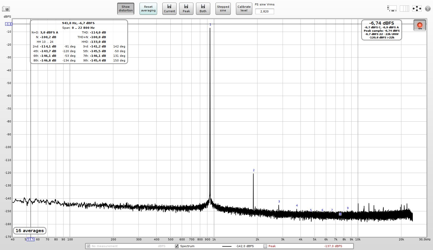

The 3rd harmonic of the Hi-Z (1M) E-MU input changes significantly with source impedance.
Practical example:
The VD pot is 5k. When the DUT path contains attenuator with the same overall resistance of 5k, the compensation works perfectly for calibration path and DUT path
Screenshot 1 - calibration VD path (5k pot) at the same level as DUT path
Screenshot 2 - DUT path - divider 270R + 4k7 - the distortion has not changed
All the following screenshots are for VD-calibration at the corresponding DUT level, that means they describe difference in ADC distortion between source impedance of the pot and that of the DUT divider
Screenshot 3 - divider 680R + 4k7 (slightly more than 5k) - H3 starts rising
Screenshot 4 - divider 390R + 2k7 (60% of VD impedance) - H3 grows a lot
Screenshot 5 - divider 150R + 1k8 (40% of VD impedance) - H3 grows really ugly
Not only is this damaging the ADC-side compensation, but also the calculation of DAC/ADC contributions. VD source impedance and LPF output impedances are different and cannot be easyly aligned without another stepper/pot. That means that ADC distortion profiles for VD path and LPF path are not equal which breaks the necessary condition of the splitting calculation.
OK, how about separating the Hi-Z soundcard input with a unit-gain buffer. OPA1656 in inverting mode takes just two extra resistors (gain 1) + two filtration electrolytes for the +/-12V supply. The buffer easily fits into the adapter enclosure between the last relay and the output socket.
Interestingly, the harmonics structure of the loopback distortion changed quite significantly with the added buffer. I think it is again caused by the changed source impedance seen by the ADC. Since the buffer is in the calibration path, any distortion does not matter, it can be compensated out, of course provided it is not changing.
The result:
Screenshot 6 - VD path compensated, calibrated for VD - that can only be clean
Screenshot 7 - divider 270R + 2k7 - basically no change in distortion profile - compare to screenshot 4 with basically same DUT impedance, but without the buffer.
I think the problem is resolved. OPA1656 buffer is not influenced by the source impedance, while providing constant (very low) source impedance for the actual soundcard input.
Unfortunately the buffer requires a power supply but there are multiple options (supply from the soundcard, from the DAC/ADC frontend which the adapter could be part of, small Lion batteries charged via the USB when not in operation, extra PSU etc.). This is a fun part, once the uncertain stuff works 🙂
The cheap chinese 10-turn pot has basically zero distortion, compared to the hard-soldered voltage divider. Only one relay switch is in both paths (calibration/DUT to the soundcard input). That is an important result too.
BTW it is interesting that the transformer-based power supply creates a minor capacitive ground loop with the switched adapter of the soundcard, causing < -140dB peaks at 1kHz multiples, probably something to do with USB frame frequency. Exactly for this reason do I not use the measurement frequency of 1kHz multiples - 941Hz was used to set the harmonics well apart from the non-related spurious.
The result:

Path 1: soundcard output -> adapter TRS -> 10-turn 5k pot -> relay calib/DUT -> OPA1656 -> adapter TRS -> soundcard input. The distortion was joint-sides calibrated/compensated for this path - screenshot 1
Path 2: soundcard output -> adapter TRS -> output relay -> BNC OUT -> external 3k resistor divider -> BNC IN -> white (Ag-plated) toggle switch from chinese ebay -> relay calib/DUT -> OPA1656 -> adapter TRS -> soundcard input. The distortion compensation was calibrated for path 1) - screenshot 2
Clearly the pot path has identical distortion to the relays + BNCs with properly soldered coax and selected for tightness + cheap chinese toggle switch. IME these low THD measurements (all harmonics below -140dBc) are extremely sensitive and every imperfection raises its corresponding harmonics considerably, no room for hiding. IMO the chances of the two paths having larger but absolutely identical distortions (amplitude and phase for all harmonics) in order to achieve the measured no difference are basically zero. Therefore for me the only plausible explanation for the calibration of one path being valid for the second path is that both paths have distortions below measurement error.
Screenshot 3 is external DUT (path 2) with compensation kept running when writing this post - for 20 minutes no change in the harmonics (<-140dBc) of the whole loopback.
Upon replacing a loose BNC connector and again soldering with special solder paste the almost unsolderable BNCs from another local distributor the initial ugly distortion through the external path with a resistor divider disappeared and these paths are equal now:

I returned to measuring my set of opamps. The measurement adapter is powered by the +/-12V SLA batteries too. I removed all the components for distortion multiplier, cleaned the board thoroughly.
Non-inverting voltage follower, noninverting input to ground with 4k7 resistor, output attenuator (to give the VD pot enough room for adjustments) -1dB 1kohm.
Fig 1 - compensated loopback, this is the calibration etalon. FFT 1M
Fig 2 - OPA1656. No difference in THD, the opamp distortion is below < -135dB, below the method precision.
All other measurements are with faster FFT 128k, because at least one harmonic is already clearly above the floor.
Fig 3 - LM4562 piece 1
Fig 4 - LM4562 piece 2 - both around -128dB. Deeper FFT would should the other harmonics, for FFT 128k only the second was measurable at -130dB
Fig 5 - NE5532 - faring pretty well, -127dB. Unfortunately I have only one piece.
Fig 6 - OPA2132 piece 1
Fig 7 - OPA2132 piece 2 - these are DIP8 versions. 2 pieces of SO8 package measured identically. -126dB
Fig 8 - OP275 piece 1
Fig 9 - OP275 piece 2 - what's wrong with their H2?
