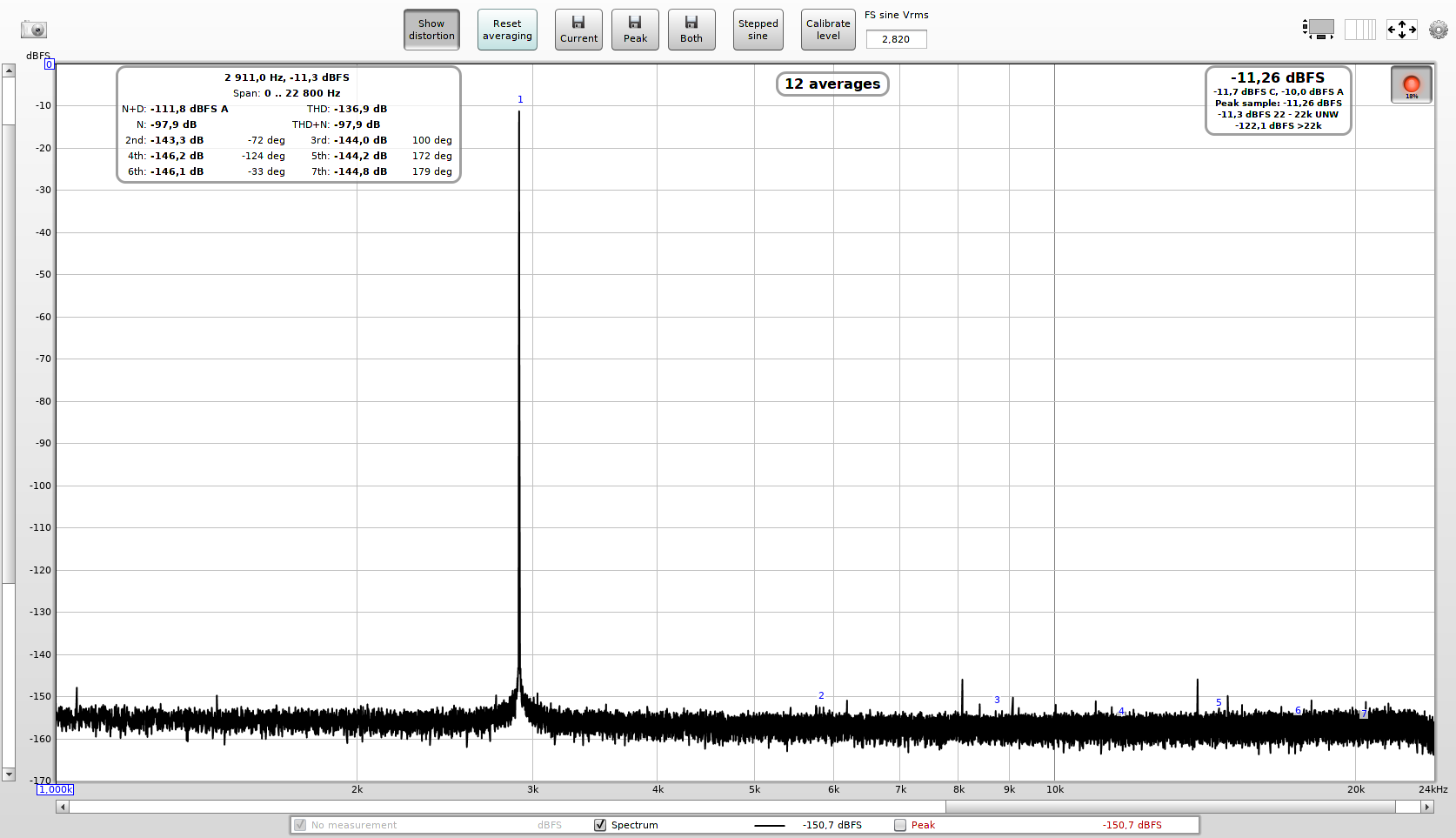

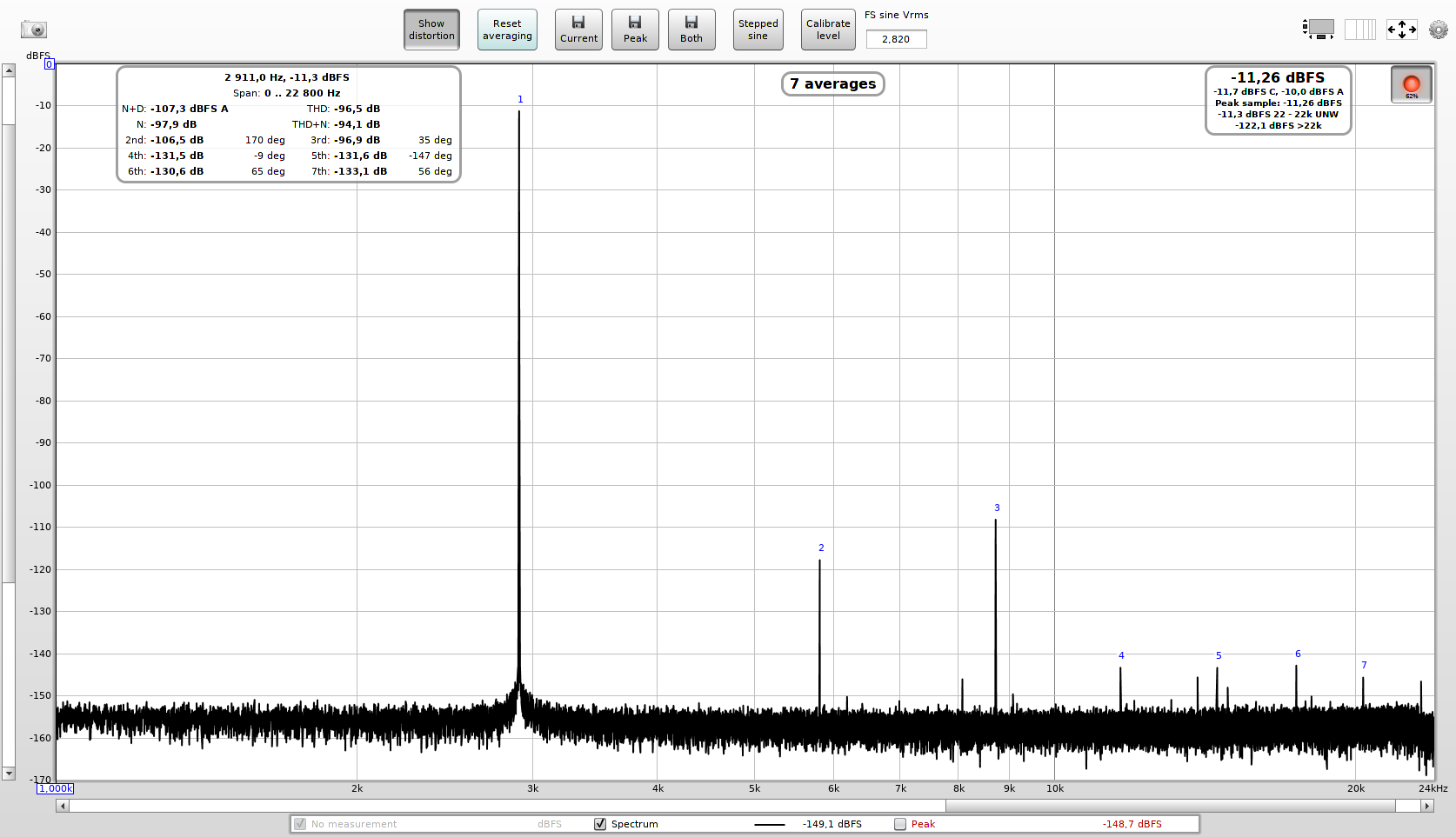

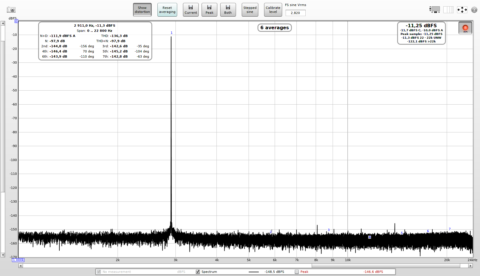

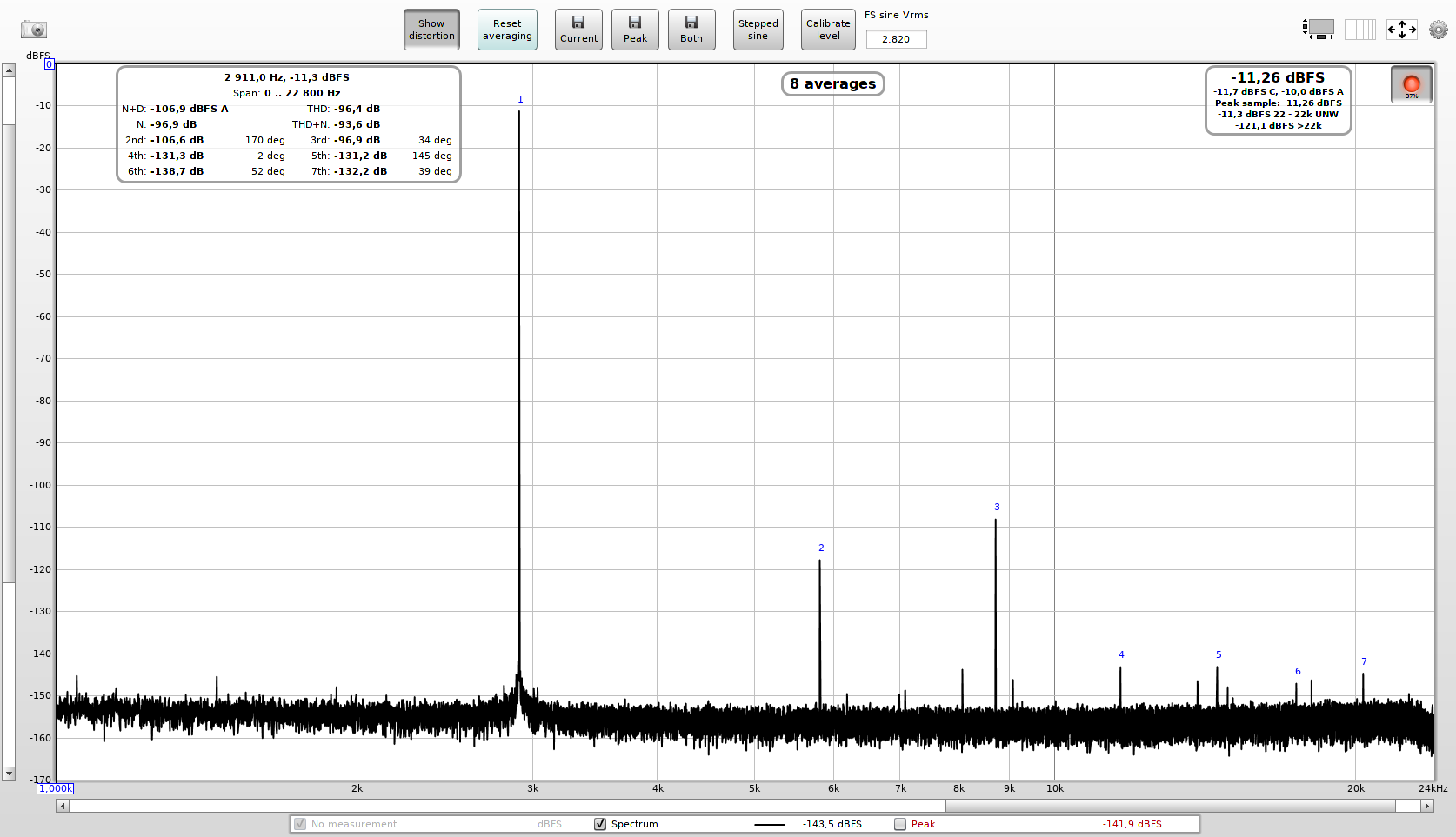

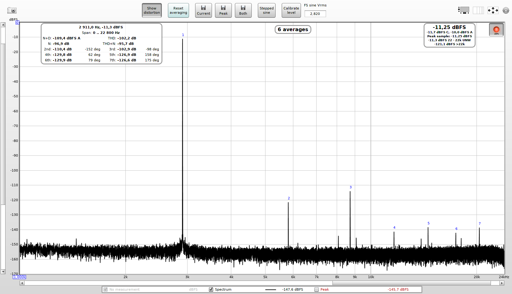

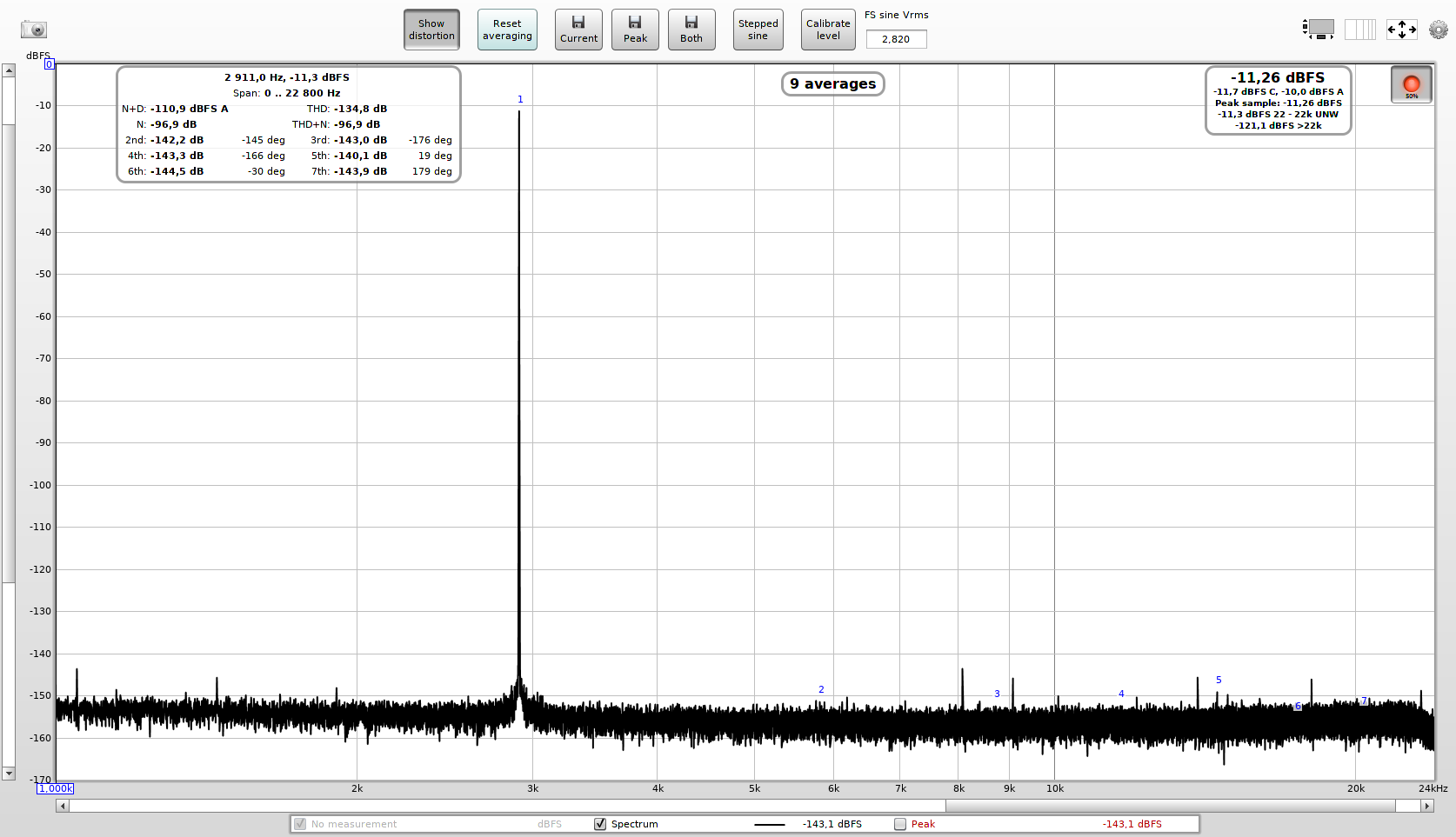

Unfortunately I have no means of precise measuring for now, but this is why I think the DAC side is clean:
1. Combined (DAC+ADC) distortions of voltage-divider path compensated on ADC side.
2. After switching to LPF, the compensation performance is gone - the LPF changes the DAC-side distortions, resulting in totally different DAC+ADC distortions than those being compensated.
3. DAC-side-only contribution compensated + the signal is passing through the voltage divider. ADC side not compensated
4. After switching to the LPF, with the DAC-side-only compensation kept running. Notice the similarity of level and phase of the harmonics on this (LPF) and the previous (VD) screenshot. Basically no change, yet radically different loopback path.
5. The remaining distortions compensated on ADC side while signal passing through the voltage divider.
6. After switching to the LPF - THD changed from -136.9dB to -134.8dB.
The screenshots are from REW. The tool sits between the measurement software and the soundcard (plus the hardware calibration adapter, of course). I develop on linux where virtual sound devices are standard part of the sound subsystem. REW/Arta/Diana all run fine in linux.

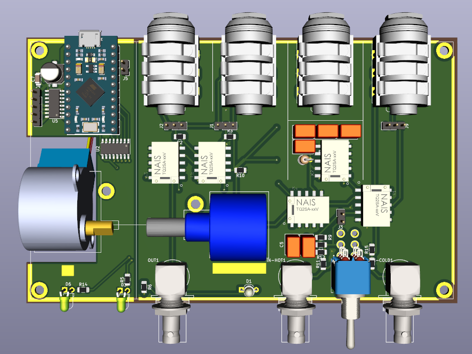

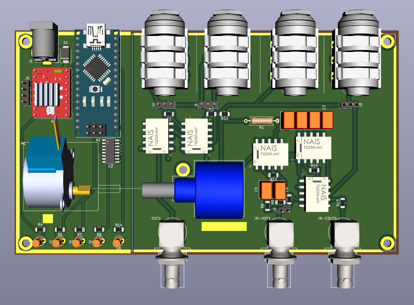

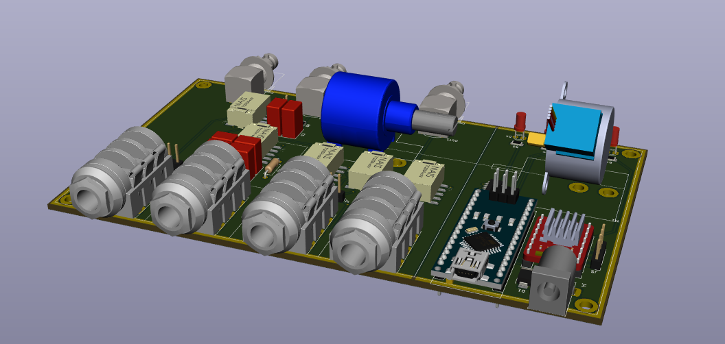

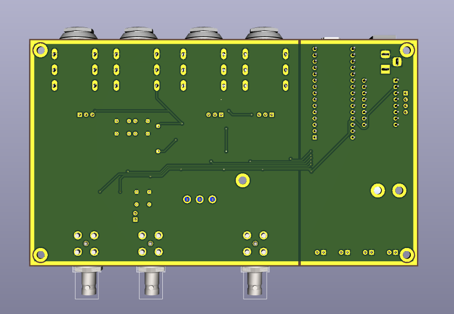

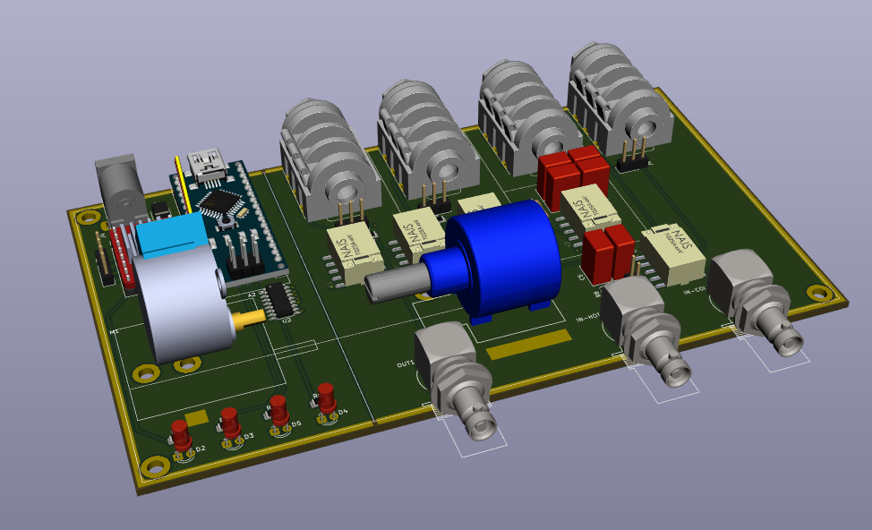

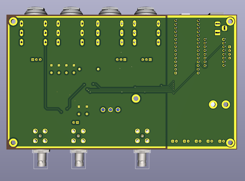

First draft of the PCB. The 3D printed enclosure will have two separately shielded sections (copper tape) - for the controller part and for the actual calibrator. The two parts are galvanically isolated (no high-voltage protection though + still need to work on larger clearances between the relay control traces and the analog ground planes). The upper part of the enclosure will further divide the calibrator into shielded sections, to separate the voltage divider from the LP filters so that phase-difference calibration is as precise as possible.
The board is ready for dual-tone generator (single-tones from separately compensated left and right channels are mixed by resistors - to be tested) and two switchable LP filters to cover larger frequency range.
Soundcard terminals: support for soundcards with single ended or balanced inputs/outputs, configurable with jumpers.
DUT terminals:
* single-ended compensated output
* balanced input (two BNCs) - hot line compensated, cold line for common-mode rejection of ground loops.
By-passable 2nd order passive filter at the hot-line input for testing impact of wideband noise on distortion.
Status LEDs:
* PWR: 12V power for the stepper
* CTRL: communication with the software is established
* OUTPUT: output terminal to DUT is active
* INPUT: input terminal from DUT is active

Hi phofman,
Very interesting project!
I would like to give a try to your software. Last git commit is from november last year. Are there significant updates not commited yet?
Still on SW side, does the the interface allow the manual calibration in a didactic way?
On hardware side, I didn't get the interest of the VD. Is it only to have the ADC in it's best working range? If not, could you please explain?
At last, one method to lower the noisefloor is to sum channels. In theory, 3 dB are gained each time a channel is added.
Do you think that alsaconf would allow synchronous summing?
Well, the VD is key part of the process. Before calibration measurements are taken, the output VD level must be very precisely aligned with output level of the LP filter so that ADC distortion profile is virtually identical for both cases. Only then can the system be described by two equations for two complex variables, solvable by nonlinear regression.

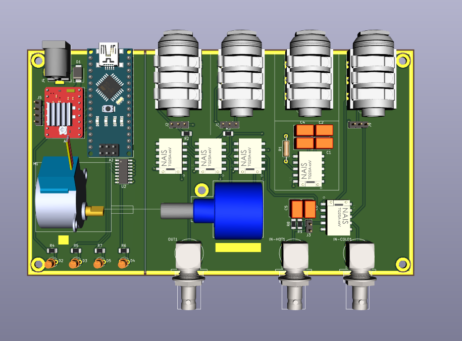

Added fully-balanced -20dB attenuator at the balanced input - it took only 4 resistors, 1 status LED, and re-arranging relays to utilize the unused halves of relays in the calibration branch (the input is never active during calibration, allowing dual-role of the calibration relays). Default (no power) operation - attenuator engaged. The attenuator will be operated by a push button in the GUI interface.

I am using inexpensive "bourns" from ebay. They are clones of the original, but the make looks quite decent, outside and inside (from what I saw when opening one)
orig. https://uk.farnell.com/bourns/3590s-2-103l/potentiometer-10k-5-linear-2w/dp/1612611 vs. clone 10K Ohm 3590S-2-103L With 10 Turn Counting Dial Rotary Potentiometer Pot Ze | eBay
I am reasoning like this - if the pot distorted significantly, the equations would not correctly describe the circuits and the split would not work for voltage-divider and LPF paths.
It is possible the original pot would yield better results though - to be tested. The same holds for the RC filter, I will use Wima FKP2 (right now using some older axial foil cap).
The input attenuator with unused relay halves was a good placement and routing exercise last night, but fetching sensitive calibration signal and DUT output (possibly tens volts amplitude) into one tiny relay package is likely not a good idea. The two sets of relay contacts are not shielded internally.
A small angle toggle switch placed between the input BNCs may do a better job and flipping the switch is faster than clicking on a button in GUI. It will not be operated automatically at clip detection, but the detection would have a large latency anyway. A proper solution would require a dedicated relay, IMO. Maybe in next versions...
Right now I am using inexpensive silver-coated switches and the compensation seems to work OK. The gold-plated ones are quite (10x) expensive.
I should build one board with all no-compromise parts to compare the results.

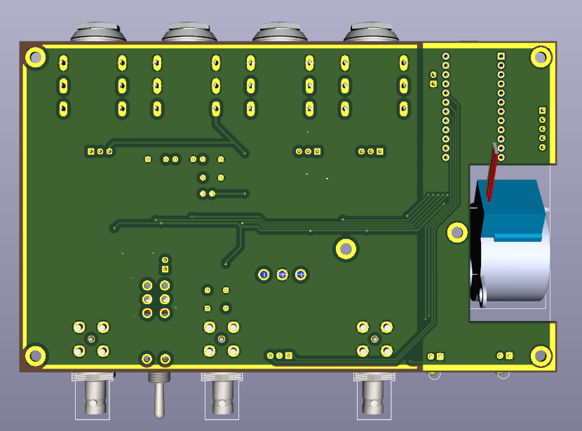

Input attenuator with simple toggle switch. LEDs are placed close to the parts they inform about:
1) CTRL - software connected
2) OUT - output BNC active
3) dual-color IN/CLIP - green - input BNC active, red - clipping on input detected, user should engage the attenuator
Using 5V geared stepper now allows powering the adapter with the USB connection only, no additional PSU needed. In addition, the inexpensive stepper is unipolar which puts less strain on power supply - no bridge fighting the induced currents is required.
The regular Arduino Nano (ATmega 328P) uses a USB-serial chip (usually CH340) which reports harcoded USB configuration parameters, including the MaxPower current. Being a simple low-consumption communication chip it requests only one unit of USB power - 100mA. Root USB ports ignore that and provide 500mA, but e.g. when plugging the adapter into a hub embedded in USB keyboard the power would not be sufficient.
It is therefore important that the adapter reports full 500mA requirement. Fortunately another Arduino variant - Leonardo - uses ATmega32u4 which features a USB receiver, configurable with the firmware. This guy reports full 500mA with its default bootloader - problem solved. At 3USD twice the price than regular Arduino, but still good deal. Plus it has a smaller footprint.
The layout is redesigned to reflect flow of the signal properly. This version (after final touches) will be sent for manufacturing.
