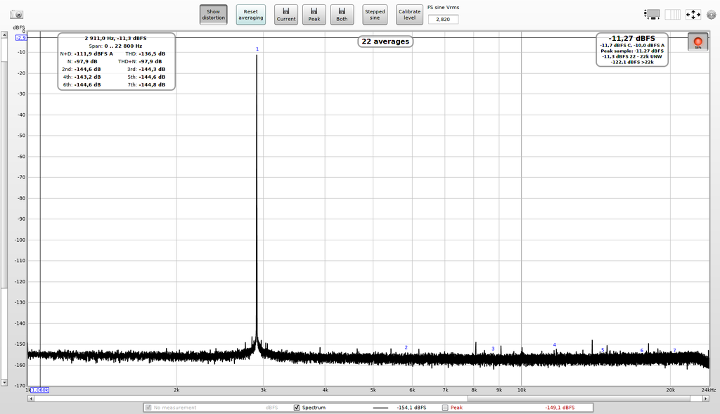

Screenshot 2 - R balanced-out -> R balanced-in. The calibration was kept running to see only the non-harmonic noise, with harmonics compensated out.

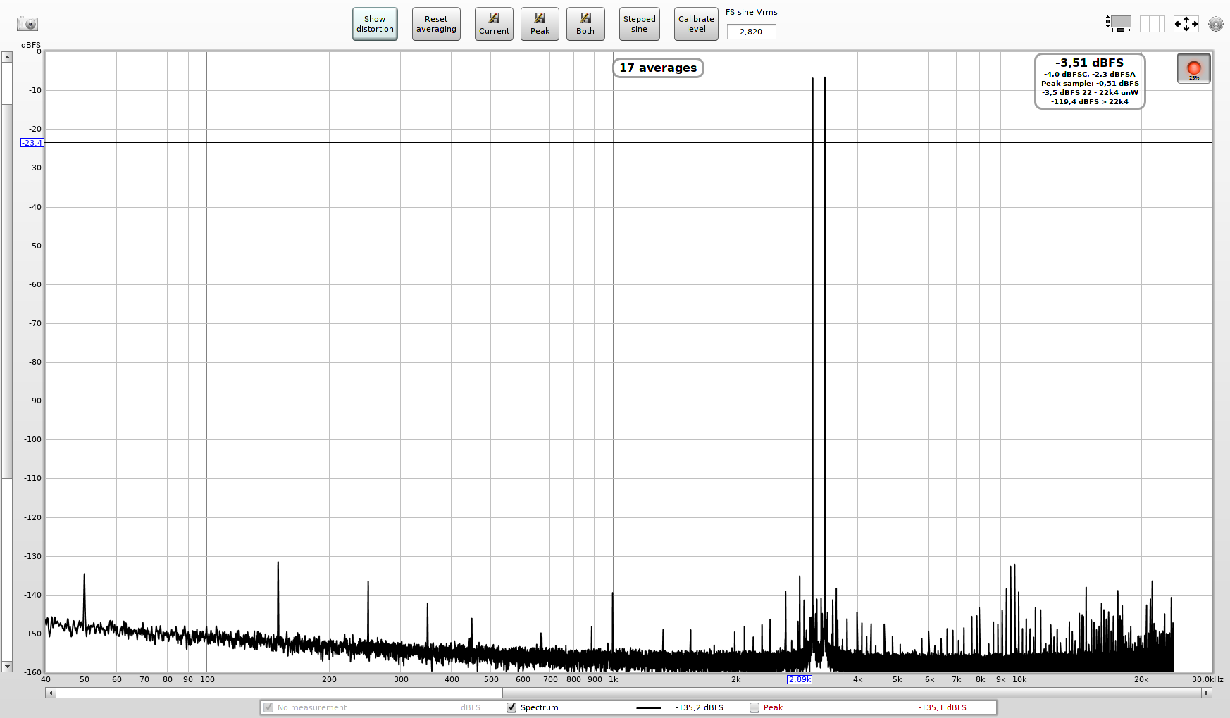

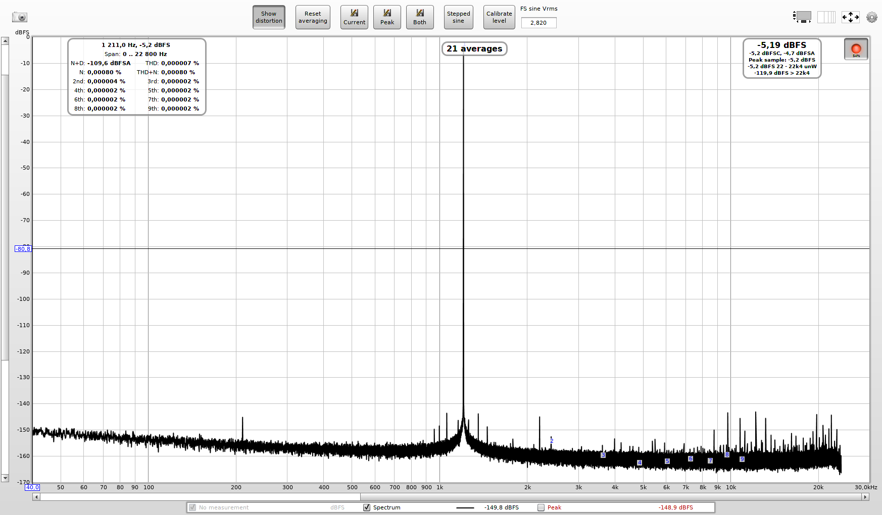

Screenshot 3 - stereo headphone output with R =signal L=zeros -> R balanced-in + running calibraton. Again, the DAC artefacts are more eliminated (with accounting for the lower level)
The next step is adding another OPA1622 on top of the existing headphones output OPA1622 module and doing the R-L subtraction directly there, creating a new output. For many measurements a clean mono SE output is sufficient.

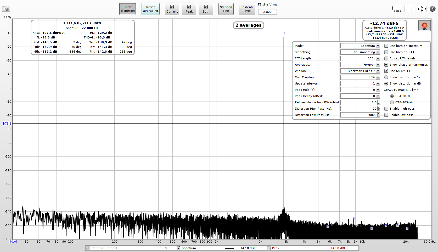

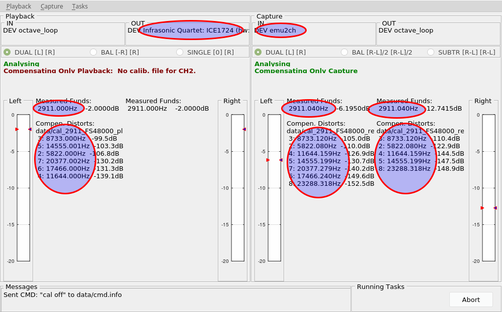

The non-integer mode in the new version of my compensation tool:
Single tone:
* non-integer fundamentals - precise to around 0.001Hz
* different fundamental frequencies on split-side compensated playback and capture sides, i.e. support for independent DAC and ADC.
Dual tone:
* non-integer fundamentals on ADC side for any two integer-Hz fundamentals generated by an independent DAC
Distortion harmonics do not change (amplitude, phase) when shifting fundamental by fractions of Hz, allowing to shift the ADC-measured frequencies to DAC originals in split-sides compensation of independent DAC/ADC.
The incoming frequency/phase/amplitude are measured several times a second. I have not tested an analog oscillator, but I believe its distortion could be measured by an ADC which was previously split-sides compensated with dependent or independent DAC generating very close frequency. The analog oscillator frequency will shift in time, but the continuous measuring should adjust for a slow drift.
I tested the new version with PCI Infrasonic Quartet as DAC and E-MU 0404 USB as ADC. E-MU's balanced inputs eliminate the common-mode ground-loop noise of the two connected soundcards hooked to the same PC (standard unbalanced - balanced connection with output ground connected to cold line of the balanced input).
Screenshots:

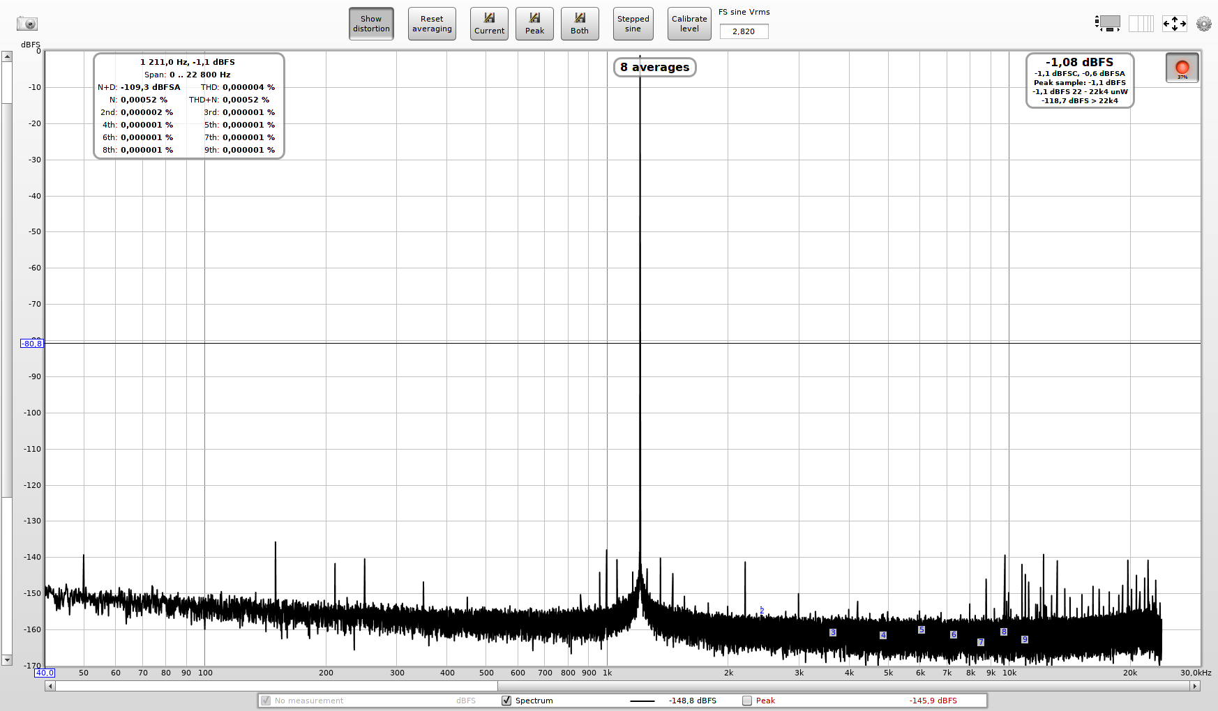

1) The tool running split-sides compensation - Quartet generating 2911Hz, E-MU measuring 2911.040Hz. DAC-side compensation harmonics are generated at integer-Hz, while compensation harmonics generated on ADC-side must correspond to the incoming frequency - non-integer values.
2) Uncompensated loop of the two soundcards, VD in loopback - both soundcards distort quite a lot.
3) Split-sides compensation, VD in loopback
4) Split-sides compensation, LPF in loopback. The performance is slightly worse than in integer mode, but FFT length must be adjusted optimally several times a second so that its bins fit the measured fundamental/s as precisely as possible.

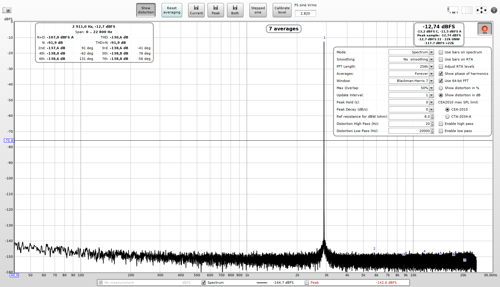

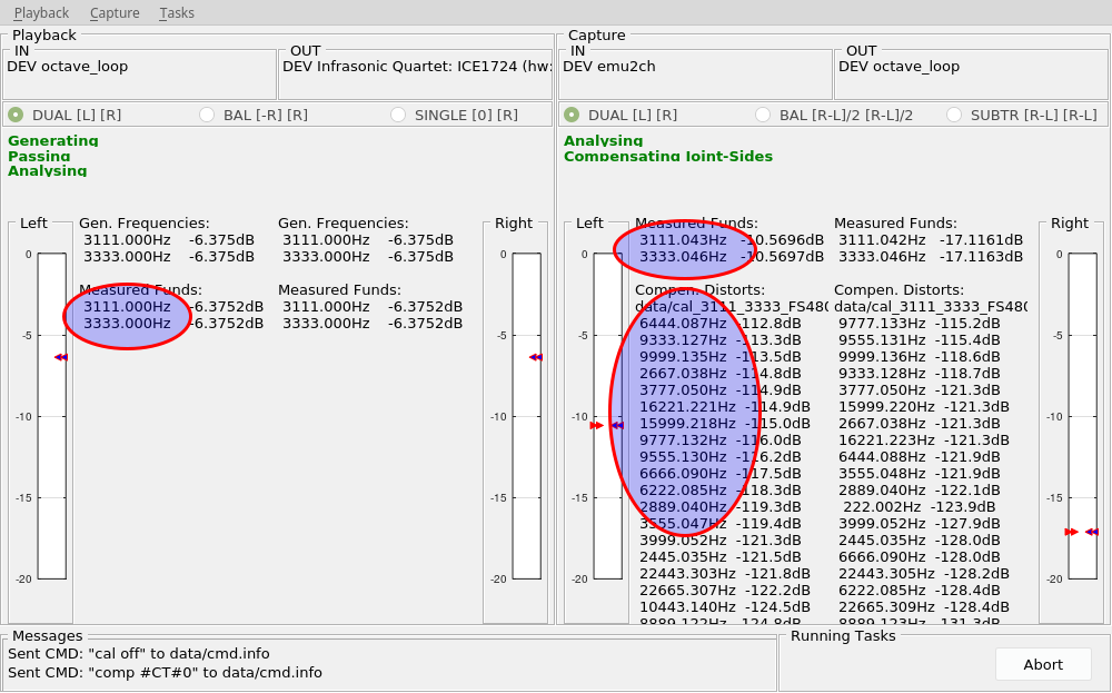

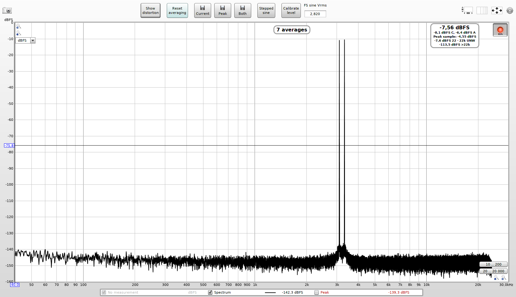

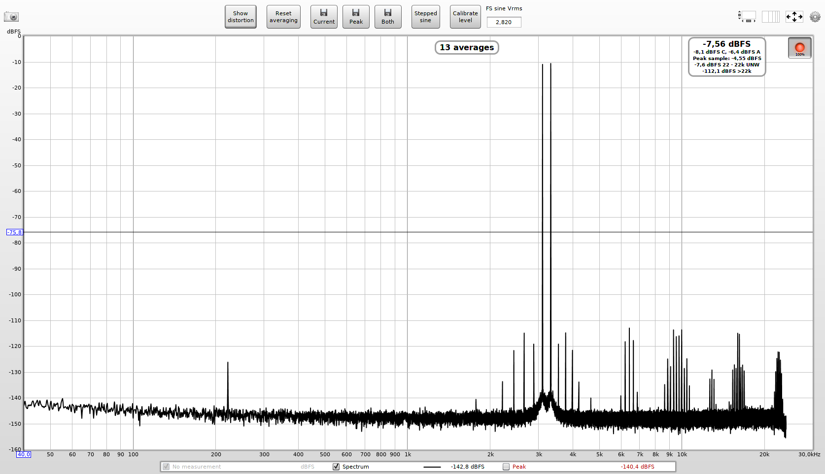

5) The tool running joint-sides compensation of dual tone. Quartet generates 3111Hz + 3333Hz, E-MU samples 3111.043Hz + 3333.046Hz
6) Uncompensated performance of the loopback
7) Combined-distortions compensation running on ADC side.

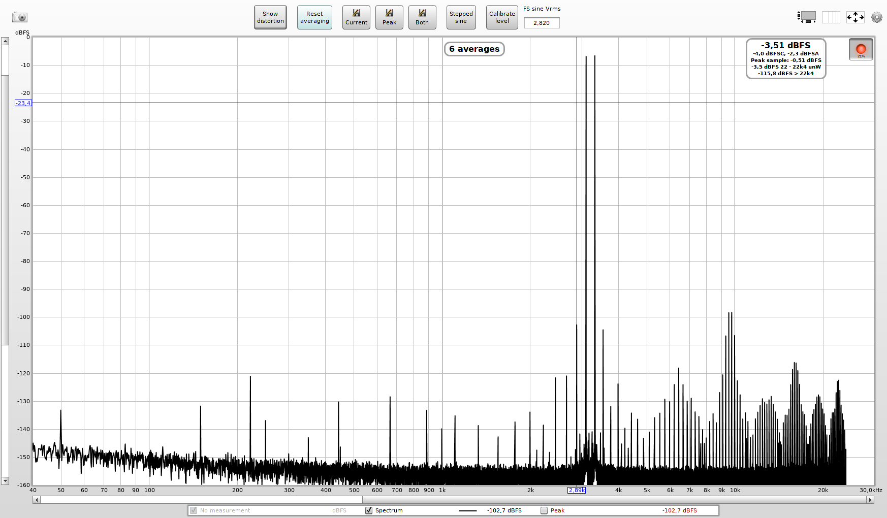

Independently clocked DAC and ADC (two different sound devices) never yield the same absolute frequency. Even if the DAC generates integer Hz signal, sampled frequency behind the ADC will be slightly different. Measuring this frequency precisely is one issue, determining precise amplitude and phase of all harmonics with FFT is another issue - the frequencies must center on FFT bins.
Great inexpensive ESS-based USB DACs exist, but they almost never come with ADC, let alone a good one. Soundcards with very decent ADCs exist, but their DACs are way behind e.g. properly implemented ESS-9038 DACs.
