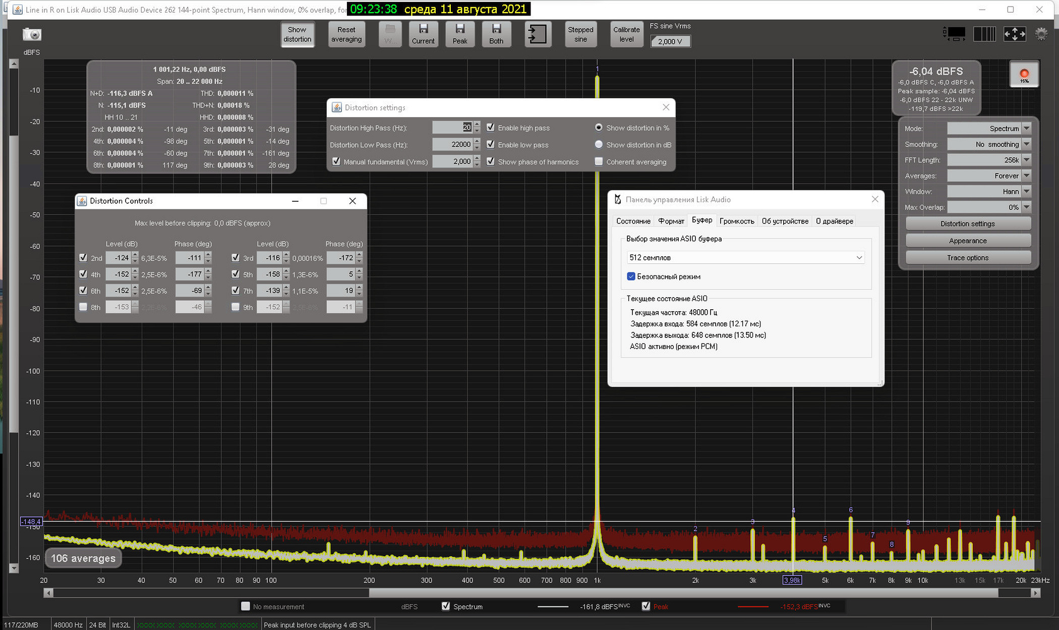

for statistics: CS4398 + AK5394

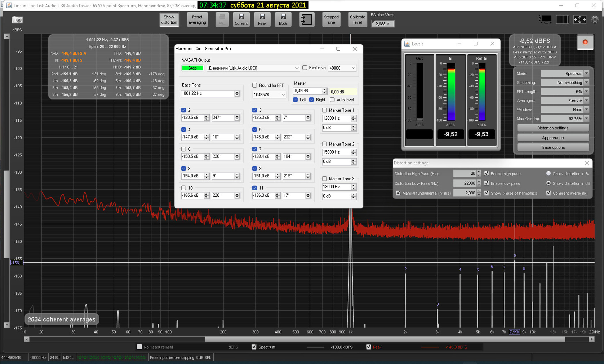

the final? for harmonic compensation: @REW beta14 RTA + E.Sokol ©generator with harmonics & phases @ CS4398 + AK5394 = The MOD 3.0 + UX3 usb card

Do I understand correctly that you took the loopback distortions as measured by REW, scaled their amplitudes for the DAC signal level, inverted the phases and added them to the generator?
That would be joint-sides distortions compensated on the DAC side. The joint-sides-compensated DAC outputs reversed ADC distortions now, to be nullified on the ADC side.
Or the same can be done on the ADC side, with a bit of DSP before REW. The goal is to compensate the DAC-side distortions in the generator and the ADC-side distortions in the DSP before the analyzer software... which requires splitting the joint-sides distortions to respective vector contributions of each side.

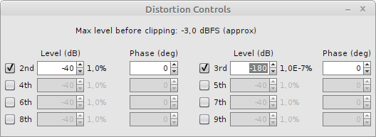

I have not been able to find inner workings of the ESS compensation. From what I seen it is frequency and level specific https://cdn.shopify.com/s/files/1/0321/7609/files/DAC3_-_2nd_Harmonic_Compensation.GIF?v=1478880997 . Just like a simple polynomial compensation https://www.diyaudio.com/forums/equ...nsation-measurement-setup-40.html#post6532409 https://www.diyaudio.com/forums/equ...nsation-measurement-setup-40.html#post6536105 https://www.diyaudio.com/forums/equ...nsation-measurement-setup-40.html#post6532409 . Therefore I assume the ESS H2 compensation value adjusts second order term and H3 some third order term of a polynomial with which the ESS chips multiply sample values before DAC/after ADC conversion. Especially when the C2 value affects both H2 and H3 (typical effect of polynomials).
The level/phase compensation of specific harmonics as discussed in most of this thread is for fine-tuning, at specific level and frequency, of distortions left after the wide-band/wide-level polynomial compensation. Of course it requires fast automated calibration at the current frequency and level, stepped-sine/level instead of continuous sweeps, and co-operation with the measurement software. The sweeps cannot give very precise results anyway RTA Window :
