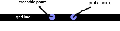

I do not understand completely: I connect the crocodile clip of my scope probe to where, and the probe itself to the same point...? Please explain again for me, I am no expert, only amateur diyer: how do you suggest to connect the scope to the noisy GND?
Don't wory I'm like you too, see picture

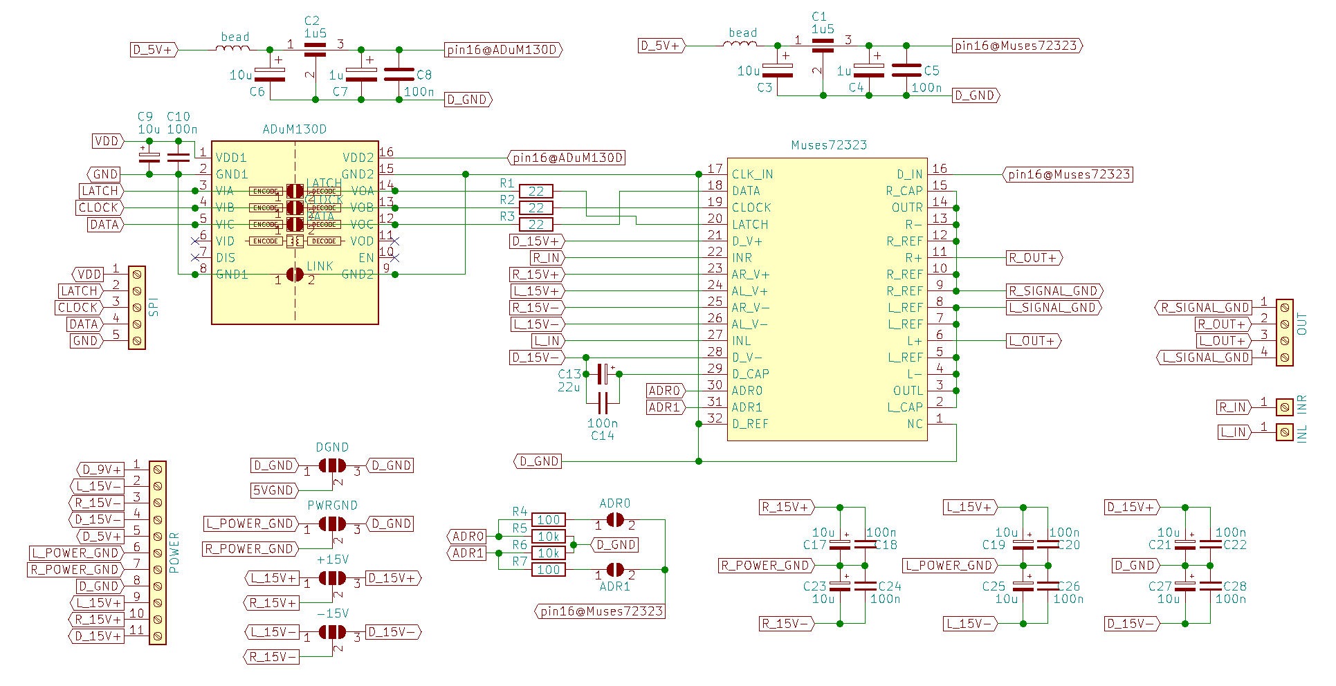

For checking the ADDR1 issue it might be quicker to remove both R6 and R7 and replace R7 with the 10k resistor and leave R6 unpopulated. Of course, also connecting the bridge to 5VDC.
There is no issue with my adress jumpers: one board is configured as 0 and the other one as 1. Works as shown in my schematic by just opening and closing the solder jumpers. No need of swapping resistors around 😀

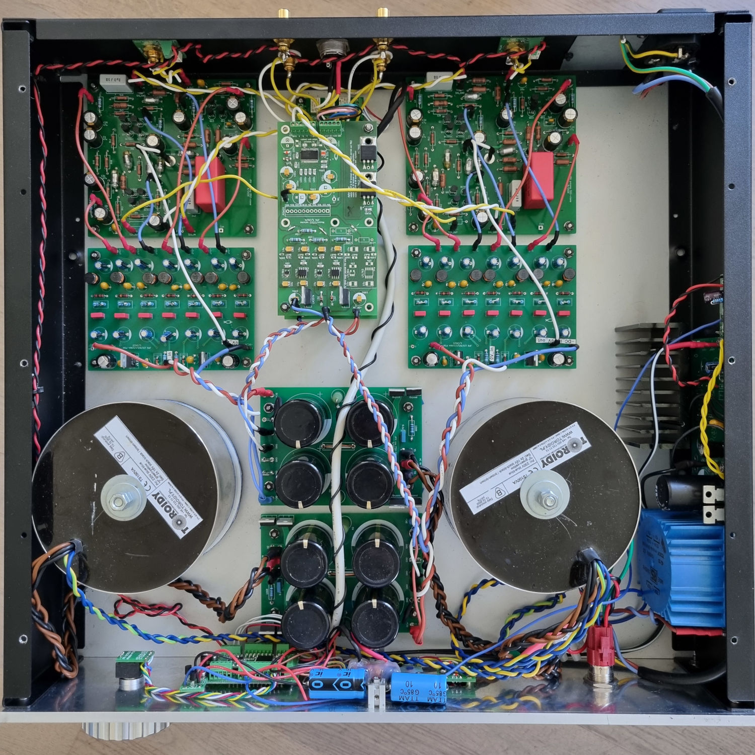

I’d put the Muses before the Naim (Muses out to ‘IN’ on left of your schematic in 296 above), like it’s done in the Iron Pre: Input Selection > Volume Attenuation(Muses) > Buffer > Gain(xfmr on the IP).
That's not the way a Naim chain works. As mentioned I have a working Muses board in another preamp (the same type of dual railed Naim).

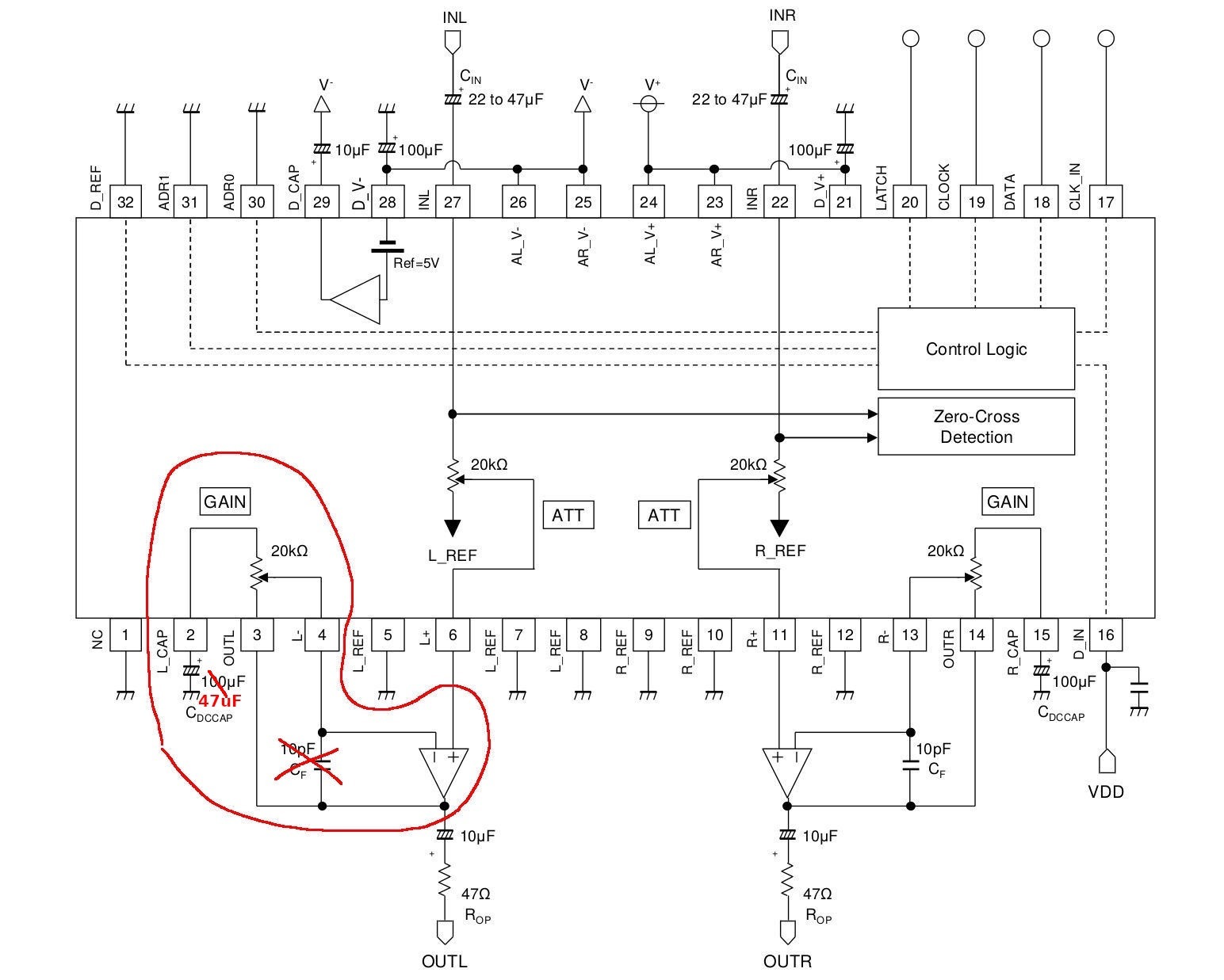

I’m quite confident that if you remove C11,12,15,16 and left unconnected PIN 3,4,13,14 taking signal out from PIN 6 and 11 and signal ground from L&R REF you should sort the noise issue.

One possibility - given that the noise lessens from -10dB and is gone at 0dB - is an issue with the way you handle the Muses gain circuitry. FWIW, I left pins 2, 3, 4, 13, 14 and 15 totally floating - no connection to anything.
I removed the caps and left the pins floating, no difference. Also tested it with all 6 grounded: same.

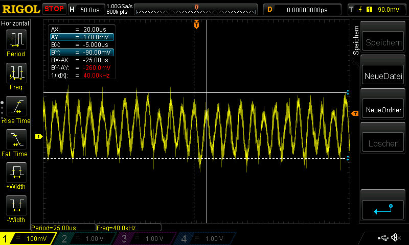

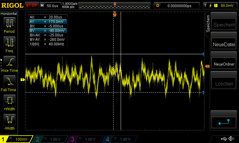

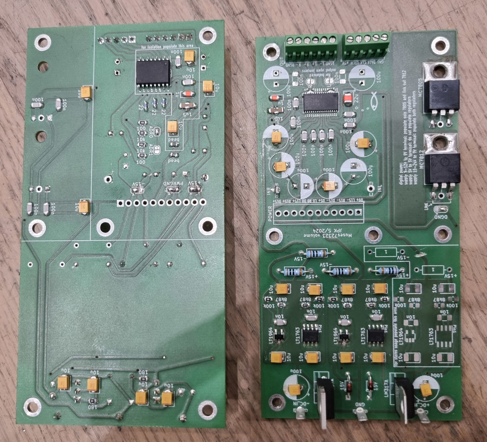

I struggled to make the noise visible at my Rigol scope. Only at the speaker output of my power amp I can make it visible:
This is with the Muses turned up to full volume (0dB) when it sounds silent. You can see a 40kHz wave with a peak to peak amplitude of 260mV. And this is with the noise, when the Muses is set to -20dB:
Seems like some kind of oscillation...? But where does it come from?

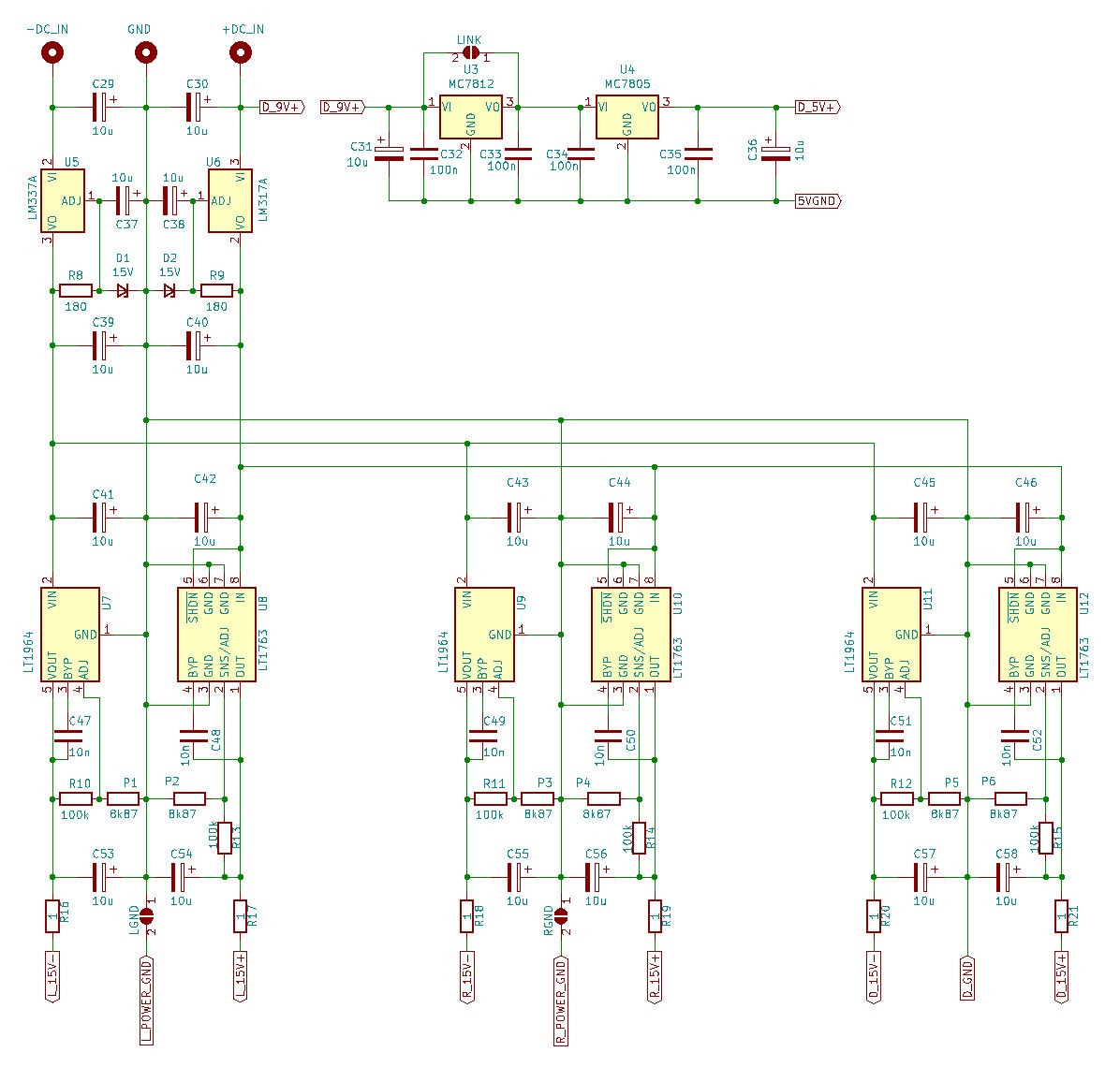

Update: I checked everything about oscillation, isolated the regulators and removed all 100uF caps. After messing around with the boards the whole day I understood that signal ground needs to be separated from power ground, but not as I did in my previous schematic - so I cut some tracks and re-arranged GND. I fitted 10uF SMD tants to where the 100uF caps were, and the noise is finally gone. Many thanks for all the support! Attached my final schematics and the modded boards:

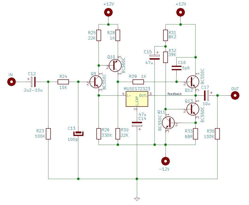

This might be slightly off topic, but I am wondering if I could use the gain feature of the Muses like this:
The schematic shows the Naim style gain stage that I am using in my preamp. The Muses72323 attenuator sits at the input of this circuit (and there is another buffer before the Muses volume). The gain feature of the Muses I thought to connect like this:
Is it a good idea to wire in pin2/3/4 of the Muses chip into the Naim circuit and control the gain like that?
I can't find the information about load impedance being 470k (or bigger). The only mention of 470k I can see in the schematic at the output: but I am asking about the gain feature of the Muses chip. I thought this has nothing to do with the load on the attenuator...?

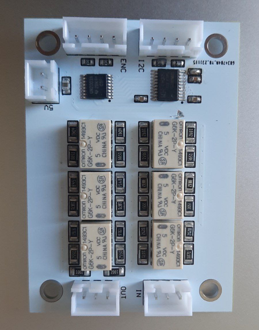

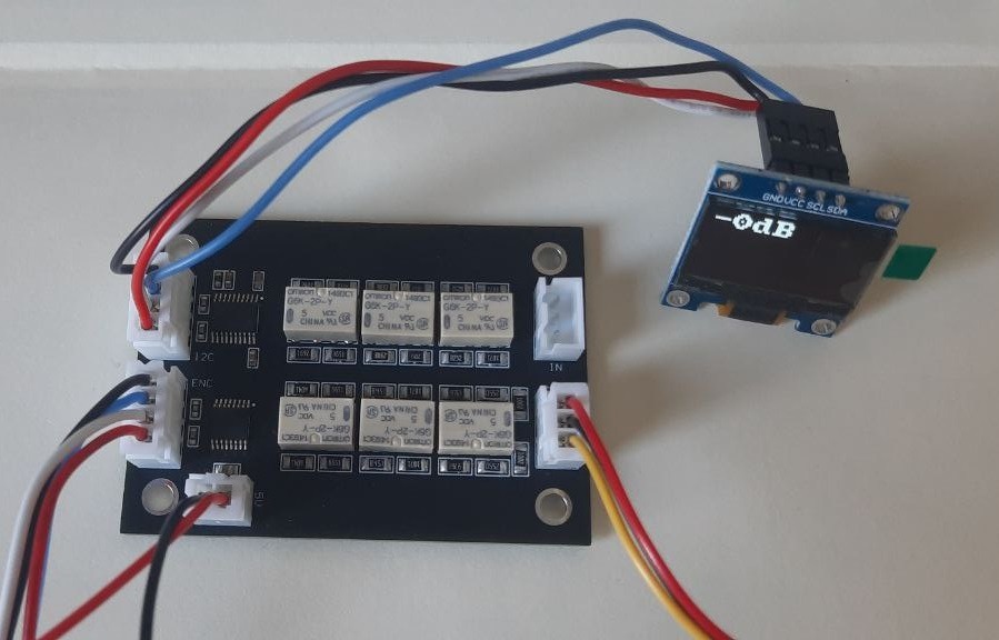

Hardware works (well, the second PCB revision is definitely required), time to work on the firmware 🙂
It's been a long time 🙂
SSD1306 display, encoder or potentimeter control. Or it can be controlled by external MCU, the module can be switched to I2C slave mode.
1db steps, max attenuation is -63dB.
