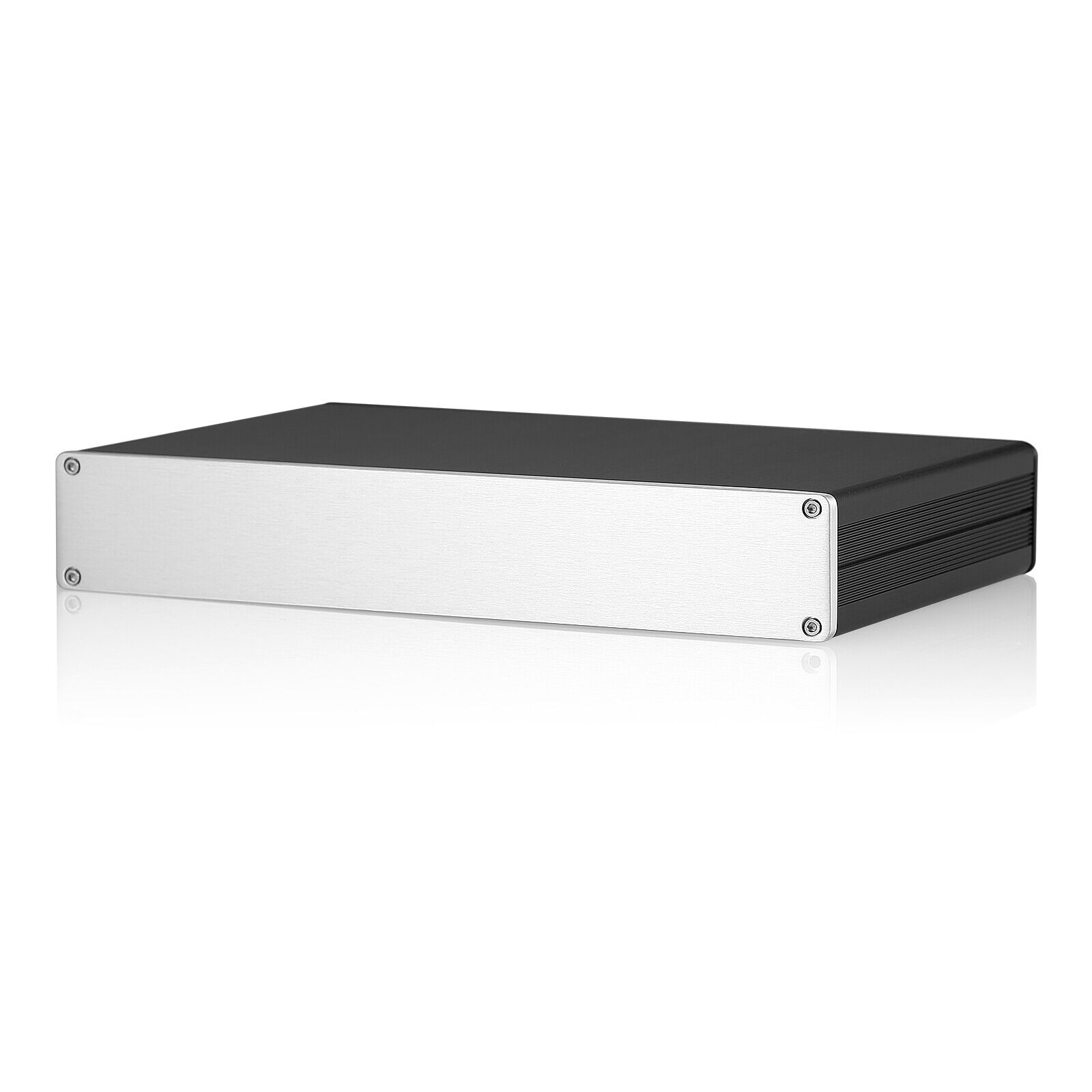

Been searching for some metal housing but the dimensions of my board are a bit unusual compared to more common pre/power amp/DAC builds?
Board is 215mm x 70mm and height is just under 40mm.

Found this that should work fine I think https://www.ebay.de/itm/166116541991
Oh, didn't see thatDidn’t you mention above that your board was 215mm wide? Usable interior on the 230 is 210mm
