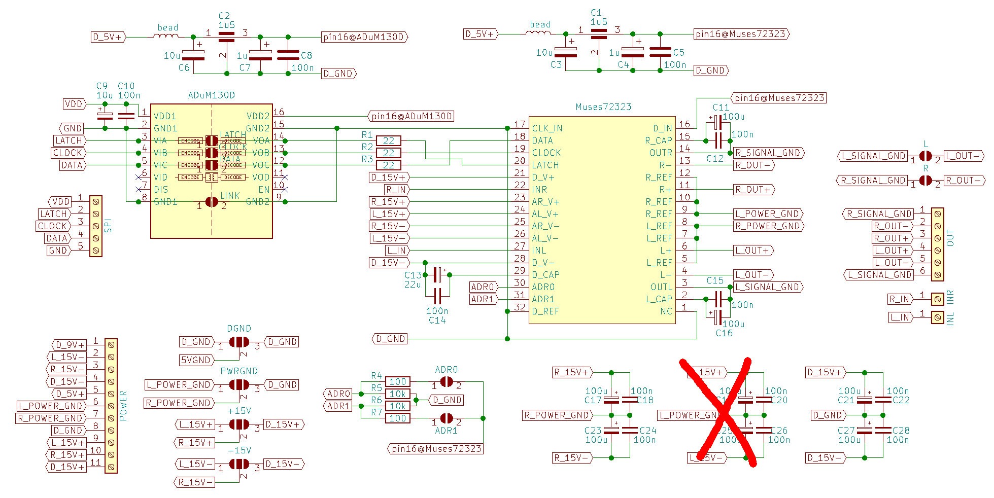

Yes, I tend to agree re not needing the isolator if you are using a separate 5VDC rail for the Muses digital supply. Definitely need it if taking the digital 5VDC from the +15V analog rail. In my case I found a dual-rail 5VDC supply (7805) which I hadn't remembered I had so opted to use that. And having two rails to play with said 'Why not use the isolator as you have a spare rail'. So one rail for the 'dirty' side - for the ESP32, ADuM 1300 VDD1 and various other necessities of my particular implementation - and the second rail for the clean side of the isolator.
Interesting approach to separating the 15V supplies. My take is that the "D_V" pins aren't shown on the datasheet as actually connected to the isolated digital logic section so should be fine being supplied by the analog 15V as shown by the datasheet. They may not actually be seeing any sort of 'digital' signal internally. Can't see Muses stopping short of suggesting separate rails if those pins posed any threat to the analog section. But that's just my non-EE take 🙂.
Typo on the pin 16 input voltages on the Adum and Muses?
In my implementation I'm not using the gain on the Muses so opted to ground all the pins between 1 and 16 (except for 6, 11 and 16 obviously) to the GND on the Iron Pre - which has an NTC to chassis ground.
Like the filtering, especially on the digital 5V! If I didn't already have my Muses boards I'd steal it!!!

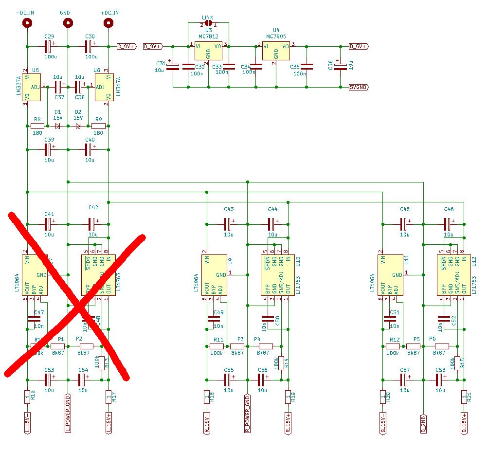

Just to report: I made a PCB with separate regulators for each supply that is shown in #281. So 3x +15V regulators, 3x -15V and a 7805 for the clean side of the isolator. Signal-GND and power-GND need to be connected together at one point. It works and sounds great.

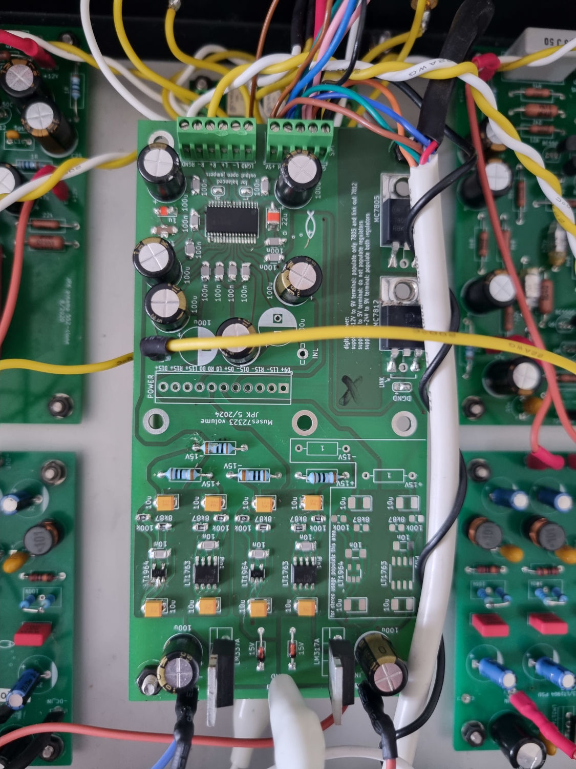

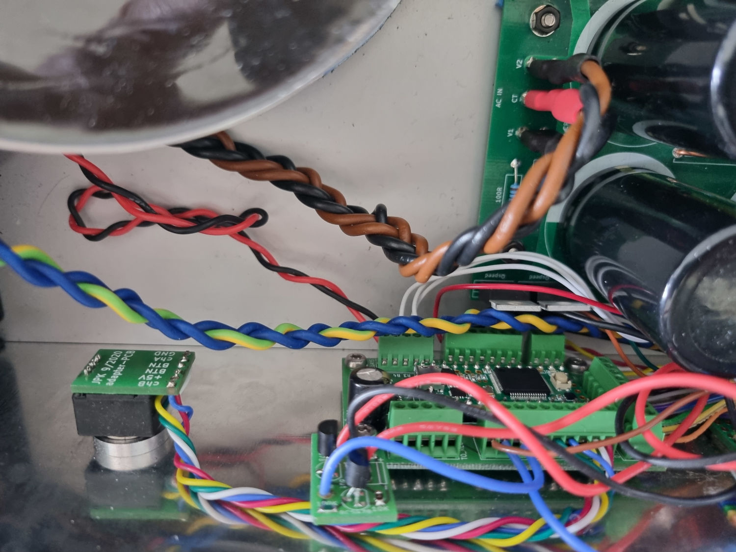

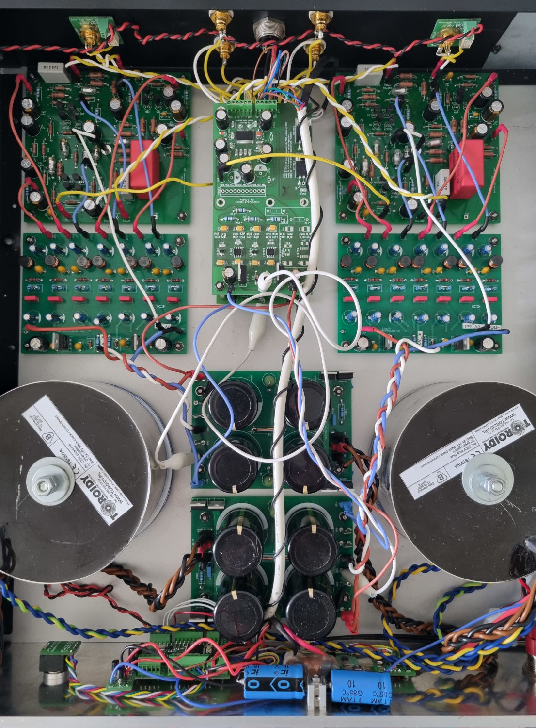

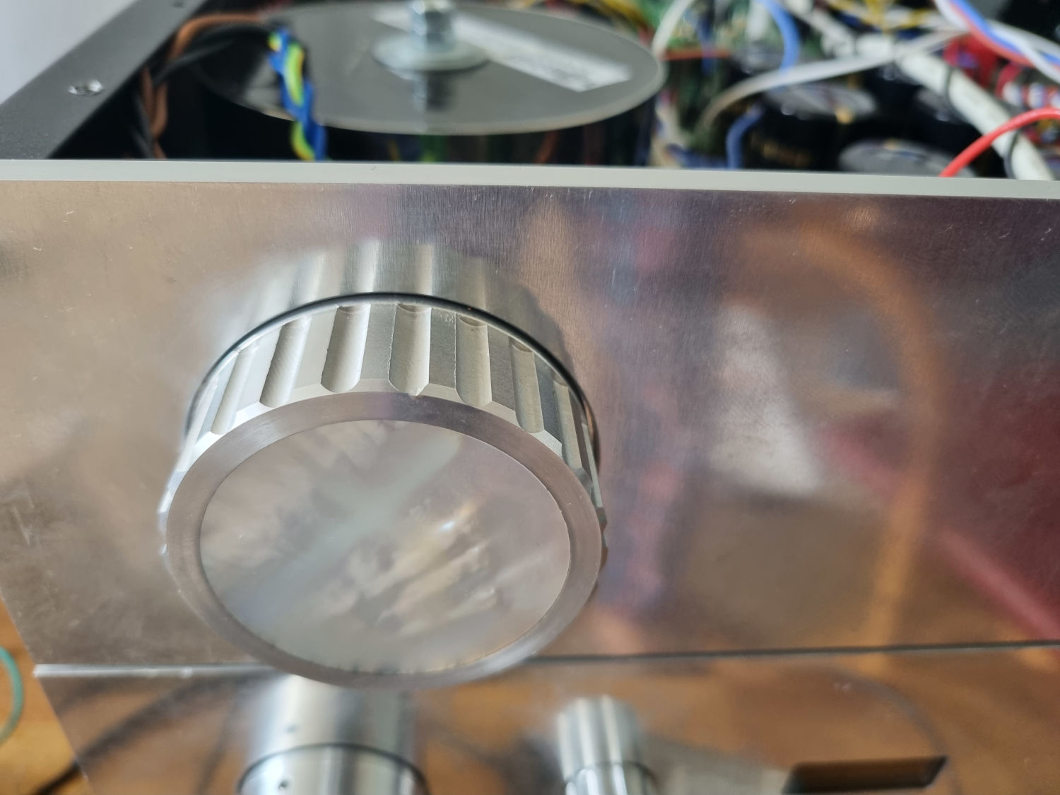

Here are some pictures - not finished yet, but already working (note the self made volume knob with the mother of pearl inlay). I can hear that it sounds way cleaner than my previous relay attenuator that was in the preamp before, but I have permanent noise on both channels, please help with that!
The Muses PCBs are configured for mono (it's a dual mono preamp), so 2 PCBs on top of each other, hence the non populated areas (crossed out in red on the schematics). I tested the Muses PCBs outside the preamp, they work fine, also I tested to use them in stereo mode etc. and tried many earthing topolgies, but the noise did not change at all. It sounds like a white noise and is independent from volume. Only in the loudest range between -10dB and 0dB it starts to reduce. At 0dB it's totally gone, but the last few steps I hear distinct clicking when chaning volume (louder than with the former relays). No clicking at all with less loud settings (I program full dB steps). The noise is loud enough to be heard during music play. I wonder if it's some kind of impedance mismatch between the preamp stages and the Muses chip? My other preamp (similar Naim clone circuits) do not have that noise, and my first Muses test-PCB works well in there. So I struggle to understand what's wrong here... Any hints much appreciated!

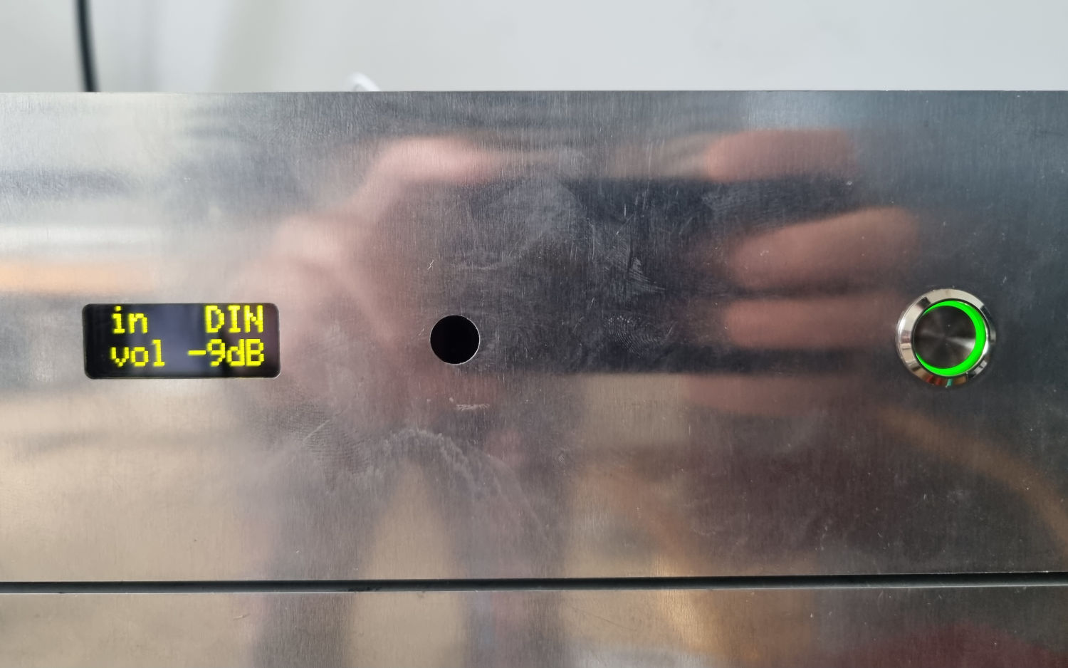

One possibility - given that the noise lessens from -10dB and is gone at 0dB - is an issue with the way you handle the Muses gain circuitry. FWIW, I left pins 2, 3, 4, 13, 14 and 15 totally floating - no connection to anything.

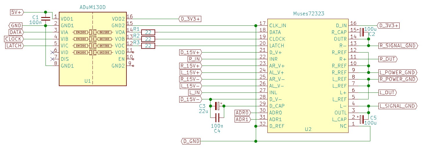

I haven’t had my morning C&C (coffee and constitutional) yet so am subject to correction here but something struck me as odd about your ADDR0 and ADDR1 schematic.
The way it is drawn the pull-ups will be grounded regardless of whether you apply 5VDC to set pin 30 high or not.
Also, although not relevant to your issue, there’s no need to make provision for pulling pin 31 up as, in a stereo balanced implementation, you only need address 0 and address 1 and both configurations require pin 31 to be grounded.

Is the noise not perhaps coming from the power supply to the Muses and MCU?

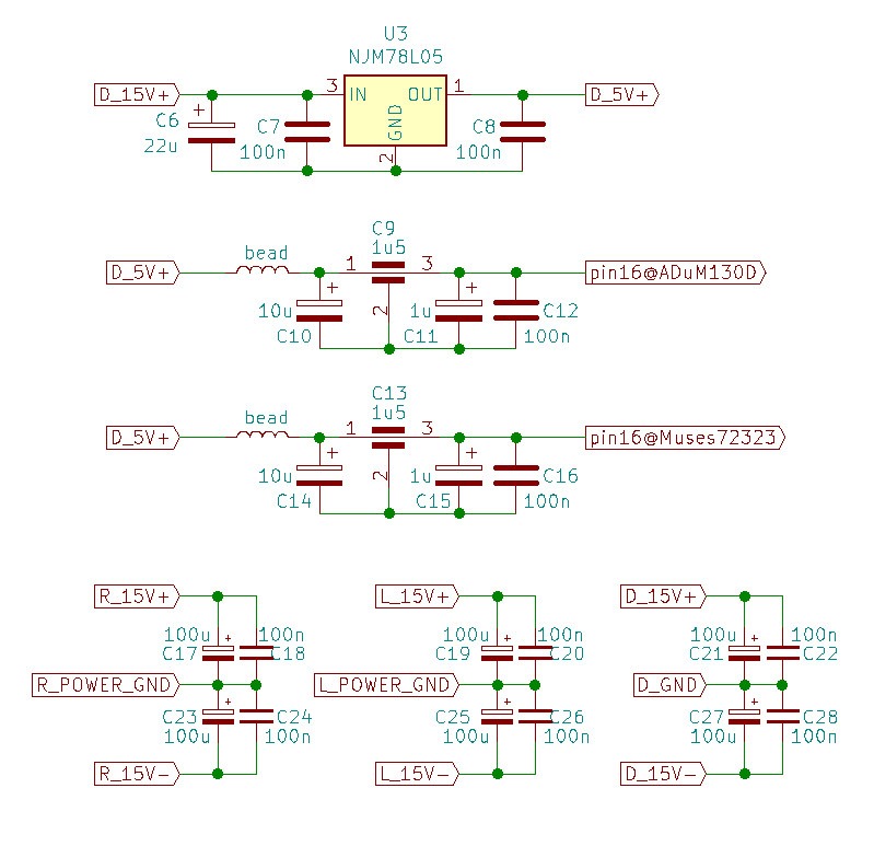

Am I correct that C1 and C2 are feedthrough capacitors? It's reminiscent of @Mark Johnson's AmyAlice filter, although not exactly similar.
My new board (still unbuilt) will use an AmyAlice filter which is incorporated onto the separate psu board. It was added to sleep better, although the current board is virtually quiet without it and using a Hi-Link smps without any filter.

Your wires around, nothing else but an set of antennas communicating with each other, ok for first test design but for final design do it on single pcb. Torus transformers must have an metal barrier so that it not emit noise to pcb...etc

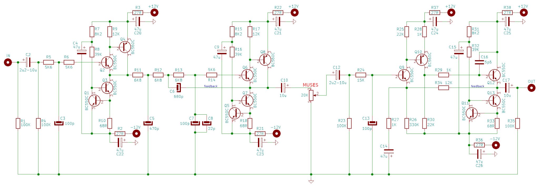

I attached the schematic of the preamp. The Muses volume sits between the buffer and the gain stages:
Yes. Probably overkill...

Having a good filter can never be overkill. Have a look at @Mark Johnson's AmyAlice filter which also employs feedthrough capacitors. From his description, I gathered that the filter should be properly designed for best effect.

if I understand correctly your schematic, there are some critical issue in it.
Pin 2,3,4 and 13,14,15 must be used ONLY if you have a OPAMP as gain device at the Muse output.
Then you can control the gain of this OPAMP with the Muse itself.
If you are not using this feature Pin 2,3,4 and 13,14,15 must be tied to ground or left floating.
Pin 4 cannot be “L_OUT-“ and Pin 13 cannot be “R_OUT-“

I’d put the Muses before the Naim (Muses out to ‘IN’ on left of your schematic in 296 above), like it’s done in the Iron Pre: Input Selection > Volume Attenuation(Muses) > Buffer > Gain(xfmr on the IP).
At the same time, I’d try both of your boards configured as ADDR 0, that is, with NO 5VDC connection.
I’d also try lifting 2, 3, 4, 13, 14 and 15 so they float.
