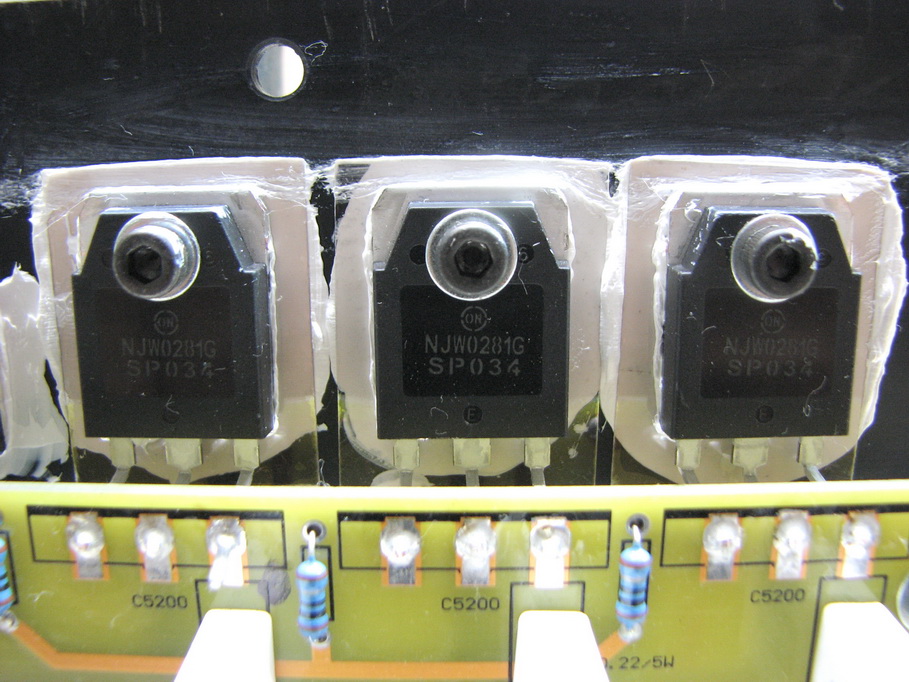

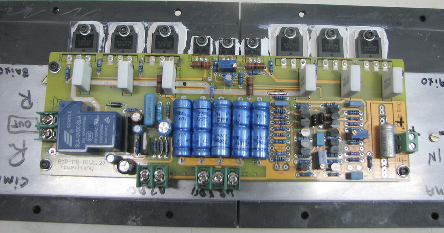

Hi everyone,
I bought a kit Diamond Differential amp version 1.2 Store JIM AUDIO. I rode carefully made ​​adjustments without powers OnSemi NJW0281G and NJW0302G. The trimpot W2 does not change anything, can turn thousand rounds for each side. After soldered the powers and turned 48.7 VDC: but nothing, no audio comes out!!!
Thanks, I'm newbie, I have difficulties. Any suggestions please ? :crazy:

Set W2 to such a value that together with R16 and R23 (330ohm in series with W2) this part of the circiut becomes 220 ohm. Alternatively, remove W2 and change R16 to 220 ohm. Actually the circuit should react to changes in W2. Mine did.
Now, overall it looks that the circuit is wrong. I mean it seems to work when simulated but it does not work in reality. One of the problems is the bias circuit but there are possibly a few other problems. Carlmart worked on redesigning the circuit with a friend of his but I do not think he has built his modified amp yet. It think he is still playing with it on his PC.
I do not know if anyone here managed to make this amp operational. I'm still working on it. Modified versions work on a simulator but not necessarily in practice. The original worked in LT spice although it was very susceptible to oscillations and quality of PS.
Write to Jim's Audio and ask them for assistance. I'm afraid this amp in the current version is a dud. It needs some parts of its circuit redesigned.
cheers,
Thanks for the effort to help. Stanton Tin (JIM AUDIO) has undertaken extraordinary effort, with many e-mails and photos, examining the position of the parts and checking the voltages that I measured here at my house. Tin explained that w2 does not work because the boards do not have anything in the output.
I noticed a curious question, can you clarify: two different schematic, the first driver Q0 is D669 and resistors RF1 (22k) and RF2 (1k) have physical connectivity with R35 and R36 (point C in its recommendations for adjustments)
The second schematic the driver transistor Q0 is the C5171, but the joints of the R35 and R36 with both RF1 and RF2 does not exist: the transistors Q4 and Q6 are connected in RF1 and RF2 but are NOT soldiers in two resistors 33R / 0.5 watt (R35 and R36)?
It can not be the problem because the gates of Q4 and Q6 should not be connected to R35 and R36?
Other suggestions are welcome. Again, thanks to the best participants of this forum, special janusz, MOER and Stanton Tin (JIM AUDIO).
