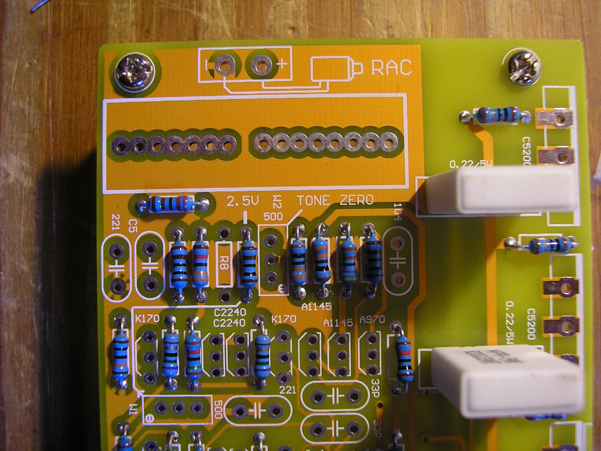

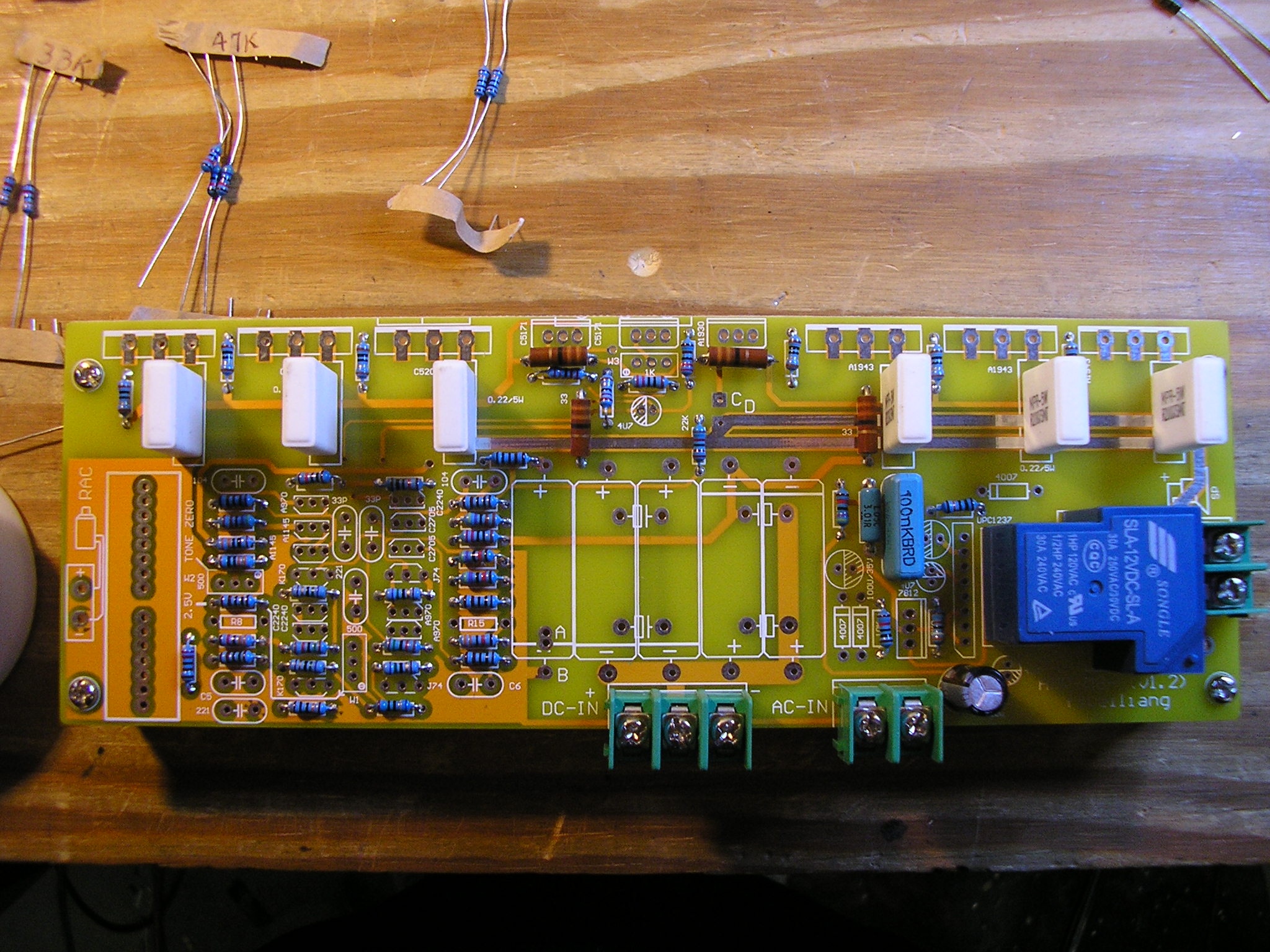

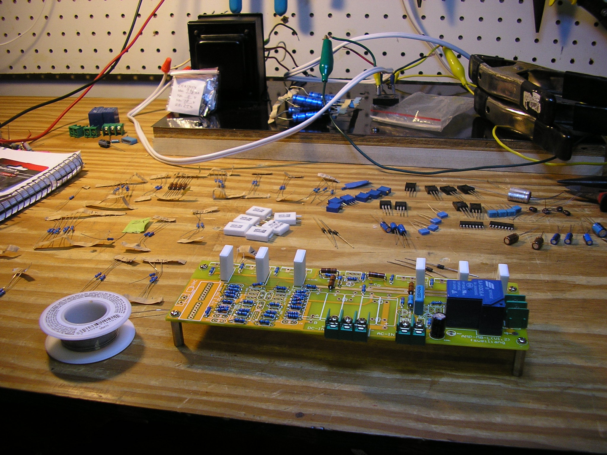

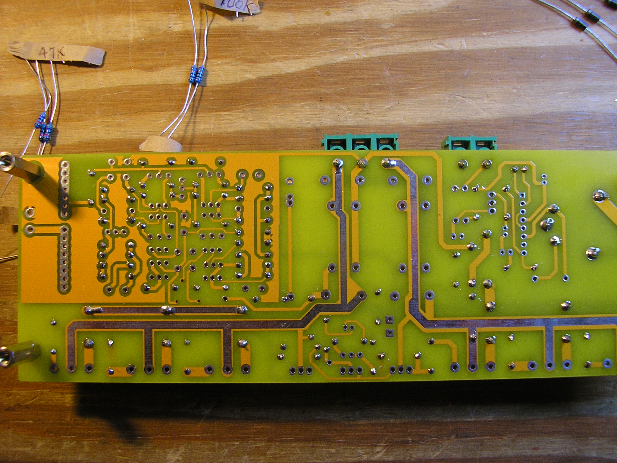

Accuphase E305V clone pics
Some pics of the Diamond Differential design Accuphase E305V clone build in progress.

Now looking at the schematic shown in the original post I can't find R8 or R15 but the components included only four 470 ohm resistors so that would be two per board and all others seem to be accounted for.Guess I'm going with the 470's in there.
Should be RCA. Mount an RCA input socket there. I use vertical sockets. I have board veresions 1.3 and 1.4. The 1.4 pair is almost finished. I'll power them up this weekend. PS is +/-57V so I used my 100V caps. Hopefully the amp will work.
