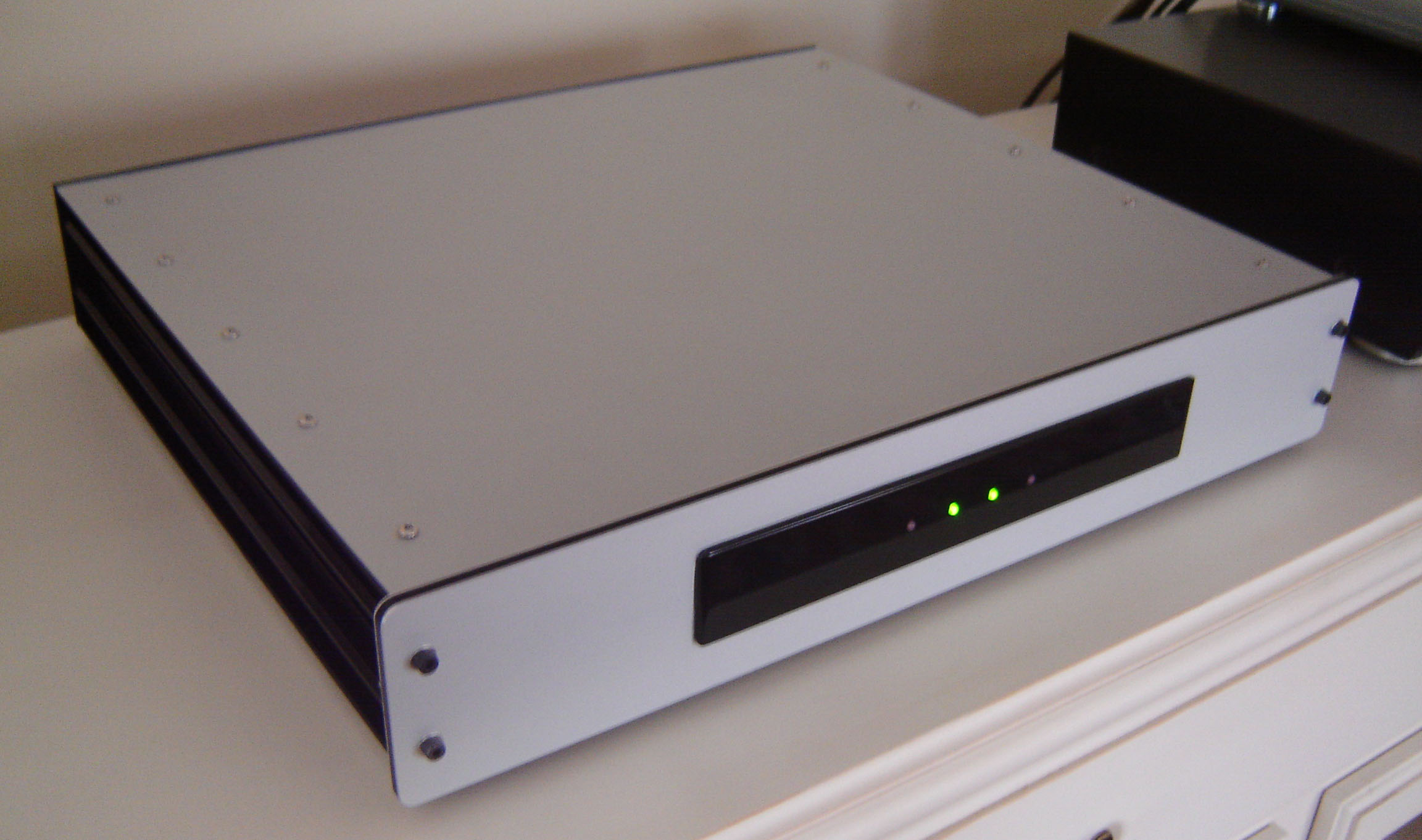

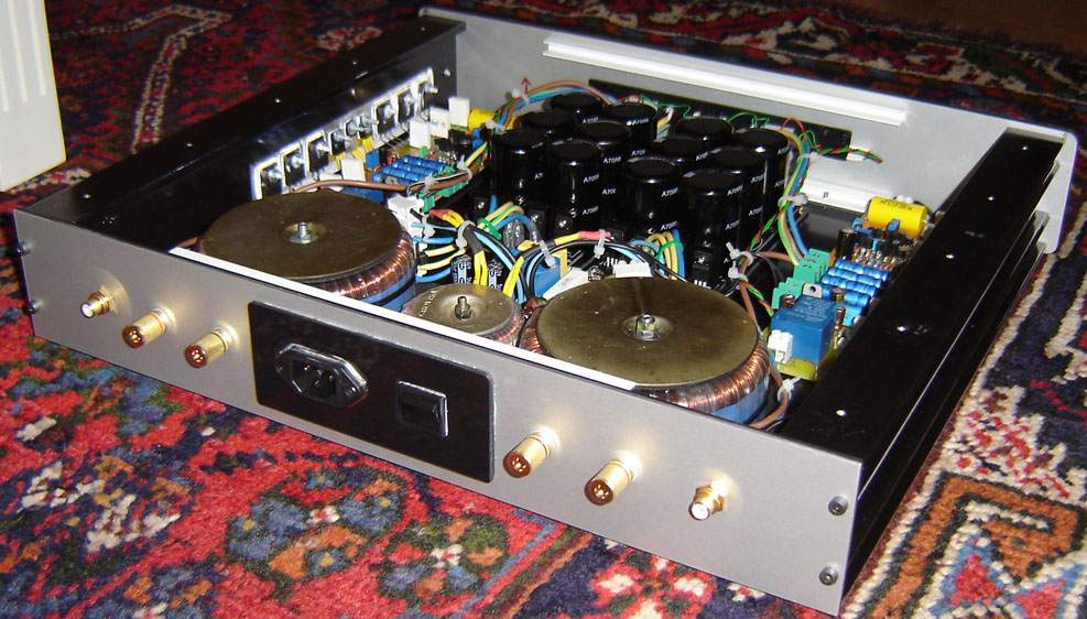

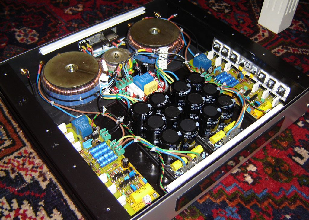

At last.🙂...the amp is finished....sounds great...had some problems with fake devices..sorry for the delay.

Fakes were output devices (ON-Semi NJW3281...)...the emitter resistors bad quality too...once replaced the unit works fine..two buyers are available: Tubeshunter and Jimsaudio..Tubeshunter don´t send any information..and the boards are different too from different suppliers...Good luck.
How did you find out they were fakes? Did you check Hfe at high currents? I have tested hfe at currents from 10uA to 20mA and these which I got were pretty linear. Did not test them at higher currents.

Well,first of all most of devices from ebay are fake...this is well known..mine exploded litterally with only 50V. per rail..sent photos to On-semi and they confirm this ones were fakes.
My resistors are buyed from an ebay supplyer.
