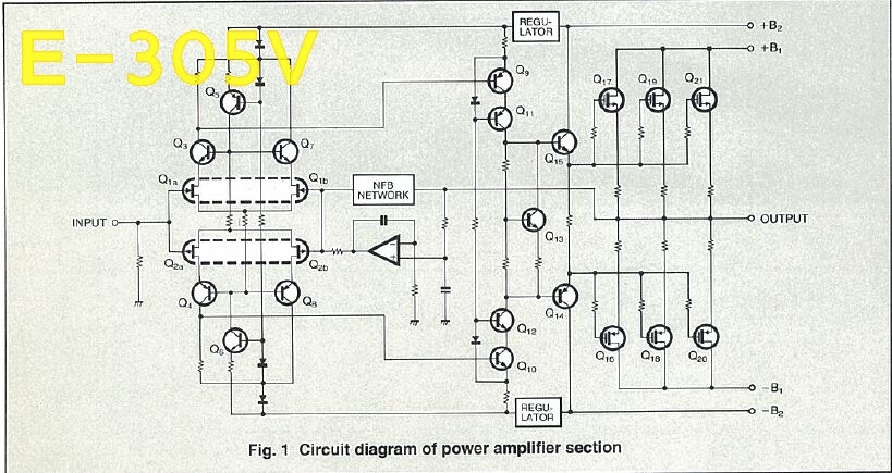

Who claimed the Diamond is an Accuphase E-305 clone?
I have just downloaded the E305 service manual, and except for the three output transistor pairs they have nothing in common.

Pity the Diamond Differential kit is not completely based on the Accuphase E-305V, that is the input and VAS stage seem to be similar, but there are two important modifications from the original:
1) The output is bipolar and not MOSFET.
2) There is no DC servo.
In any case, kudos for what it seems Jim's Audio new policy.

It is like a E-305V, a different amplifier.
Like Jim's Audio now shows on eBay, this is supposed to be clone for the E305-V.
But even so there are two important differences on the clone: the output is bipolar; there's no DC servo.
Not a clone. He says: "This kit is reference to E-305V", so it's NOT a clone.

No one says on eBay what they are selling is a clone of a commercial product, present or past.
Whatever the word they use (resemblance, reference, inspired on) it's only a matter of semantics. If the people who should be buying the kit do not read on what existing product is it based, they wouldn't buy it. So that characteristic has to be quite clear.
At the beginning of this thread it was discussed why was it called Diamond differential, and some comparisons were made with Sansui amps. But they were not. I still do not know the reason for the name.
