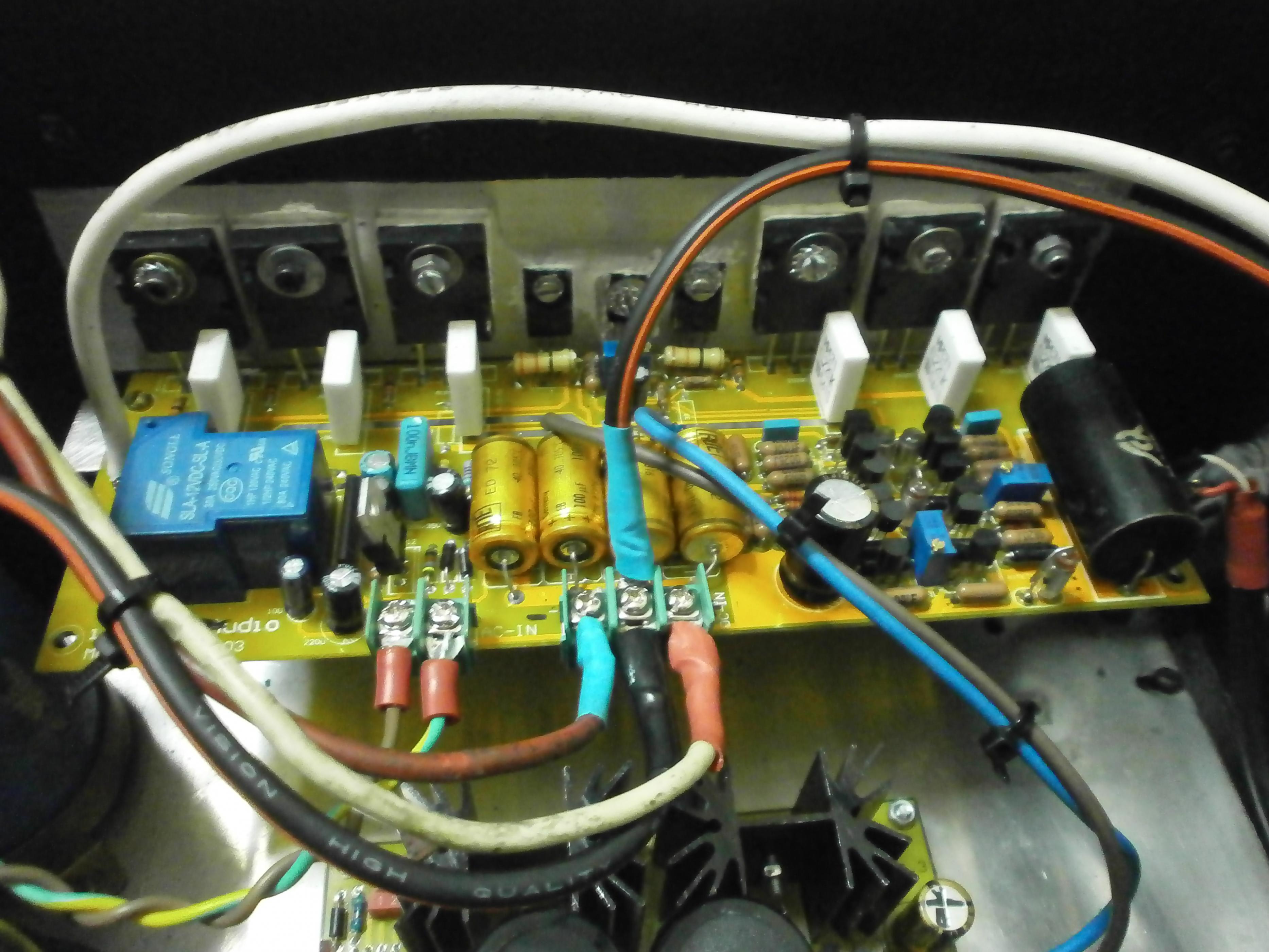

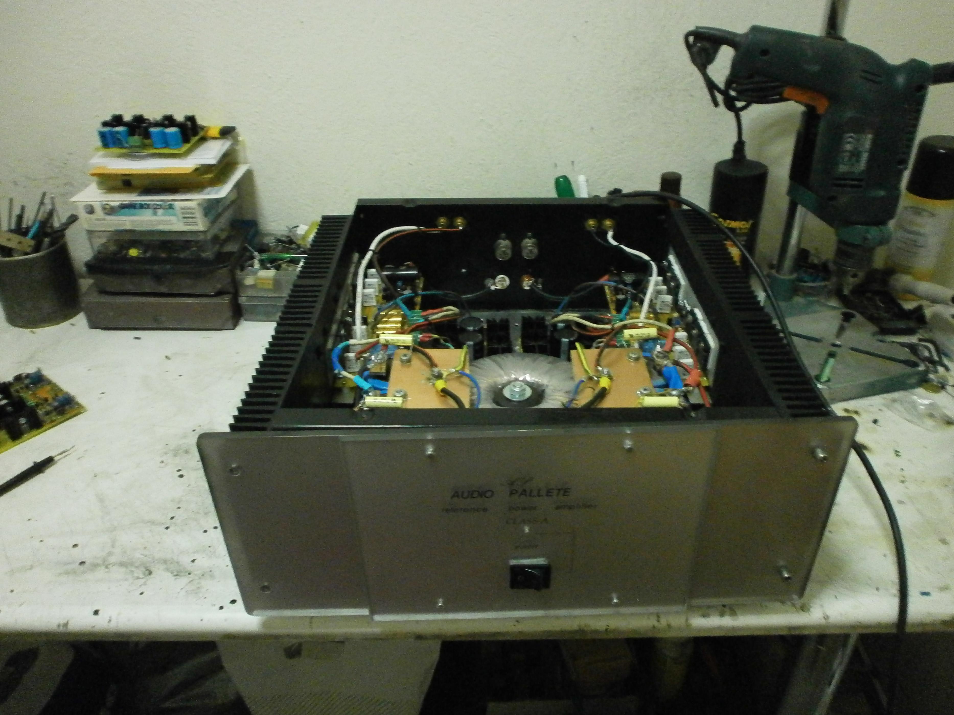

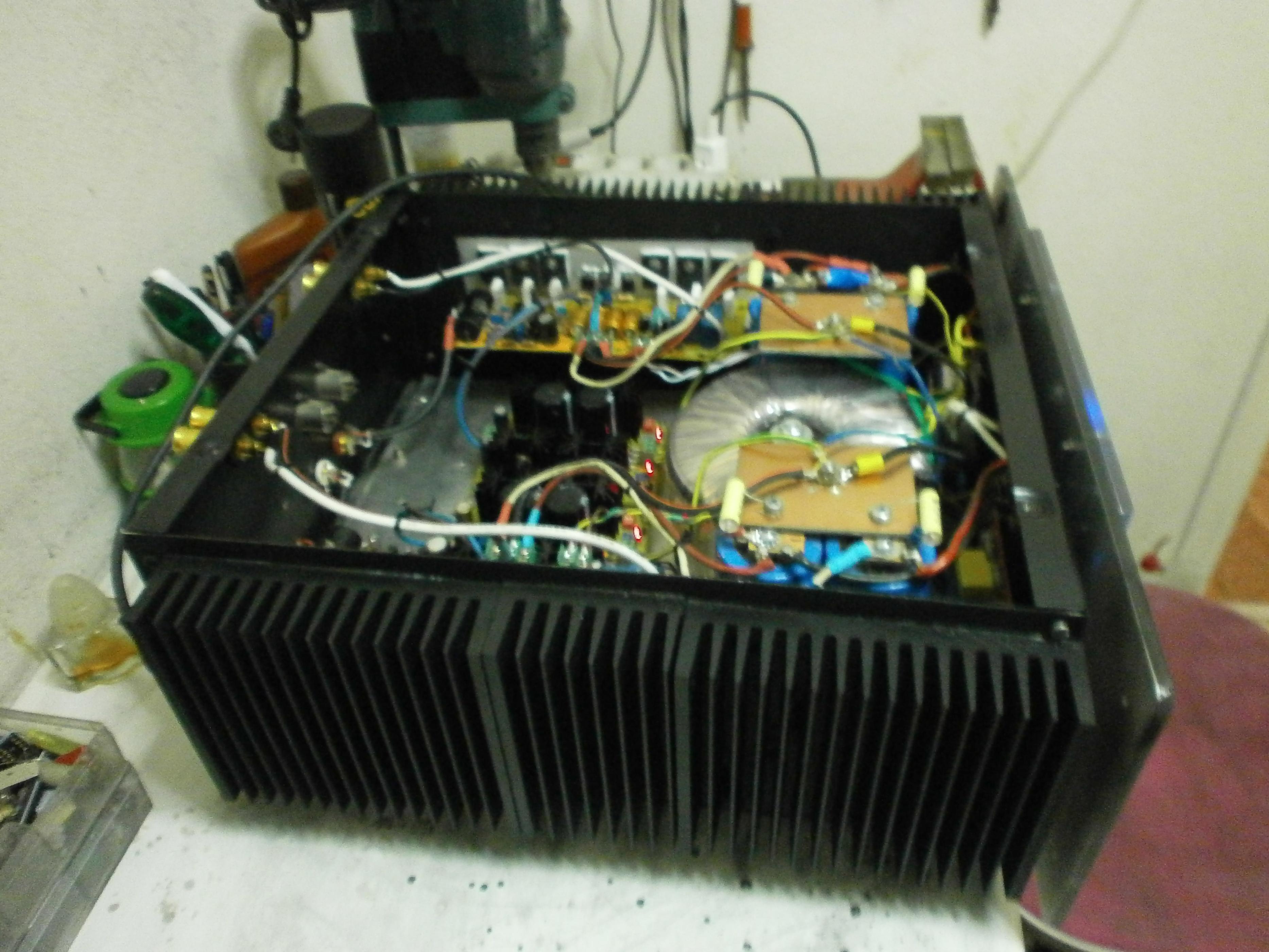

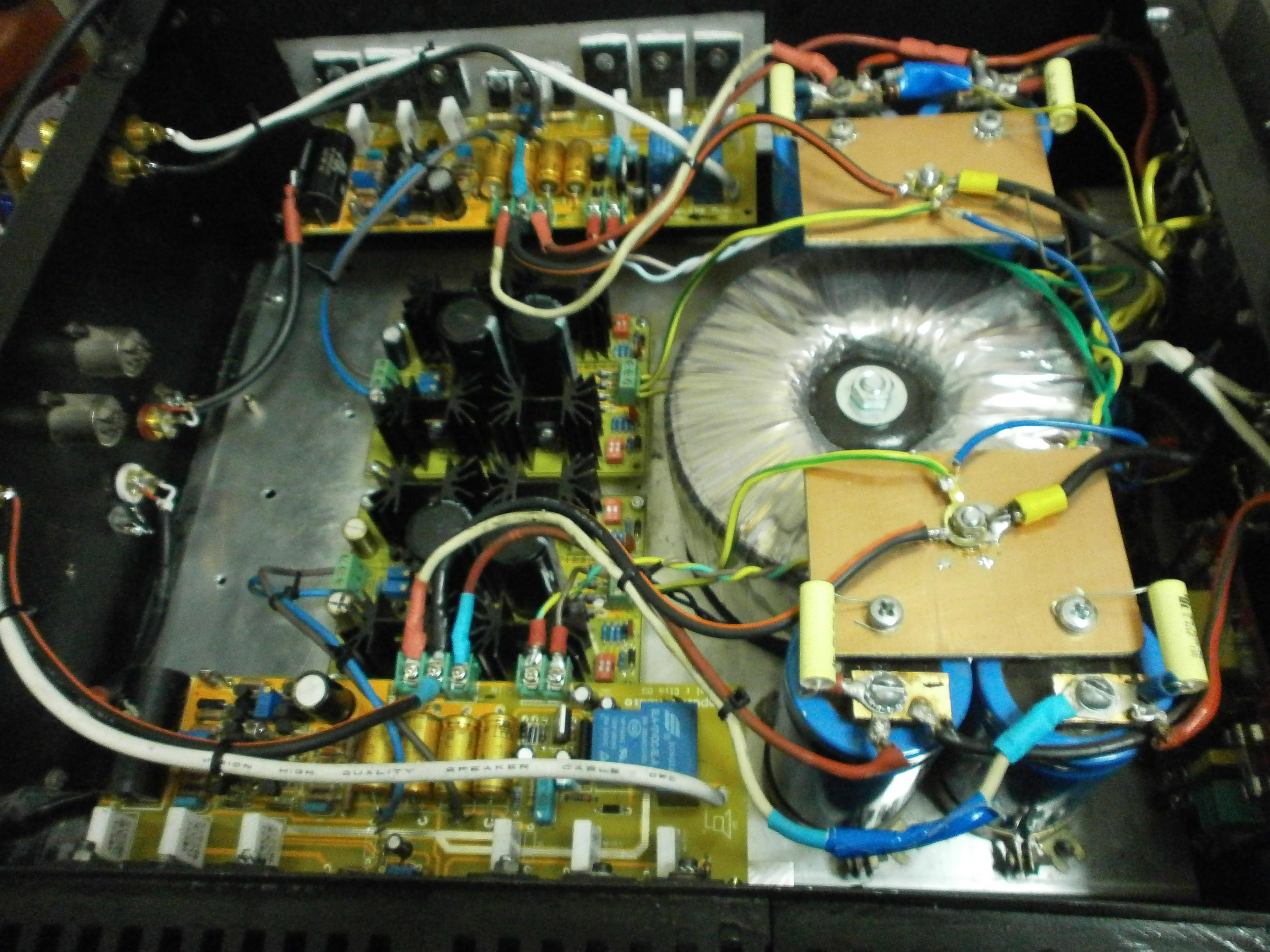

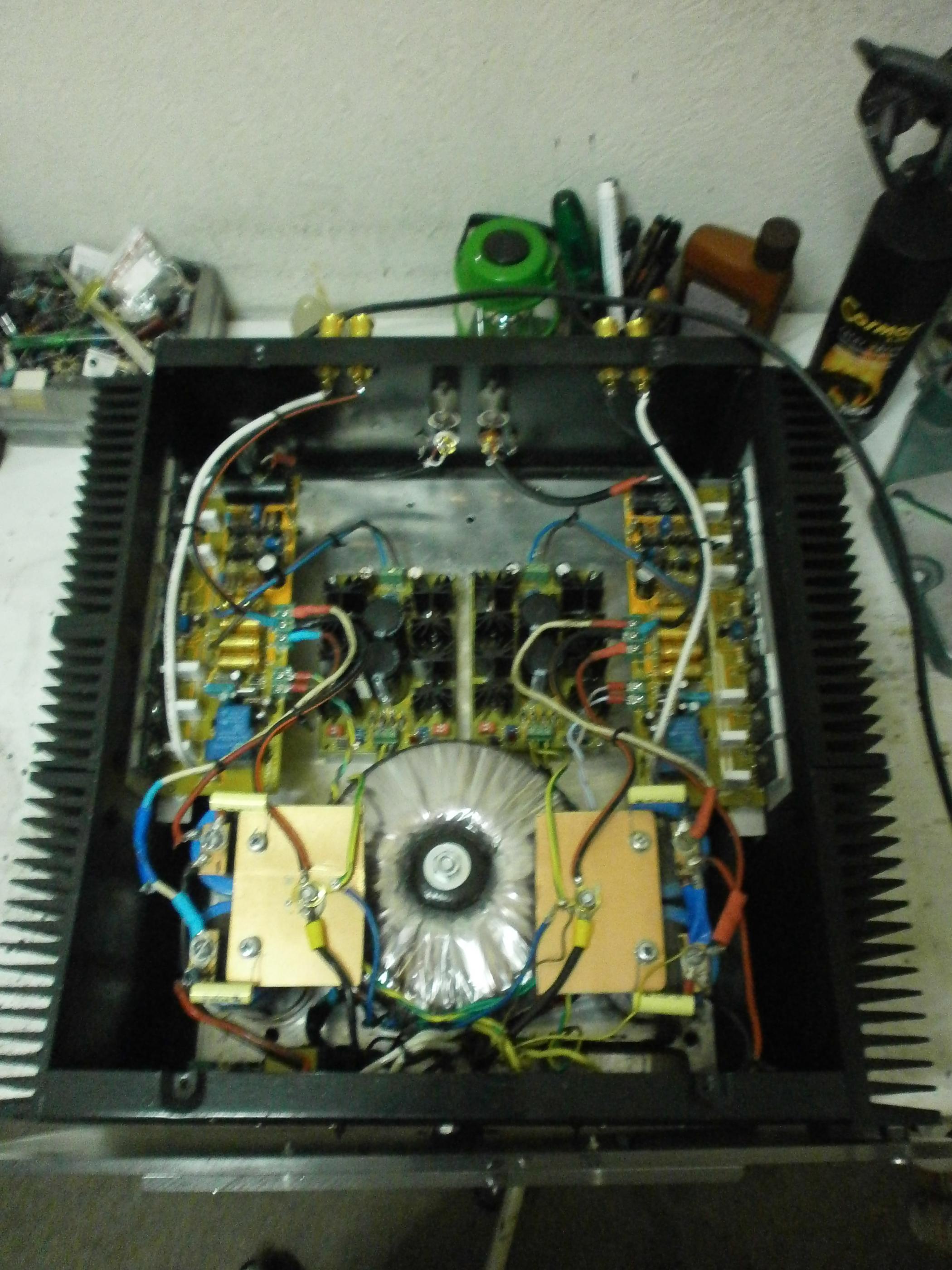

Images of my own diamond differential amplifier

My own D.D Amp has the 2SC5200-2SA1987 because I had over 200 of these.So I matched them measuring their HFE by my dig multimeter.Of cource this is not exactlly the presice method but in practice gives good results.The other D.D.Amp has the transistors included in the kit.

Congratulations on good work and the amp looks nice.
I use separate PS for each module. Transformers are 300VA each 2x40V plus 2x15V to feed speaker protection circuit although originally the additional winding together with 2x40V was to feed regulated PS but there is not enough room in my case.
Eeach of my PS boards has ELNA audio caps 4x15,000uF and dual 50A bridges. LTP and VAS are separately fed via additional 470uH coil filtered to the ground by 470nF cap.
