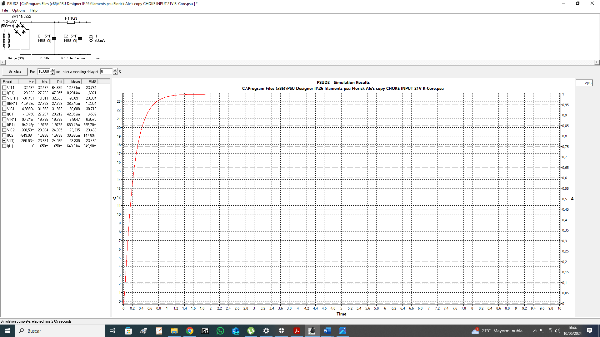

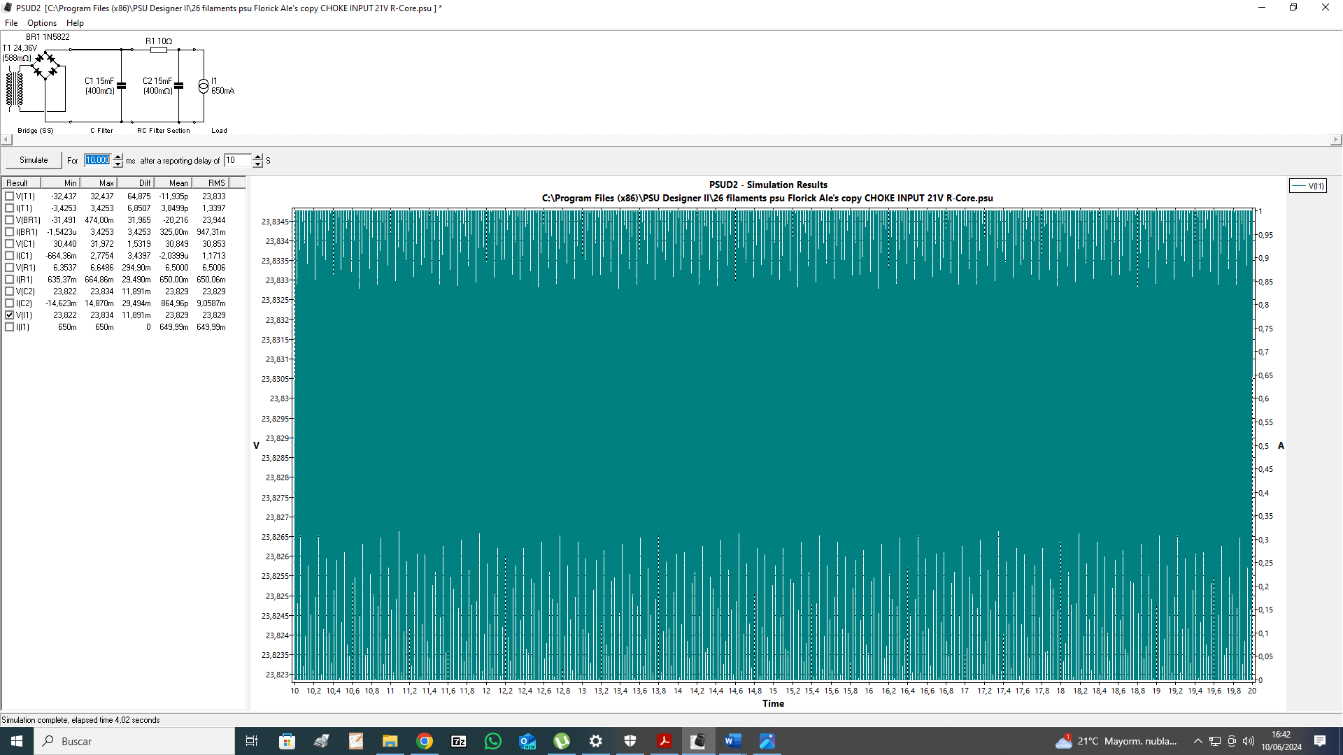

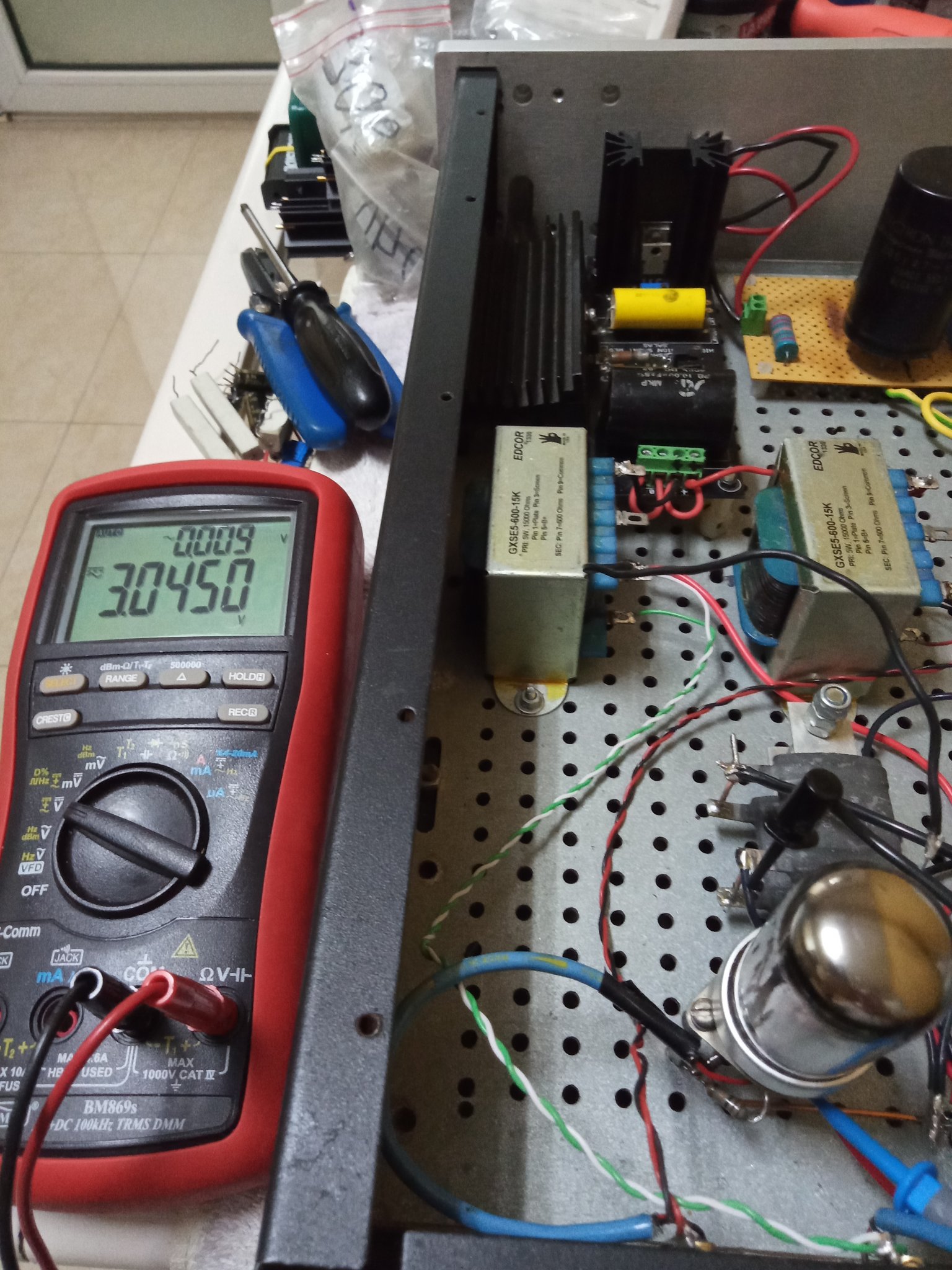

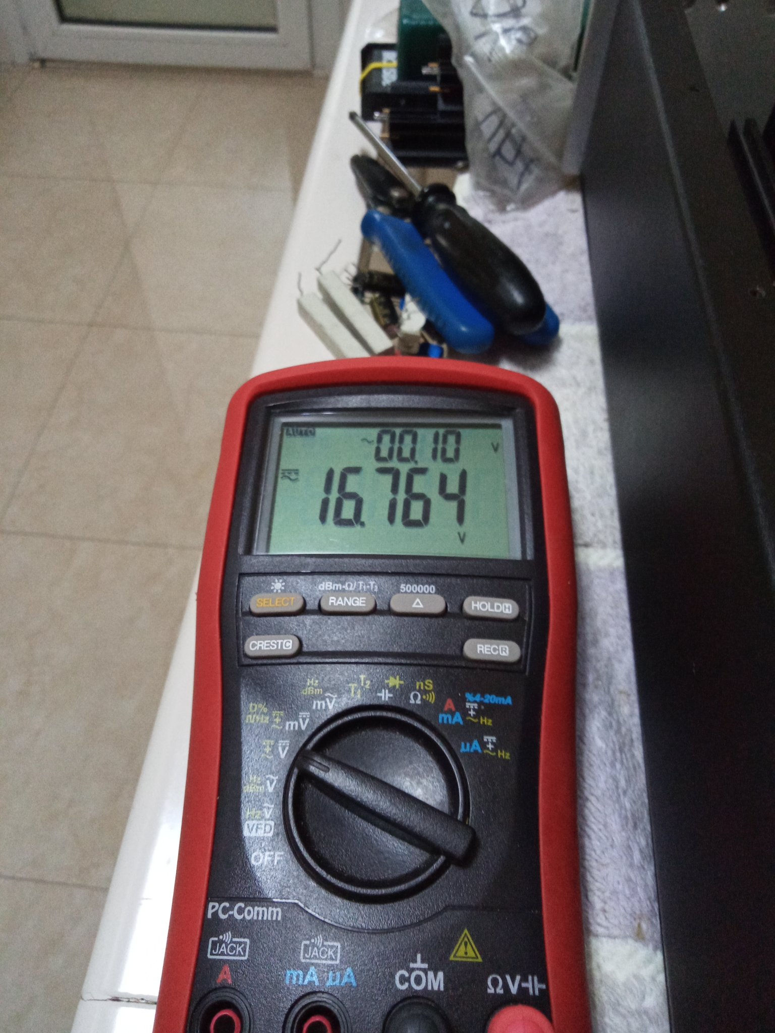

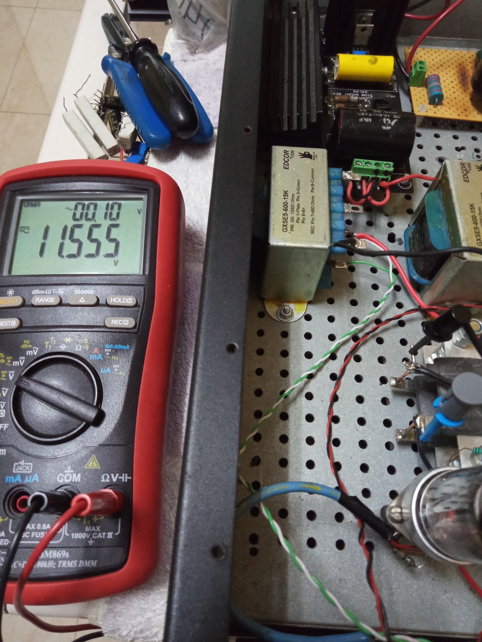

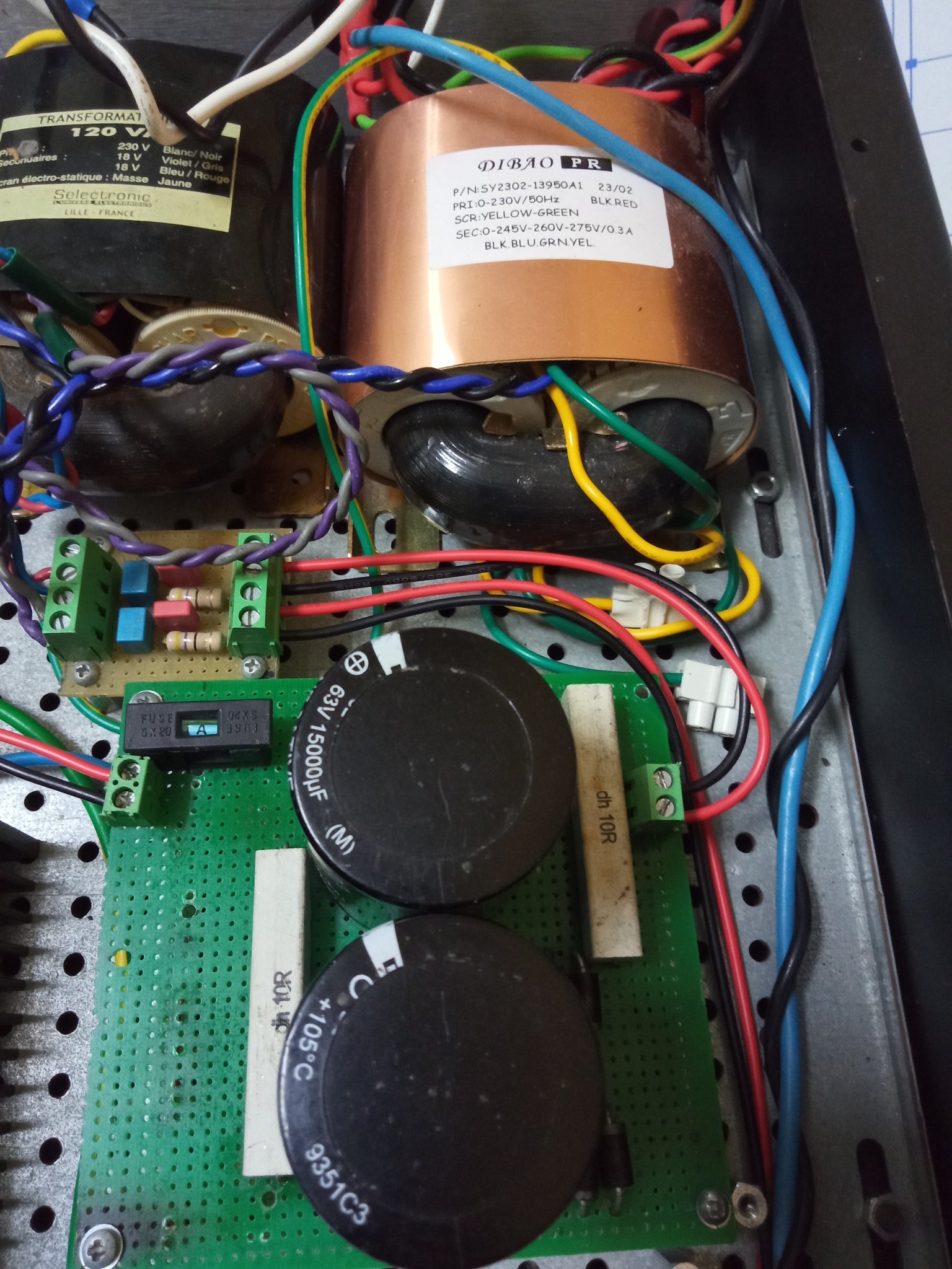

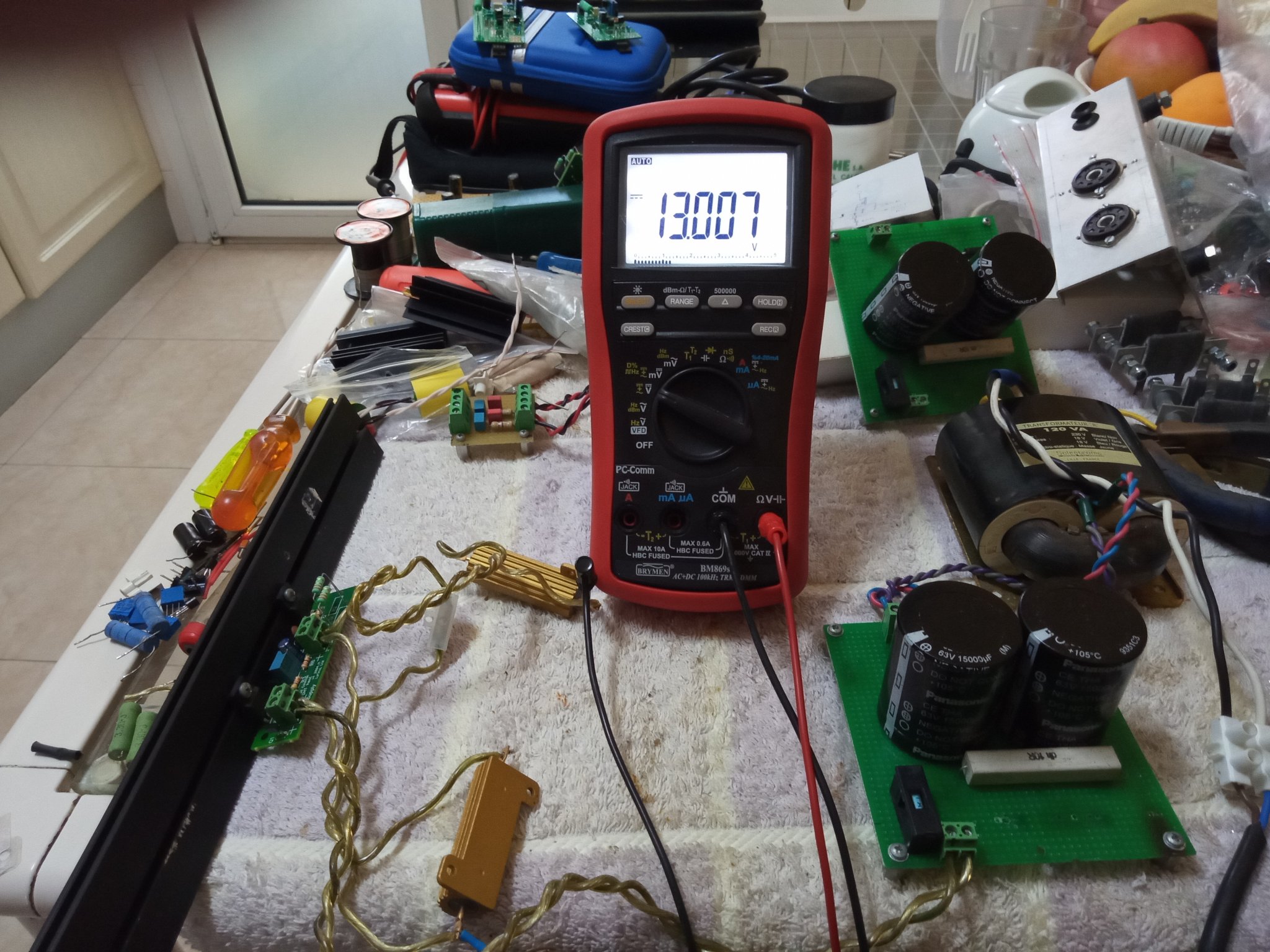

Test filament reg. passed with 20R dummy load 13V = 650mA

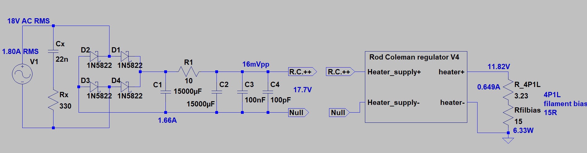

If the PT is 18VAC it's working.
5.88V headroom is just enough for R.C.
If you want more headroom, decrease 10R to 8R.

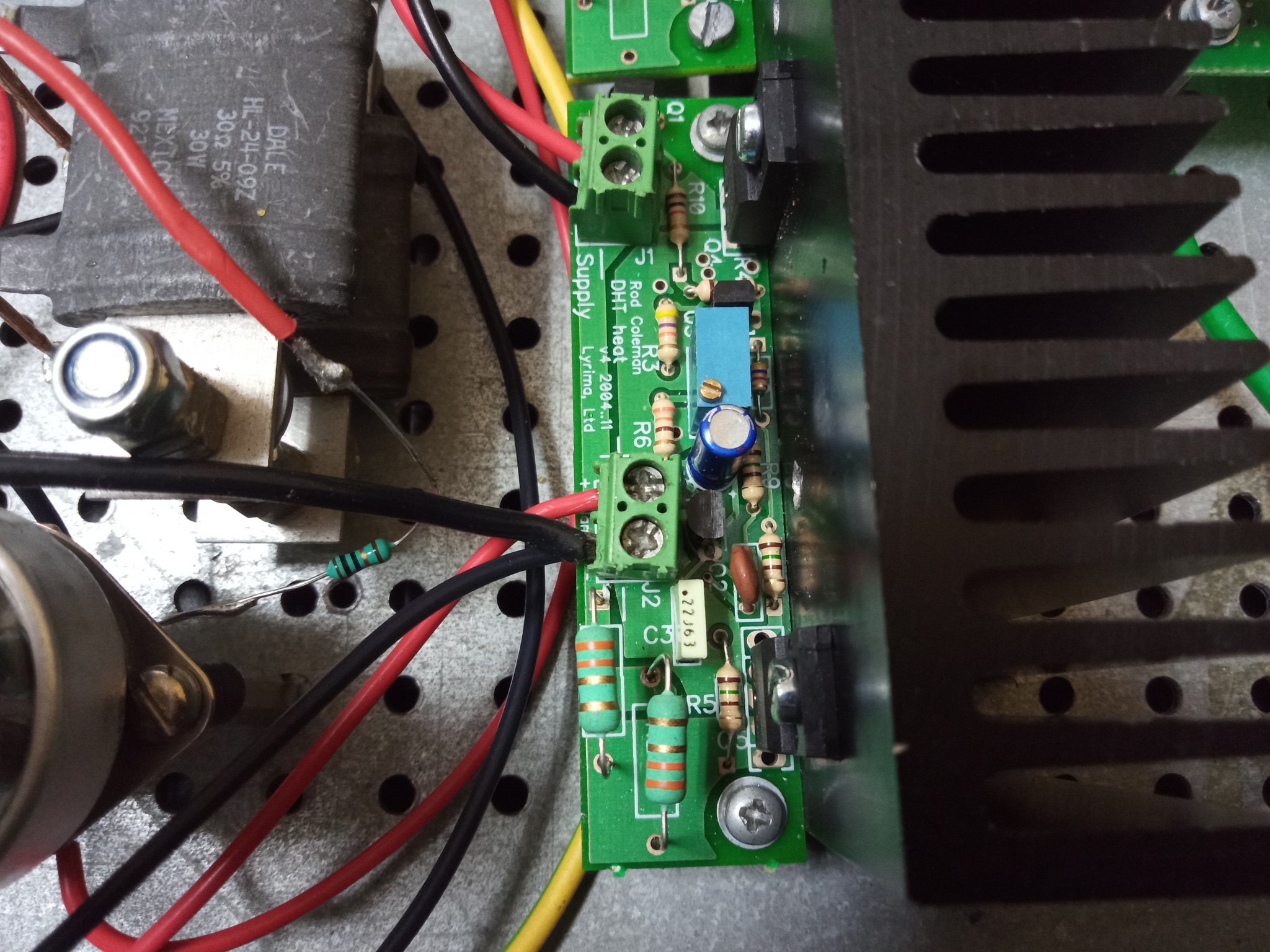

Are you sure, that R.C. all component is OK?
Rset is 3R3//3R3.
If you tested the raw supply without R.C, the dummy load resistor value must be 27R.
17.7V/27R= 0.655A

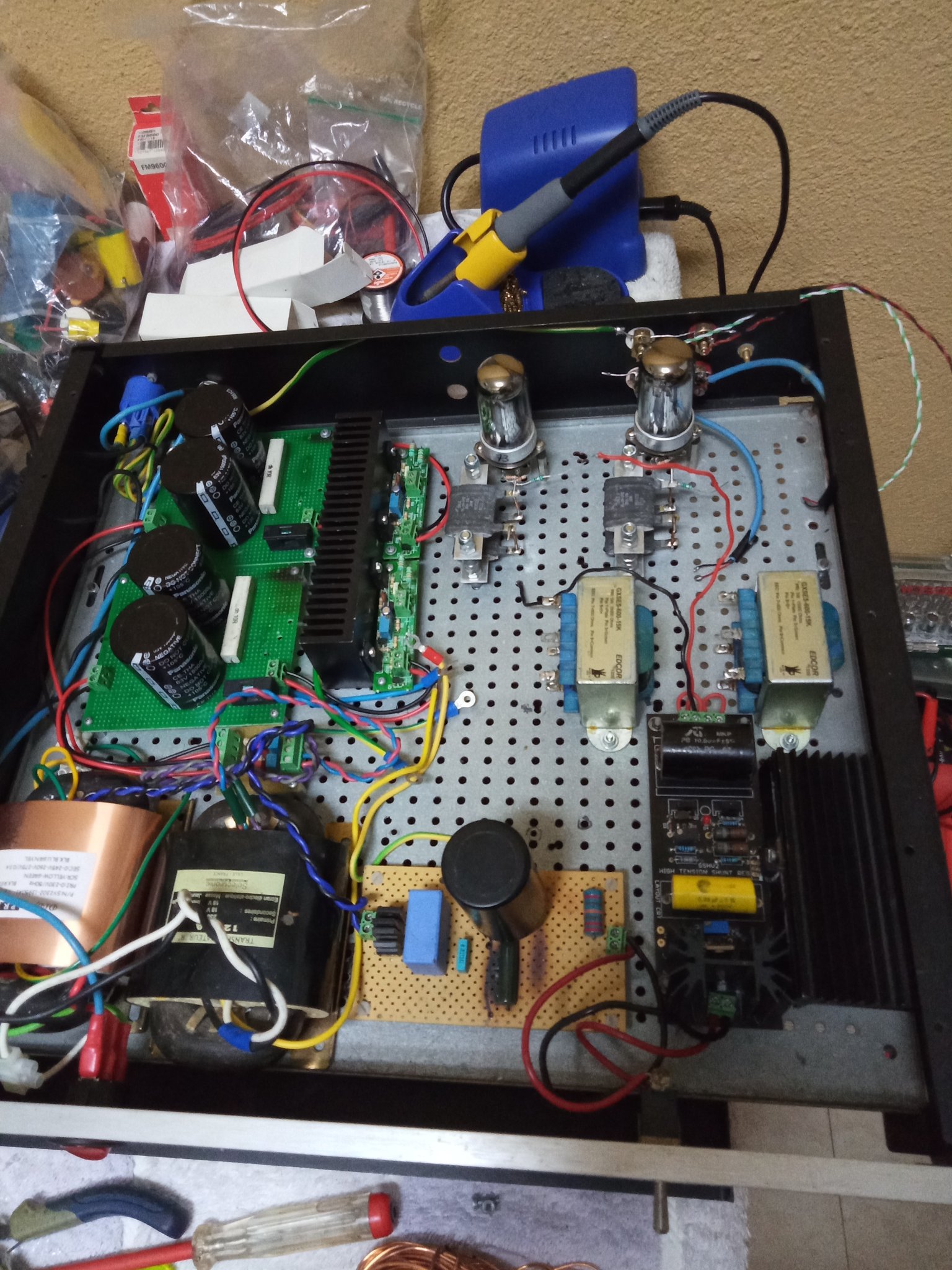

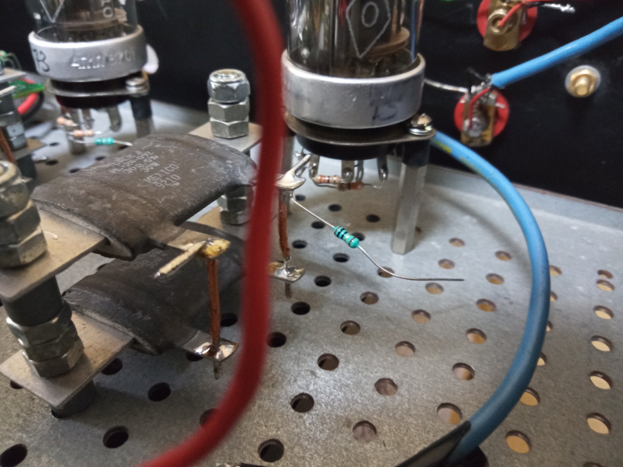

Attached pics with measurements, now two 10R in each +- rails.
