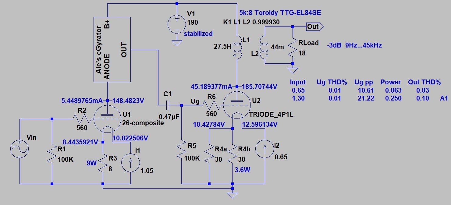

What about my calculations for selected bias 28mA, Ih-600mA, -20V BIAS, 235Va?

For 650mA could I use these 30R 1% 50W non inductive resistors?

-20V bias requires 18.95V (20-(2.1/2)) on filament bias resistor, so with 0.65A current the required filament bias resistor is 29R ... practically 30R (12.66W dissipation!). At least 50W resistor required, with heatsink!
Choosing 15R the dissipation only 7.2W. The resistors in #55 post are perfect, even without heatsink (only passive air flow -6..8 holes- required).
BTW, why 20V?
The assumed output power only few hundred mW, so practically any operating point (around 30mA anode current) between 10 and 20 can be used.
If you choose lower value, the filament bias dissipation will be much lower.
If you use for first stage gyrator loaded #26, as in #72 post schematic shows, even 190V B++ is enough.
+260V is totally unnecessary for power stage: wasting power, high heat production, expensive filament bias resistor, more expensive R.C. power supply.
Otherwise regulated power supply recommended for power stage (the first stage gyrator serves the #26 at any B++ voltage greater than 180V). The headphone amp generally requires clean power.

My idea it's to make the 4P1L in a separate box from the 26. What do you think?

Yes.
Be sure, that OPT tolerates anode current.
If you want to use first stage in separated box, C1-R5 (probably 470k) is will part of preamp and another 100k grid leak resistor needed for power amp.
BTW if you make "Line out" output from "Ug" and use switch to turn off power amp supplies (from +190V and R.C. transformer), the integrated amp can be used as preamplifier.

10.43+2.1+3.5= 16.03V raw supply output.
I would use at least 17-18V raw supply.
Do you have V9?
V4 requires more headroom than 3.5V. I usually use at least 5V headroom for V4.
If you have both versions, I would use V9 for #26 and V4 for 4P1L (there is not so important the better quality, than in preamp).

Thanks Bela, several questions more to be sure before make the headphone amp:
1-Filaments have to be connected parallel for 2.1V: pin 1 & 7 together and 8 filament center-tap?
2-Have I to connect 300R resistors between anode & pins 3 (2nd grid) & 4 (3rd grid)?
3-Pin 5 to GND?

Bela have I to use 4,7K for R8?
Yes.
The value is not extremely critical, between 4k2-4k7 still working.
"4.7K for 14V of filament bias (Regulator output = 16,1V, Supply input = 21,1V)"
As you can see Rod also recommend 5V headroom for v4.
