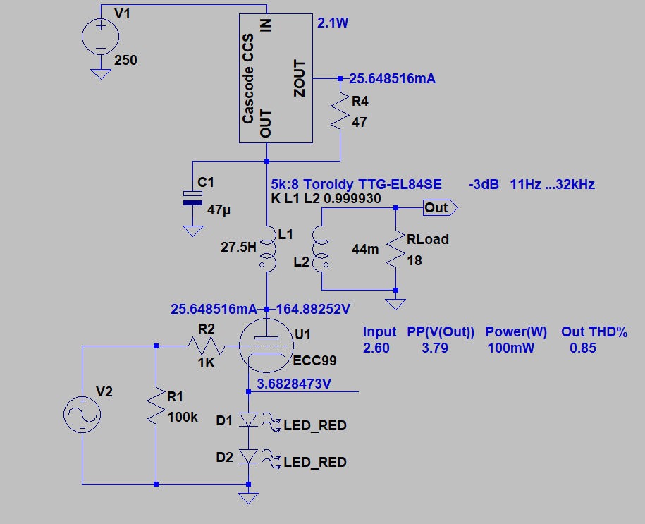

B+ MUST be equal or greater, than suspected anode voltage + half of required anode voltage swing + 20..30V headroom for CCS.

I don't understand how here https://www.mvaudiolabs.com/tubes/tube-data-library/4p1l/ can reach
Ia-35mA, Ia-600mA, -9.3V BIAS, 165Va?
While I wait the OPT for headphones just curious how it works as preamp.
N.B. to have 35mA Ia 620mA -9.3V Bias Va 185V
What's the anode voltage swing or how can calculate or measure?
If you want to use CCS loaded tube as preamp output swing for example 6 Vpp -3V peek- (little over 2V RMS), the required B+:
Ua+Vp+20V (for CCS)
185V+3V+20V= 208V
For a little headroom use 220V as B+.

Bela with Va 185V & CCS 41mA doesn't sounds good, music stutters and flaps. With Va 165V & CCS 23mA sounds without stutters and flaps. Now I will try Va 130V 9mA & let you know.
Va 130V CCS 9mA doesn't sound good the music flaps but no stutters surely need more B+ or more CCS or both.
It's very fun & time consuming and you have to be patient to find the sweet spot for the best sound quality.
