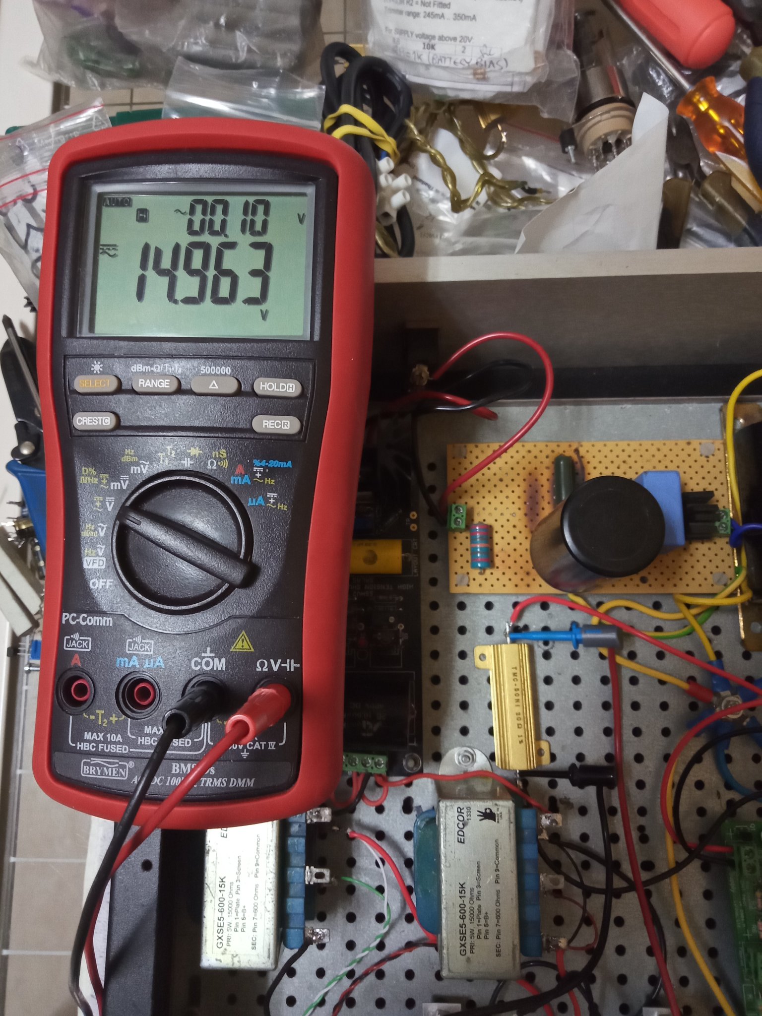

PSU Voltage across 30R (don't have 27R) = 14,96V it's enough?
Why???now two 10R in each +- rails.
It's (if current is 0.65A): 20R*0.65A= 13V wasted voltage.
Set the raw supply loaded output voltage to 18V with 30R as dummy load (0.6A).
Measure C1 voltage if output of raw supply is unloaded.
If it -for example- 21VDC, for loaded (0.6A) output R1 value:
(21V-18V)/0.6A= 5R.
Paralleled 10R resistors.
If you want to use two resistors (only dissipation limits justify this, only one is suitable), use two 2R5.

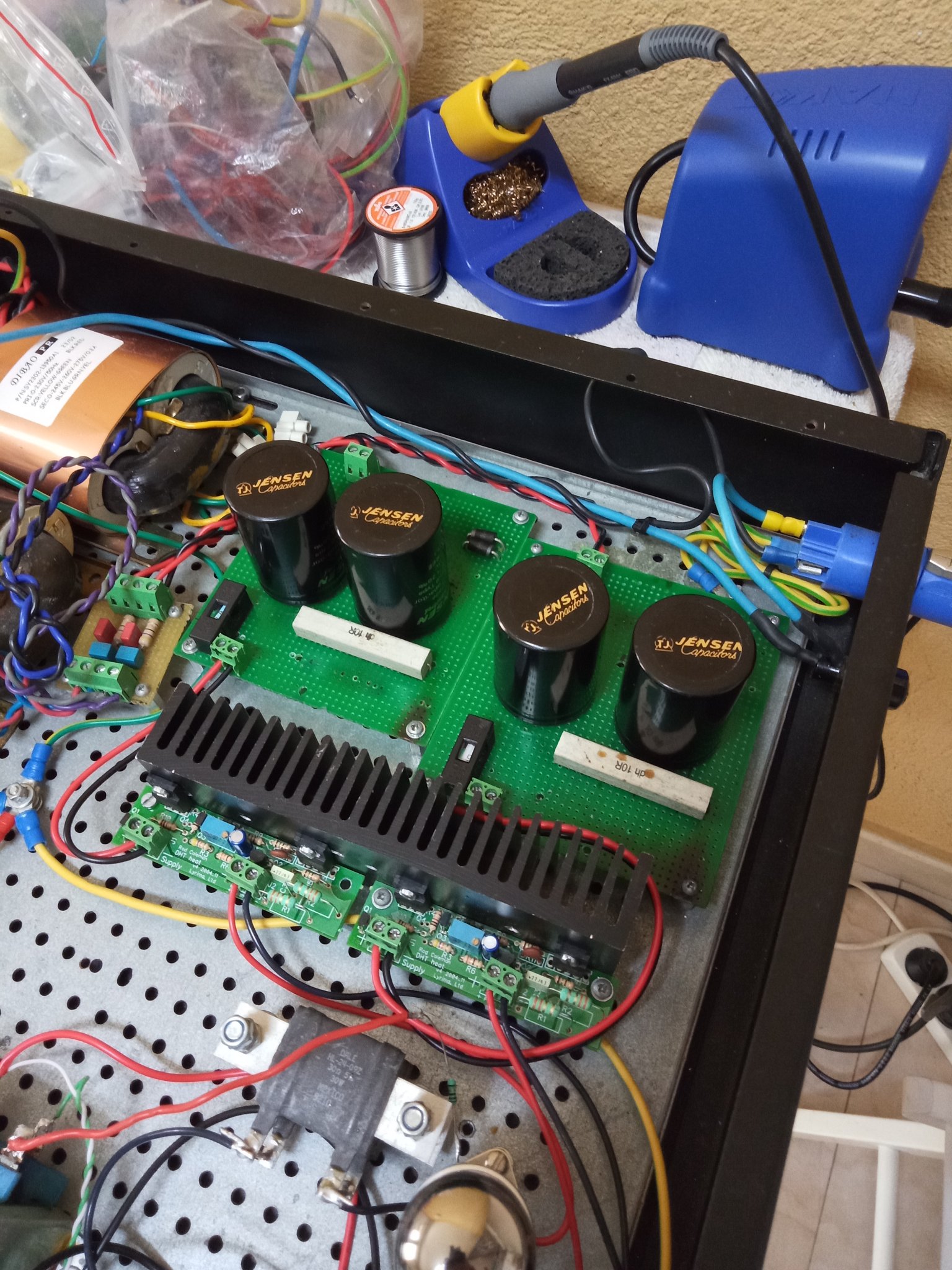

Lowered to 8R2 only + rail
Vin 18,xx
Vout 16,xx
Voltage filaments 3,57V
Now worse, it seems clearly the reg. doesn't work
Vin 18,xx
Vout 16,xx
R.C. current setting (with trimmer) due to the CCS section, so if you test it with 18R dummy load, it turns out that it works or not.
If you haven't 18R, even with 15R the 0.65A can be set.
