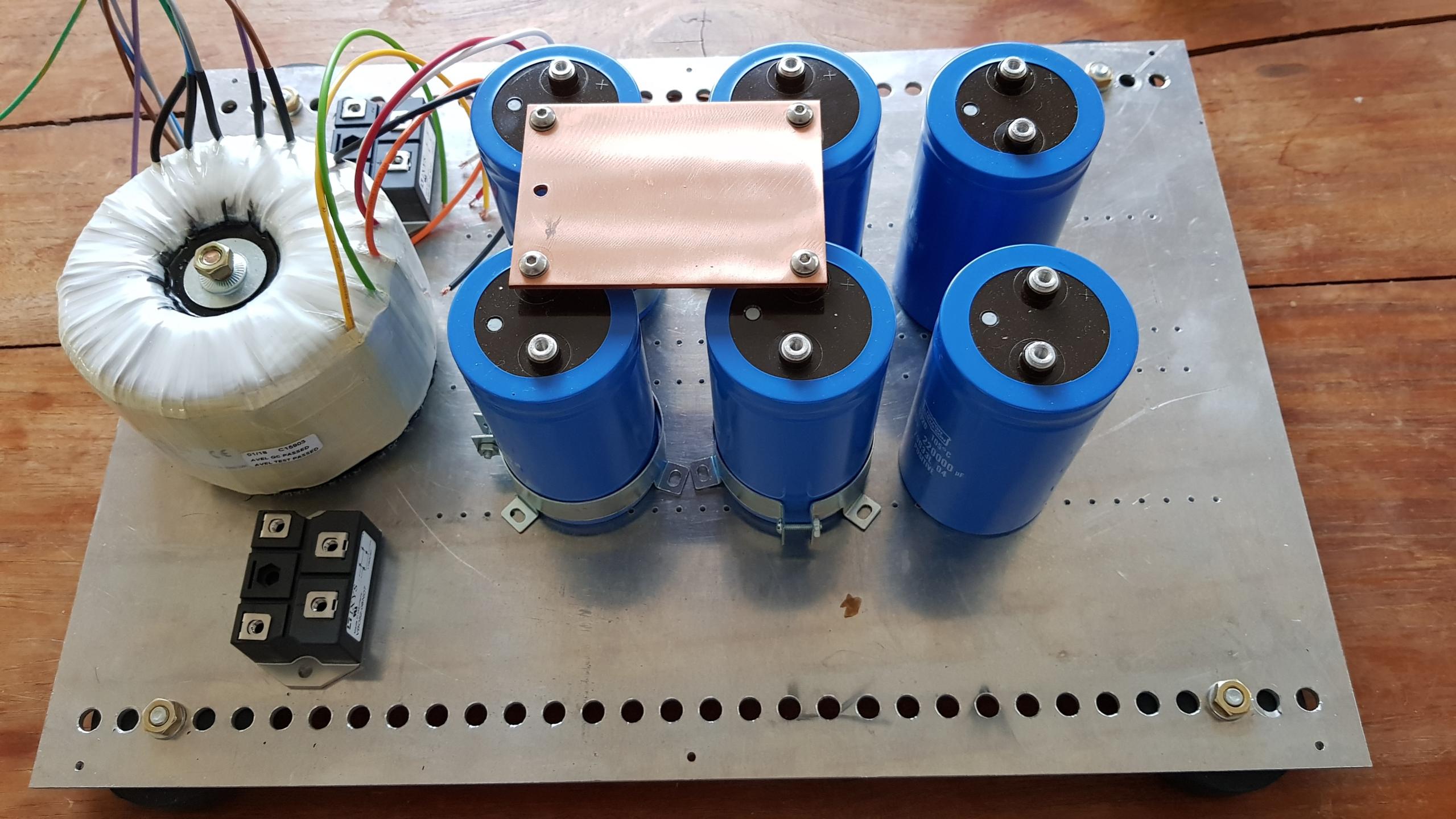

Ok you want porn.
Here ya go.
1,320,000 uF
I got a little cap the size of a walnut with 4 times that capacitance😀

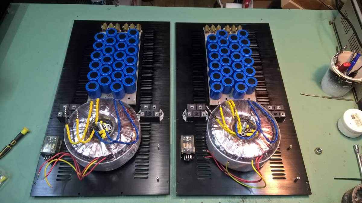

Holy soldering smoke that is THE PSU's !these are for Sissies
Superb power wire wound resistors for CRC as well
excellent choice , sound goooood & not Sissies build
Applause
Relays contact are evidently georgeus top quality !
Understand better why Zen Mod write : " Life is good "

Better have first caps after primary in CRC string with less ~ 50 KuF capacitance.
Small +R+Big or
Small +R+Big +R+Big Cap
Just my 2 uA
