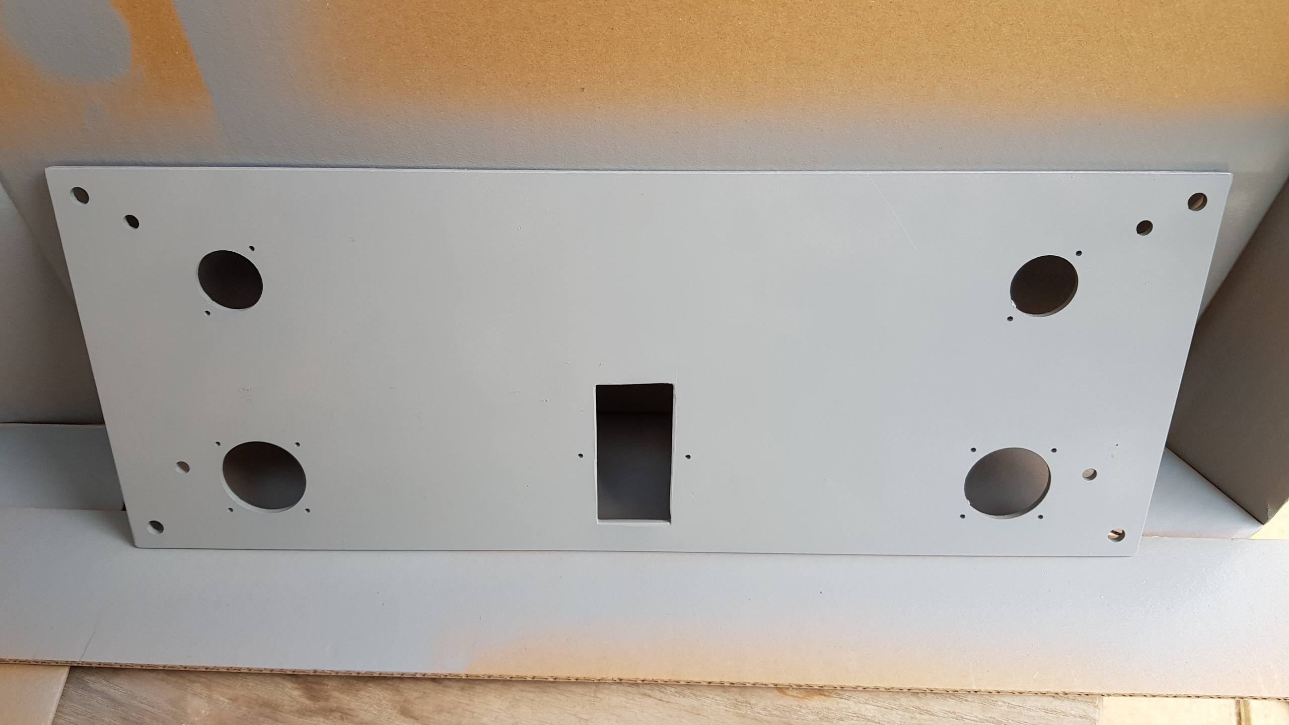

Starting to feel unlazy.
Putting on primer coat.

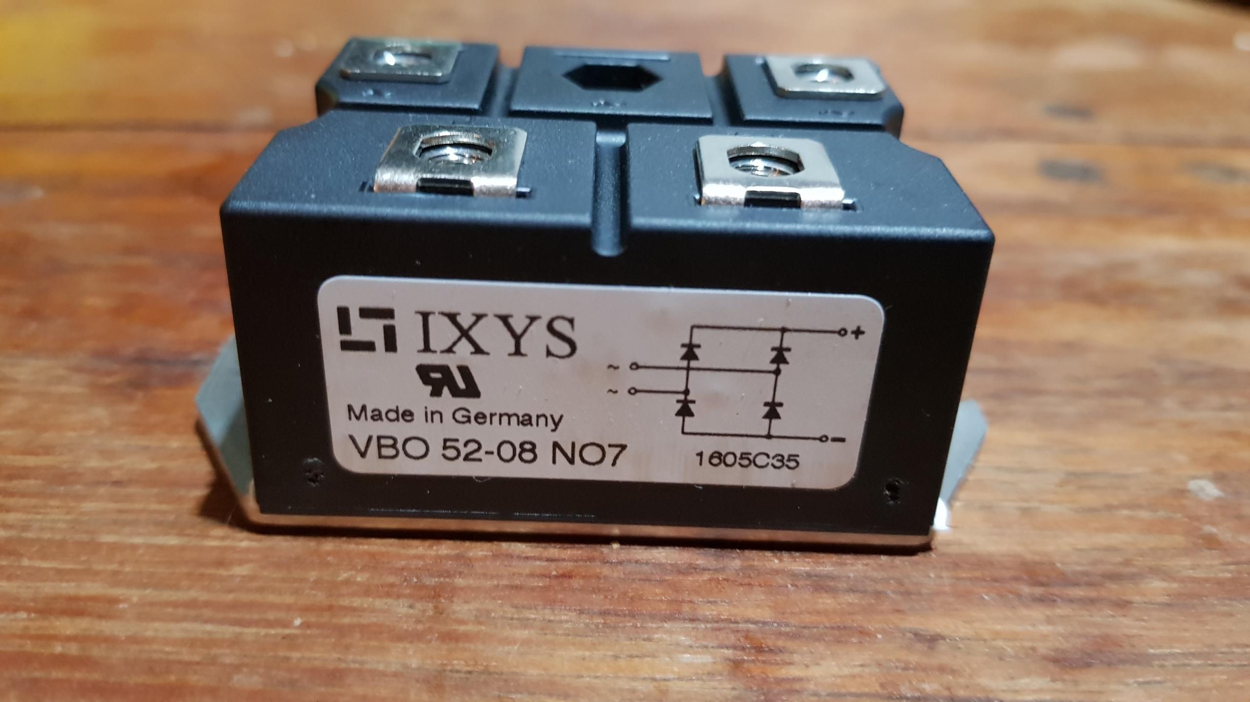

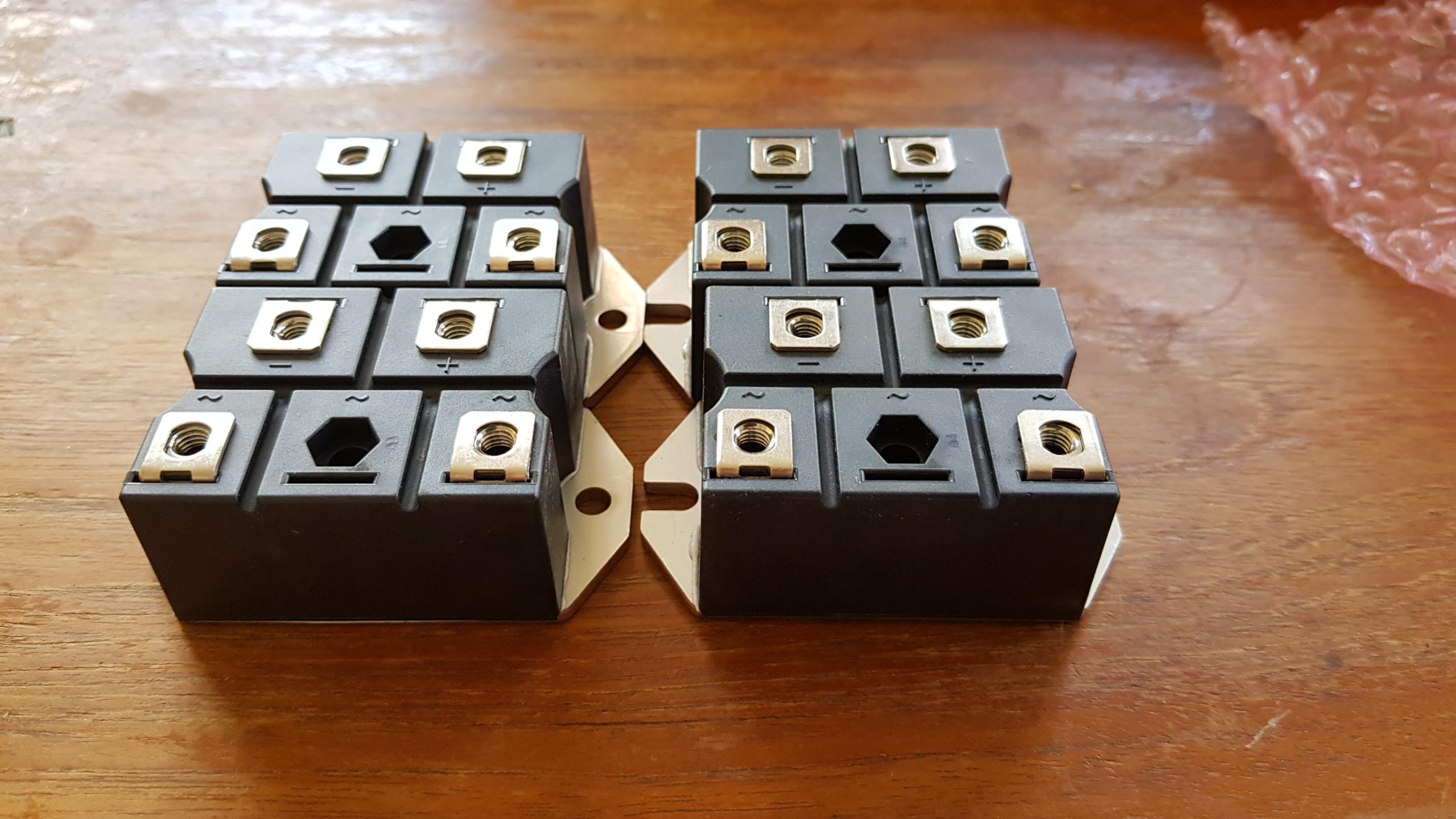

Jeez, what monsters - these make the big Semicron's look small!
