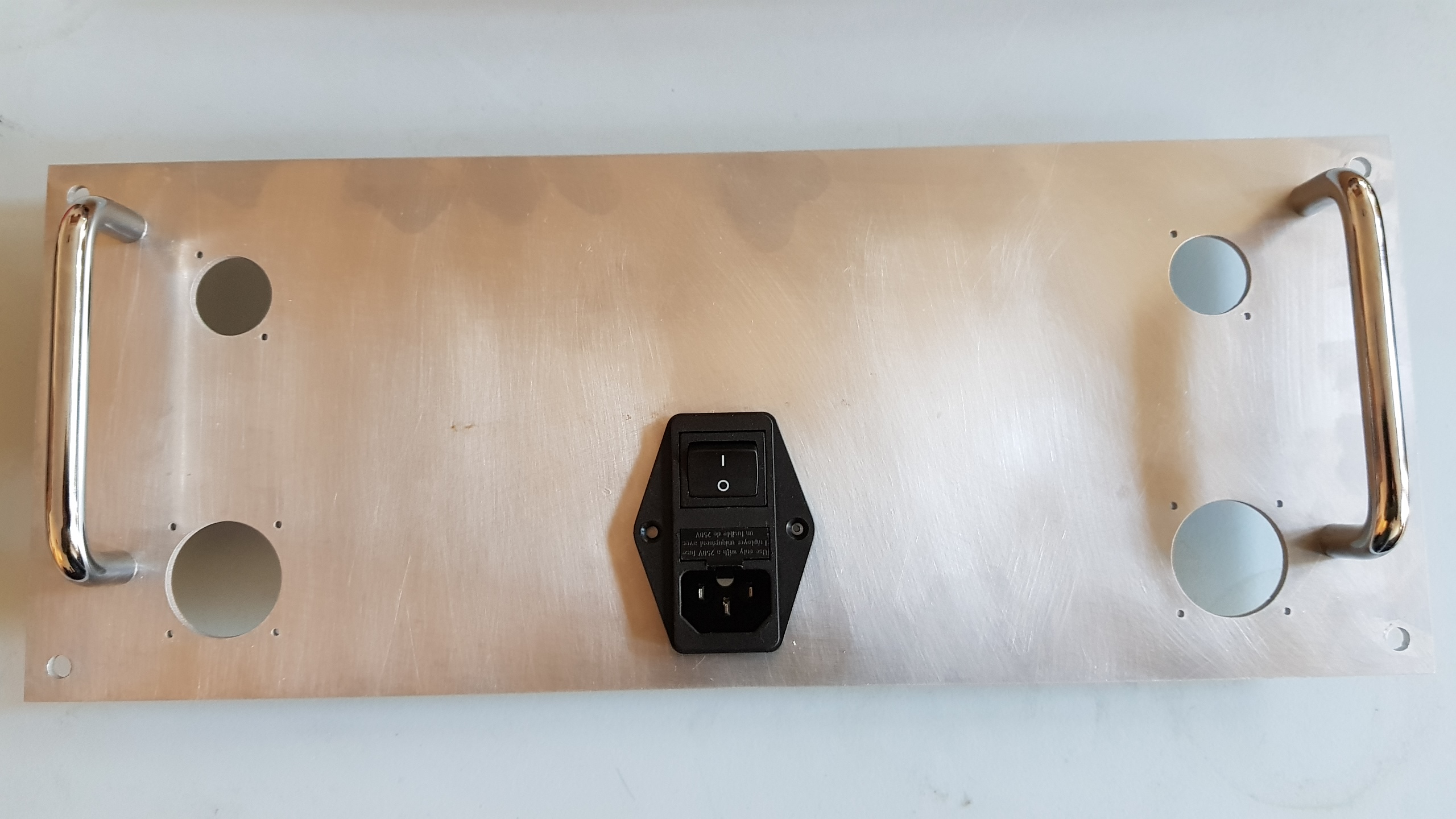

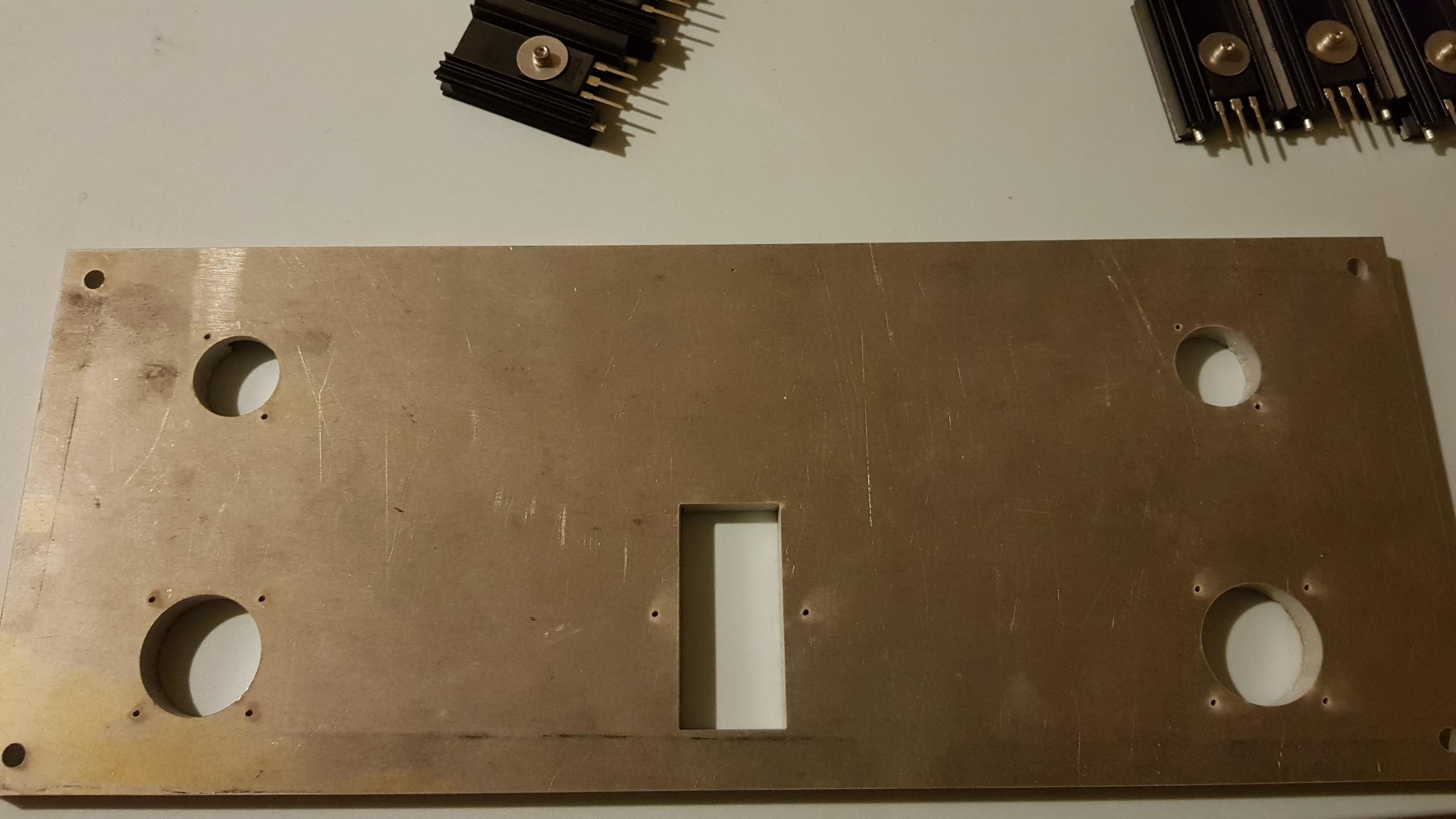

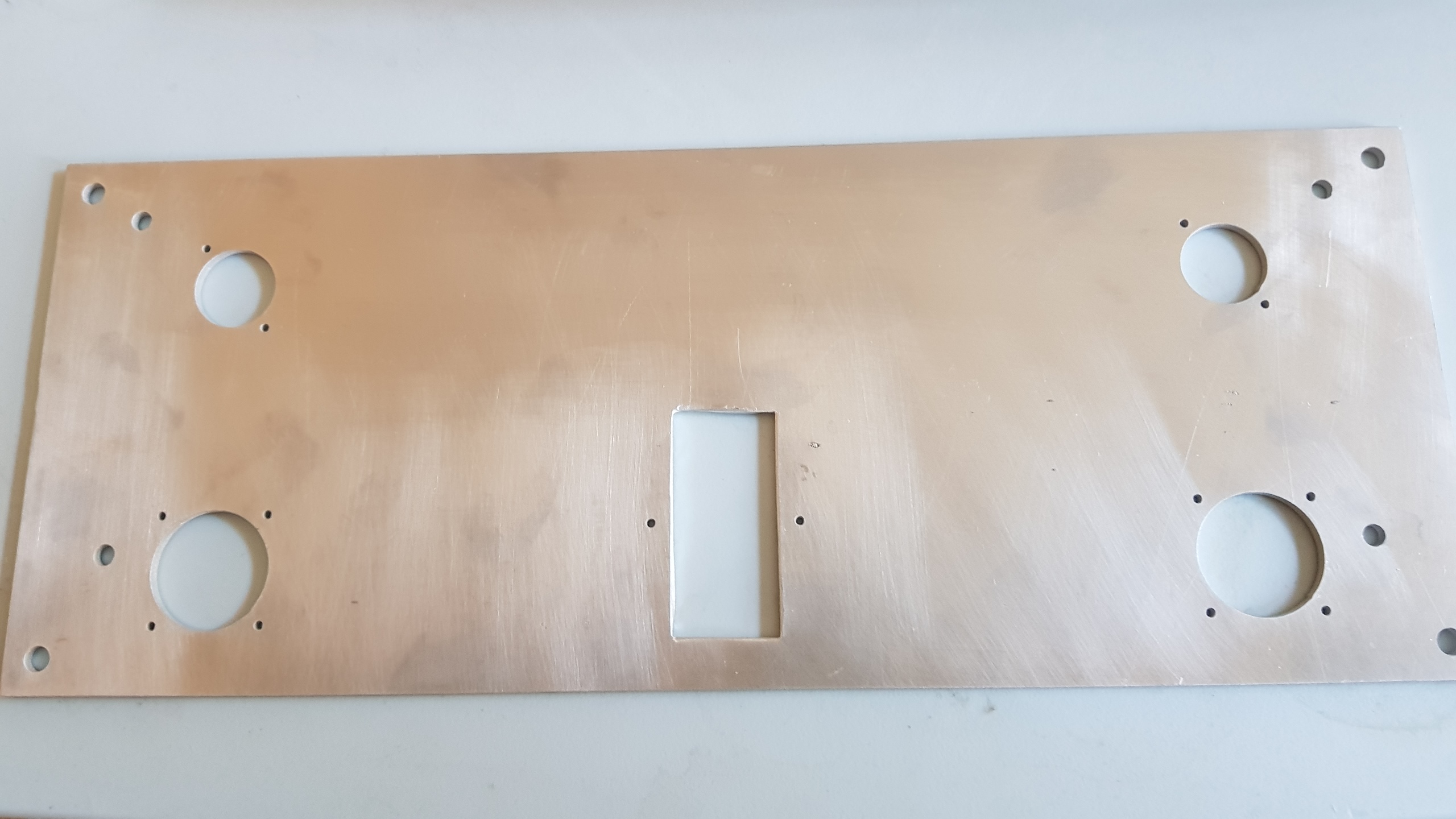

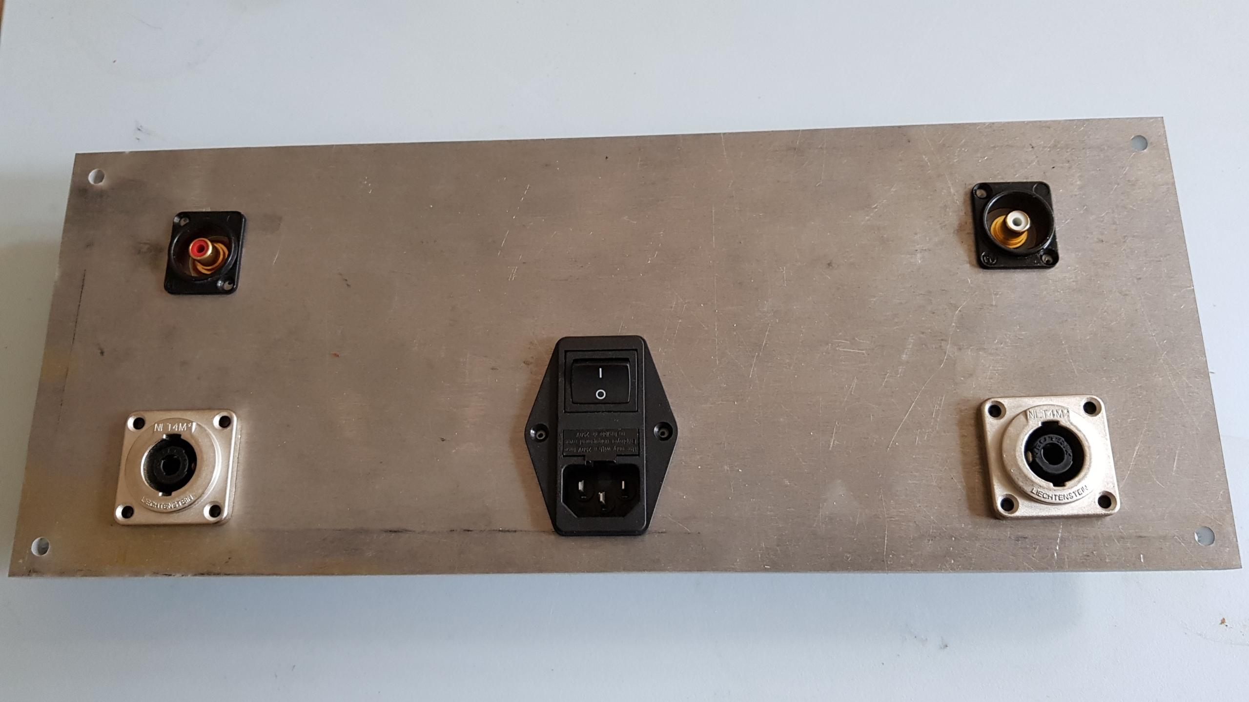

Everything fits, however the recommended neutrik rca hole diameter of 23.6mm is far bigger than necessary, should be no larger than 22mm.
You could maybe add a couple of those nice handles (ie. Prestige, Bunnings 3962333) to protect the cables and assist handling
Used them myself - very useful - curiously, on the front panel they were a PIA - just got in the way all the time and looked 'industrial' even on the big 40kg amp - meant to add wheels ...
.. I meant to add -

Thanks to James for encouraging me to put the handles on.
These monoblocks are gonna be bloody heavy and I'm not getting younger.
Yeah, 'that's the go' - saves an enormous amount of agro later
