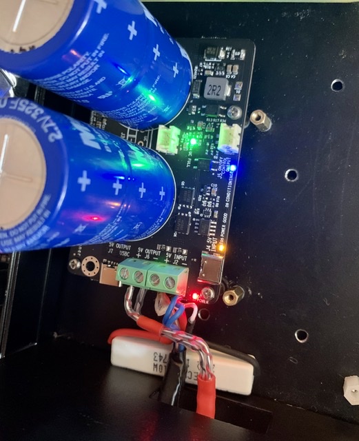

I have a friend who works at a power supply company and he can help me. Can you tell me how to modify it?
UcConditioner installed on the clear side of fifopi can be heard the difference. There are two more sets of UcConditioner to see how to plan the configuration. thank.
it works...
thank you Ian!!
Is the discharge resistor installed at the power input? 😎
@mksung
Congratulations! What the ultra capacitors are you using?
Ian
@mksung
I follow the manual and get BCAP0325 P270 S17 from mouser.
Ian
The output is a bisesik transformer, and the sound is very detailed. It was originally output directly to the post-amplifier, but the sound is quite sharp, so the output is changed to the pre-amp and then the post-amp of the vacuum tube to increase the charm of the vacuum tube.
