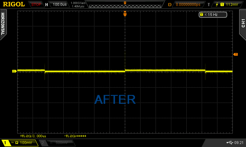

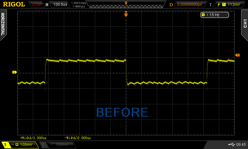

How much imorovement that a ConditionerPi can make to a RPi DAC
I did listening tests to some popular RPi DACs without and with a ConditionerPi. I used just a normal 2A USB adapter as power supply for my RPi 4.
The improvement was very clear after install a ConditionerPi on top of the RPi.
I didn't do serious tests as well as long time break in. Just with simple setups, I've already felt much more details and more air surround environment. Higher sound density. Bass was deeper and solider. Much musical than before. I have a sound tracks that was felt too noisy to me now plays very nice at same DAC. I spent a long time really enjoy listening to the new discovery from that music.
As an engineer, I need to know how much improvement it made, so I did another dynamic load transient response test. The step of the demand current of the dynamic load was 500mA. The steps was switching at 1KHz frequency. Please find the attached waveform of output voltage rail before and after a ConditionerPi.
Thanks for the new released 10F/3V ultra capacitors. The finial performance is better than I expected though both capacitance and size are smaller.

Does make any sence to use batteries or linear pover supply before uc. because looking to the test results seems all prity much the same regardles of wats in front of uc.
@Arunas
A linear power supply is still the better option before ConditionerPi. Because switch mode power supplies have some very high frequency noise at output which can not be removed completely even by ultra capacitors.
