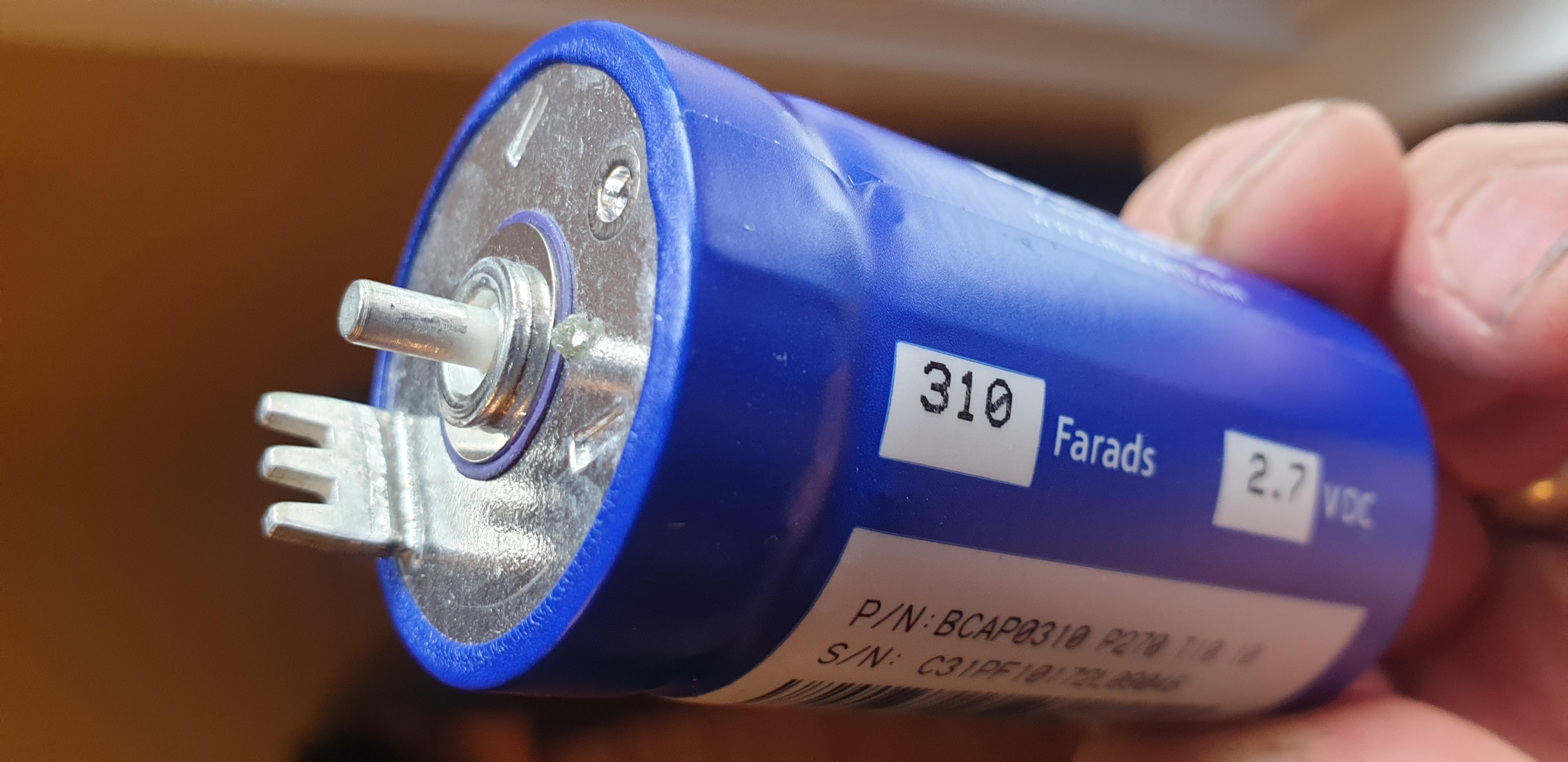

Ian does the board accept BCAP0310 P270 T10. I thought the 3 holes aligned maybe so.?
It could be, but need to confirm. I don't have this uc buy you can try if you want.
