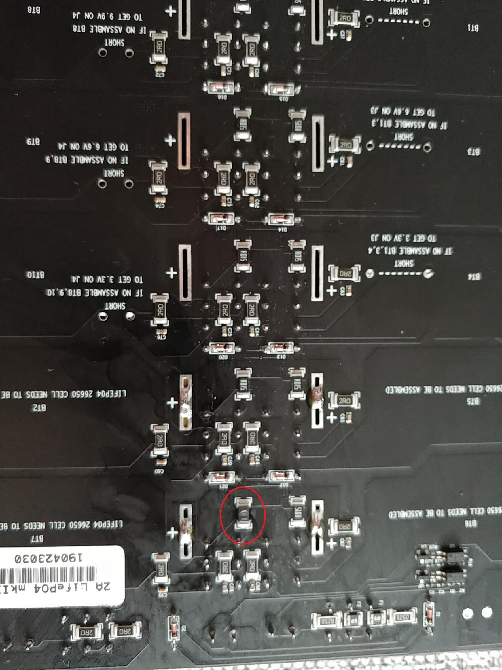

I did some tests, separating the stack and powering just the whistling unit with different 12V power bricks. The result is same.
Then I tried different batteries and also without any, which also produced the whistling while connected to power bank. Unfortunately, putting back the batteries I was able to reverse terminals on BT7 and create some smoke. Looking at the back, seems that one of the R015 resistors is burnt. Image attached.
The unit can still turn on and provide voltage. I have not yet connected it to DAC though, just to be sure.
Please advise, how to proceed.

@nielsek,
That the unit still turns on suggests you might be good by just replacing that resistor. Go back over the posts in this thread for the last 2-3 weeks to find the PN.
The output power SHOULD still be ok, though I suggest measuring it. When the unit is turned on, the relays connect the cells to the output... when off, to the charging circuitry. So the on-state is likely not affected. BUT AFAIK, it won't charge that cell correctly.
Sounds like you haven't yet tried the lab supply with the output voltage limited to 19V. Please try that and let us know if the whistling still occurs. Sorry, I have not powered mine with 12V supplies... I'll look around and see what 12V supplies I have that would be appropriate and give it a try.
Finally, if you have not yet color-coded your cells for polarity, please do so. That has helped me NOT connect them in reverse-polarity.

Thanks Greg. I did look for .015R resistor PN but couldn't find it. Did order these ones WW20NR015FTL WALSIN - Resistor: power metal | TME - Electronic components, 2010 casing.@nielsek,
As I'm not using the 3.3V-13.2V rails, could I just swap one .015R resistor from there, until I have sourced for new one?
Concerning testing different power supplies (12V > 19V), the other LiFePO4 unit fully loaded with 10 batteries works correctly with all my 12V supplies. Of course I will proceed with testing different AC-DC adapters. I just don't think the whistling noise is caused by that.
The lab supply I have, probably didn't have enough power. I did test it with full stack (2 LiFePO4 units and 12 batteries).
Thanks for the help, hopefully I'm able to replace the resistor and test more.
@nielsek
R015
Digi-Key Part Number: WSLE-.015CT-ND WSLE-.015CT-ND
Mouser No.: 71-WSL2010R0150FEA
Manufacturer: Vishay Dale
Manufacturer Part Number WSL2010R0150FEA
I think is important, the orignal: Current Sense Resistors - SMD 1/2watt .015ohms 1%

@Deenoo, THANKS on the .015R PN! You were faster than me.
The PN for the ones marked 2R0 is:
Digi-Key Part Number 541-2.00ACCT-ND 541-2.00ACCT-ND
Manufacturer Vishay Dale
Manufacturer Part Number CRCW20102R00FKEF CRCW20102R00FKEF
Description RES SMD 2 OHM 1% 3/4W 2010
Greg in Mississippi
P.S. @nielsek, I just noticed in your picture you added the jumpers on the cell positions closest to the cells you have in place for the 3.3V-13.2V, but not for any of the other positions. You have to have a jumper in every position where there is not a cell. At least that is what I found when I traced the cell circuit and what worked on my setup.
When I finally get around to updating the manual, I will make that clearer.
Greg

First I thought I need 3 additional rails for the DAC, but 2 was enough, so I just used BT6/7.P.S. @nielsek, I just noticed in your picture you added the jumpers on the cell positions closest to the cells you have in place for the 3.3V-13.2V, but not for any of the other positions. You have to have a jumper in every position where there is not a cell. At least that is what I found when I traced the cell circuit and what worked on my setup.
I used my lab supply with 19V and no more whistle! It's only there when using 12V bricks. I didn't have much time today to use more voltages but will try that in near future.
I checked the burnt R015 sense resistor and it's still working. Just to be sure, switched it with a fresh one from a rail I'm not using.
The strange thing is that for 5 seconds the Lifepo4 unit is charging and then 5 seconds pending and so on. Both when using 19V or 12V brick. When using the latter, the whistling sound is changing a bit, from pending to charging.
I checked all the resistors on the back with multimeter, they were all OK.
Also connected the 2 rails to DAC and everyting is OK, of course I won't risk it with charging as it keeps changing from pending to charging every 5 seconds.
Unfortunately I can't be 100% sure if this was present before I reversed the battery. I used this Lifepo4 unit just for few days and it was stacked under the other one, so didn't see the OLED correctly.
What should I test next? Batteries are running empty while listening good quality audio, need to get them charged 🙂
