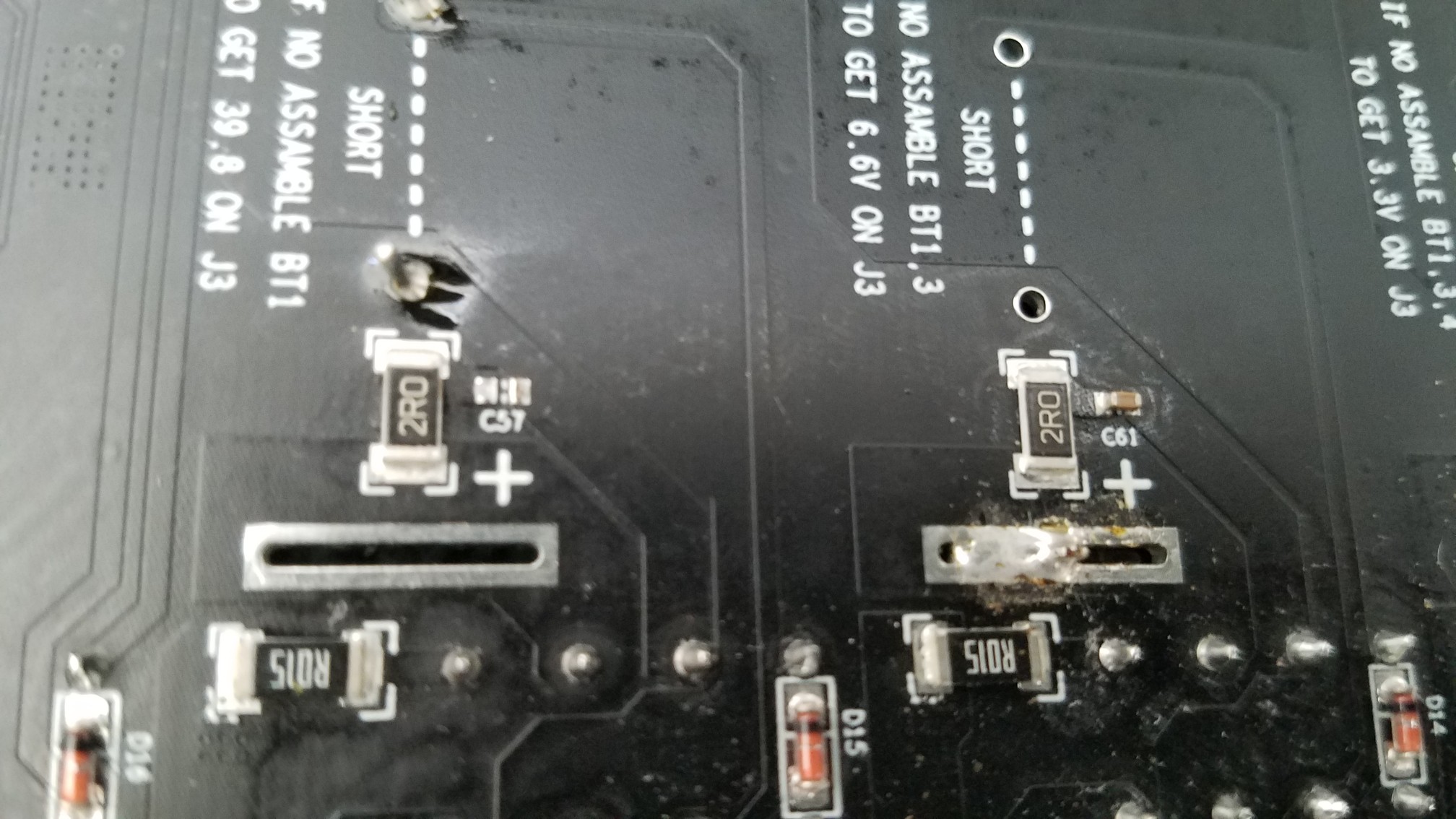

Everything was looking good and working as designed. I went to measure the output voltages before connecting any loads. Batteries are charged and display reads "pending". I turned-on the unit, relays click, display reads "ON", time starts counting down. Then after 10 seconds the unit turns off and reads, "short protection". For that brief time it is on, there is 0 vdc at J2, J4, and also J8 reads 0, even though it is enabled in the settings. I do have 3.3 vdc output at J1 and 9.9 vdc at J3, however. ( 8 batteries are installed and the last 2 jumpers in place.)
Also, I noticed a spot where one of the SMD capacitors on the bottom of the board near BT1 is missing, C57. Seems I may have a defective unit. What is the next step?
Thank you.

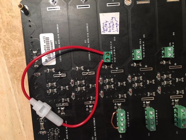

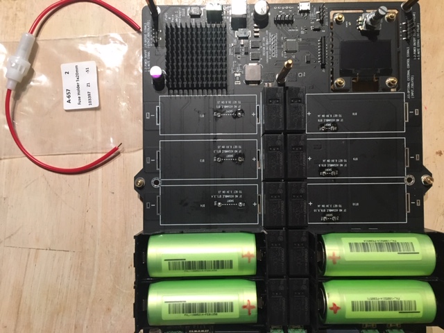

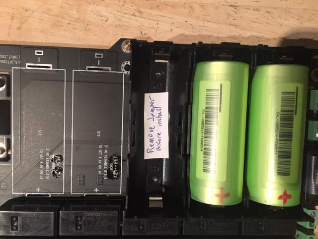

I also have the LiFePO4 Mk II version and have a similar problem:
I initially installed 4 batteries into the BT 4,5 and BT 2,10 positions (for a desired output of 6.6v at J3 and J4) but after powering it up got a "short protection" display and the unit turned off.
I then realized I hadn't put the jumper wires in to short the empty cells so did this but still had the "short protection" advice on power up and the unit turned off again.
I wasn't sure if batteries should be in the BT6 and BT7 positions so installed these and had some success as the "short protection" warning has gone and I now have correct voltages at J1, J2 and J4 but 0v at J3 (should be 6.6v).
Anyone got any ideas why the initial "short protection" warning came up and perhaps this is related to the problems we are both having?
Thanks.

@Heathkit and @marcus1, a few thoughts on your issues...
1. @Heathkit, can you post a picture of the missing C57 with some of the nearby components shown so others who have the MkII board can confirm the presence in their boards. Sorry, I don't have a MkII here, only a couple of the original ones.
2. Yes, AFAIK, BT6 & BT7 are required. I have powered the boards with NO cells installed and they stay powered for a few seconds and then drop out. They do this with no damage if anyone wants to try this themselves. I did not observe a message. I was not looking at the display, but instead using the on-time to trace connections for the jumpers.
3. I have one board with only BT6, BT7, BT2, and BT5 installed and appropriate jumpers installed so I get 4 3.3V outputs. It works ok that way.
4. Can you check your cell voltages both in the off state and when turned on before it cycles off. I wonder if one or more of your cells drop significantly or go to 0V, which would likely trigger the start up current protection circuit.
Curious what you find!

You can see C61 is present in similar position for the next battery, but C57 is missing, some residual solder sticking up as if it fell off before the solder hardened, not completely flat pads...

On the Mark II build I installed terminal blocks on the bottom side of the PCB. You can install the battery holder after, but must be careful not to install a jumper and battery at the same time! I consider using a fuse instead of a jumper for some safety in case of stupidity. This might be a good candidate:

@Heathkit,
Thanks for the picture of the missing capacitor. Looking at it (and locating the similar ones in the original boards), I don't believe that capacitor is critical to operation.
To help us debug this, can you provide:
- A picture of your whole board from the battery side?
- The off, then on (before it clicks back off) voltage of each cell?
Also, the area around the jumper position above the resistor next to the missing capacitor looks odd. Did it get damaged or is that just an artifact of the photo?
Thanks!
Greg in Mississippi

Thanks Greg for helping out on this. Yes, the photo has an artifact, the jumper area is fine. And I agree, looks like those SMD caps are for minor filtering and I doubt the missing C57 is causing the issues. I will take a few photos of the front of my board later tonight.
Over all, I would say the solder flow work on this board is not quite up to expected standards, at least comparing it to other boards I have from Ian or other group buys I have.
I did not see any change in voltage on the cells before and after attempting to turn the unit on several times and the unit running for 10 seconds then shutting off and displaying "short protection". I noticed that when it's off, all batteries on each side are connected in parallel, is that normal? So of course they all measure the same installed on the board, in my board 3.335 VDC. I will take them out and measure them individually later tonight. Btw, the first time I connected the power supply, it charged for maybe 20 or 30 seconds then went to "pending" and the green LED flashing, so it looks like my new batteries came fully charged.
