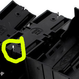

I don’t see any tabs on those holders - how do you connect them to the board?
Look closer and you shall see 😉
There are tabs but they are tiny, check attachment
Thanks guys I see them now. Ian must presumably be satisfied that they are up to the job.

The taps looks tiny but not actually that much because the 26650 battery holders are pretty big. I tested no problem for 10A charging current. Can be even more. So, just no worry.
