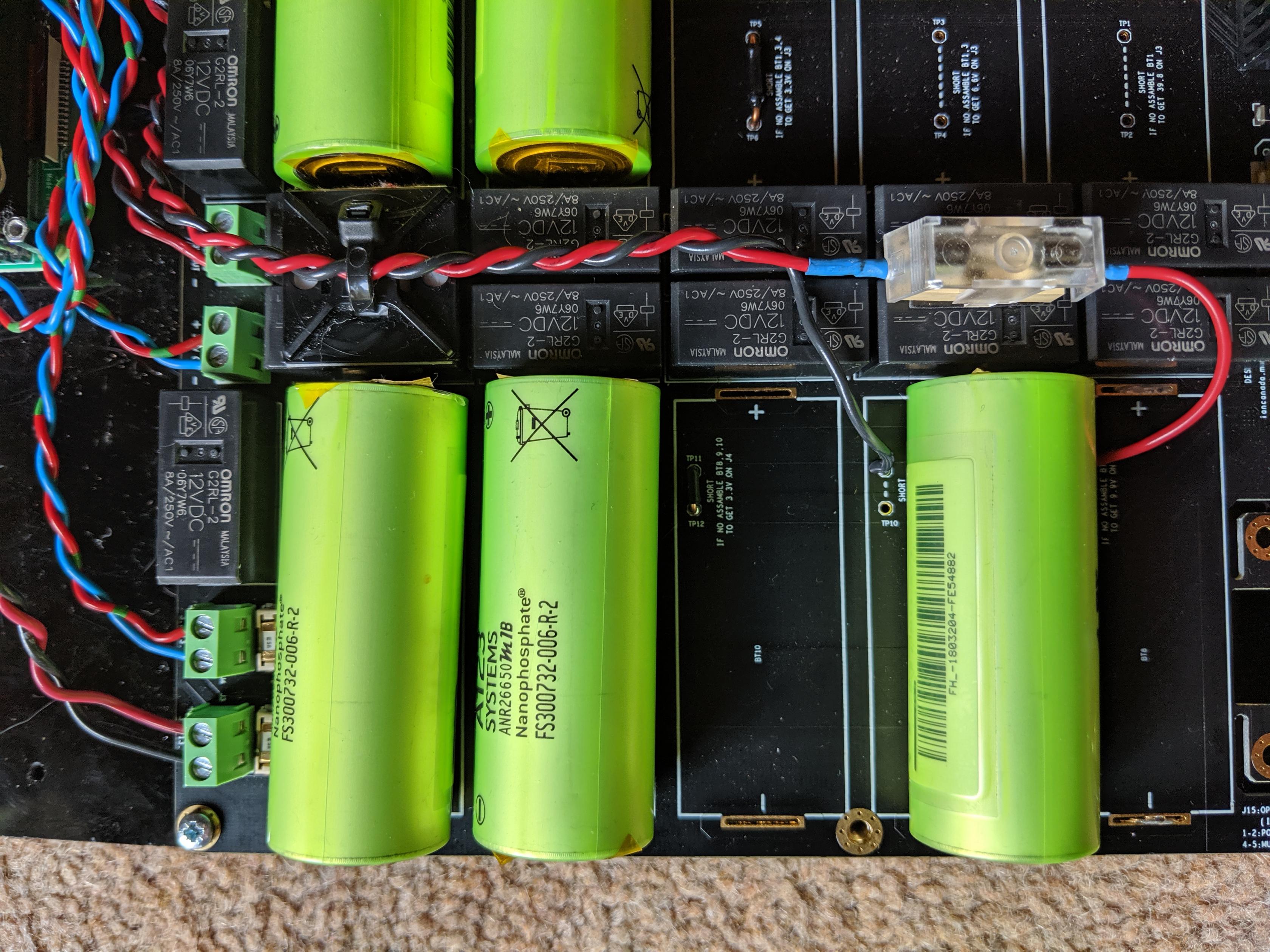

Thank you Greg and Simon for your suggestions, it helped track down what was going on.
It didn't make sense because the batteries all measured fine with it OFF, but when running, 2 cells measured 0 vdc. So that immediately told me either a faulty battery or holder. I tried swapping positions of those two cells and the zero volts situation moved with the suspect cells, so now I'm wondering how 2 out of 10 brand new cells could be bad?
Further testing with the unit running showed when putting the test leads on the holder terminals there was 0 vdc, BUT when you moved the leads in a bit and contacted the battery itself, then it was reading 3.3 vdc. What the heck!
It turns out 2 of my batteries were not making contact on the negative terminal in the holder due to the plastic center being slightly raised above the negative contact surface. See photo attached. These 2 cells were carefully corrected with an xacto knife.

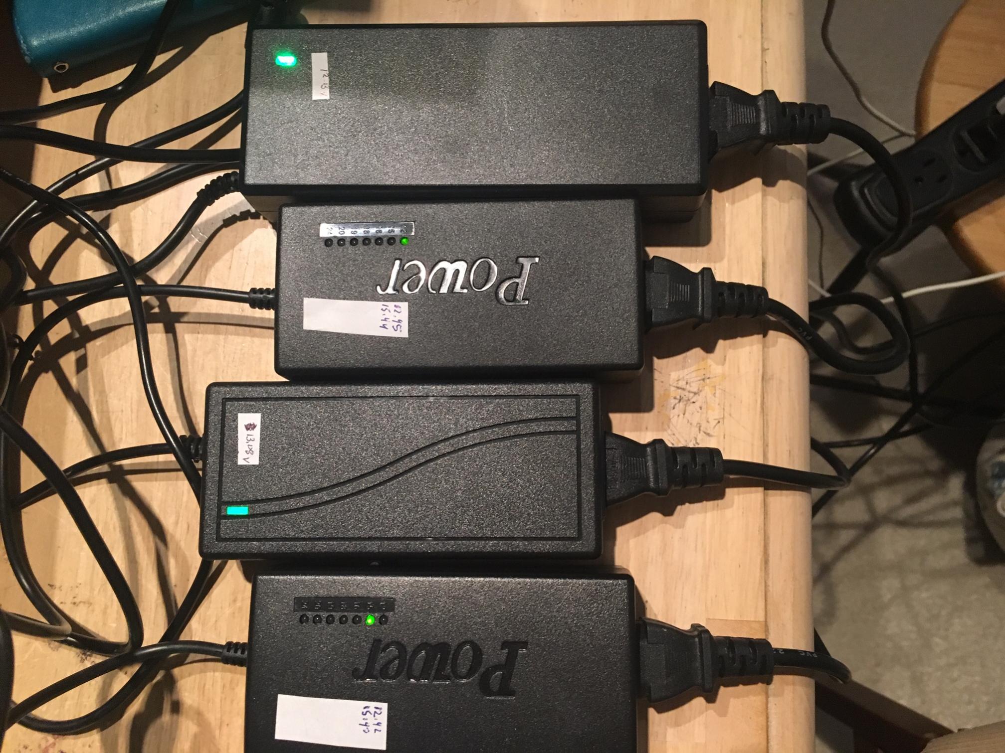

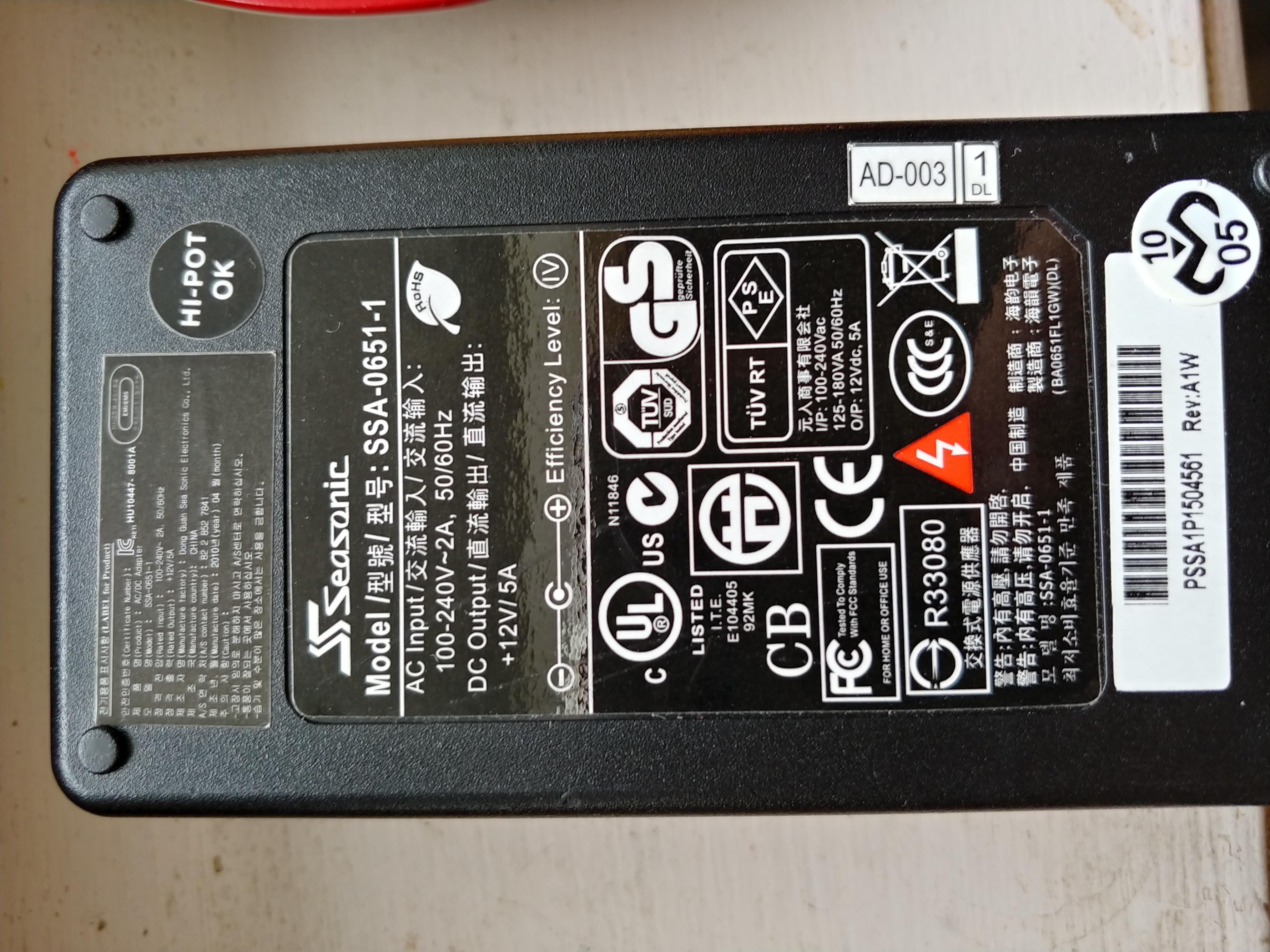

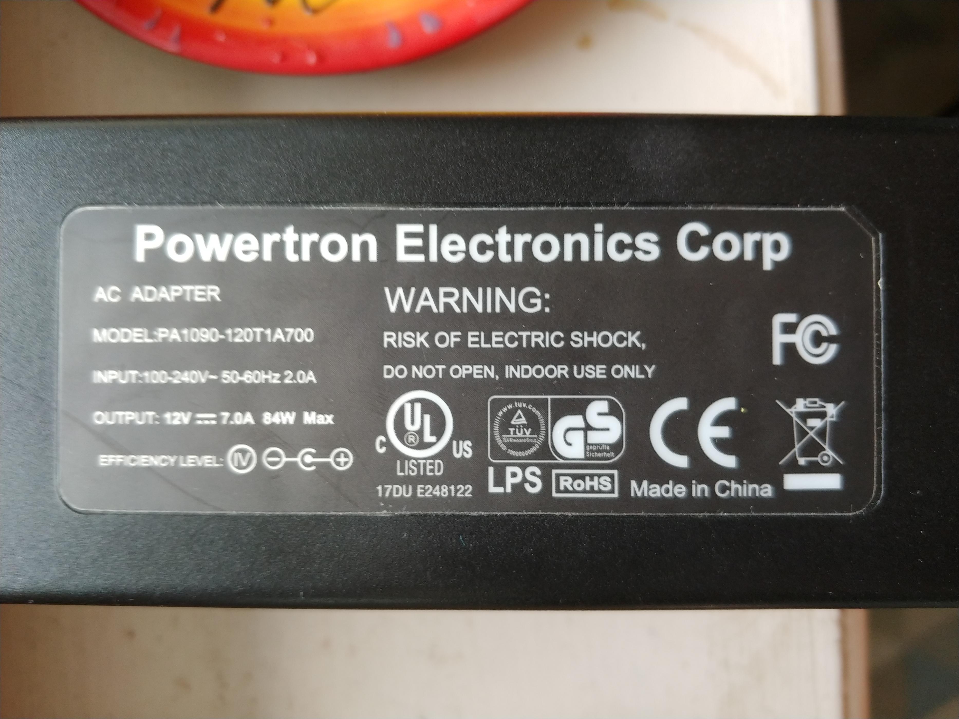

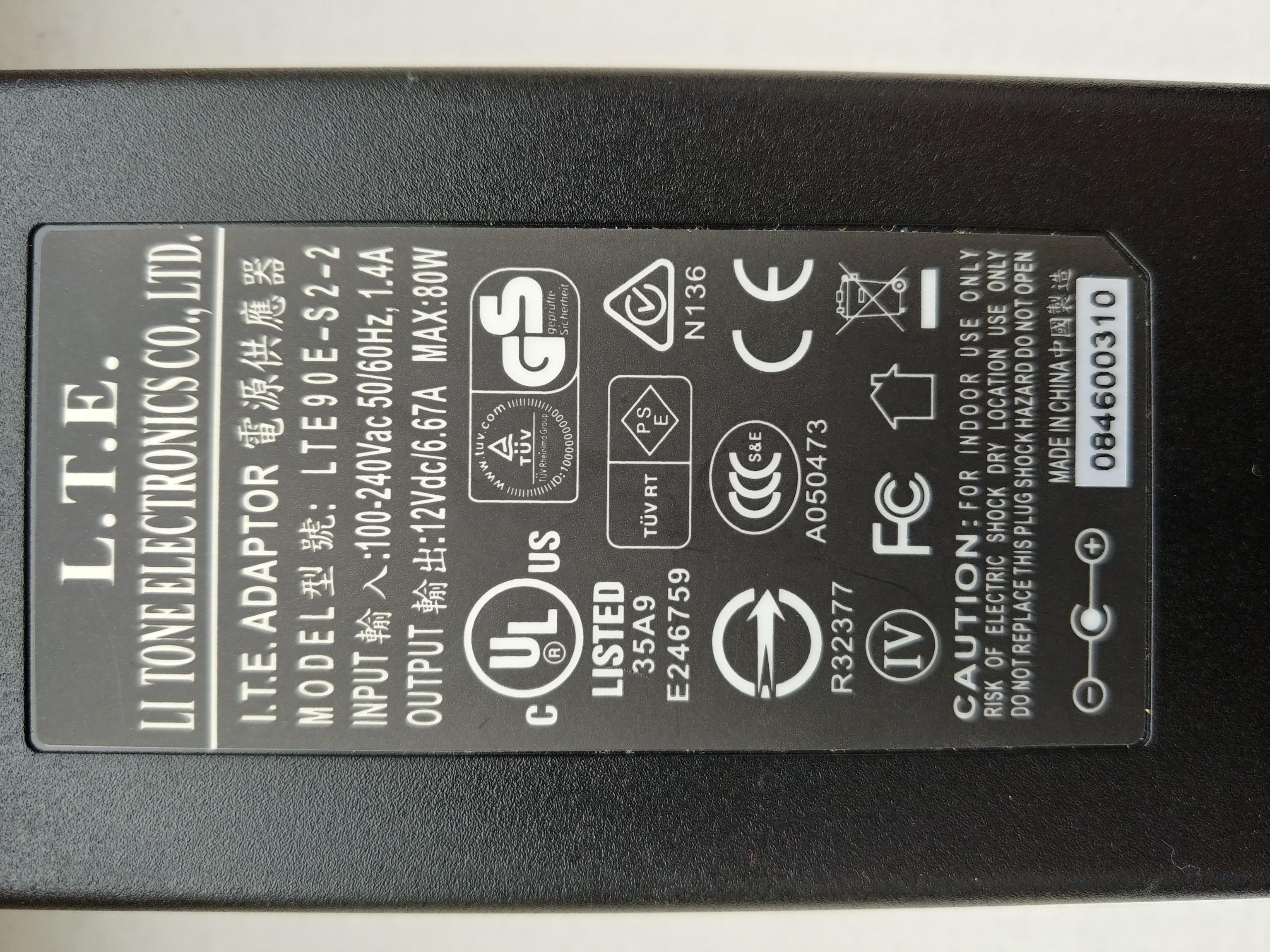

Attached are some photos of 12V chargers I used and they all whistled. The last one's model I couldn't figure out.@nielsek & @alazira, can you give us more info on the supplies that are causing the noise? Type, make, manufacturer (if not DIY'd), pix? AND anything else you can think of that might be useful?

When works with lower voltage DC adapter, the demand current would be much higher than the higher voltage DC power when the LifePO4 in charging or pending states. If the the DC adapter is a switching mode power supply, some times it can generate audible noise in some cases, either at DC adapter or at LifePO4 board. But normally it still fully functional. But I'm highly suggest replacing it with a better DC adapter that without any audible noise.Either higher voltage or better quality.

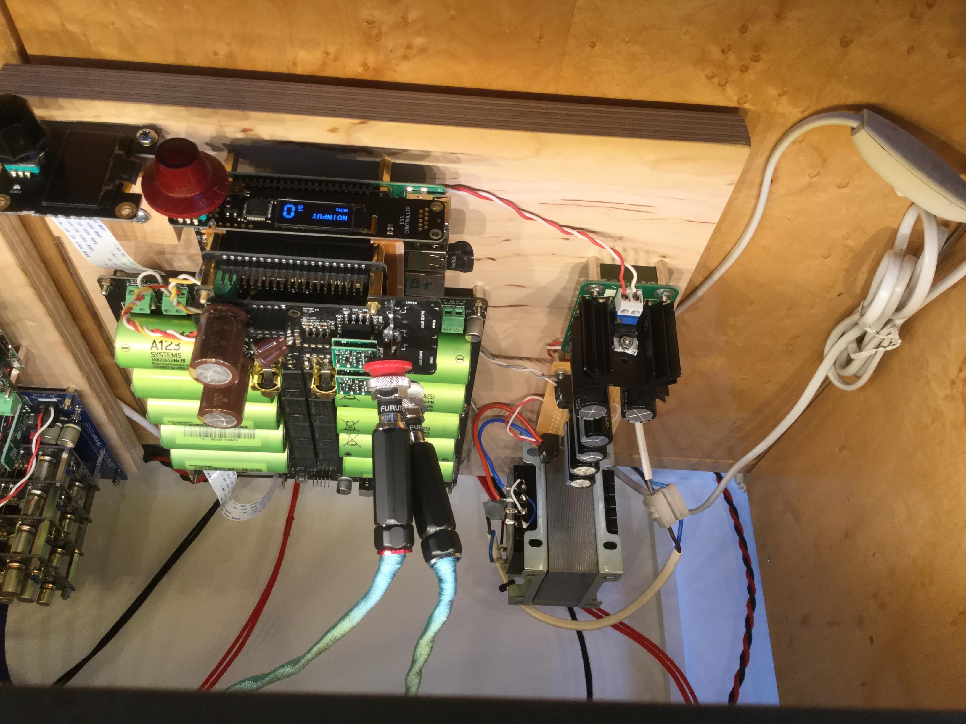

As I wrote it is working perfectly, so why change it? It is quit, without any hf rubbish that most switching ps put out.
I also used a 19v switching ps that has ruined a sparkos opamp so won’t try that one again.
I can follow your explanation that a lower voltage will increase the current draw, after all it is a certain power that is needed. But I have used another switching ps at 15v that also draw 5,5amps when charging. So there is probably some other factor limiting the current draw.
I have experienced that I can run all day (12-14 hours) on the battery pack, nice!
