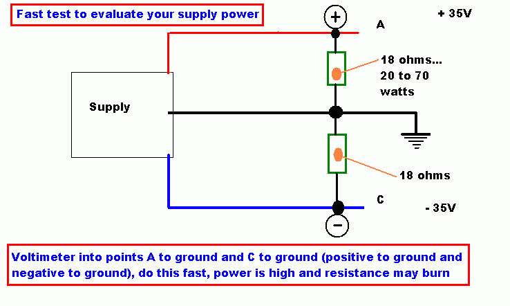

After you have your supply assembled, measure the DC voltage without load
and adjust the series of zener diodes to have 5 volts less into the input circuits.
Good idea is to measure the supply under load... 2 amperes each rail for instance..using resistances to drain power into each rail simultaneously to check the supply behavior under load conditions....then you will know the real thing, and will adjust zener properly to have excelent sonics.
Of course, if you perceive your supply as too much weak, than adjust your zeners to loose more than 5 volts, as will depends from your losses into the supply.

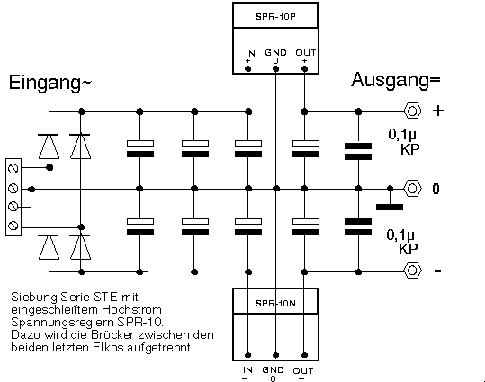

Carlos,
The best thing to do is stick by the schematics voltage.

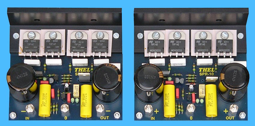

I've a special regulated supply for audio amps from Thel Audio in Germany.
www.thel.de
It's written in German but if you want I try to translate it for you.The reason I bought this was to avoid the problem of buying toroids for each amp I shall make.With this I could make the voltage I need positive or negative or both.
www.thel.de

It can be regulated from 10V to 90 VDC and the current is 10A RMS and a peak of 20A;so I could use this supply for many amps.

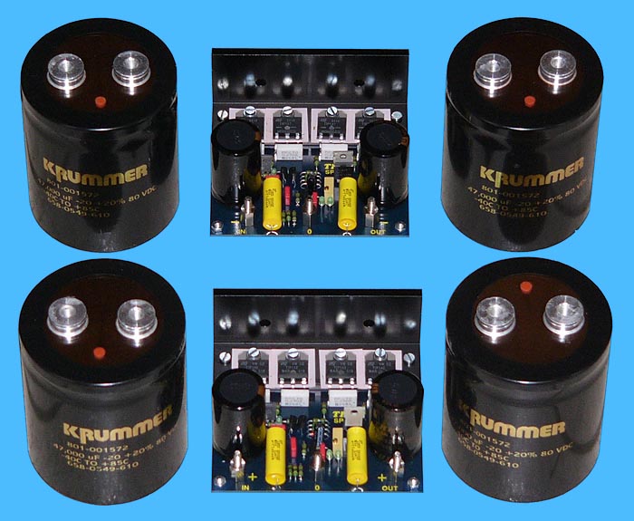

Just some notes... the capcitor spaces on the board, can easily carry 100V caps..
Also related to the size of caps (capacitance), although I know the source or person the comment was attributed to , and have very few people I respect more in this line of things....
My experience, was that the big caps I used, increased details in the mid and top range if anything...
Doing AB test.. the sansui sounds muffled in comparison and even the DX classic. I do also believe (and eperienced) that some electrolytics jsut do not belong in audio circuits, and this is not price dependant, had some realy nice sounding cheapies...
The units on my boards at the moment are Panasonic TSUP caps. at 2 x 10000 and a cheap, but clear sounding 4700 on the input side... considering the little current useage of the input side, the 4700uF caps are undoubtably overkill and a sign of my inexperience at the time... I do however like a cap that has a ripple current rateing exceeding the maximum instantanious potential current draw of whatever it is connected to...
Bottomline is if you got something you think will fit the holes and voltage requirements... give it a shot. Worst case scenario, you swap those parts later on... if your HRII sounds muffled in any way, I suspect something is very wrong... It is one of the clearest sounding amps I have heard. And even giving acceptable sound through a set of test speakers that makes jsut about any amp sound like fog horn.
