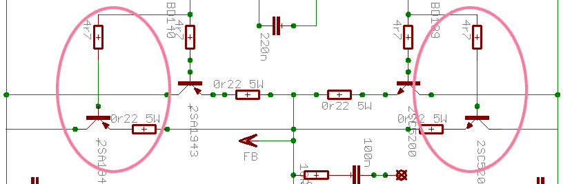

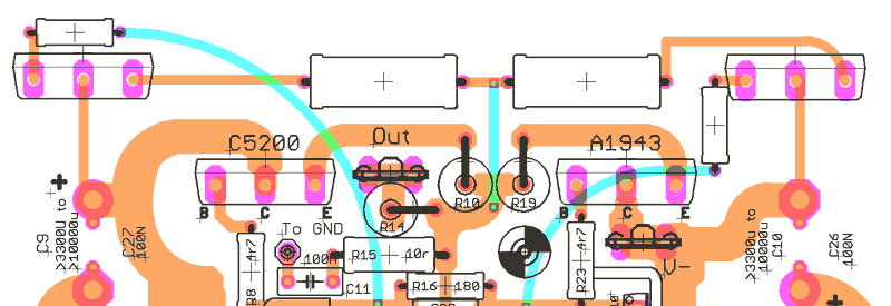

I am getting good enough results from 2 300VA 26VAC x2 transformers...
For a single I would go for 500VA+
Slightly higher rails wil also not be bad, say maybe a 2 x 28VAC transformer... (once again all youwould need to adjust is the zener.. although the kit ones will work fine, there is a bit more power to be had if you then switch the two 16V ones out for a 33V zener.... you can just bridge the position of the second zener.

Yep, the ones at the side. The only other zener is the 12V that sets up the CSS for the front side. That one stays standard...
In fact the amp could in theory work without the transistor and zeners there on the sides, simply bridgeing the transistor with a 82R resistorso voltage can make it to the front side...
Will have more power but less quality in sound...
The benefit of the higher voltage is that you can use a large margin of it to regulate the front end and keep power output higher...
Of course without the regulation, full power is available to the amp... the 42V.
With the regulation, the outputs are only driven by the amount of volts you let through to the diffirential and voltage multiplier...
The Output transformers just supplies the current the output load needs to follow the instructions to keep the output voltage at whatever the voltage multiplier tells it to be at any instant, over said load.
Tell me if it does not make sense...
