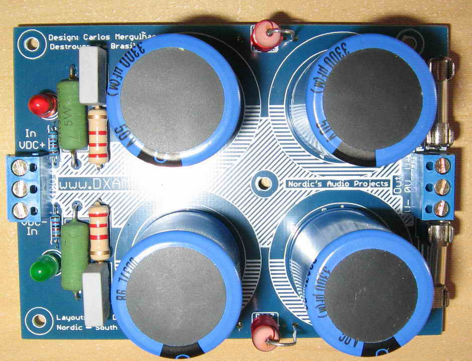

So I should just go through the website and order the 4 "parts"? amp PCB, PSU PCB, resistor pack and transistor pack?
Aside from that, just whatever inexpensive/expensive caps I want to stick on there, the xformer and usual connectors.

Ok just want to confirm for the backorder groupbuyers, that I got hold of the owner of the PCB factory, got a bit worried as it seems they had an extended holiday... The order for your boards have been submitted and will be processed asap...
