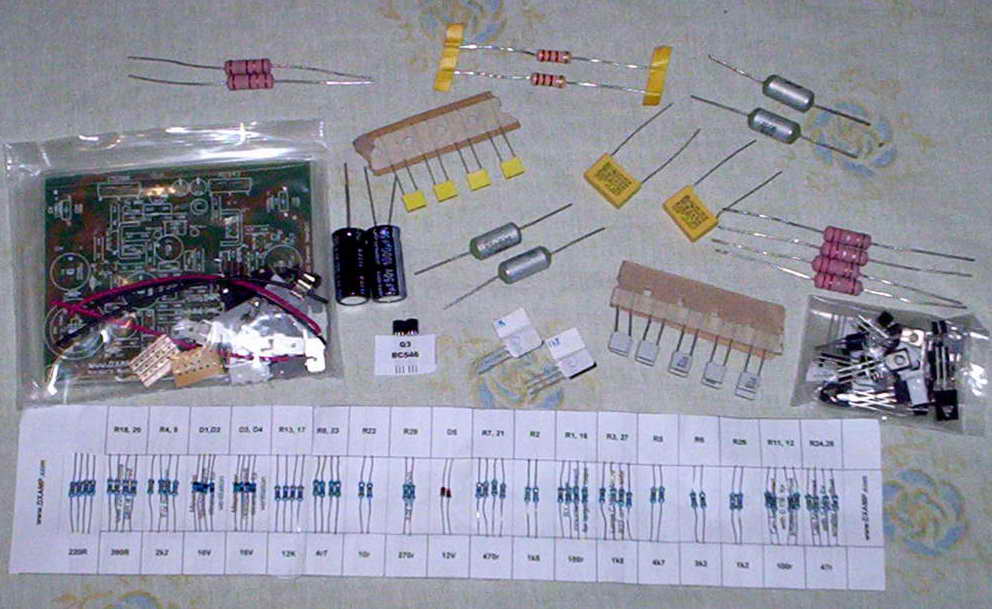

It is best to take the point to the groundstar there by the bottom spade... don't use too thin wire, as the amp's power will runn trough it i case of some mallfuntctions and it can't protect your tweeters if burned off.
http://picasaweb.google.com/salesmonster/DXHRIIBuild/photo#5148397743153281554
Take this measurement with servo connected to PCB...
Well done with the pictures...
Some pointers for future constructions....
Start with smallest componenst first, wire links, small resistors, and work your way up, this makles it easier keeping the components in place while you solder upside down.
For zener diodes (and most other similiar packaged components), you get better dissipation (i.e. the power rateing goes up) if you allow a few millimeter air clearance under them...
It seems you are in the group that got only 4 small insulating pieces... one of those should be used for the bias servo to isolate it electricaly from the heatsink. Idealy you would have received 6 pieces, but clarity on actions normaly is higer on things done than those that are going to be done., use the other piese on the transistor by that resistor that is installed underneath the board.
Also if you want to try an output inductor in parallel with the 18R resistor on the board, you should bridge its holes and install the resistor and inductor offboard.. the inductor will be pretty large..

Nordic:
Just to make sure we are on the same page, you are talking about this little guy, aren't you? Link2?

Nordic, thanks for the input! The changes have been made (to both my boards, and to the slideshow)
http://picasaweb.google.com/salesmonster <- for those of you keeping score at home!
Dave
