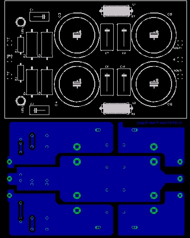

DX HDII Clone PCB
hello,
I just finished with DX HDII Clone PCB Design.
I Used Original schematics, but the Amplifier PCB is redesign.
Power Supply PCB Layout is slightly changed (As shown in figure.
Here I am posting DX HDII Power Supply Board images, tomorrow I will post Amplifier PCB images.
-suds

I'm certainnly not speaking for Carlos...
Suds:
I'm certainnly not speaking for Carlos, but I would think one of the design elements of the snubbers (let's use C3 as an example) across the electrolytics (C7) is to be as close to the actual pins of the big caps as possible. I can see why you would move them around cosmetically, and you did a very good good with the boards. But, personally I think you should at least move any snubbers back to their close-up positions with their mates. In this case, it could mean mounting them on the bottom of the board.
Just my 2 cents.
