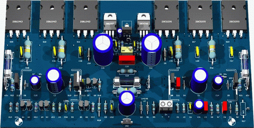

DX HDII Clone PCB.
Hello,
Thanks to authors, carlos and nordic.
With their permission, and conditions.. I offer to provide custom PCB for DX HDII Amplifier.
PCB are made by me from Original schematic from authors website.
Designs are modified, Track Routing are modified for Double side PCB. These are not same / copy of PCB's sold by Authors. Schematic Part Values are not changed,
Before actual manufacturing of PCB, Prototype PCB will be assembled and checked.
Both Power Supply and Amplifier PCB Layout are complete.
Image of PCB will me made available.
Sudheer.

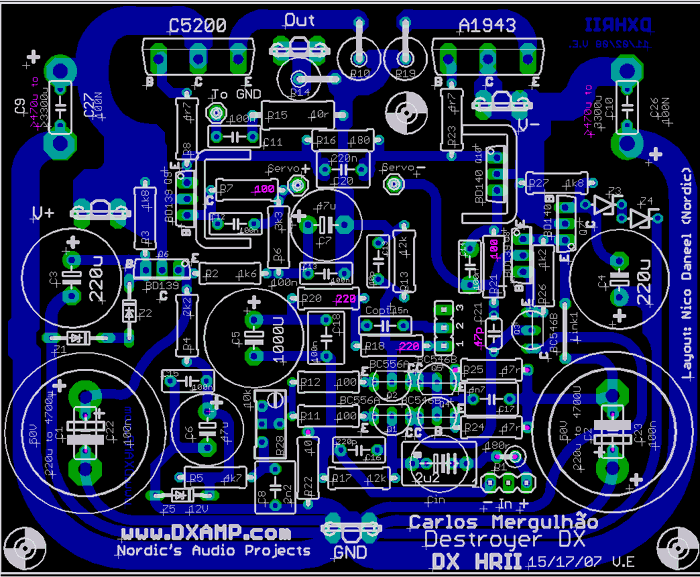

Here is the last revised schematic.... i think this one will be the last if we do not find some error i could not see till this moment.
The technical good operation was Nordic work... he worried about everything, even the Feedback line point to have connections...following Dr. Self ideas about NFB copper lines...were to pick the signal.
I have more responsability related how the board looks... also Nordic worked to make it pretty too.
We have to thank Nordic, to be so competent and to tolerate my obsessive needs related parts position, letters size, colour, condenser size, simetry and that stuff.
Todd Johnson, our TAJ, made the schematic using his Adobe Illustrator software... he is good, very skilled into this work... i have to thank him once more.

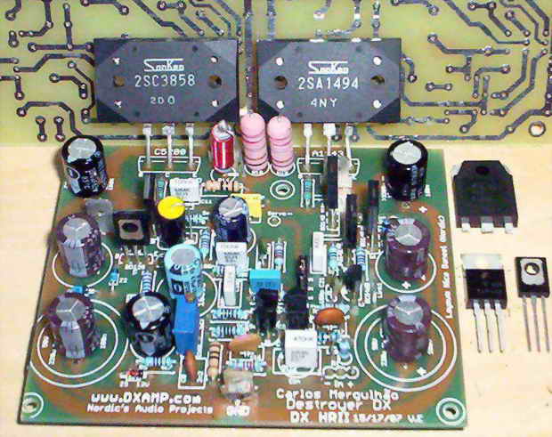

It ain't pretty...
but it's ready for biasing the HRII!
The build took WAY too long, but not because of any external factors, just life on this end.
Anyway, don't laugh at the plywood prototyping. 🙂
I was snow-bound for a few days and I just worked with whatever materials were available.
