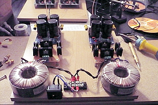

It ain't pretty...part 2
The Power Supply:
Note that the transformers aren't what will be used in the end, but they were lying around with the right voltage specs. I have no plans to rock until the bigger transformer(s) are in place.
The power supply caps are 12,000 uF 50V Nichicon snap-ins from ApexJr's website. Not a bad deal considering they are $1.99 each. Compared to the $6.50 each for 10,000 uF Panasonics, it was a no-brainer for me. Your mileage may vary.
I'll take pictures of any smoldering wreckage after I power up here in a bit.

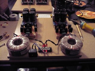

The Power Supply:
