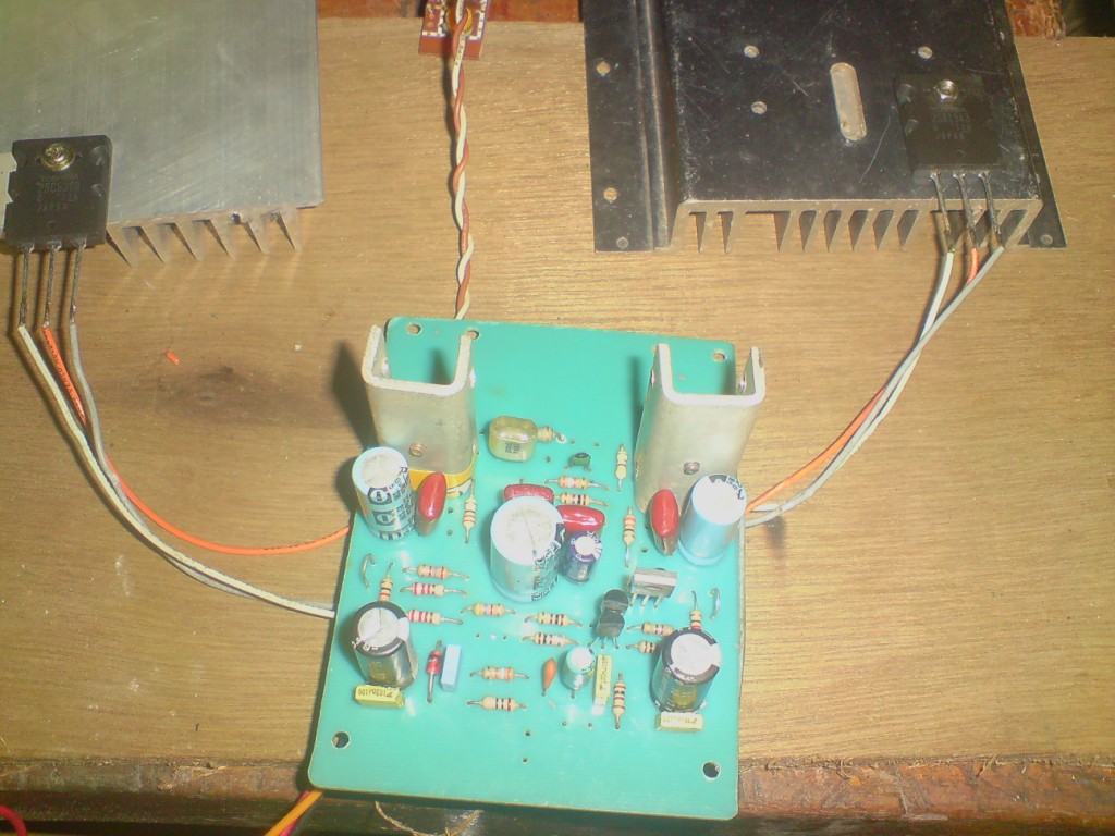

it was a printer problem. not a good copy. when its printed, i noticed that some inks from the transfers are to thin. but this is only my first build. the next build will be a better one.

For your next PCB: increase the land diameter around the holes.
it must be a optical illusion ..............Maybe the holes are way oversize.
not an optical illusion.it was a printer problem.................the transfers are to thin. but this is only my first build. the next build will be a better one.
Have a look for yourself.
Some of the lands are so narrow they almost breakout at the hole

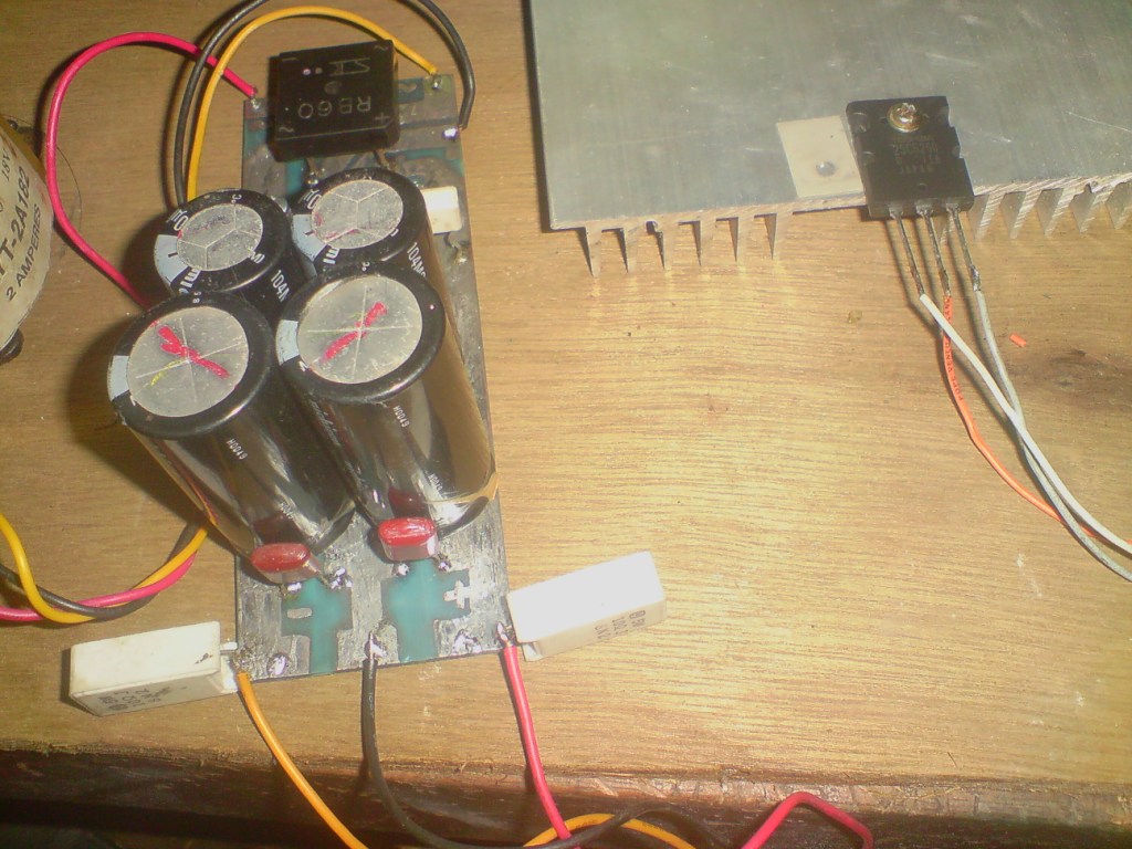

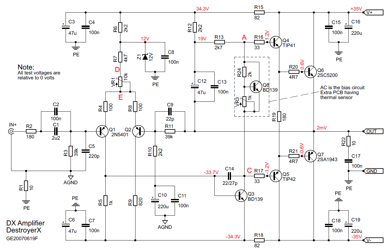

i have a problem. all circuits are fitted right. no grounded traces. all components are working. but when i turned it on, with protective resistor, these are the following problems.
1. protective resistors get hot after a minute or two.
2. my power transistor gets hot too.
3. output measures some DC. around 3volts
i don't hook up any load yet and the input is grounded as the procedure says.

Power up via a bulb tester.
It will stop the devices becoming hot.
It will allow you to measure voltages without risk of the amp blowing up.

and one more thing. only A1943 is getting warmer but c5200 is cold. what is the problem? i check the voltage across the protective resistor and it reads 4.40v.

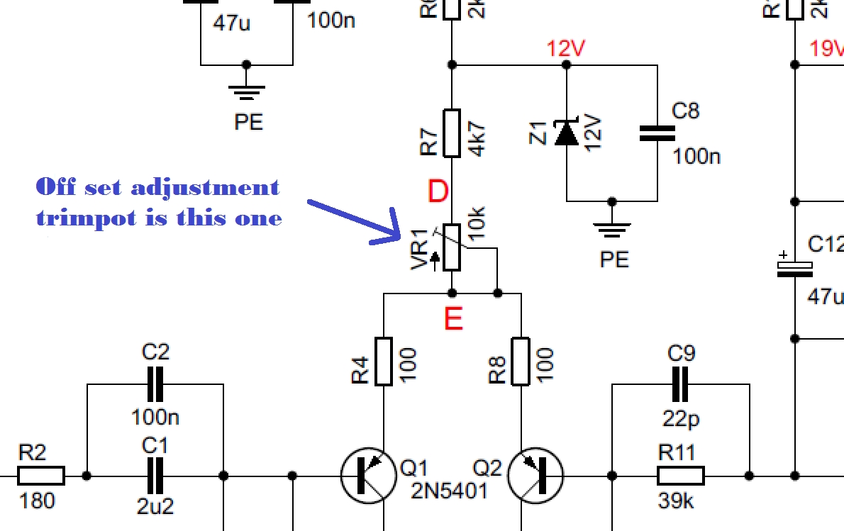

actually. it is now working. but it seems there are still problems like:
1.when i set my DMM to 200m and measure the output i have dc readings from hundreds then fluctuating slowly.
2. when i test the resistor protection i got my reading at 500+MV but when it is in the halfway, it reads 1400+MV.

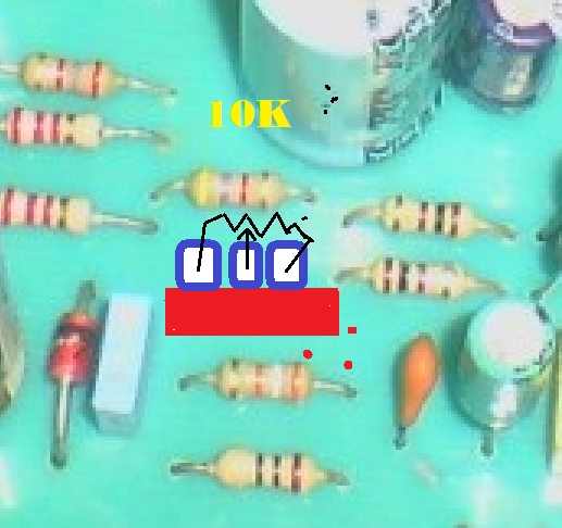

There's a trimpot to adjust off set.
Is it assembled below (beneath) your pcboard.. is it in the copper side?
Is this trimpot adjusting?... when you turn the trimpot knob or the adjustment screw, is the off set changing?

By the way..is the bias trimpot operating?

Is this current scale or other scale?
Off set is Direct current... milivolts in DC...what is your measurement... the flash spot is covering the scale so i cannot know what scale you are using.
