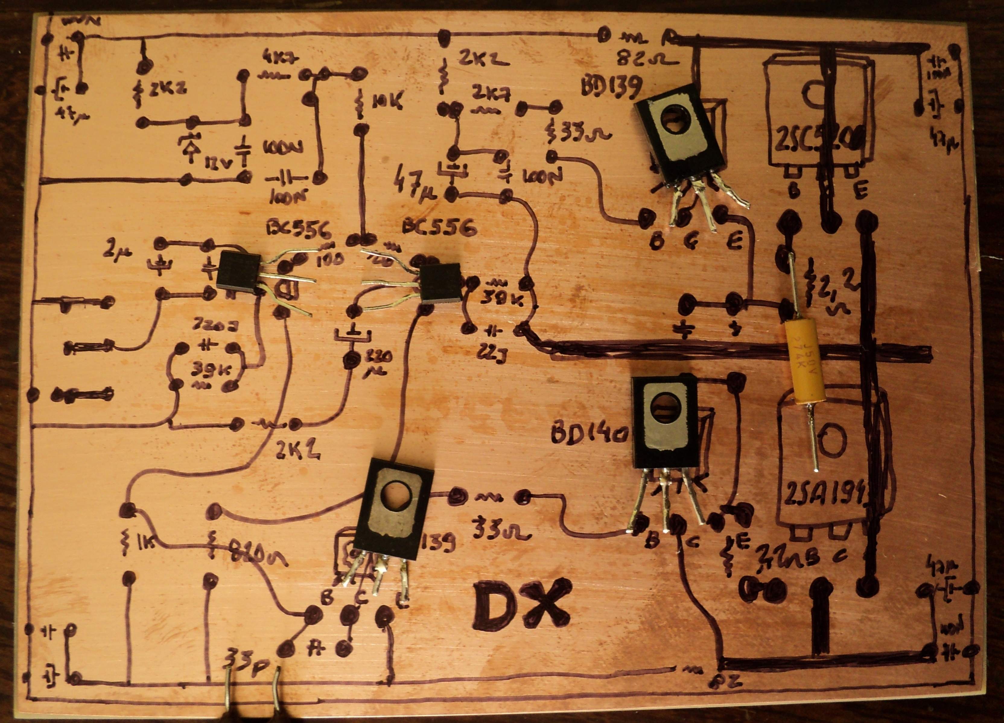

I would like to see pictures from your board harmonicconverger
In order to check your diy home made pcboard.
there are several non authorized pcboard sellers in the internet, mainly from China, but some from South America and from South Africa.
I will always, and gladly, help Dx amplifier builders in many ways, but will not give any support to the ones are buying from pirates, because i will be working for free for them to have non authorized profit from my work.
Of course the diy efforts are my target, as we are in a DIY forum, where designs are provided for free and the consequent follow up is nicely provided, advices and all kind of help and support are given for free because we are not in a business environment.
The use of this forum, my person and the home pages dedicated to the Dx amplifie,r is an abuse from these ones that are exploring the stuff as a business, this have not my approval, my support and i am sure forum management will not appreciate the stuff made this way.
I would be happy to see your pictures, about your diy efforts, for further conversations about it....there are so many things to say that i wish you have made by your own effort...i will proceed to help you after confirmation of your diy efforts.
Thank you in advance by the images you gonna post, as they will start a long relationship that will result our mutual benefit.

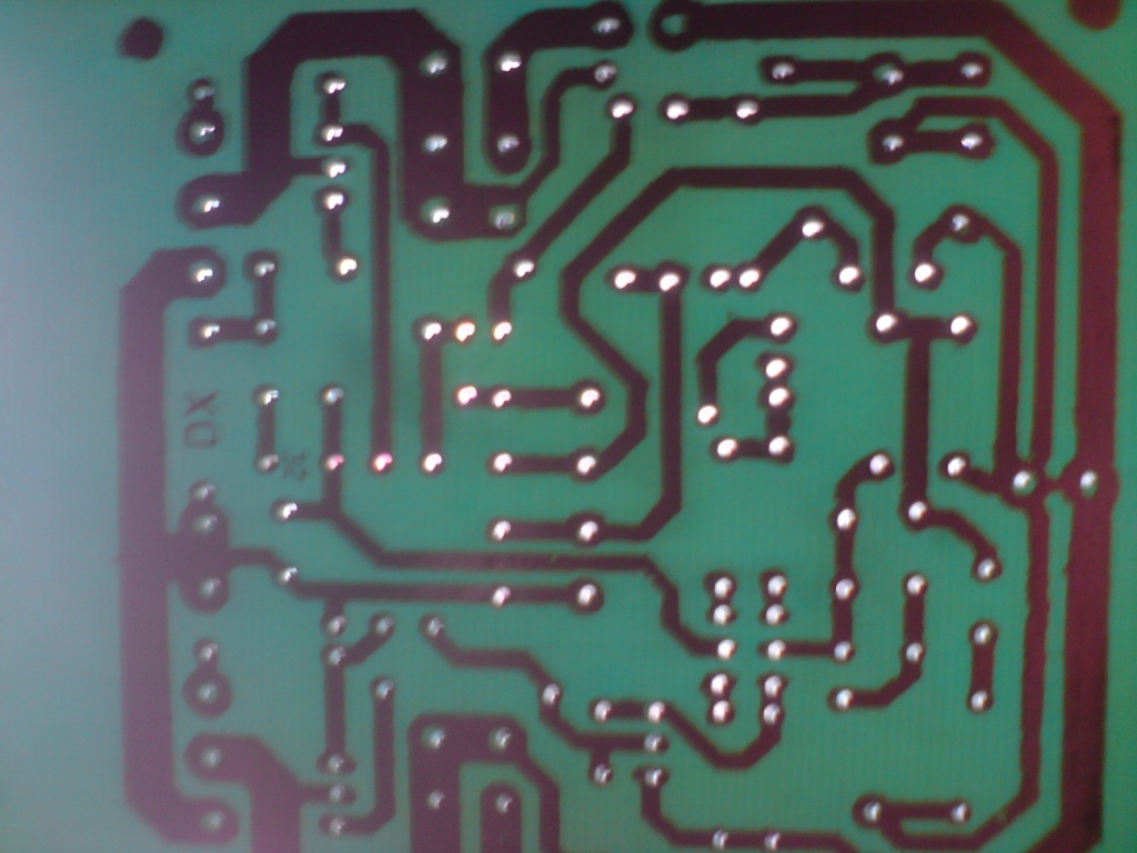

See the board i am doing.... almost made.... i am searching for a break in my personal activities to assemble this one.

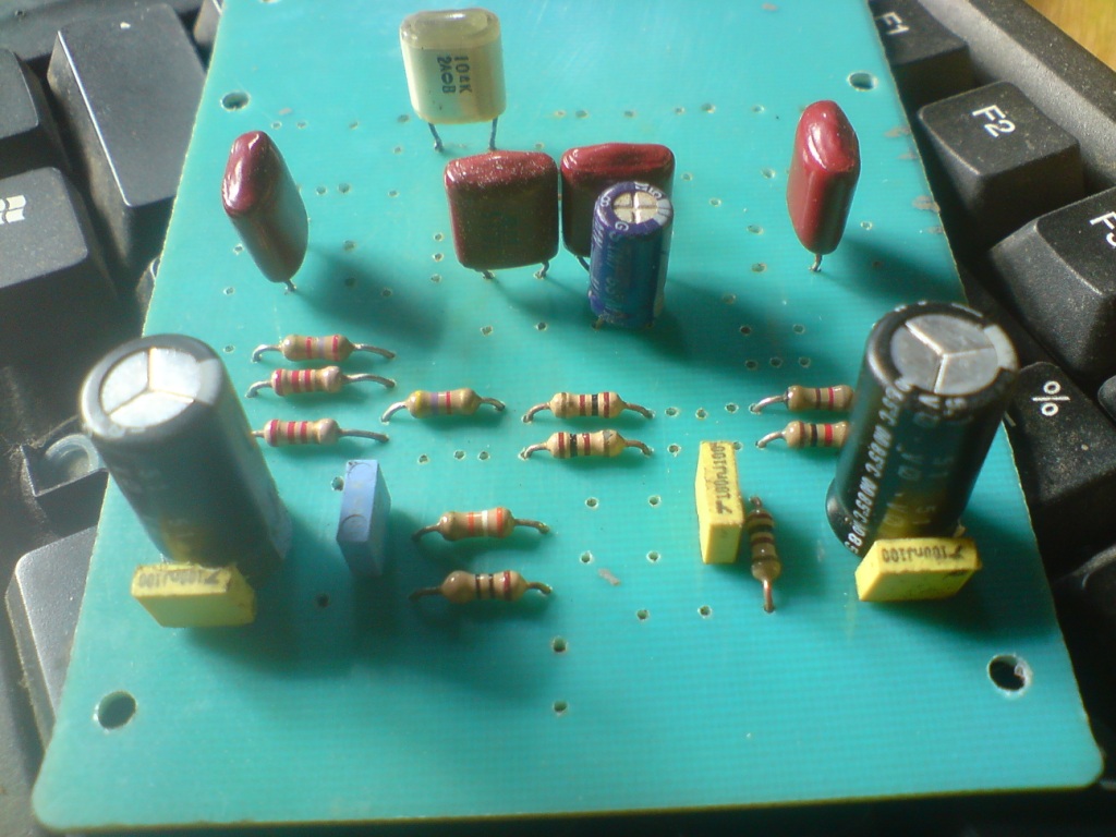

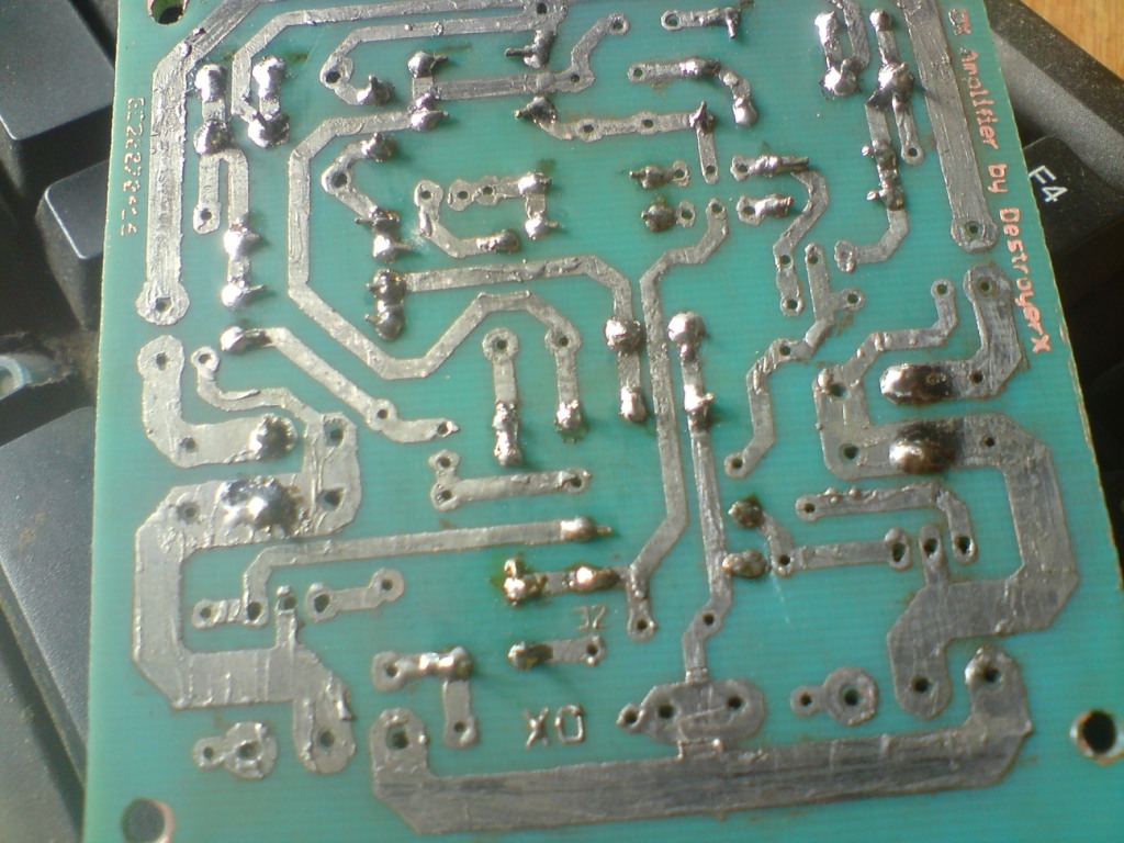

Here is my unfinished DX amp
i'm not yet finished with this amp cause i do not have some parts available in my house.
maybe i can now ask you sir Carlos for some changes in using 18-0-18 power supply.
what are the changes in value and in bias?
For your next PCB: increase the land diameter around the holes.
Andrew, it must be a optical illusion because the pads on my original single sided PCBs are huge, much bigger than standard EAGLE components. Maybe the holes are way oversize.
http://users.tpg.com.au/gerskine/dxamp/media/dx prototype rev0.brd.pdf
