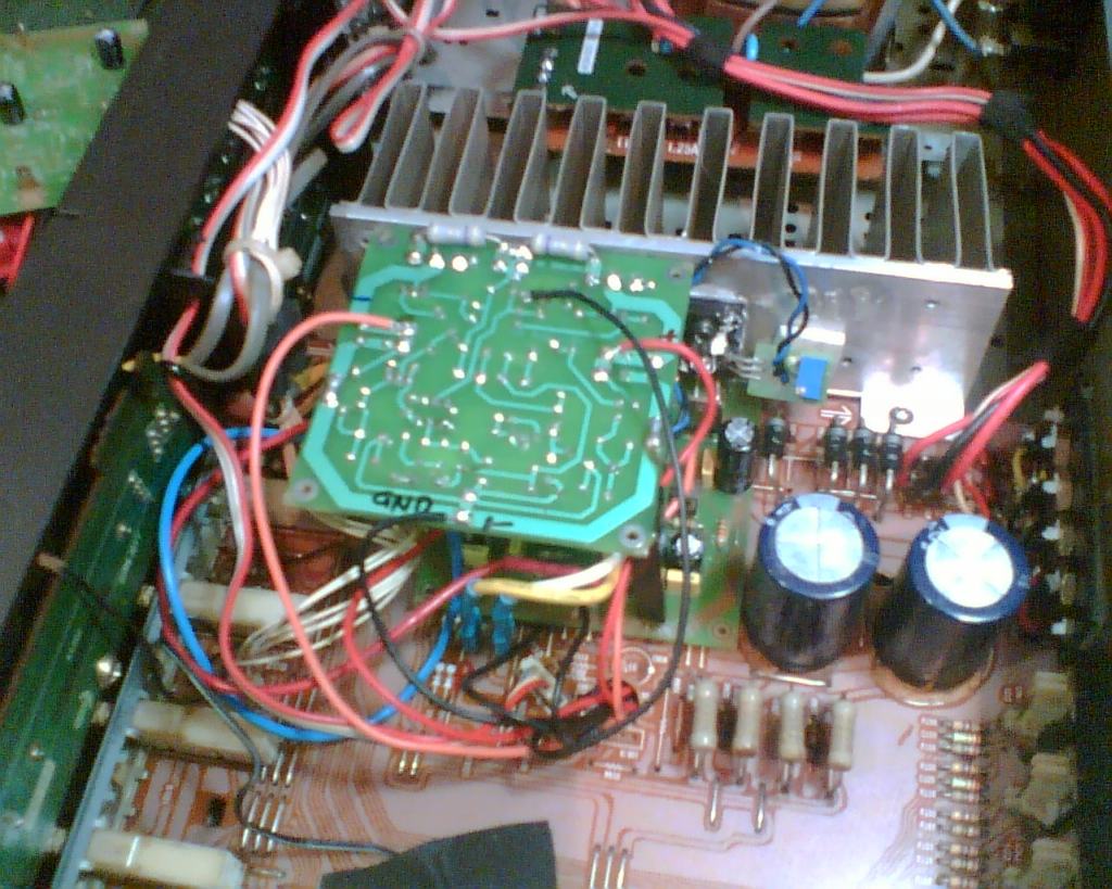

Ok, I made it
First, it was dedicated to replace hard to find original stk,
but i like it, works like a charm, deep solid bass, bright precise mild, and nice highs,
small heatsink force me to reduce idle current, but works fine
very good amplifier, thanks Carlos

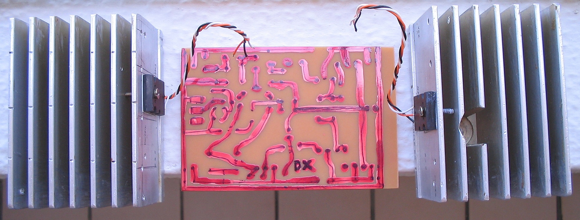

Hi all!
A vey, very broad topic!? The amplifier is very interesting!
So at the end makes the final set schematic with thermal loop amplifier for bias (circuit wih transistor for bias - see figure) the output transistors 2SC5200/2SA1943.
And of course set the PCB for this amplifier!
I pray Alex mm (POP) to develop, if it is able for the final PCB design amplifiers.
thanks and cheers !

Hi radio,
I have a couple of 2010 PCBs left over from my personal stock so if you are interested PM me. They are not OFFICIAL PCBs as they are changed a little to my preferences, but close enough to the original design. Differences that I can remember, no zobel on PCB, added emitter resistors under PCB, bypass caps under board.
regards
They are official board dear Greg...you are Dx amplifier board layout designer
So, the charge is yours...for life long.
