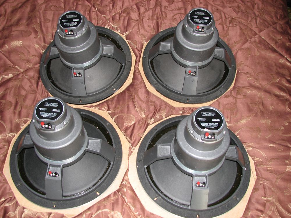

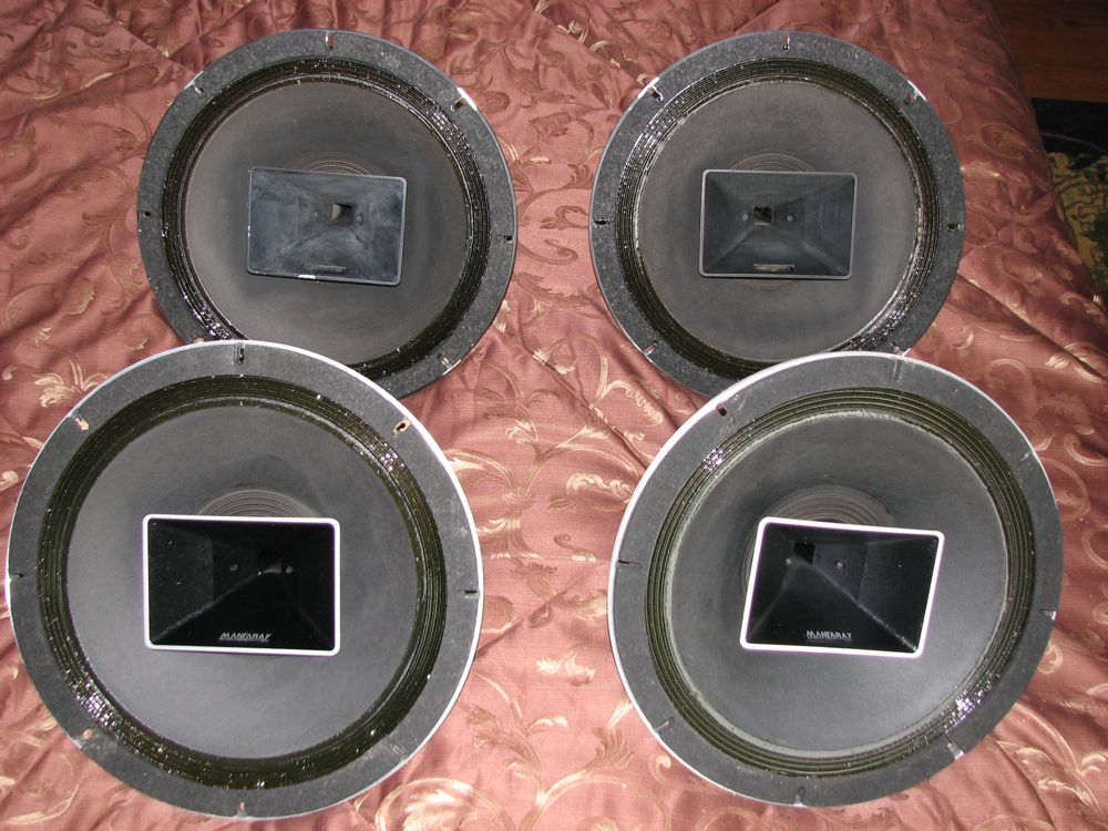

Oh!... these ones would be a dream that comes true
The bass these ones produces are unbeatable.
