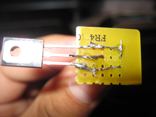

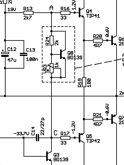

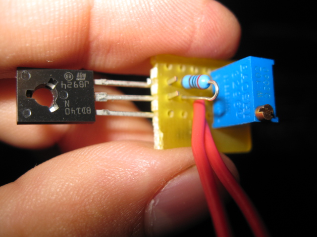

Your BD's aren't the "totally encased in plastic" type? I though the whole reason to use those for the bias stack is so you don't need an insulator....
BTW - the BD140 is PNP not the NPN. There's no reason a PNP won't work as a Vbe mult, but realize that it needs to go "backwards".
I'm using what came with the kit. By backwards do you mean my connections are wrong ? Thanks for the help.Your BD's aren't the "totally encased in plastic" type? I though the whole reason to use those for the bias stack is so you don't need an insulator....

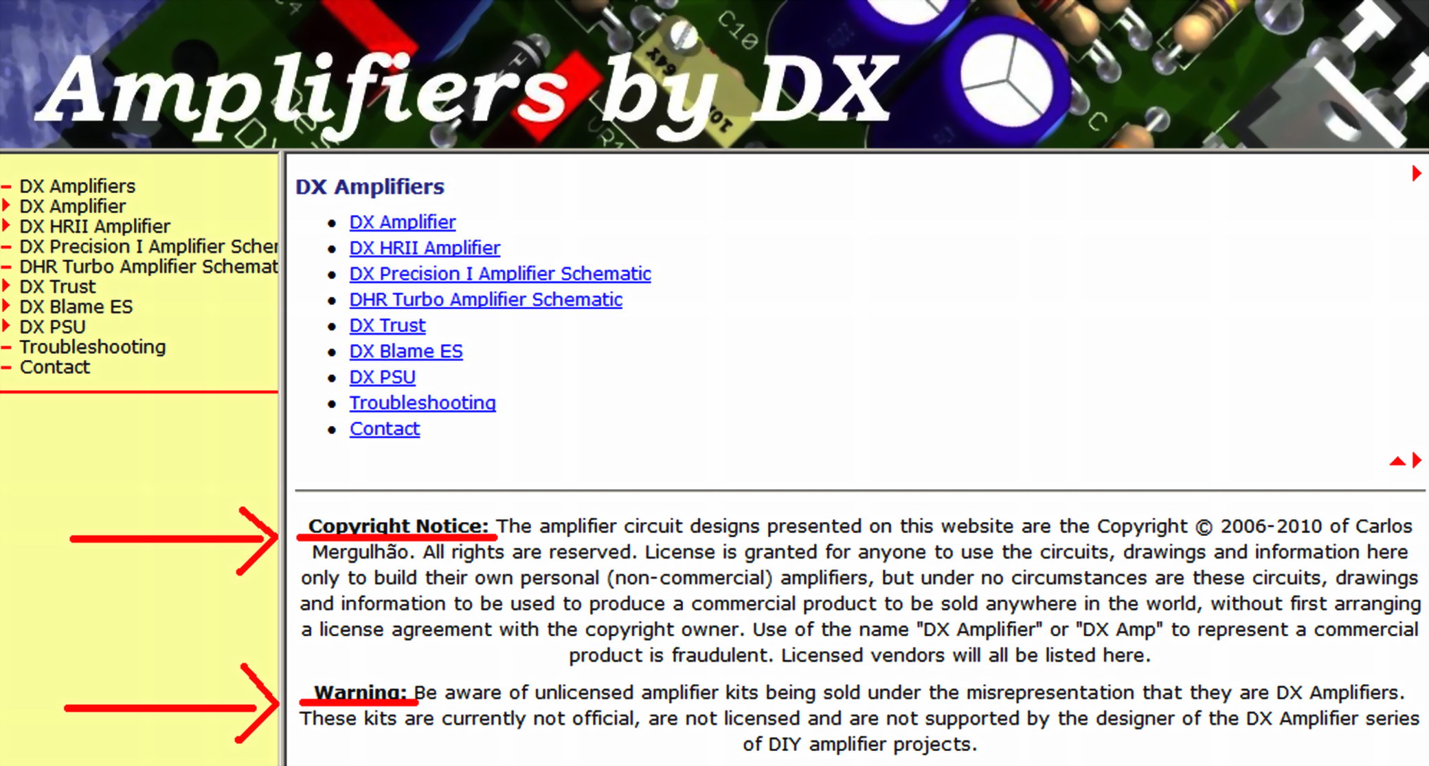

I understand and will gladly donate to greg's website.Greg Erskine site.
In my humble point of view, the one ask money for the kit should give the needed follow up to the ones have bougth their kits.... this is part of "his" costs... the follow up and printed instructions.
I am responsable for non paid dyers, the ones have participated the thread and have created their own boards, producing the etching and buying parts by themselves..for these ones i am ready to give some help..also Greg and his thread (pointed by the business man as a support for his products) can be helpfull too.
The man is having profit..he is making a business and not ashamed to do that without authorization, also pointing a DIY forum as support.
I think, the way things are, i will be working hard to that guy earn money..this does not look fair to me.
About Greg.... he decides what to make...i will continue, gladly, giving support and beeing a great helping hand to the ones comes to this forum, to produce their boards, to buy or select parts from junk box, or their own reserve of parts and to build as a real diyer...not a kit buyer.
This is a non paid forum.... this space is not used to produce sales, this is not a business section... the one is producing kits should ask first my authorization, should make an agreement with me, and also pay for advertising in the forum dedicated pages, to business..as paid publicity.
Also Greg deserves some return, as his pages..his site...is not for free to him.... while things are contribution between friends, DIY from a world forum... amateurs building..it is all rigth...but when things turns professional, so the costs must include my design, the layout made by Greg and the costs Greg is having to maintain the pages...to rent the space in his provider.
You are not guilty dear kit buyer..... the one that sold needs to feel ashamed of his behavior and to start conversations with me.
E bay already informed the kit has not authorization..the forum adress, the thread adress already informed.
At least. ... this is free advertising to me...this may help the day i decide to start a business...but i feel things are not beeing correctly made.
There are so many kits out there - which may or may not bear resemblence to the original. If using a 139 for the Vbe, connect collector to A and emitter to C. If using a 140, connect emitter to A and collector to C.

Your page is useless since the trademarks and circuit involved
are not registered in the legal sense of the term...
For one to "licence" a product, there should be an official holder
of an intellectual property, be it a name , a circuit or a Pcb..
Anyway, the term DX has already ben used countlessly,
and the circuit is a classic one which can t be deposited
anymore...
Only the Pcb can be subject of a legal dispute that could
be sustained in courts...
