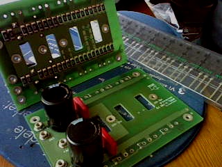

Was just thinking, from your descibtion of its sound, maybe DX could be worth a try fore those who have smaller 2ways
And maybe it would play well with fullrange drivers too
Had these pair of nice output boards fore some years
Each with 4 pair 21193/94
I will try to place the DX driver stage on top of them, with standmounts directly on heatsinks
I have a pair of 36V trafos, and heatsinks
Found some nice cheap supply caps
Shouldnt cost much to do it
Might be time to do something about it

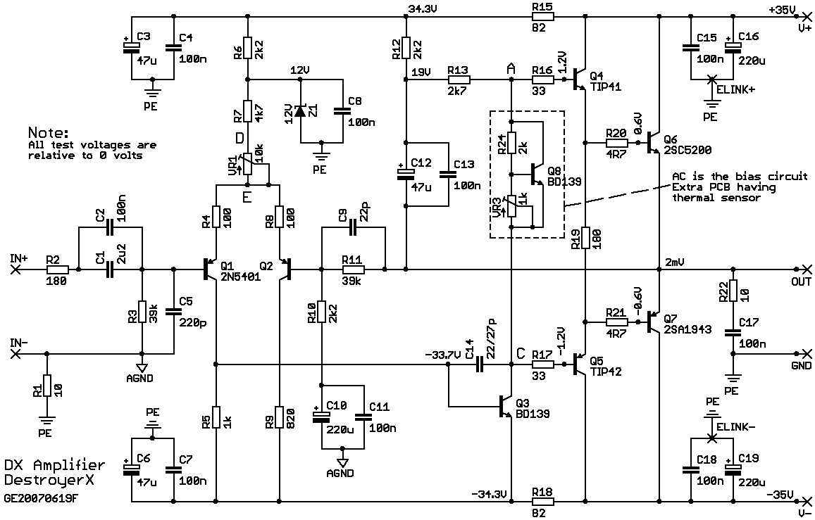

VR3 Vbias
I decided to try and build a DX amplifier. I purchased a kit online and began cross referencing between Greg's website and the online instructions for the kit provided by the gentleman who sold me the kit. There is a difference in the way the vbias is carried out. I don't wish to offend him or anyone here, all i want to know is if the online method will give me the desired results; wich are a working amp that will not overheat. I've attached some pics and a web address to the online instructions. Help will be greatly appreciated. ** DX-Amp **

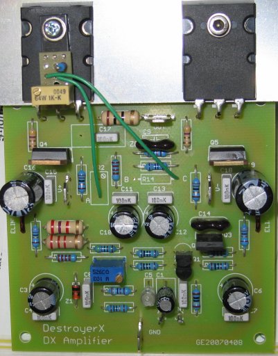

hi bryantramos79,
I am not familiar with PCB that you purchased. You would assume that it has been tested and the instructions supplied are correct, but.....
I have included a picture of my DX Amp that was constructed from the instructions on the DX Amp website.
Note that VR2 and R14 are obsolete and are not mounted on PCB.
Just a brief history of the bias of the DX Amp. Originally the bias was set with only using VR2 and R14 but this requires a very, very large heatsink. So VR2 and R14 was removed and a small Vbe PCB was used instead - see picture.
regards

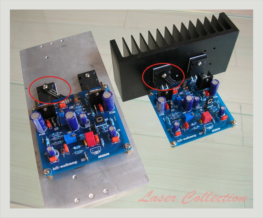

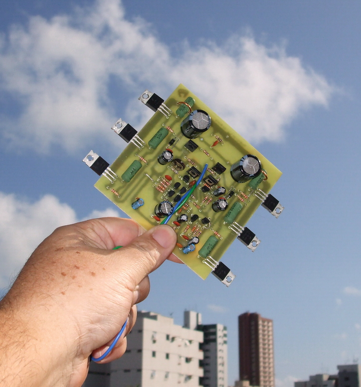

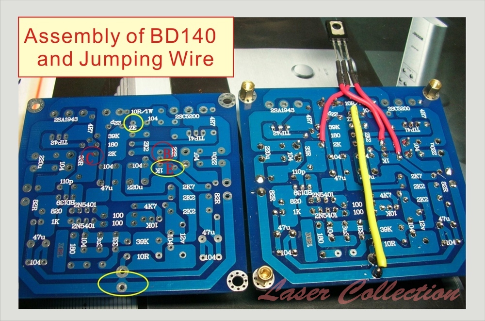

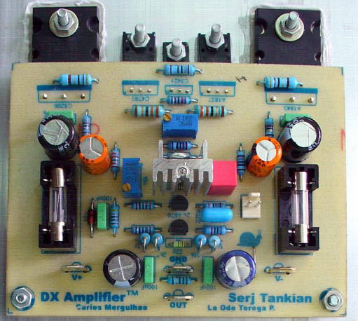

We are becoming more and more famous dear Greg!
Thank you.... you see...your board is spread world wide...hundreds have built at home...and now, people selling, not only in this site but in others too, will bring us more and more satisfaction.
This happened because our forum, the best wide world forum, and will turn even better the day thread opener had the freedom to block boring folks to post annoying things spreading dirty in the threads.... in the future will be this way...or a lot of folks will abandon forum because it will turn not confortable having people disturbing..beeing annoying.
Money is not entering our pockets..but the satisfaction to start the whole thing belongs to us!

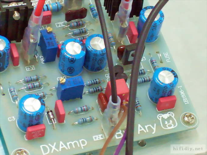

** DX-Amp **
The most lovely one is the picture number one..someone have copied and was sold in the Islands we have surrouding beautifull Australia... La Ode torega is not the responsable..he just have made the beautifull board.
A Brazilian, sligtlhy modified one (had CCS and some transistors in parallel) was tried to be sold...another version appear in the Brazilian free market (E Bay)... one of them i could remove from the market using family influence with our President (Police order..or remove or will be one week inside a jail)...but i have asked because bad quality and not using VBE limiter..also not explaining how big the heatsinks should be in this case.... the price was really a shame..too much low (15USD).. this makes the "clever" ones to run to the bargain...and the result is a big lemmon in their lives.....bad kit that one... would burn easy!
Also you see the third picture, that one made and sold in China.... started in 2008.... it seems thousands were produced... now a days they removed from the line..ahahahaha..using another one... a banished forum folk that made Fet things (Aska....you see.... Aksa wrote scrambled...dirty thing that one)
This is good...in my mind means a big "thank you" we are receiving by our job...there are things that have much more value than money... at least to me things are this way.

** DX-Amp **

Regarding your design, as I said, your schematic looks dangerously like a cheap Rotel 80's amp, which I owned decades ago and its sound is characterised by inflated dynamics, edginess and considerable perceived distortion.
In my experience, a lot of topologies actually DO NOT work in audio, even though they might simulate, measure or seem very valid. This is why diy audio is a catch22.
rest assured that I speak only for myself, not my country, not anybody else when I post here. Quite cunning of you trying to trick me into a national pseudo-pride trip, but I won't fall for it, if that says anything to you about background, education etc. As for your threats, is this your morality? In actual fact, nothing is more immoral than threatening people.
