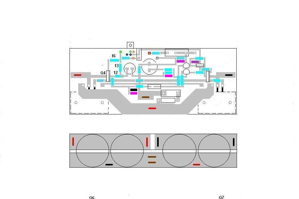

My layout is finished 🙂
I decided to avoid the double layer board
I still need a final check to see if there are errors
And check component size etc
30 years since I last made the much simpler JLH boards
I need to decide how to get this into a print board

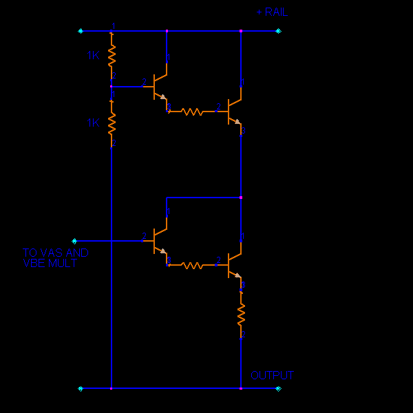

gaetan - you have the right idea, but not quite the right way to implement it. You can't just drive the bases of the uppers and lowers in parallel. If you do the voltage will not divide evenly (or even semi-evenly). The uppers and lowers need their own drivers (BD139, etc). The lowers hook up like normal. The uppers bias from a divider between the rail and the output, putting half the voltage at the emitters of the uppers. A couple of 1k's will work for the dividers. Try that in the simulator - then build it.
This one will sound different, it is not really a Dx amplifier, not a Dx Standard
Better to keep the Dx thread without options, the way it is since several years ago.
Please, dear Gaetan, open another thread for the Dx Zilla or other name you want..it is Dx style because of the input, but this one will not have the same sound..it will be different...the added parts will change the distortion style, despite the topologie have not changed too much.
I do not know if there are too many guys that wants to use these old transistors, they are not more fashion..well....maybe there are some guys that will appreciate that way.
Opening a new thread you will not deviate the attention from the Standard, and will be able to produce follow up helping builders without confuse the whole thing here.
You can keep, if you want, the Dx reference name, because the Dx style, or not if you prefer to give another name.
Increase the resistance that goes to the zener diode, use 3900 or 4700, or increase the zener power to 1 watt.

Hello Carlos
Sorry, my mistake, it was not to do a new DX, and not for a DX-Zilla, I was only asking suggestion in the DX thread because I was using your schematic only once time as a base for my friend. And in the following posts I was reply to wg_ski and his suggestions.
After his reply I did think that maby other guy may use it.
Yes, it will not have the same sound..it will be different...
No need for a new thread about this circuit.
I ask the moderator to delete my post about this schematic and the reply to it. Posts number 6675, 6676, 6677, 6679 and 6680
