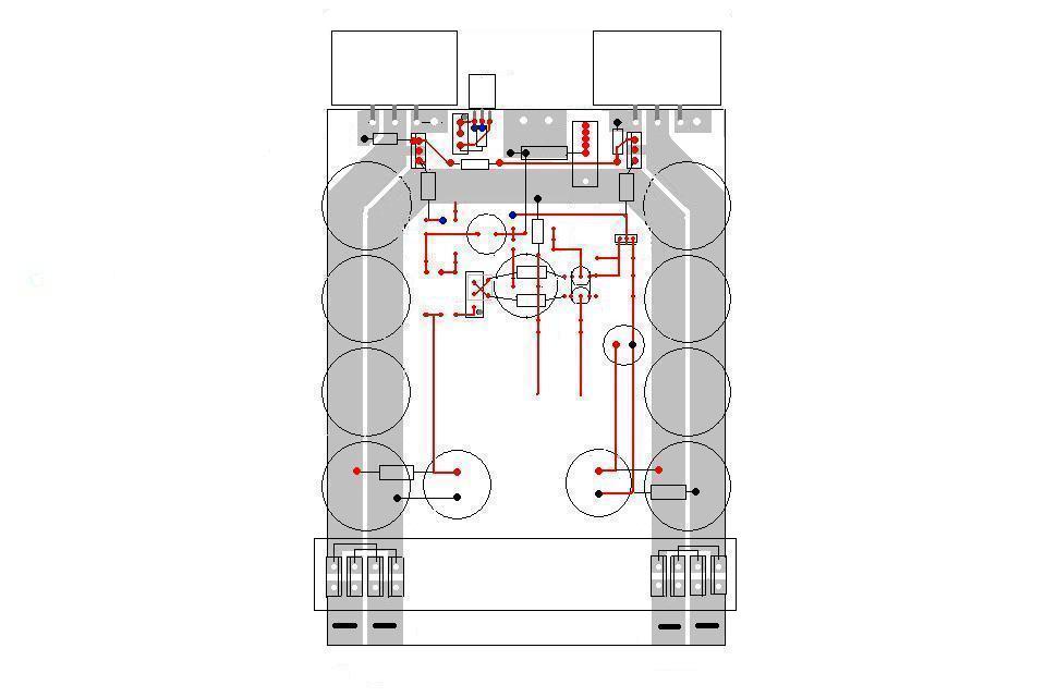

Im thinking about a different layout, with a certain EU box in mind
A very affordable box
Starts like this

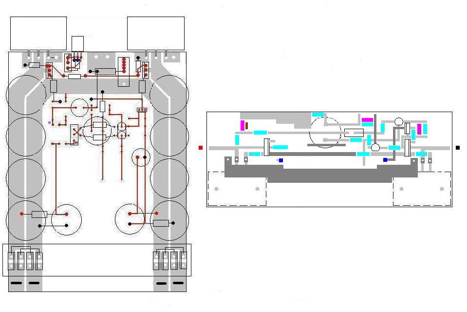

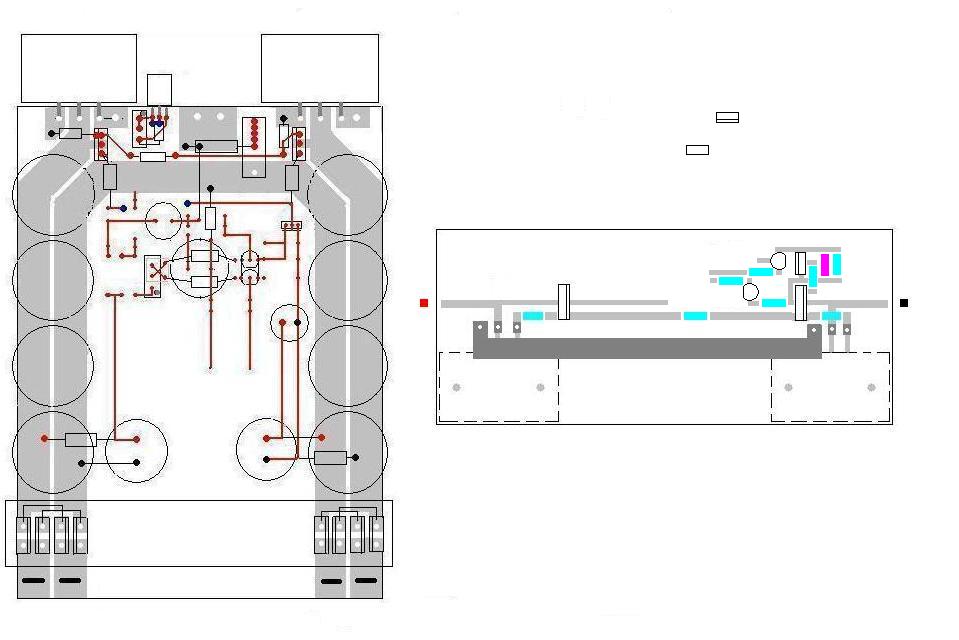

Now I will try a modular design, with each module designed to fit each other, and the box

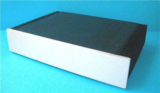

Found a relatively cheap stereo box with heatsinks and all, from Modushop, italy
Tho I wouldnt do it with classA, amp boards will be mounted flat onto heatsink
It gives more space fore supply, and should fit 80mm height
I hope to draw power supply boards in a day or too
Btw, back then I named it DX outlaw, in my file, long time ago
Carlos call it Horse Shoe, but now I only use it to look at, making the new one
Maybe that cause the misunderstanding
Would be fun to hear hows the difference with different layout and build
edit, Volkers look different, with more transistor
