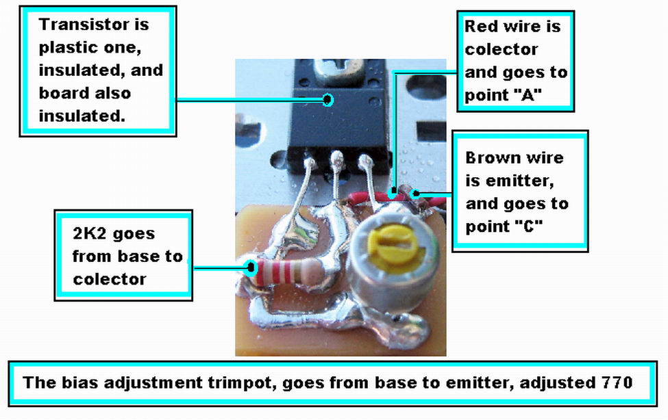

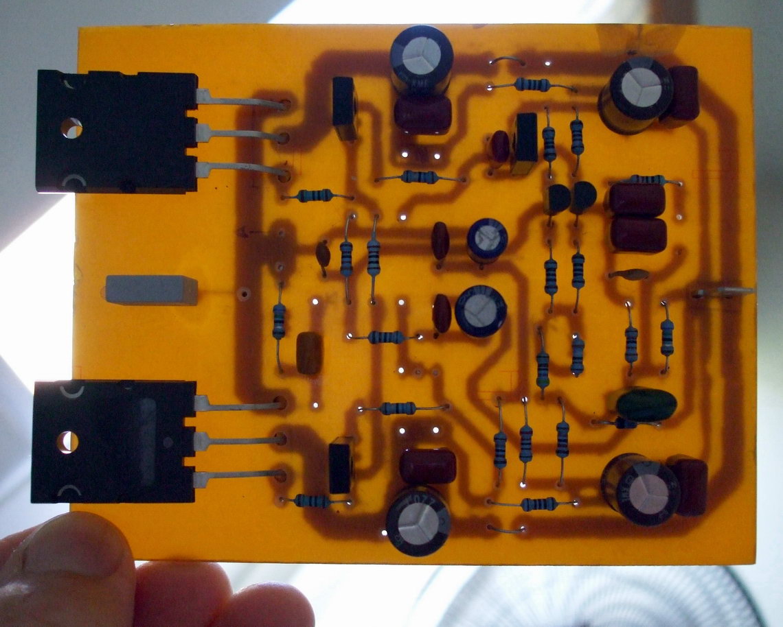

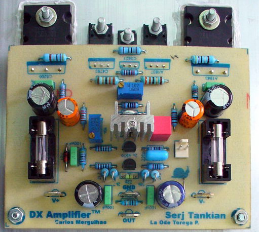

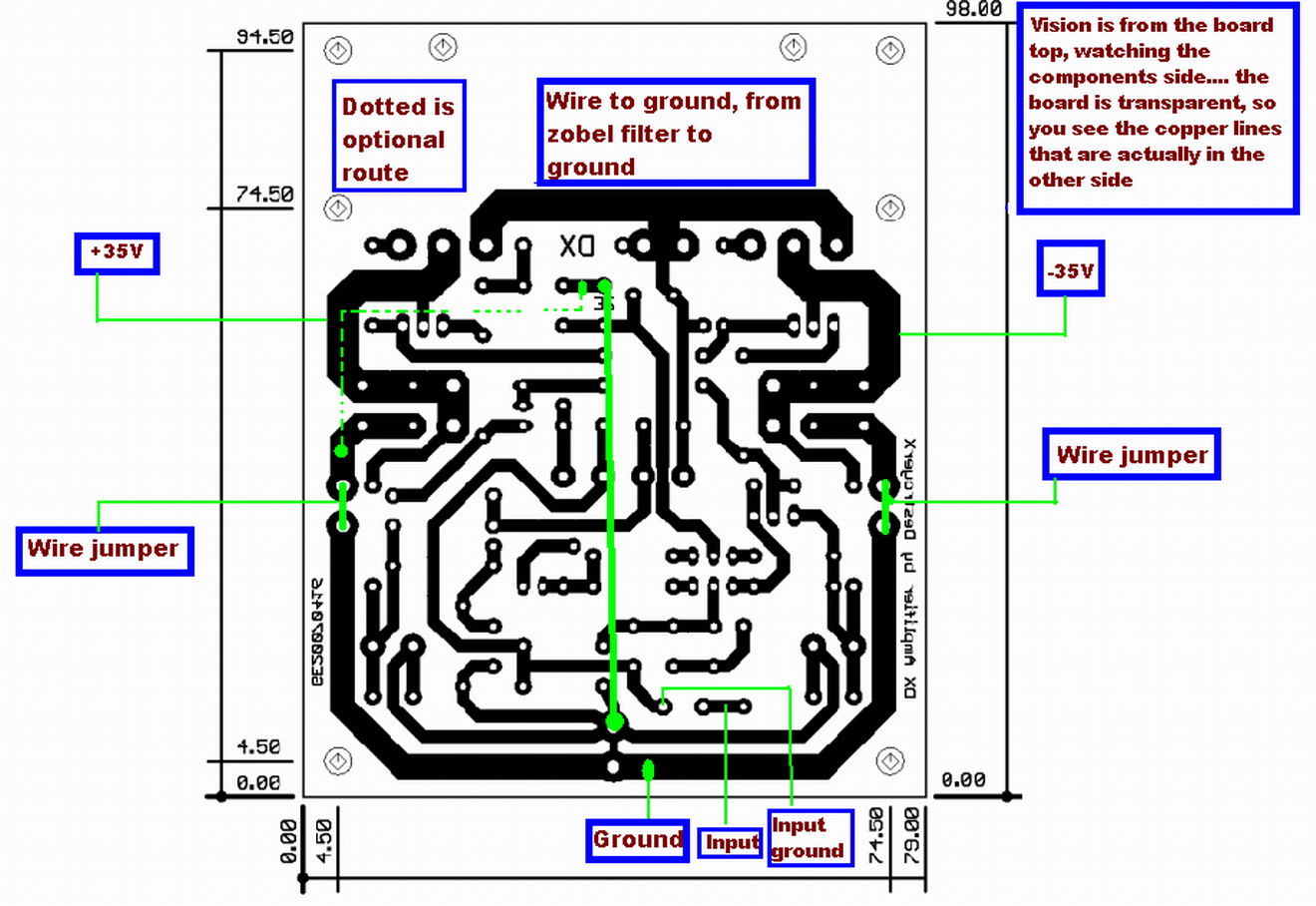

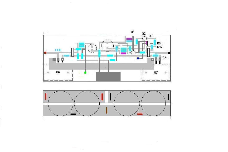

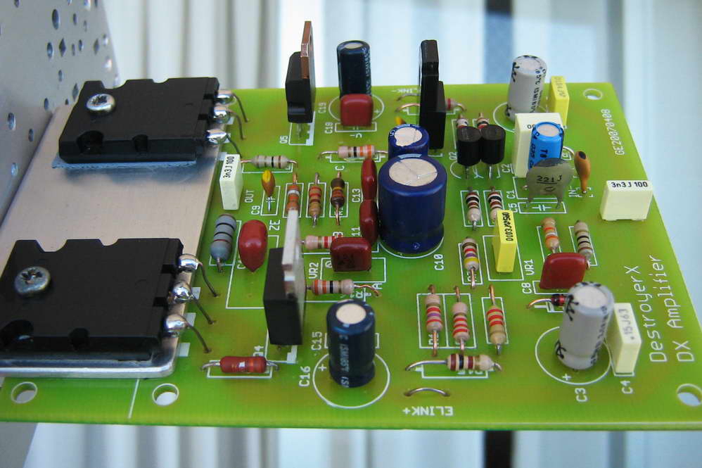

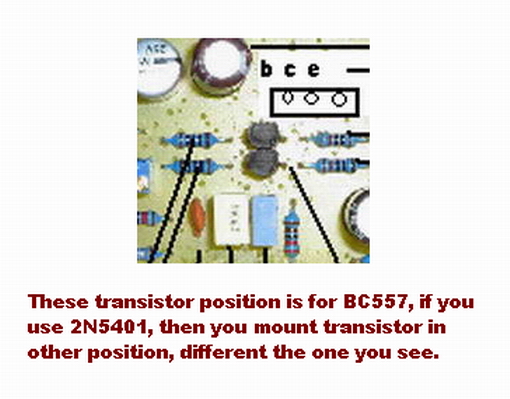

Here you have some images that may help you to decide
and also to allow you to make a self evaluation if you can do it or not.
The site with schematics and more details:
Greg's Web Site
