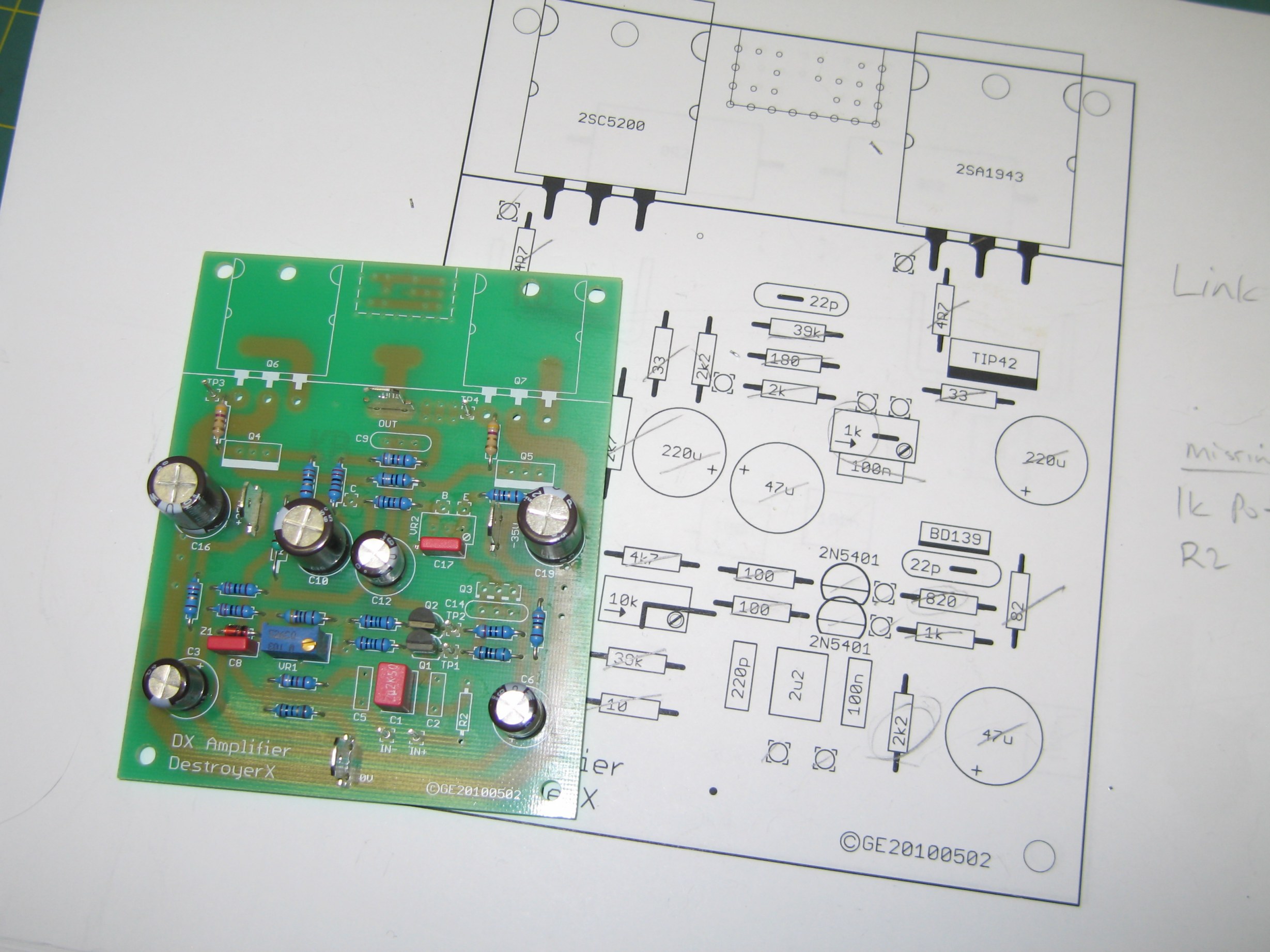

Hi Carlos.
I started buying the parts before the Blame was released so I stuck with the DX.
Also the DX PCB was simpler to etch as a first attempt.
Once my money box is full again there will be a Blame (or whatever DX evolution has come in the time between)
If this is a starting point, it is one I am very happy to be at.

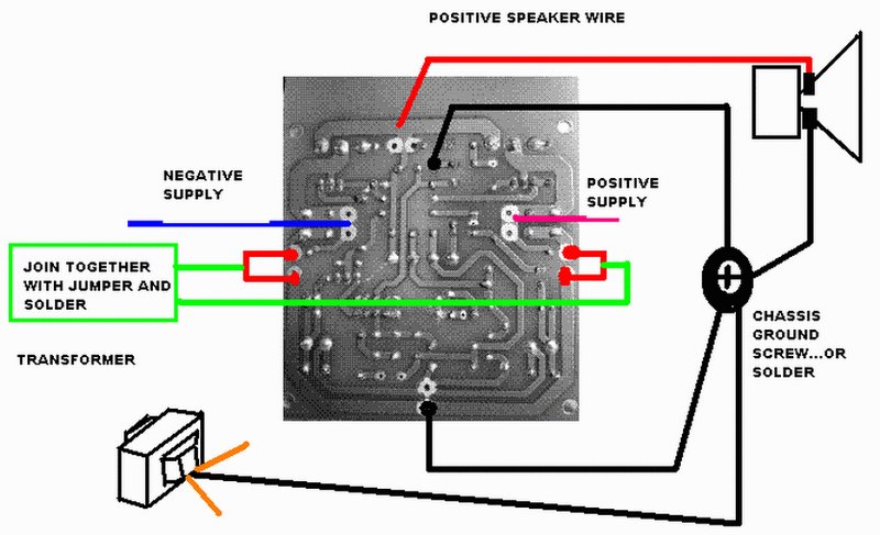

Dx amplifier wire and cable...the ground connection and the jumpers
There's a wire from the zobel big capacitor (100 to 250 volts insulated 100n unit) to ground not shown.
Also not shown the bridge rectifier and the filter condensers.
But people use to call me because of that..so..once again, here is the image.
These jumpers provides ground to rail filter capacitors...this was the result of forum folks suggestion to have a board that can accept several style of grounding...so... where to connect the ground was optional and discussed by theorists.... then the board offered the several options.
regards,
Carlos

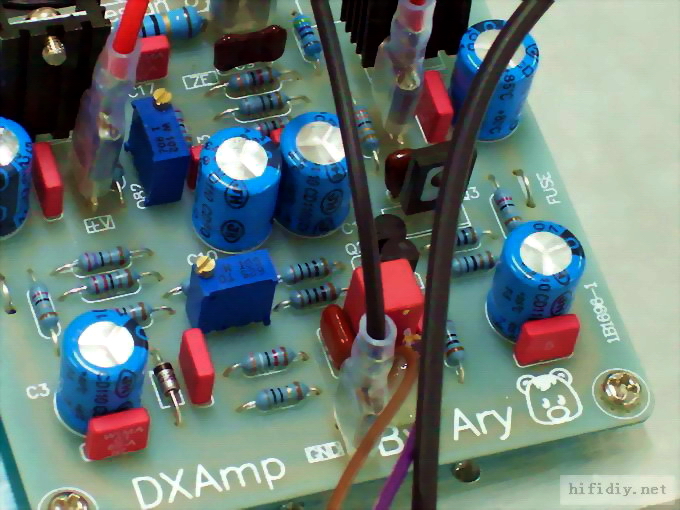

Turn on and off thump with the DX amp,Why?
Ibuilt two of these nice little amps but the turn on and off worry me.
Speakers push way out.

Robb2112... we really have power on thump...and power of "click"
But this depends on the condensers time of charge in the differential... some amplifiers i have build had small movements of the speaker cone...they move all the way with 3 to 4 volts usually.. and this is not what usually happens...a very few quantity of people have complained about that power on thump saying it is annoying.
The ones had very small power on thump was the ones had obbeyed the schematic....the correct values to capacitors..anything increased..... other amplifiers i had huge power on thumps..and these ones had increased condensers everywhere...so.... try to obbey the schematic to reduce.....or try a speaker delayed insertion circuit to avoid the power on thump, that really exists, despite very weak and sometimes not audible (infrasonic...below human audibility), in correctly selected part's amplifiers.
Avel 30...the use of darlington output depends to re arrange the entire amplifier..if you are skilled enougth, then you will remove drivers and output and will install your darlingtons without problem..because my EF output is connected in darlington mode...so..you gonna be substituting and changing 12 by a dozen...the same thing the darlington and my circuit..say...almost the same..as darlingtons use to be worse..as you cannot adjust the internal resistance..some of them are for switching and not for audio and you need to install a huge capacitor from base to colector to avoid them to oscilate..it is a recreation, a redesing.... an big job that i prefere not to have...it is a custom amplifier..not the Dx amplifier anymore..i cannot be responsable and i do not accept this responsability..do it under your own risk...i wish you good luck.
Shreya..the output pairs are complementary..one is PNP and other is NPN...i have not made and tested, a quasi Dx Amplifier...but maybe you will find something alike in the begining of this thread, as a good friend have asked...i think there's a schematic with this option in this thread...search the thread if this is your need....but the amplifier i give follow up is the Dx amplifier, the non modified one..i am not responsable and will not make customized diagrams.....if you intend to use that transistor with it's complementary, then i say you can do it.
regards,
Carlos
